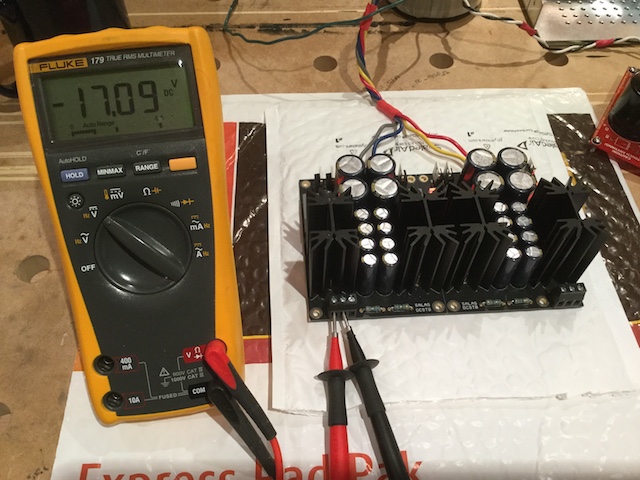

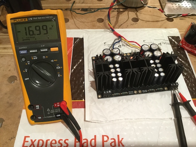

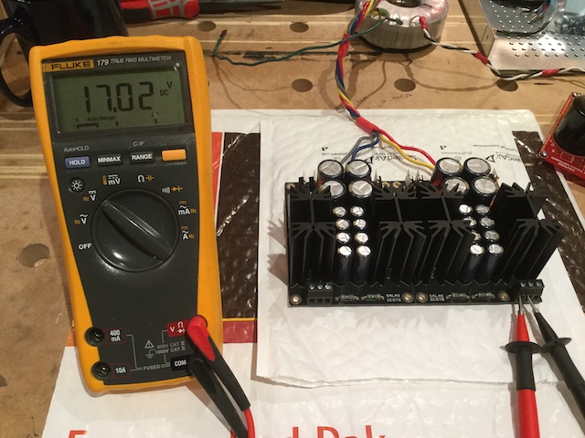

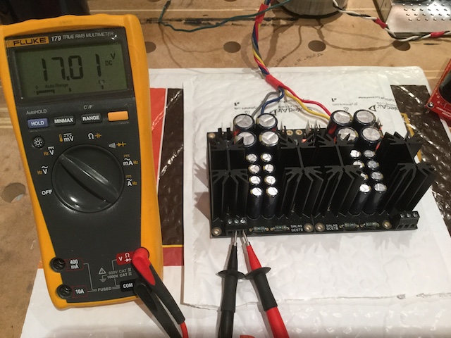

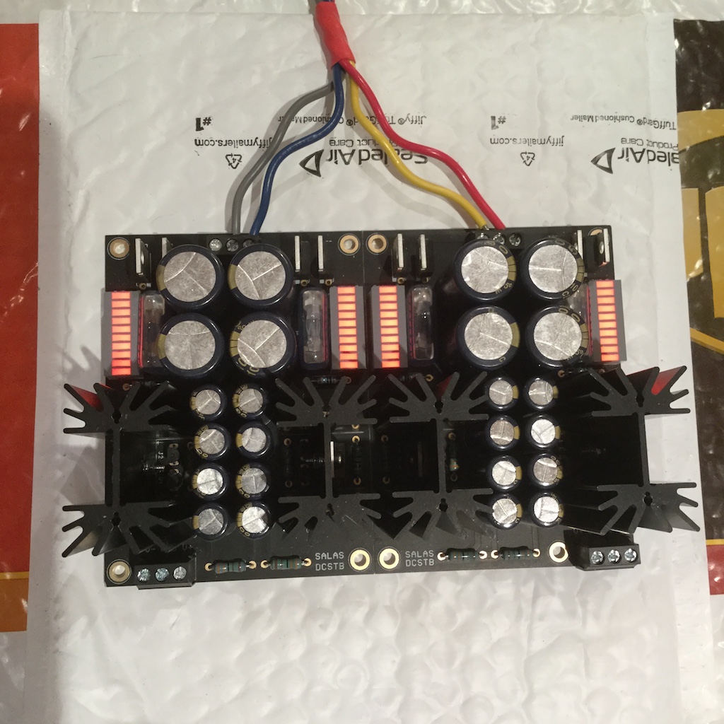

Build Progress
Okay! Making some progress with my build and thought I'd share some pictures.
Just finished the DCSTB and did some testing. Still working on heat sink arrangements for the DCG3, so these tests were no load.
The LED bars look really cool! Input is 18V-25VA for this trial, and voltages drop about 40 mV over 3 minutes or so and then stabilize at the levels shown. With 50 VA per side (secondaries in series) the output is about 60 mV higher. I think (hope?) this is a good result.
Looking forward to getting it all together, and I hope it will turn out as well as other builds in this thread. Many thanks to Salas and Tea for making this kit available!
Those are very good DC results but you will also need mid point AC secondary wire(s) for each PSU unit's AC in
