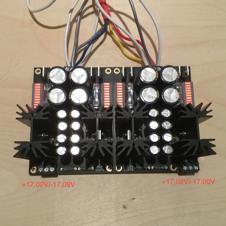

Those are very good DC results but you will also need mid point AC secondary wire(s) for each PSU unit's AC in
Thanks Salas.
Properly wired (!) results shown in the attached photo - embarrassing rats nest of wire but I just used what was close to the top of my wire box.
The final build will use 2 transformers for dual mono as others have done.
-Keith-
