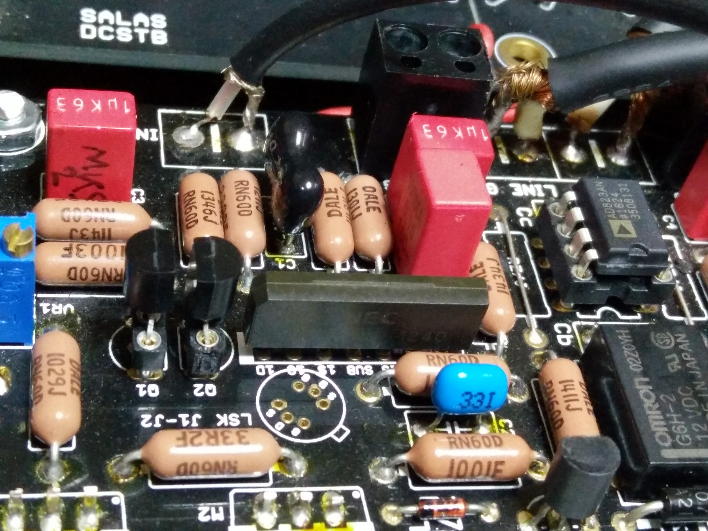

Just doing some final checks before powering up my DCG3 build, and found that I may have made a mistake - can someone please advise?
I have used Takman REY metal film, but through lack of attention have installed 0.25W resistors in about 50% of the positions, rather that 0.5W, which is probably closer in characteristics to the CMF55 recommended in the BOM.
R3 is a 1W resistor.
Question: is it okay to leave the 0.25W pieces in the circuit, or, where is it better to have 0.5W (like R6 perhaps)?
I expect to bias at about 110-120 mA, and gain of about 3.4x.
-Keith-
Should be fine.
Only R10 (7.5-12R) needs to be 1W

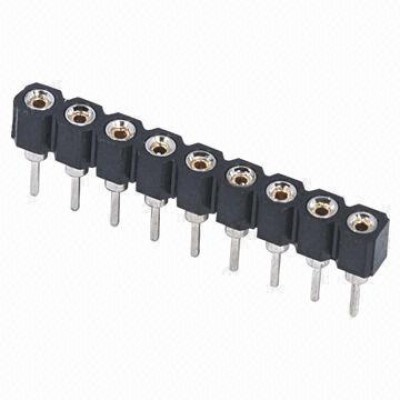

i can not find the tread where you show some Socket to use with the bc237-40
have you a nummer on those socket...
i will try them again ,,,because i have change speaker and dac
use now Troels Gravesen The Loudspeaker--- and dac from Mirand audio
Best Bjarne
Hello
Those are called 2.54mm female headers or sockets (example code from company 3M on Mouser: 929870-01-12-30 example on ebay: 10 x 3 Way 2.54mm Single In Line SIL Socket | eBay example on ebay 2: 5pcs 40 Pin 2.54 mm Single Row Round hole Female Pin Header PCB New | eBay)
Thanks Salas
i will buy some from RS parts Denmark
give they good enough connection ?so they can stay in forever
The transistor legs fit as good as the servo op-amp fits in its socket. At least in those common cheap 2.54mm row sockets I happened to have. But keep the transistor legs short to be rigid. I did not notice any noises etc. from coming loose or oxidized by now.
