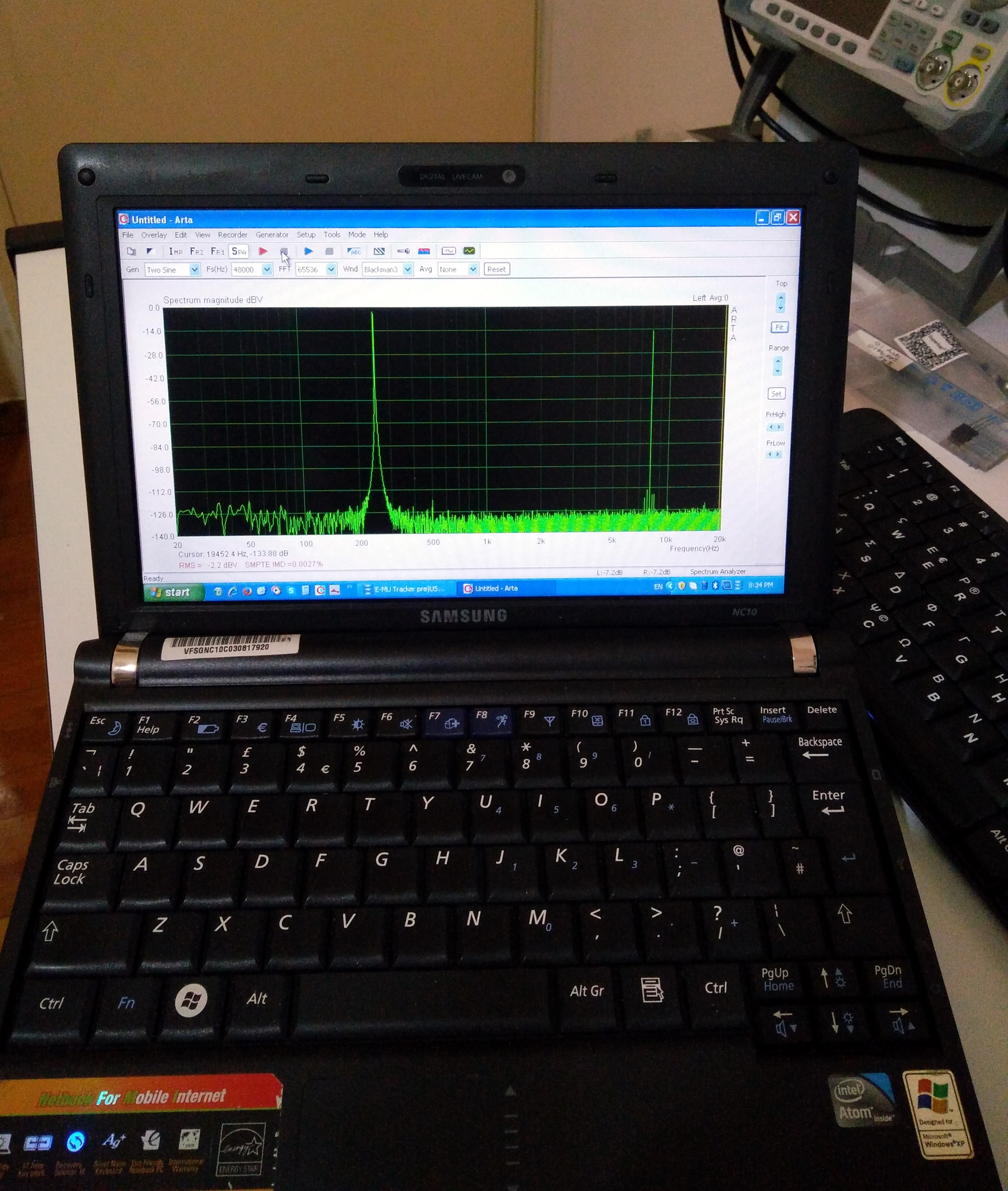

It has at least 40dB 1kHz to 20kHz PSRR as a whole when I tested for it through speaker coil VDC feed and capacitor to gen which is the practical limit of my 8 bit DSO. Simulation is indicative but it does not know layout so take it with a pinch of salt if producing some very good PSRR figure. Sometimes there can be odd results when breaking the rail of a tightly knit system and I did not see need for it by the IMD SMPTE 250Hz 8kHz 4:1 measurement so its up to your curiosity to try and see. There is very steady Class A bias in the output stage (not only using CCS but its set in the Mosfets zero tempco region also). So small signals don't rock the boat but if you have in mind difficult to drive headphones you may achieve something bit better for when listening loud is my best guess. On the other hand, more output stage current bias could possibly achieve somewhat analogous goodness in that occasion as well.
From my post #17
"Here is IMD SMPTE when driving 120 Ohm for instance. That's strong 250Hz trying to modulate quieter 8kHZ. See the little bass tone modulations around the high tone's base. 0.0027% modulation at 101dB SPL with those AKG. Means clarity in busy music. Not easy to do that with SE tube headphone amp."
P.S. The load on the above test was specifically the AKG K612 PRO medium sensitivity headphone which has a reputation of being difficult to really move. And it is. Significantly quieter with "meh" quality than the HD600 on my PC's direct output, but on the DCG3 its flying.
