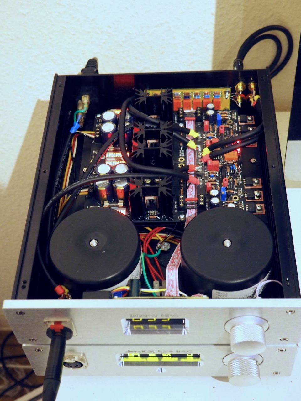

I'm using the DCG3 with DCSTB, 2 transformers with 2x18V, each 50 watt. Bias is 150mA, headphone impedance 250 ohm.
Is it possible to use only 1 transformer with 50 watt without losing sound quality? The power of one 50 watt transformer must be enough I think.
Hi
Do you mean one new custom 50VA transformer of double three wire 18V secondaries? If you mean just 18-0-18 it can't be shared, you will have to downgrade in mono DCSTB.
diyAudio Chief Moderator
Joined 2002
OK, I got it. So a transformer with double three wire (each 25 watt) will be OK?
Yeah sorta... Do we settle on single core of 40+40W triple wires? An 80W core is not much wider than a 50W one. There are taller core types than too wider.
P.S.
Is it a matter of box floor space? Can't you stack your now transformers one up the other?

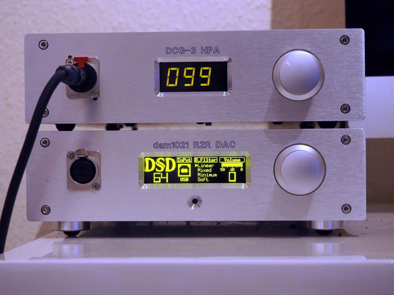

Yes, I'd like to change the ladder volume control to a muses 72320 and I don't have enough space in front. I don't want to use a cabinet with another form factor due to the dac which has the same cabinet (see photos)
Perhaps it's useful to disassamble the amp and play a kind of puzzle to see how it will work out.
