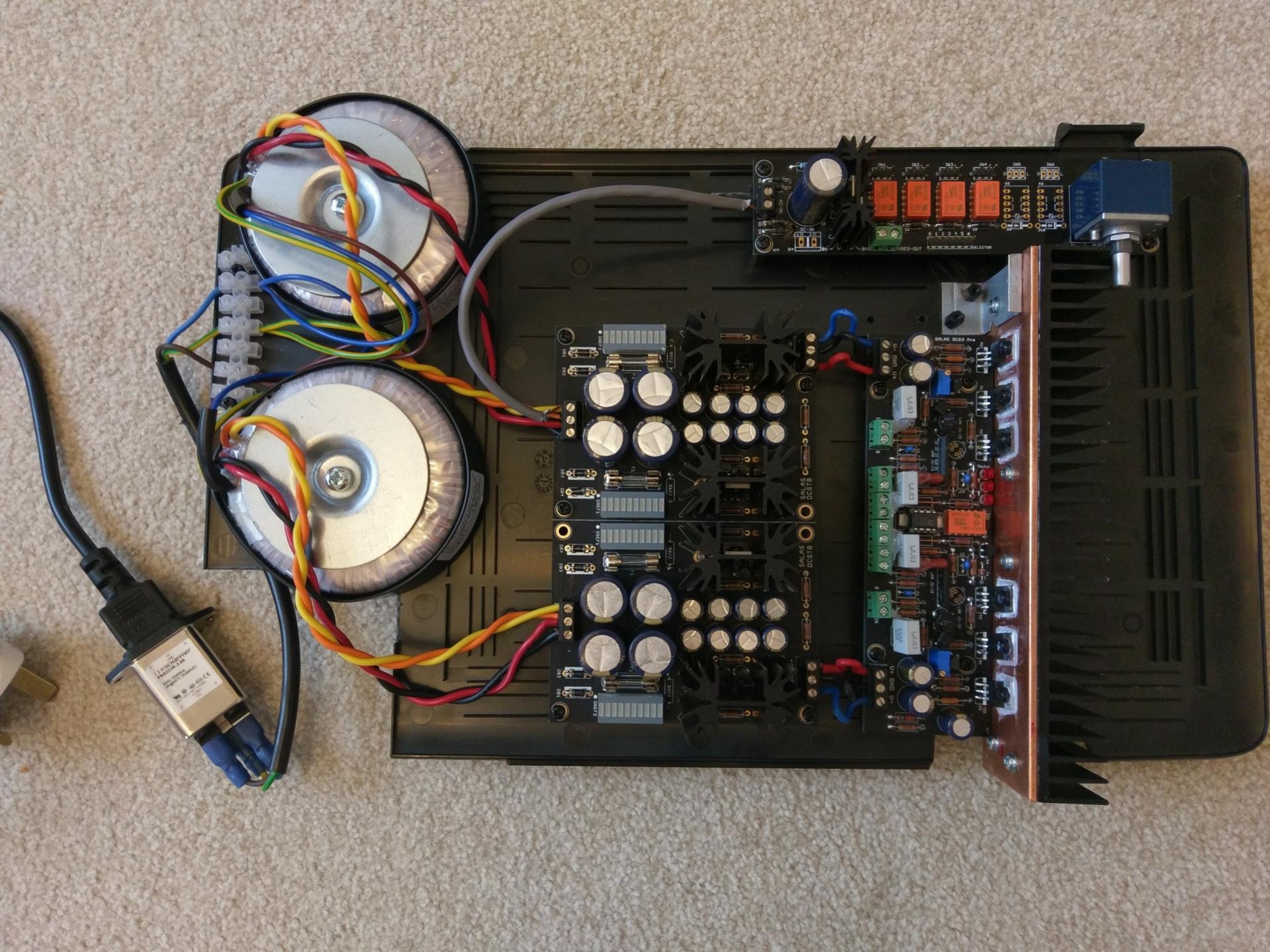

Something wrong with the AC secondaries interaction probably. Was the selector board fed from an independent secondary? Is there a picture of the whole as wired when failing? Raw DC from a DCSTB's reservoir capacitor can be fed to selector board instead of AC as well. It has DCin also. Presuming that its components are in good condition. What is the exact type of relays you used? You can have low Ohm reading across the output when the pot is fully closed.

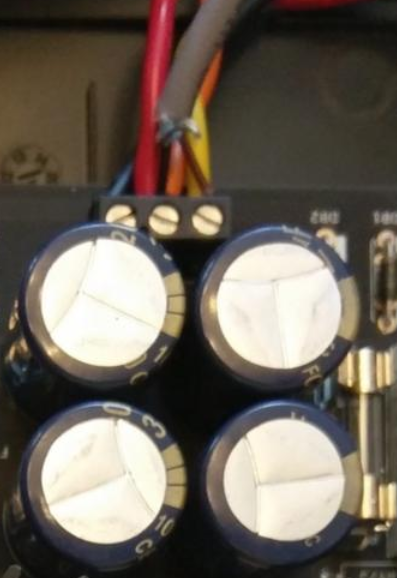

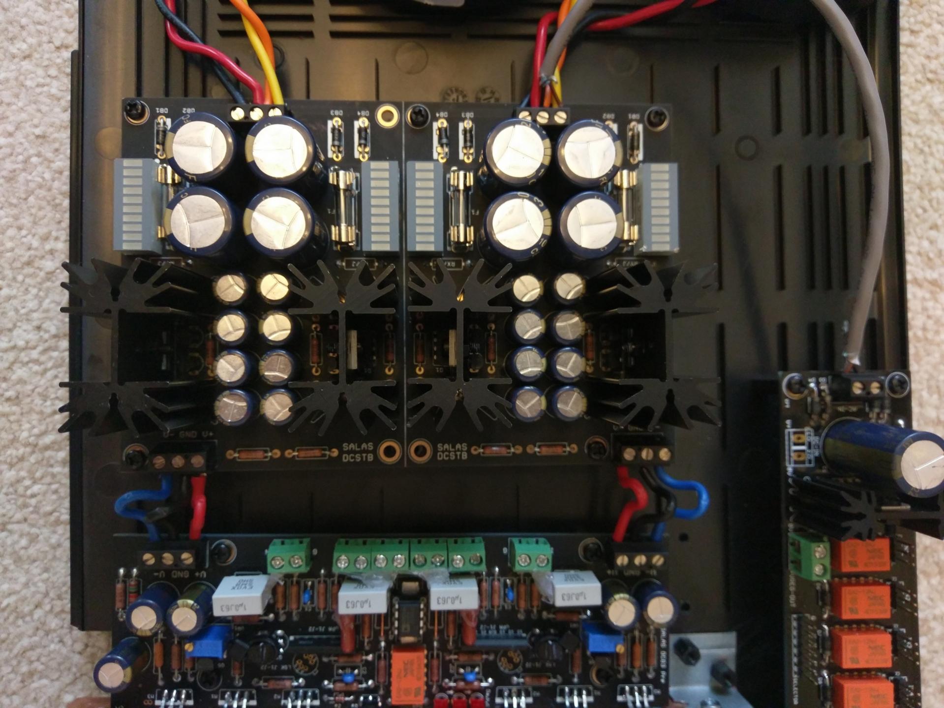

I've attached a few photos - it's breadboarded as you can see and the grey wire supplies roughly 20V ac from a single secondary on that transformer to the selector board. I'd already taken the signal wiring back off so that I could inspect the selector board before I took these pics. I'll try to describe the extra wires I had so you can tell me which was the stupid one! Selector board output had two screened twisted pair cables soldered on, one per channel, ground common between the channels. These ran to the DCG3 input headers and yes I did check that ground went to ground. The pot had a wire looped round the shaft housing held on by the nut and running to the 0V header on the Vreg out pads of the selector board - this is on the same trace as the ground for all of the switch contacts. The selector switch was wired to the board with the appropriate centre contact to ground and inputs 1-4 to switch contacts 1-4 - it's a 2 pole switch and I'll use the other half of it to run source indicator LEDs in the final build. There was also a wire from the common ground trace along the front of the DCG3 to the 0V header on the Vreg out pad of the selector board so that both boards saw the same audio ground. That front ground trace also connects by the power connectors to the transformers centre tap (I think) or in my case the common ends of the dual secondaries. I hope that makes sense of what I did, clearly it didn't make sense to the electrons!😱
Can I see the grey cable with two wires connected across two AC instead of one AC and zero (CT)? Keep on using the bulb tester...

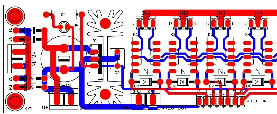

Diodes D3 and D4 on the rectifier of the In-Select are fried; I assume that somewhere I had a short and pulled way too much current but I can't see any errors on the board after taking all my wiring off.
D3 & D4 on the selector board are to its ground. They made passage for the floating AC to its own CT as soon as that board's ground came in contact with the system's common ground. Use one AC leg and CT. Replace those diodes also of course. Check that the zero blue trace did not burn off. Visually and with the DMM's continuity buzzer.

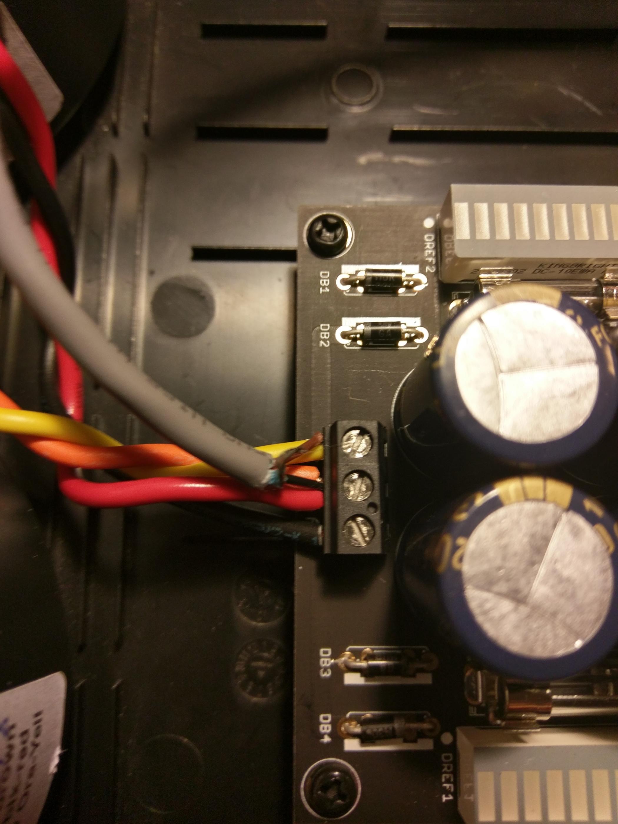

The grey wire is across one ac to ct only - clearer photo attached. Voltage across both ac is just over 40V - the 7812 would definitely have gone up in smoke if I'd done that. Does the black ct wire need to go to the ac in terminal next to D3/D4? Just noticed that at the moment it's the brown wire from the other end of the secondary that is closest to D3/D4 - as these run to ground perhaps this is the cause of the short?
Hi Salas, thanks for the speedy help.

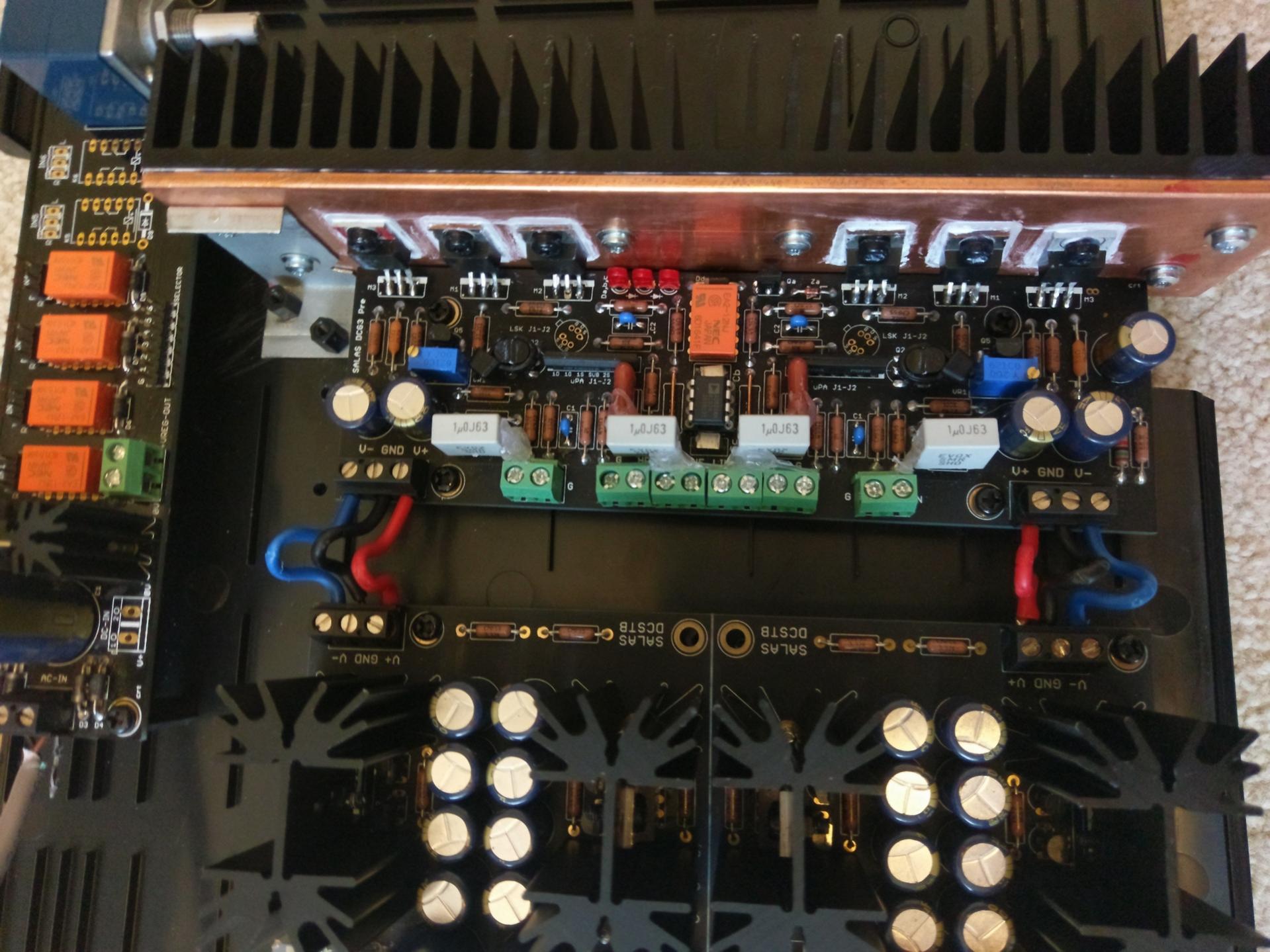

It does look like across the AC connector in the previous pictures. Tricky pics. Make sure of your transformers secondary wires colors and rearrange as you wrote. But I don't think that's the key. Still don't use that DCG3 0 to DCout 0 selector board wire again. That's my suspicion now that you cleared its not about feeding across AC AC.
I agree that the photo looks a bit misleading (pun intended 😀) - sorry for the confusion. I will replace D3/D4, check track continuity as suggested and re-wire the signal inputs without the connection from amp common ground to selector 0V point. I'll also make sure I've got the dim bulb tester in circuit when I power up again.

You may use any 1N4xxx diodes to replace those. The DC in/out 0V on the selector board is the relays PSU ground, not a signal ground. Signal ground is the middle points common line along its inputs and output connectors. The dim bulb tester is going to help save the day in most cases. A loop breaker is not a bad idea either. Good luck and let us know.
