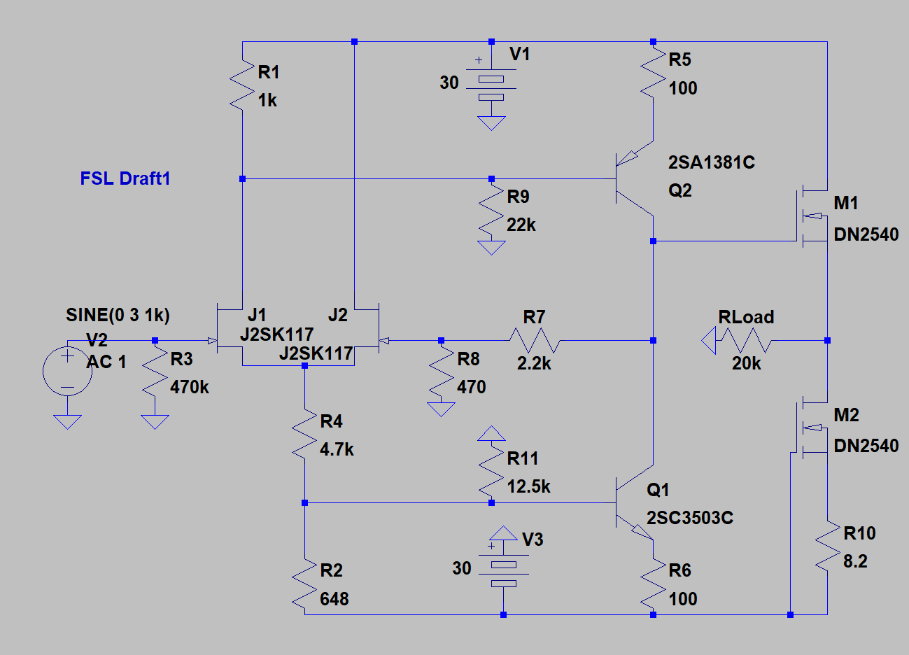

I must have devised on breadboard and measured about a dozen ideas back then. Each one I listened to with cans and I copied it to Spice for archiving as I was tweaking it to another draft or abandoning it to different.
Here's one of those, one of the earliest. Has high rails, push pull BJTs, and outta loop SE Mosfet buffer. For your inspiration because you recently asked me what about such features I think 🙂
Why I had named some of those "FSL drafts" don't ask me, I forgot by now LOL
