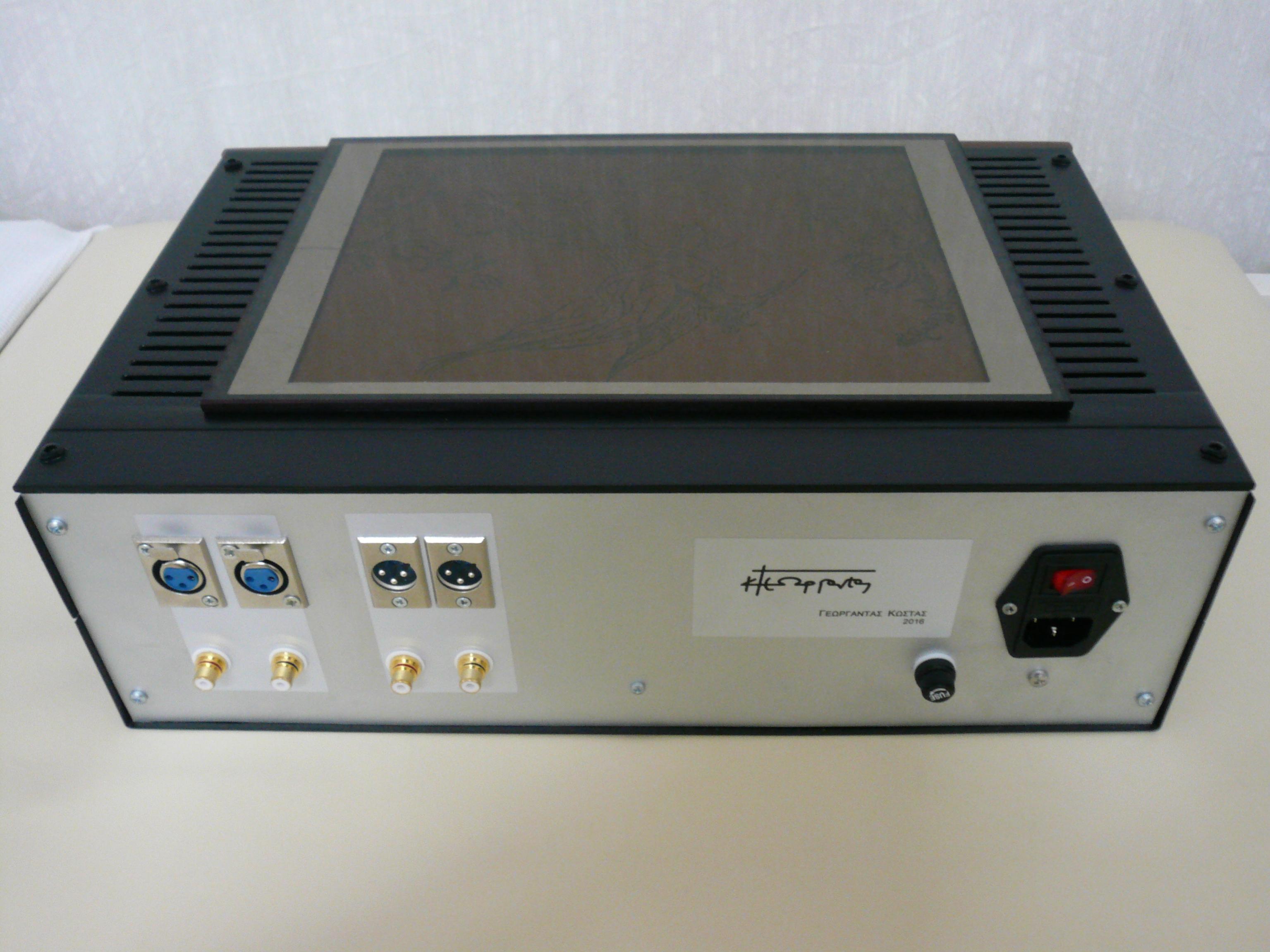

the above diagram has only balanced in balanced out, SE in SE out but not BAL In SE out.
All you have to do is connect a balanced source at the input XLR and take SE output at the RCA. This will be one phase (positive or negative). The other phase will simply stay dissconnected.
Perhaps it should be made clear that it's not a differential configuration. We are not talking about CMRR here. It's only a four rail line stage to amplify a weak balanced signal for the requirements of the next stage. CMRR will hopefuly take place there (the amp) provided it has differential input.

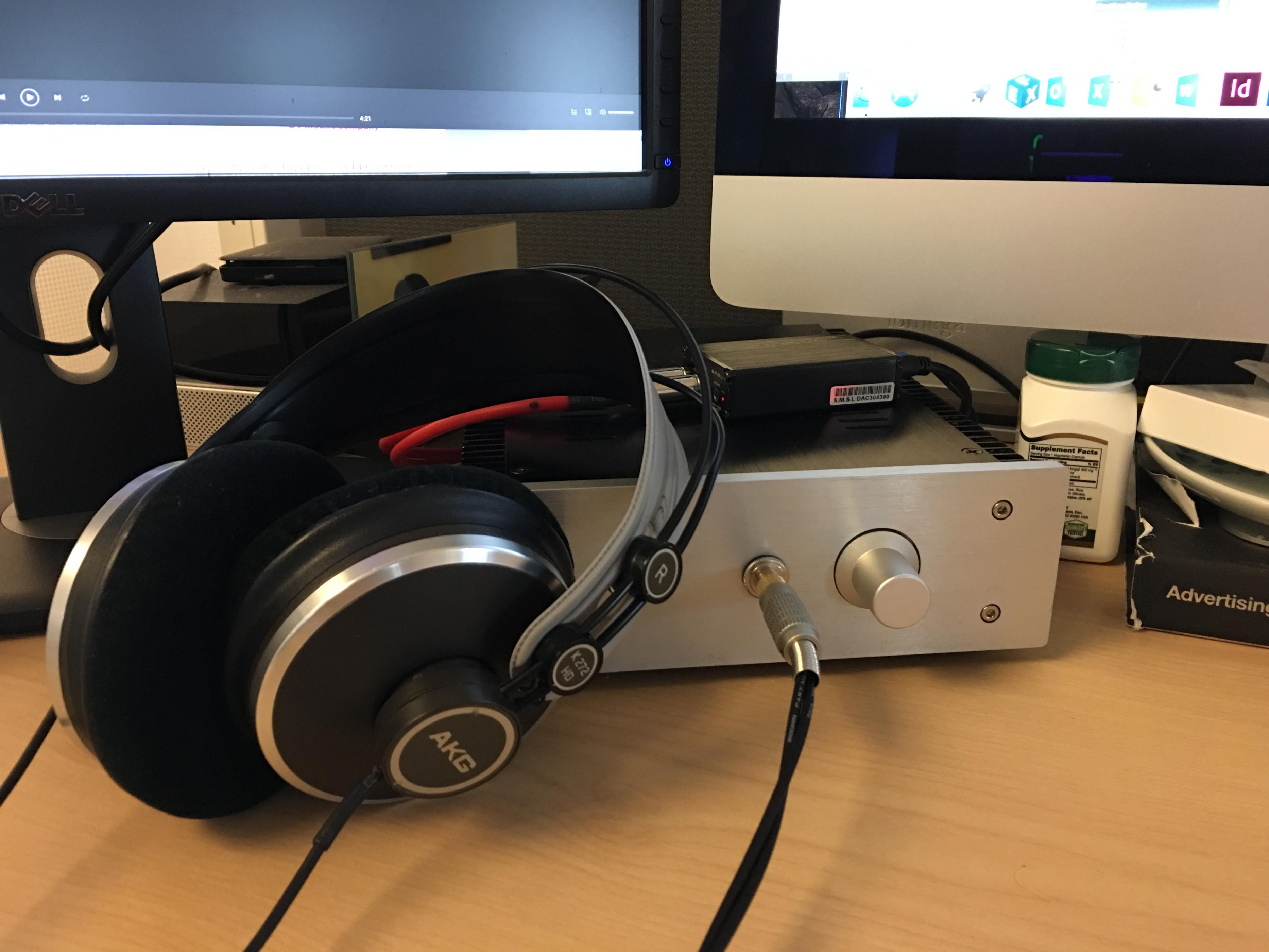

Personally, I would choose 3x especially if you get another set of headphones. 3x is just right with f5 turbo (20db gain in amp) a little to much gain for grados. 3x is perfect for akg 7xx. Headphones vary a lot. Those audioquest headphones are meant to be driven from a phone...so not much gain needed.
Mosfets theoretically sound best with more current so I’d max it out if you have the heatsink and your power supply will accommodate it. And with 25ohm headphones you want as much current as you can get.
The power supply will be the dual version from Teabag, the two transformers are the recommended Antek 18 + 18 @ 50VA. Is this sufficient?
Russellc
diyAudio Chief Moderator
Joined 2002
Russellc
Yes. More than enough.
Each transformer is rated .5A. You want the load to be less than half the transformers rating ideally.
So you are in good shape. I run mine with a single 50va transformer at 130ma with no problems.
That could be their rated primary current? They are rated stronger for secondary current I believe.
Iam listening to mine now at work.
Sounds damn good. Seriously.
One thing to consider is if you are building for headphones and don’t listen loud (at work I can’t listen loud) you want less gain so the volume pot is not always set so low. Many volume pots have inconsistent tracking between channels at the beginning of the pot.
I have a stepped attenuator in mine so it’s not a problem. But at work I only use 1/4 of the dial with much less efficient headphones than the audioquest. At home I use 3/4 of the dial with akg 7xx.

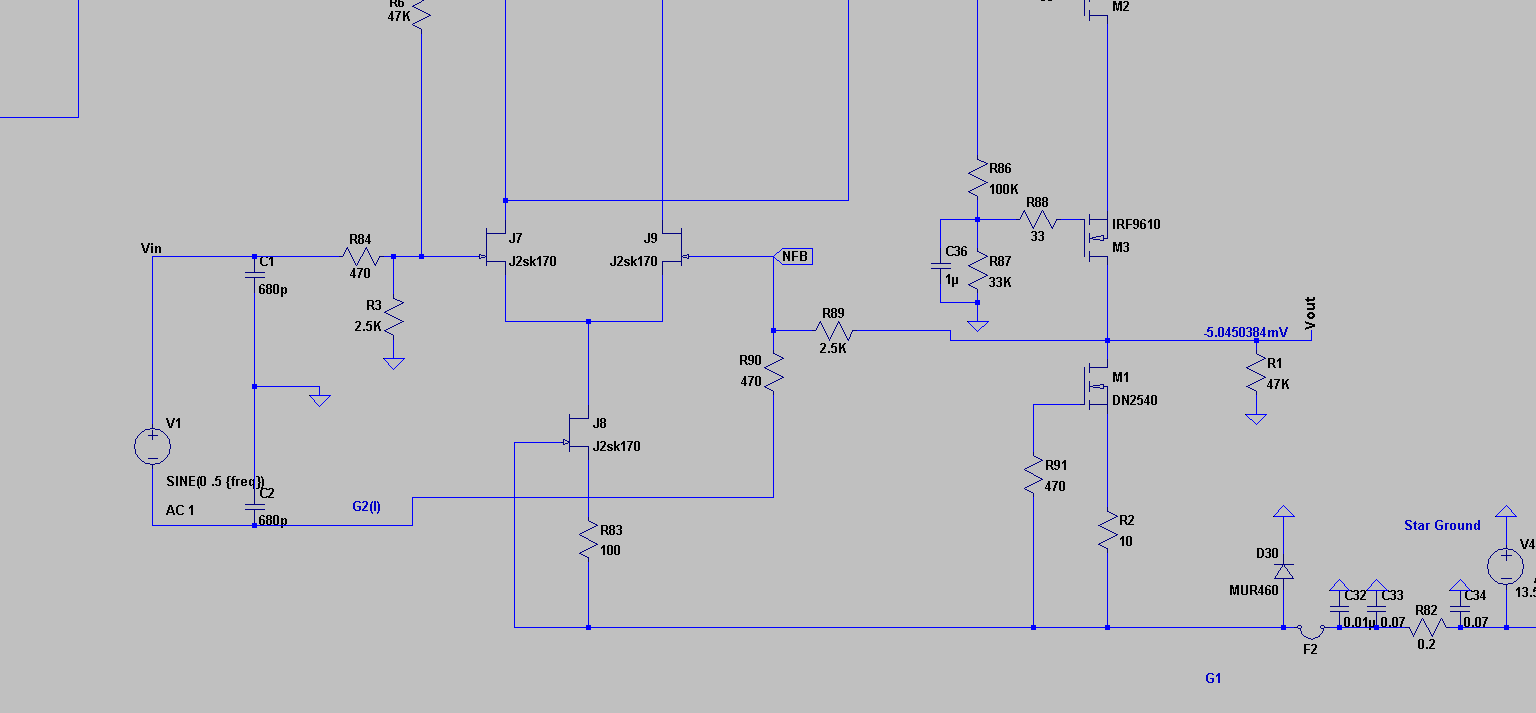

Hi
Have now power on the pre
1 channel do not work right ,,,to high DC on output
it was a fault 9610
i mounted 2 new..and then it looks alrigth
witout the servo ic i have about zerro to 10 millivolt...not bad
with the servo ic zerro to 2 millivolt
also the volt over R10 is 119mv on both channel
now it is time to mount the in and output
Best Bjarne
