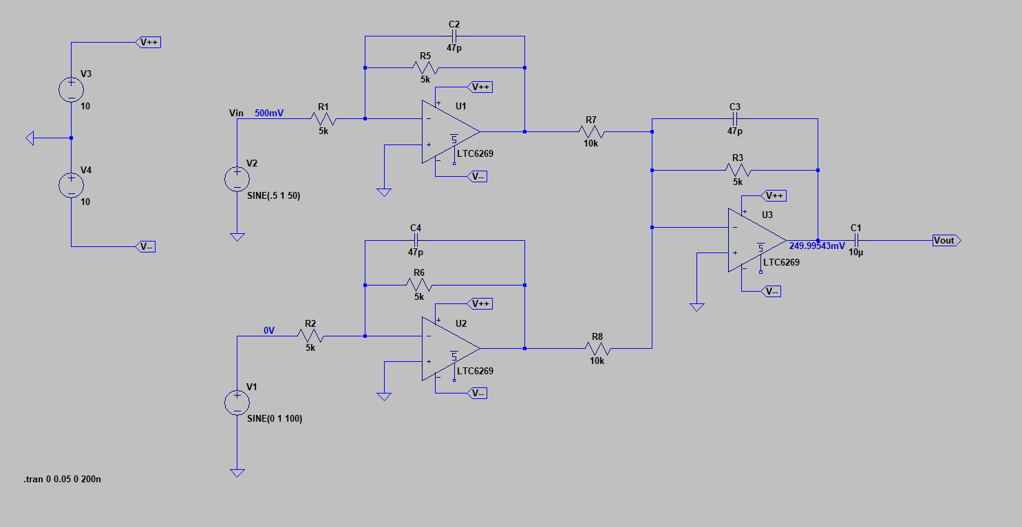

Hi Salas
I need a subwoofer output in my DCG3.
The idea is to sum the outputs without causing crosstalk so I designed two unity gain buffers that should present high impedance to the DCG3 outputs and then sum the result and buffer it to drive long cables.
Please let me know if it can be done like this:
The final summer presents a 10k impedance to the two Buffers.
The two Buffers each present a 5k impedance to the two Sources.
Why don't you just use the summer connected to the two Sources?
The virtual ground at the -IN node prevents virtually all crosstalk. It's why the summer channel is used for proper summing of two signals.
