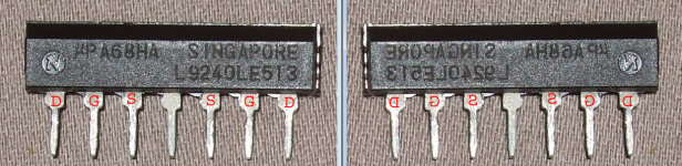

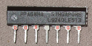

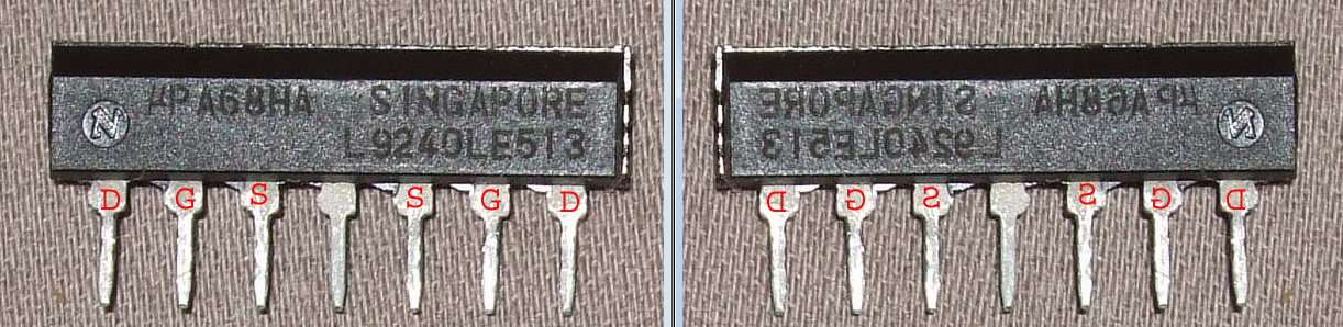

One more orientation question...the uPA68 devices. Does pin "1D" correspond to the small round brand on the end of the of the device that appears to have a N in it? This is the same side that has uPA6U marked on it? Otherwise how are these parts oriented?
Russellc
Russellc
The pins are as marked in this photo. So 1D corresponds as you described.
Looking at its pinout I'm thinking that this part has no right or wrong orientation, right?
Palindrome part.. 😀
Is this the right way to do? I see slight increase in distortion from the above schematic.how about using this way for Balanced input SE output.
Palindrome part.. 😀
Its a flipper 😀
