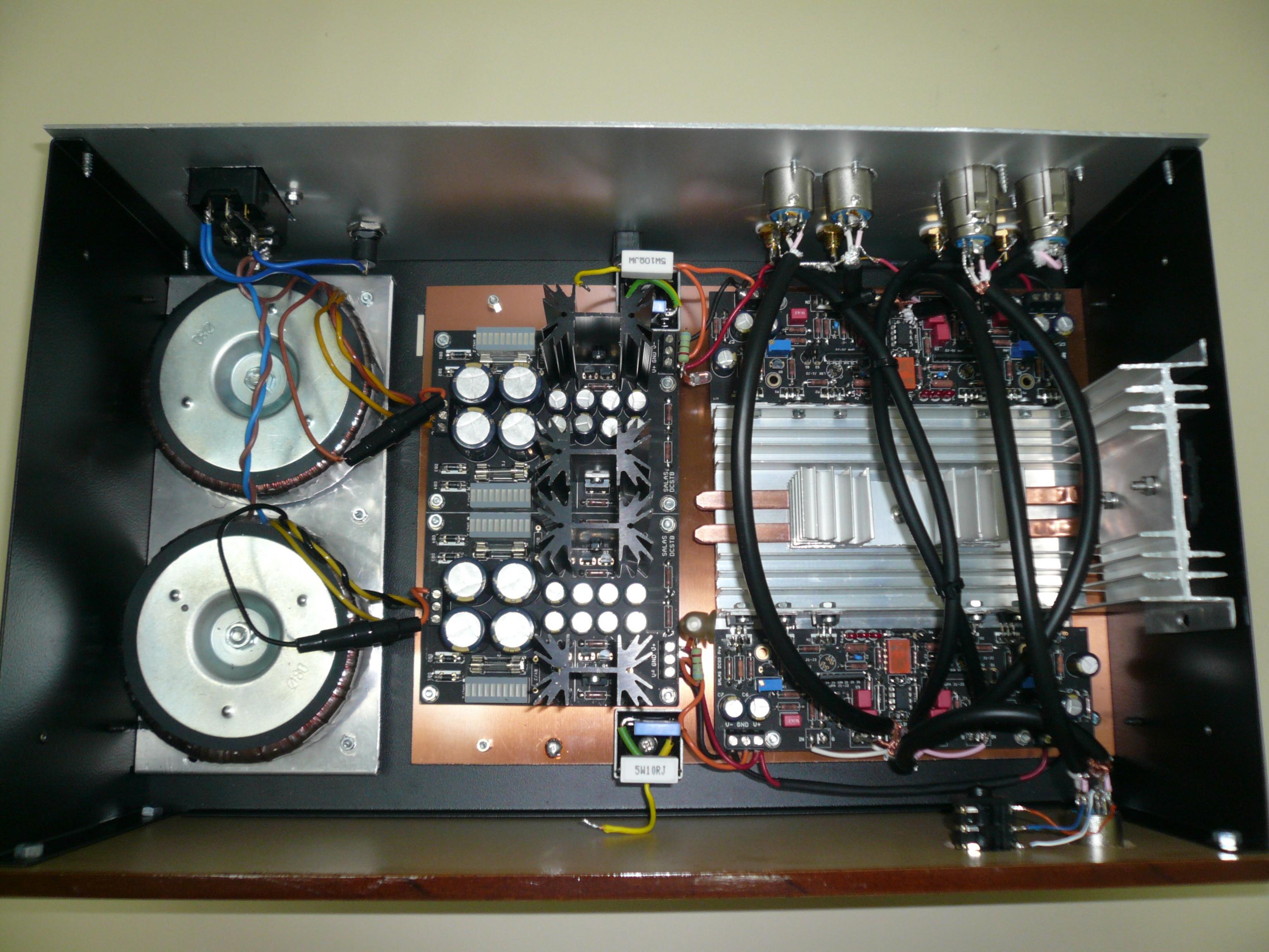

Hi Magicbus how are you using DCG3 in balanced mode? just connecting two preamp for + and - inputs? which balanced amp are you using?
Hi Rhythmsandy,
Yes, I used two DCG3 boards, one (double) DCSTB and two 100VA transformers. I wired it with XLR for gear compatibility. Output XLR pin 1 is connected to chassis as ought to be. But input XLR pin 1 is connected to circuit ground because it serves as signal returning path since this configuration is not a differential amp. See schematic. In my build, I left the circuit ground floating (chassis always to mains ground) because I take signal from a PC. Other sources may require different approach.
I use diy tube amps. Currently a balanced KT88 PP. Input XLR pin 1 to chassis.
Reading again my previous posts I felt like making some comments. Still, I think balanced mode sounds better than SE - that is in my humble system. But I started revising my opinion that this is due to differential amps present a constant load to the psu. It seems more plausible that the difference comes from the grounding scheme that a balanced system allows. Provided that pin 1 is connected to chassis, components' circuit ground don't mix. Just my thoughts...

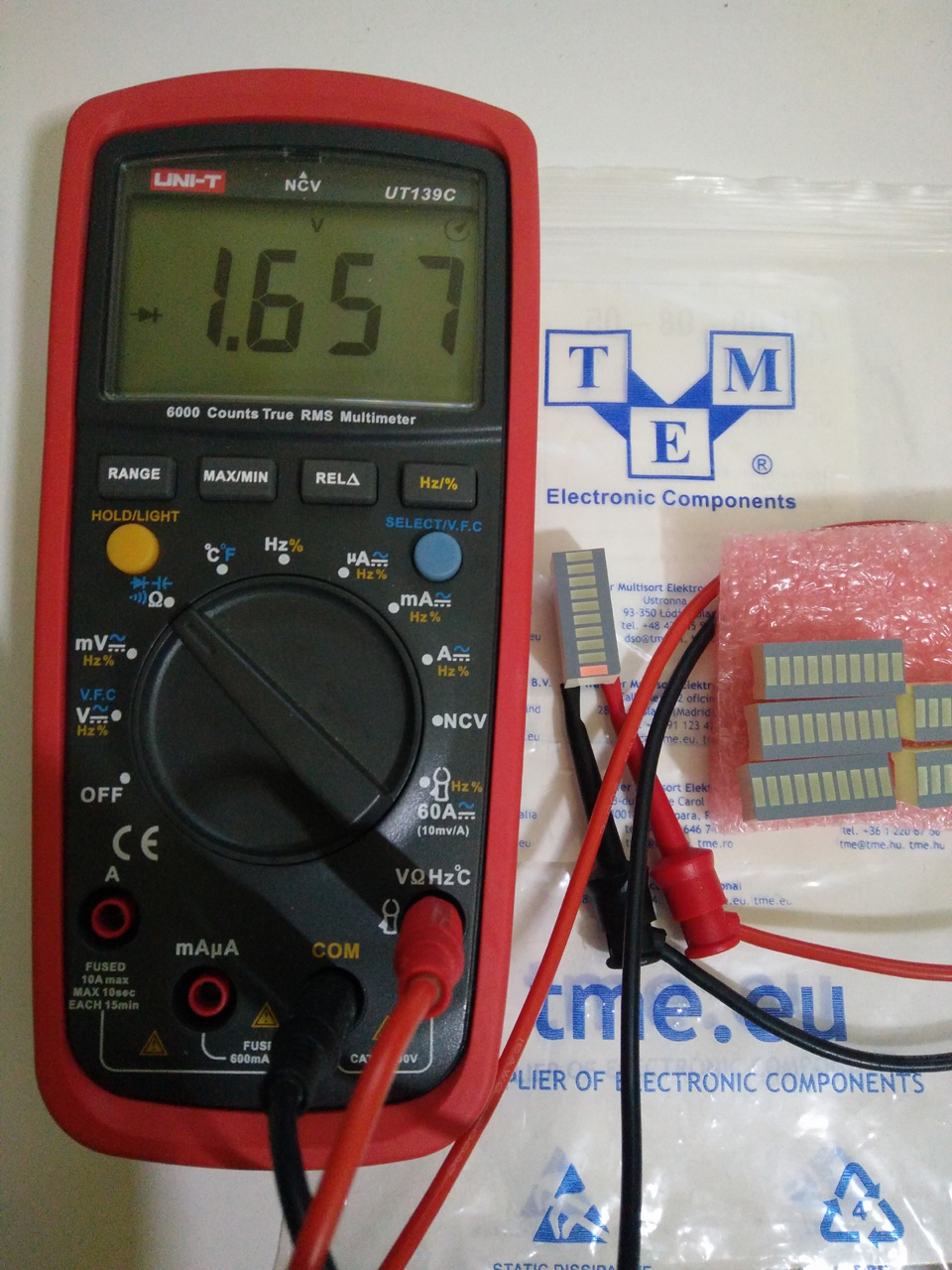

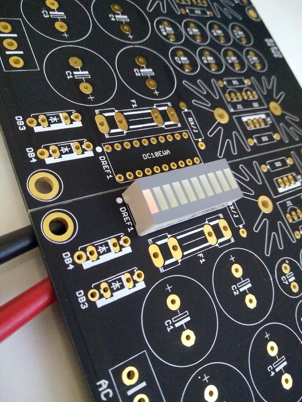

Orientation of the LED bars question here. I have the Teabag kit and boards, I see a heavy line on one end of the trace on the board. I know I remember reading here how they are oriented, either a flattened corner or #1 pin where a small embossment on the part...I can not find this.
Can someone tell me how to orient these pieces?
Thanks,
Russellc
The beveled edge mark should suffice. A dot on the silkscreen is situated opposite to that beveled side as well. This one marks cathode in case you want to confirm the LEDs bar part electrically also. In the attached pictures a red probe is connected to the beveled edge's pin and a black probe to its opposite pin. The DMM's diode function lights up and measures the bottom LED. Goes correctly to the PCB with the the black probed pin at the dot marked pad.
Thanks. I see it now. The bevel is very slight!
