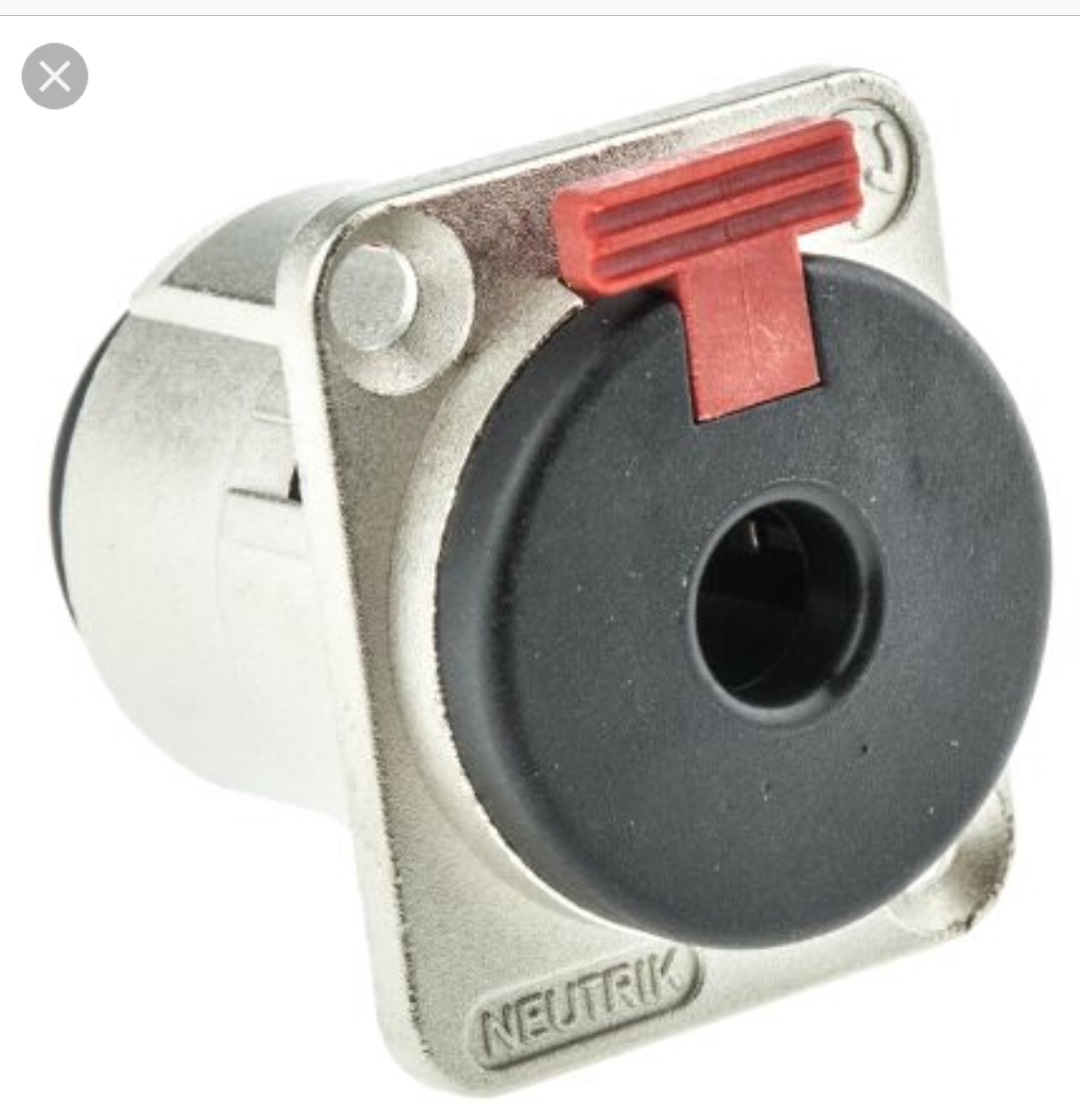

It also takes a precise cut of a larger panel hole for that one. No nut to conceal a rough cut.
You can buy a rubber “gasket” that fits around those that gives you a little more room for error when drilling. It’s in the data sheet.
I have one of those jacks but Iam too scared to drill a 25mm hole through 10mm aluminum in order to put it in my case...
Thanks guys for your suggestion. I will order one tomorrow. Trying to get my chassis done and do some testing next week.
