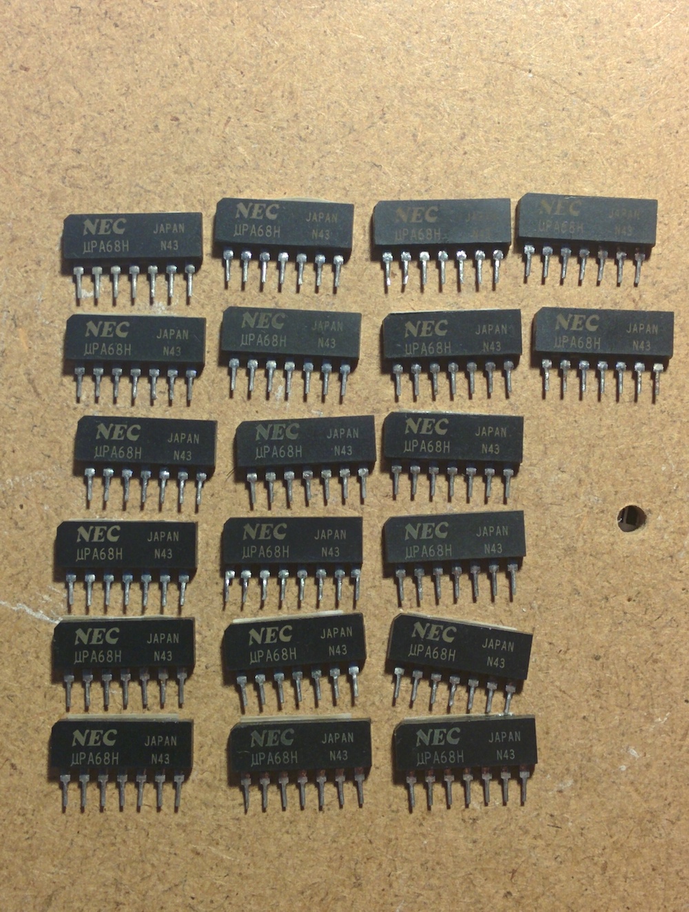

Just started the build and came across a fake/mutated NEC while measuring
the idss of them. Can you find it 😉
FWIW, the idss range from 4.2X to 14.4X mA, all are usable except one.

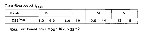

That's a very weird sample. At the bottom right side they also all have the same N43 (fishy). It should mean N class and batch. They must only range between 13mA to 18mA. Else they are fully suspect. My stamped Japan fat variety samples are random, they have different letters K, L, M, and different batch numbers, shiny leads and the NEC stamps are located some at the top left and some at the top middle but all are in faded white color. Their IDSS follows their lettering rank in test.
Yup, I suspect that is a bad one that somehow passed QC.
The casing and prints are identical to the rest except one pin too many.
Wonder what it actual is ....
IMHO those are all most possibly forged and the eight pin one is the forger's worst blunder
Yeah, I was very surprised to see the wide range of idss as well. I bought those when this thread firstly started (from ebay, of course), so the demand wasn't even there.That's a very weird sample. At the bottom right side they also all have the same N43 (fishy). It should mean N class and batch. They must only range between 13mA to 18mA. Else they are fully suspect. My stamped Japan fat variety samples are random, they have different letters K, L, M, and different batch numbers, shiny leads and the NEC stamps are located some at the top left and some at the top middle but all are in faded white color. Their IDSS follows their lettering rank in test.

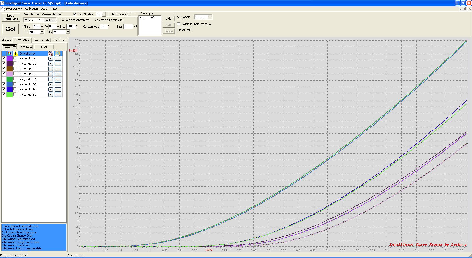

I just checked a few of them with my curve tracer. The "Auto Detect" said N-JFET for both sections with the correct G pin (D, S pins interchangeable). The curves also match the data sheet's (see attachment) VGS vs IDSS curves with closely matched sections, too. Perhaps, they are no worse than those I can buy from ebay these days, sigh.
Maybe they had various similar NEC and rebadged them. In any case I would not risk to build with those if I had an alternative. Noise or capacitance could be off. You can use 2SK170GR or BL matched pairs in their place if you got any.
