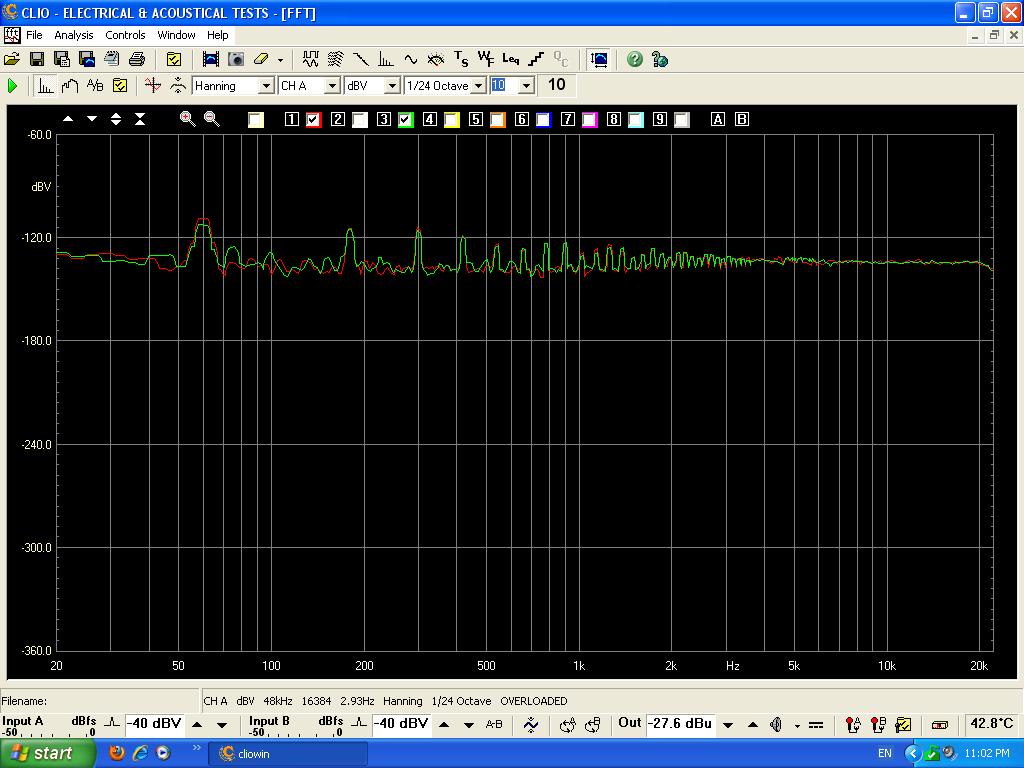

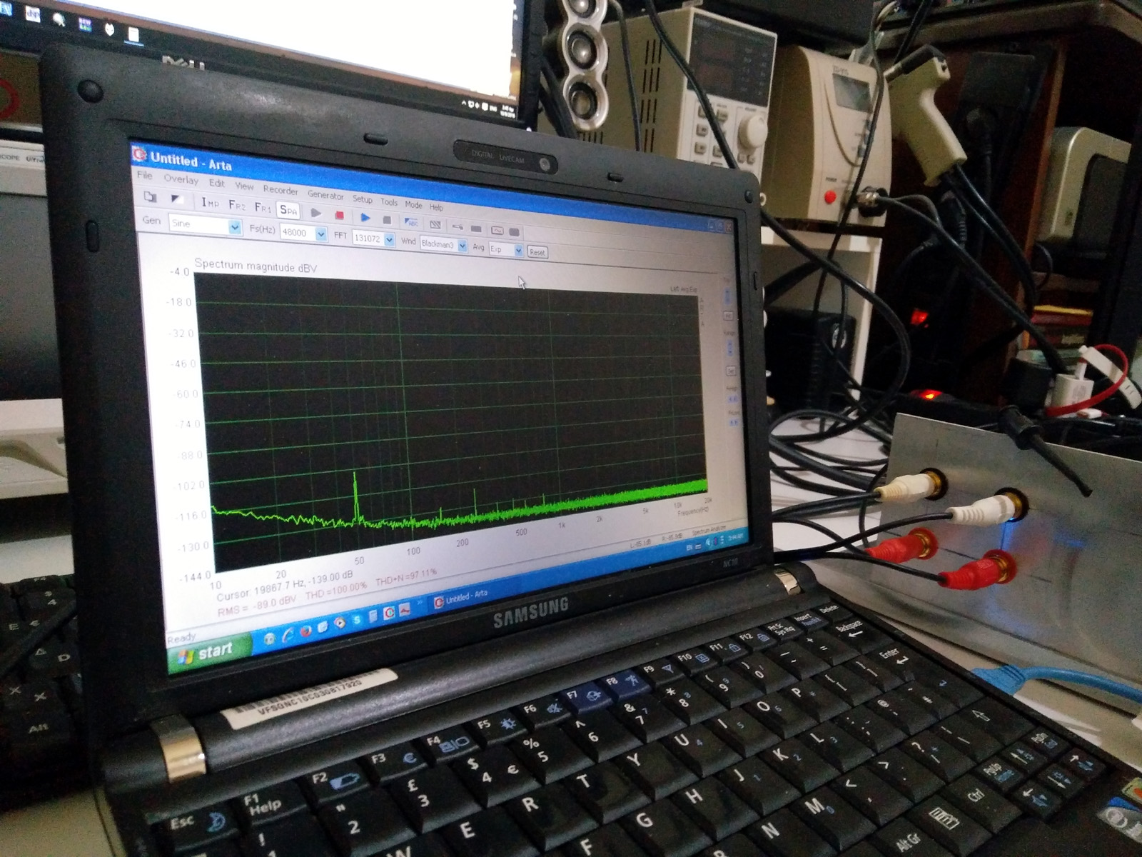

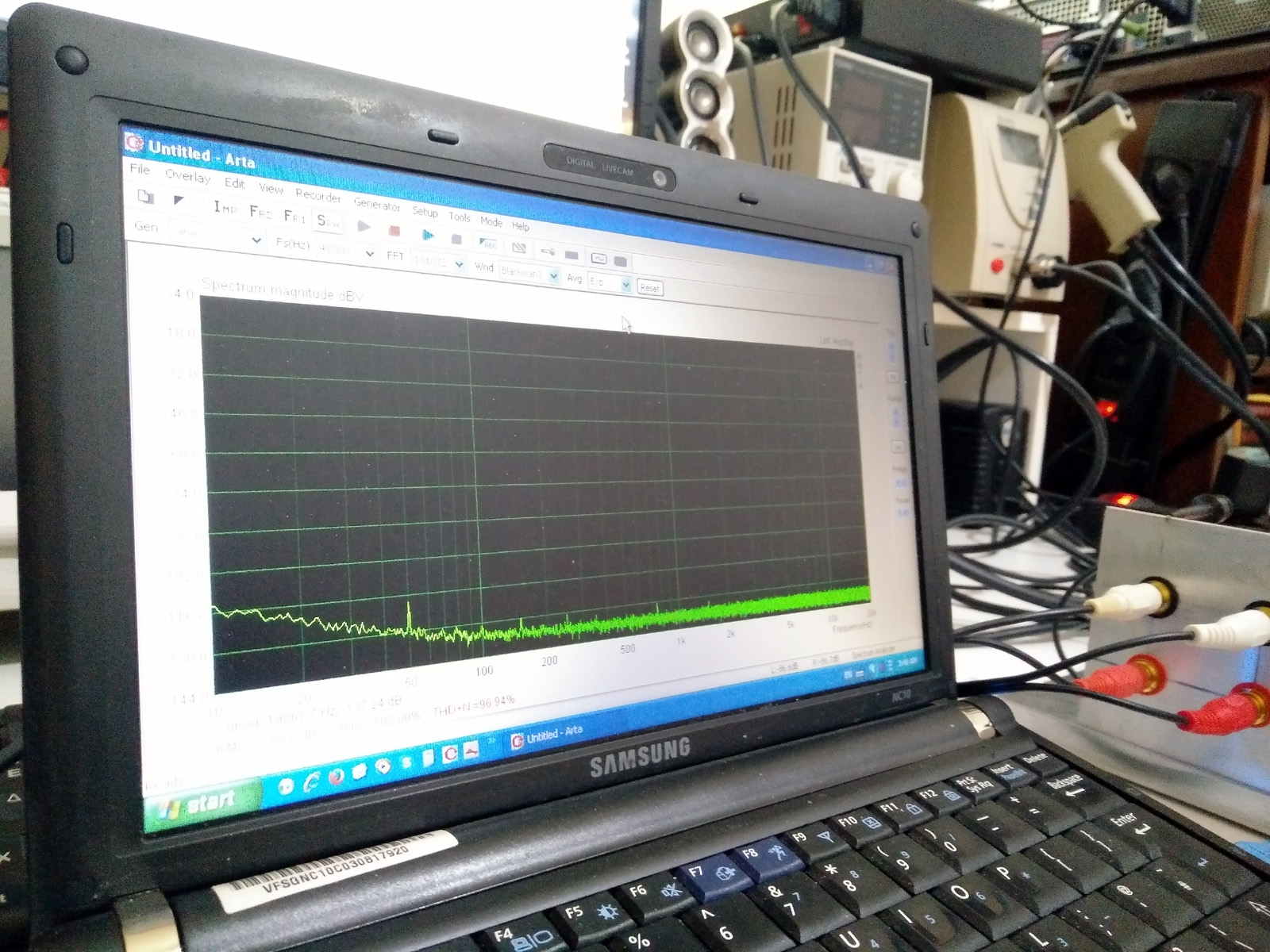

Hi Salas. So here the latest results for the noise floor. As suggested I took my measurement with volume at mid-course, net effect was to see a higher 60Hz component, but reduced higher harmonics. Input is grounded.
Red trace is with case fully enclosed, Green trace is with volume pot ground pins connected to frame through a 10R resistor, it is slightly lower, but still is the better result ever I had. Now the noise floor is at -97dBV, instead of -95dB when I started.
Compare to your own measurement, I can see your using a laptop, probably running on battery. My own CLIO card is inside a PC, its power supply running off an insulated power transformer, so it is probably collecting nasty RF noise that reflects into my measurements. It is still one of the best results I had so far with my test setup.

Now you added the pot's noise as a voltage divider's impedance hum pick up point. Which is representative of how we use the preamp. Integrated full audio band SNR number is one thing but your 60Hz hum band is very low at -114dBV. I did not understand if the green trace was also a closed case measurement again? Why you run a low 16384 FFT? Higher is better for noise. Also, select log than octave smoothing frequency axis mode if there is option. So to can see little spikes better.
Yes my take was better because the transformers were away from the metal frame located behind the DCSTB and the laptop was on battery but the power cables nearby on the bench were not that benign. The 50 Hz hum spike could easily jump to higher than yours if I wouldn't mains earth the preamp's test frame. See before and after clipping the earth lead pics. So your build has done very well for having mains wiring and big trafos crammed inside a single tight box.

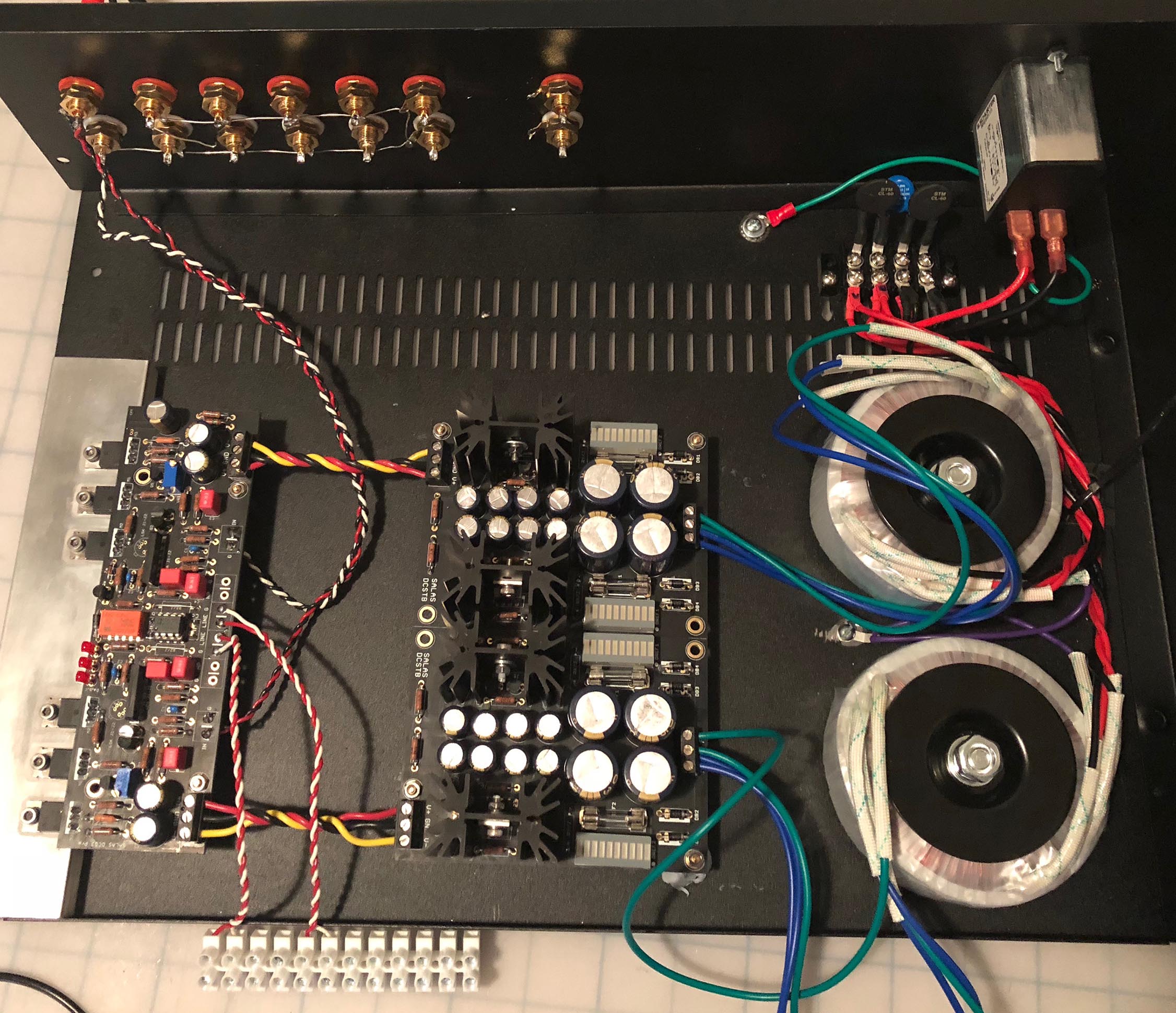

Hi everybody,
I’m getting there—slowly, but still having fun!
Here are my numbers so far.
DV voltage at dual mono PSUs, unloaded (sorry, forgot to write down loaded but I checked before installing the chip and they were couple tenths of a volt lower than unloaded).
+17.37Vdc
-17.47Vdc
+17.18Vdc
-17.30Vdc
Bias across R10(12R)s on DCG3 PCBs::
99.5mA
98.8mA
DC offset, inputs shorted, with opamp chip, fluctuating between:
-0.04 to -0.09mV
0 to +0.07mV
Do you guys think those numbers are good enough or should I do some tweaking?
I’m attaching a photo of my WIP setup so far. Once I put it all in the chassis, I’ll add an i-select board.
As always, I’m very grateful for all your helpful posts along the way.
Dan

Hi
Your numbers are really good. Check the heat for maybe opting for the high bias setting? Or for something in between with 9.1R or 10R? I see a big box.
One last thing out of curiosity, by watching that only the black DVM probe is used on ground pads, check the channels output offset polarity again.
