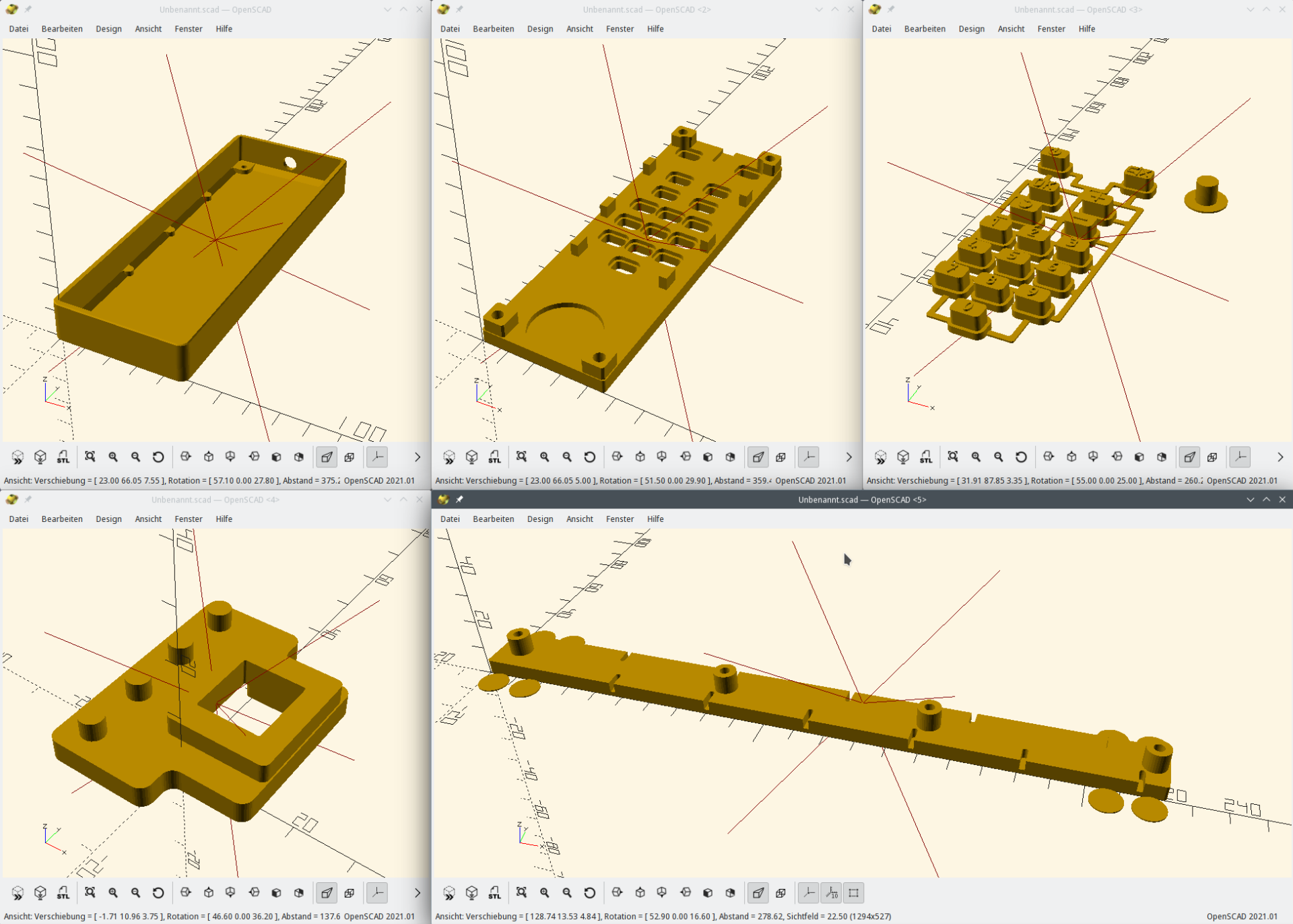

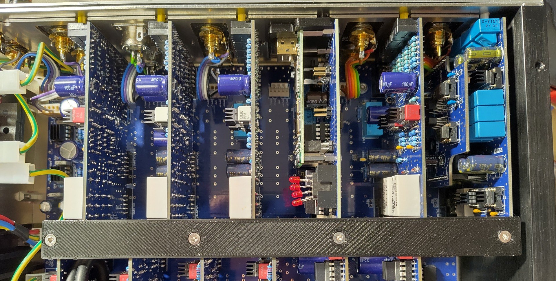

Some 3D printed parts ...
Remote control case parts rc_bottom.stl, rc_top.btl, rc_buttons.stl (from left to right.
Below USB DAC to backplate holder, input/output modules card holder.

... you want a clear definition I see 😉
From OpenSCAD website/wiki:
  • OpenSCAD is software for creating solid 3D CAD objects.
OpenSCAD Tutorial/Introduction
  • OpenSCAD is a solid 3D CAD modelling software that enables the creation of CAD models through a scripting file. The domain specific language designed for this purpose allows the creation of fully parametric models by combining and transforming available primitives as well as custom objects.
OpenSCAD User Manual:
  • OpenSCAD is a 2D/3D and solid modeling program that is based on a Functional programming language used to create models that are previewed on the screen, and rendered into 3D mesh which allows the model to be exported in a variety of 2D/3D file formats.

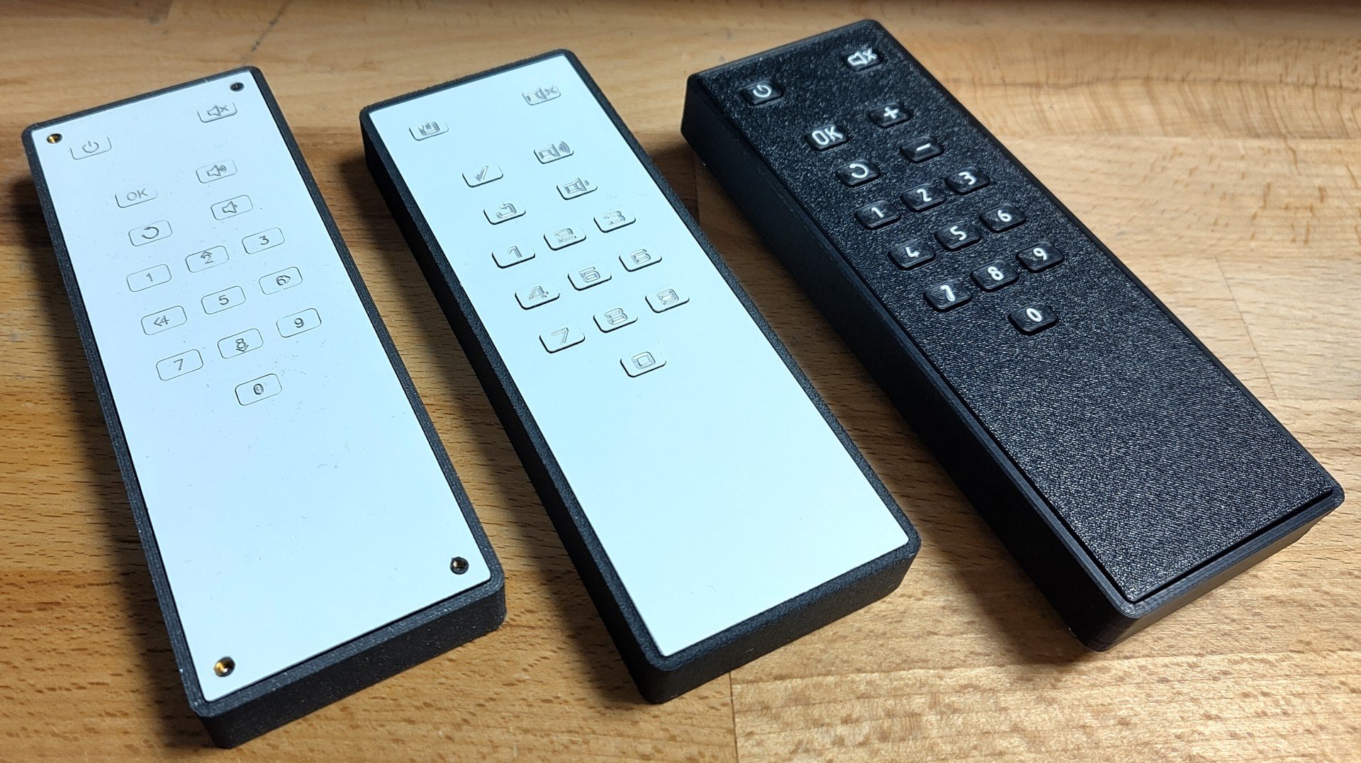

Remote control reloaded.
  • The left RC is the first working prototype (bottom 3D printed, top and buttons CNC milled from Alu Dibond; made at home)
  • The middle RC is the currently working RC for SA2022 (bottom MJF nylon external printed, top and buttons CNC milled from Alu Dibond made at home)
  • The right RC is a 100% 3D printing variant. (3D printed at home in ASA, buttons with filament change from black to white - works but optically not "high end")
Within 10m distance the RC is working reliable.
Have fun, Toni

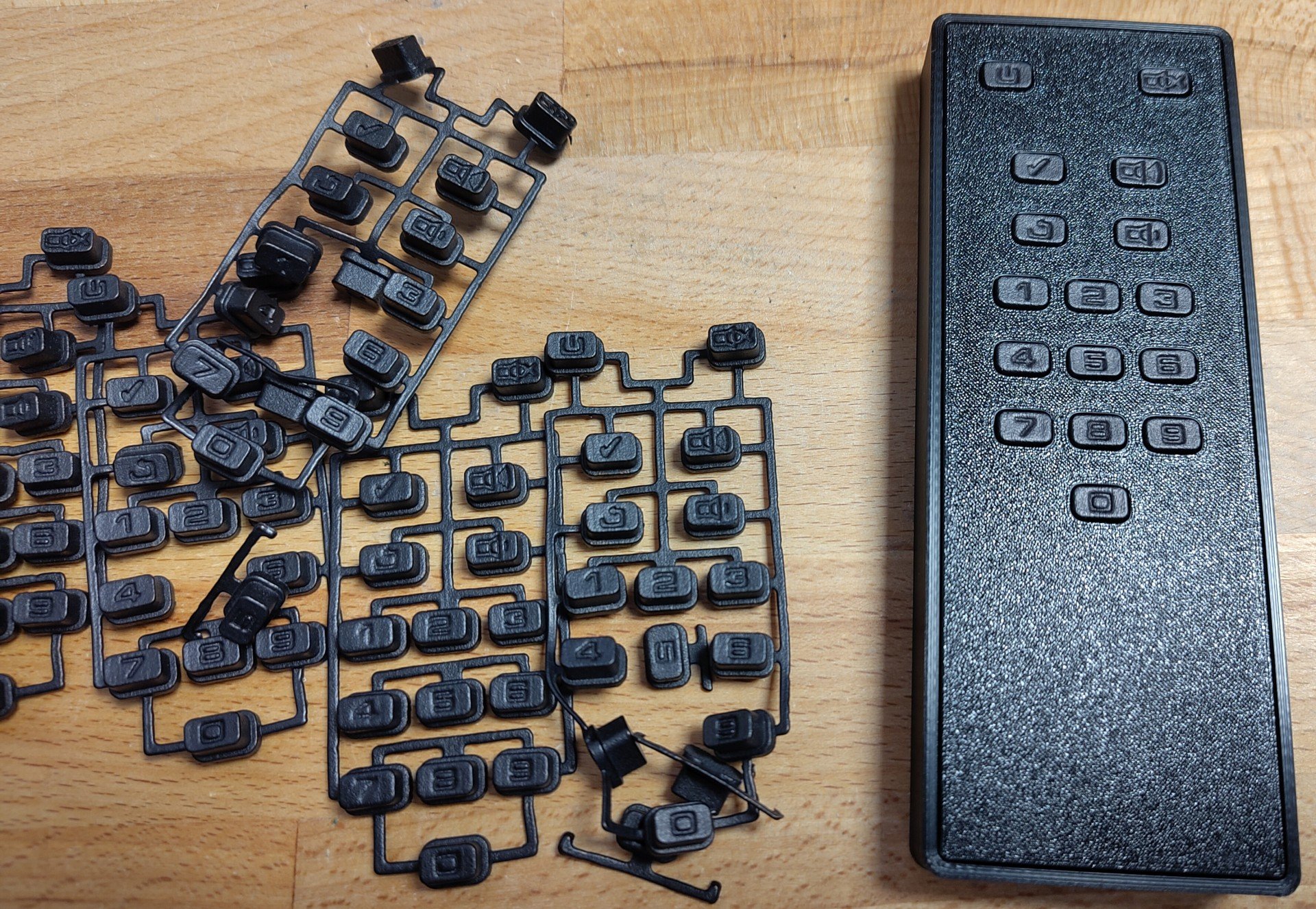

MJF printed buttons arrived...
The case top and bottom is 3d printed on my Prusa MK4S using black PETG.
Optically not high end, but works as expected.
The "buttons only" price for one remote (when buying 10 sets) is about EUR 16,-
Another method could be canibalize the buttons from an existing RC and redesign the top case.
Printing the case stl files quality depends on your 3D printer.
BR, Toni
