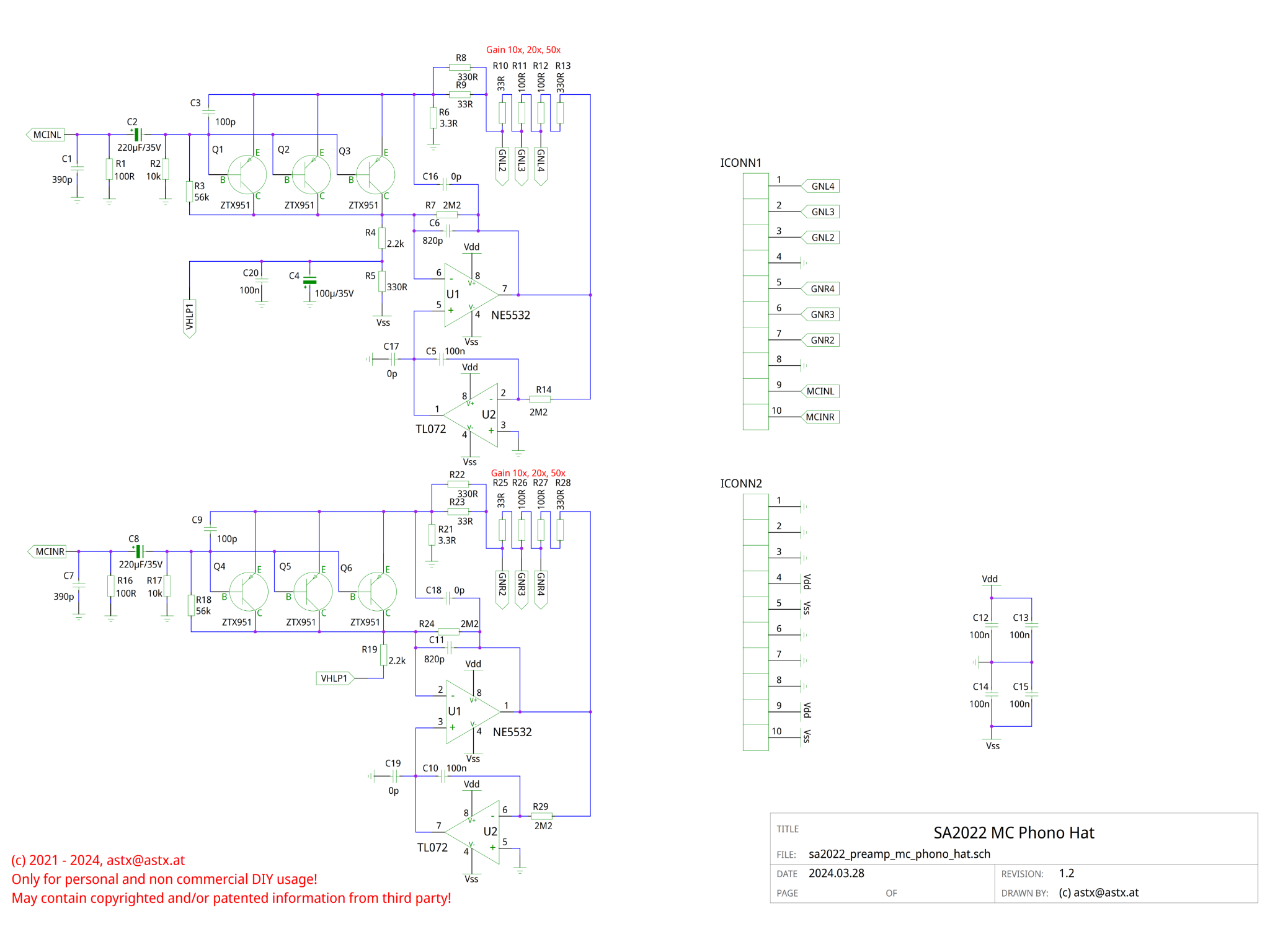

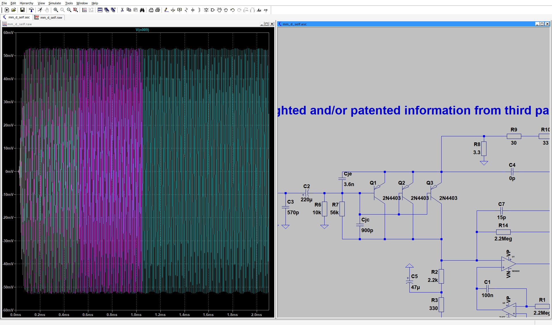

Dear Rick,
the oscillations (~ 250kHz) can be reproduced using a 40uH coil directly attached at input (the cartridge has 38uH and 40R dc resistance).
The oscillation can be reproduced also with a spice simulation. Will upload the sim today...

Voila! Found the easter eggs in the garden, now had time to zip the simulation files ...
If changing C7 from 470p to 15p the oscillation starts.
Removing one or two ZTX951 increases the oscillation frequency ... colpitts osc.?
Changing ZTX951 to 2N4403 the C7 / 15p - no oscillation.
Have fun with simulation, Toni

Tony, the rbb’ on the Zetex devices is very low (c 1.5 Ohms) so with a low emitter resistance and any small amount of base capacitance they may oscillate. I can’t find any rbb’ data on the 2N4403, but I suspect it is a bit higher than the Zetex devices and this is why it is not oscillating. One thing you could try is to put one or two ferrite beads in the base leads. Don’t use the solid SMD types as the end to end resistance will ruin your noise performance. You need to use the small hollow ones.

According to "The art of electronics - 3rd edition" p.501 the 2n4403 has Rbb 17 Ohms.
Have tried already using only one ZTX951 with ferrite bead - oscillates with same (relatively low) freq. I don't think that the ztx are oscillating - it is more the interaction of the high Cjc/Cje to the input. The opamp possible interacts with the MC cartridge on input (Cartridge + input capacitor are a form of LC circuit) via the relatively high Cje/Cjc of 3 paralleled ZTX951 (3*1.2n ~ 3.6n/3*290 ~ 900p). Using 2N4403 and adding the capacitors as shown in the picture provokes the same oscillation as ZTX951 ...
Colpitts?
Colpitts?

Yes, almost certainly a Colpitts oscillator. Just check that the 2N4403 isn’t oscillating at HF. You might be able to quell the oscillation by loading the base to 0V with a 1-2nF cap. Since the source resistance (MC) is low, this will hardly affect freq response. I have not played with the Self circuit - it’s quite interesting.
This tip is working at least in simulation. Changing the 470p cap on input to a 4.7n stops oscillation.
Square wave response has a hefty overshoot but well damped. In combination with C7 e.g. 100p the THD performance is still single ppm up to 20k

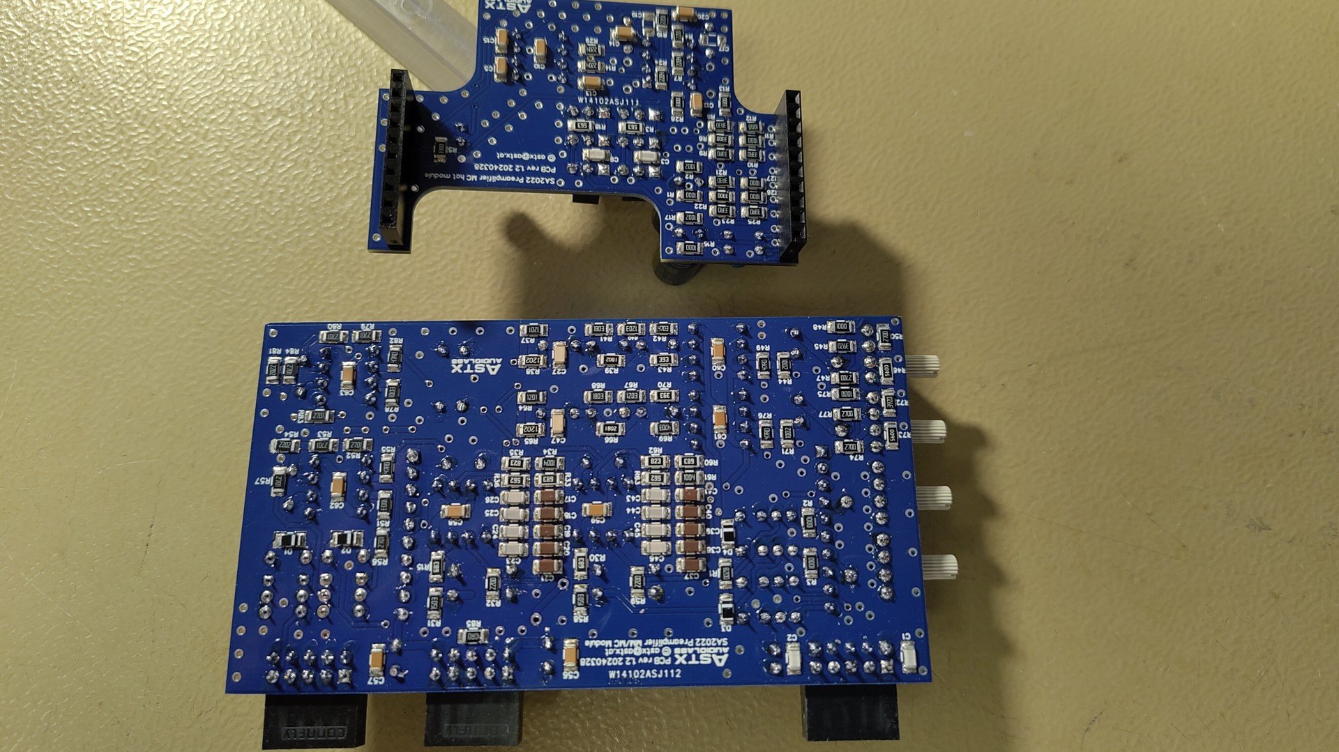

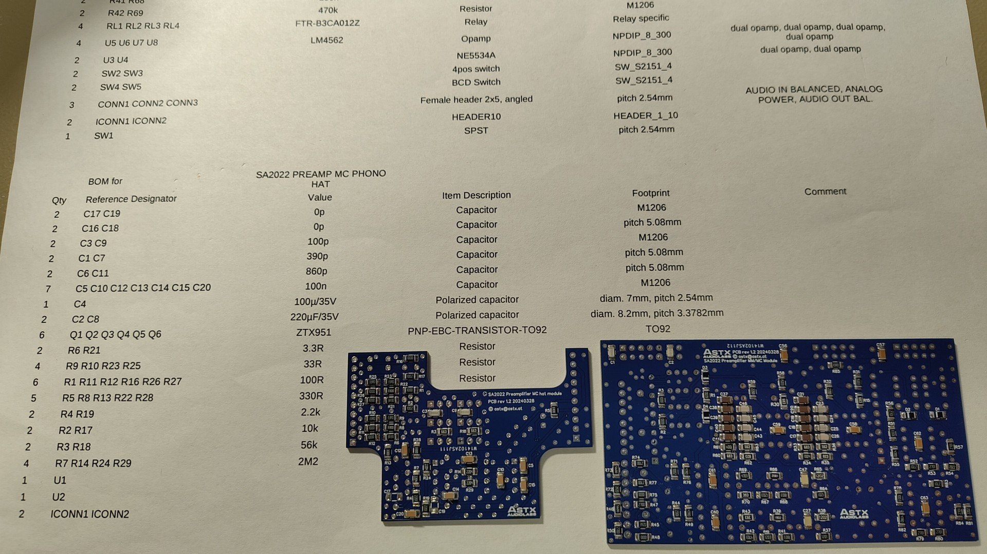

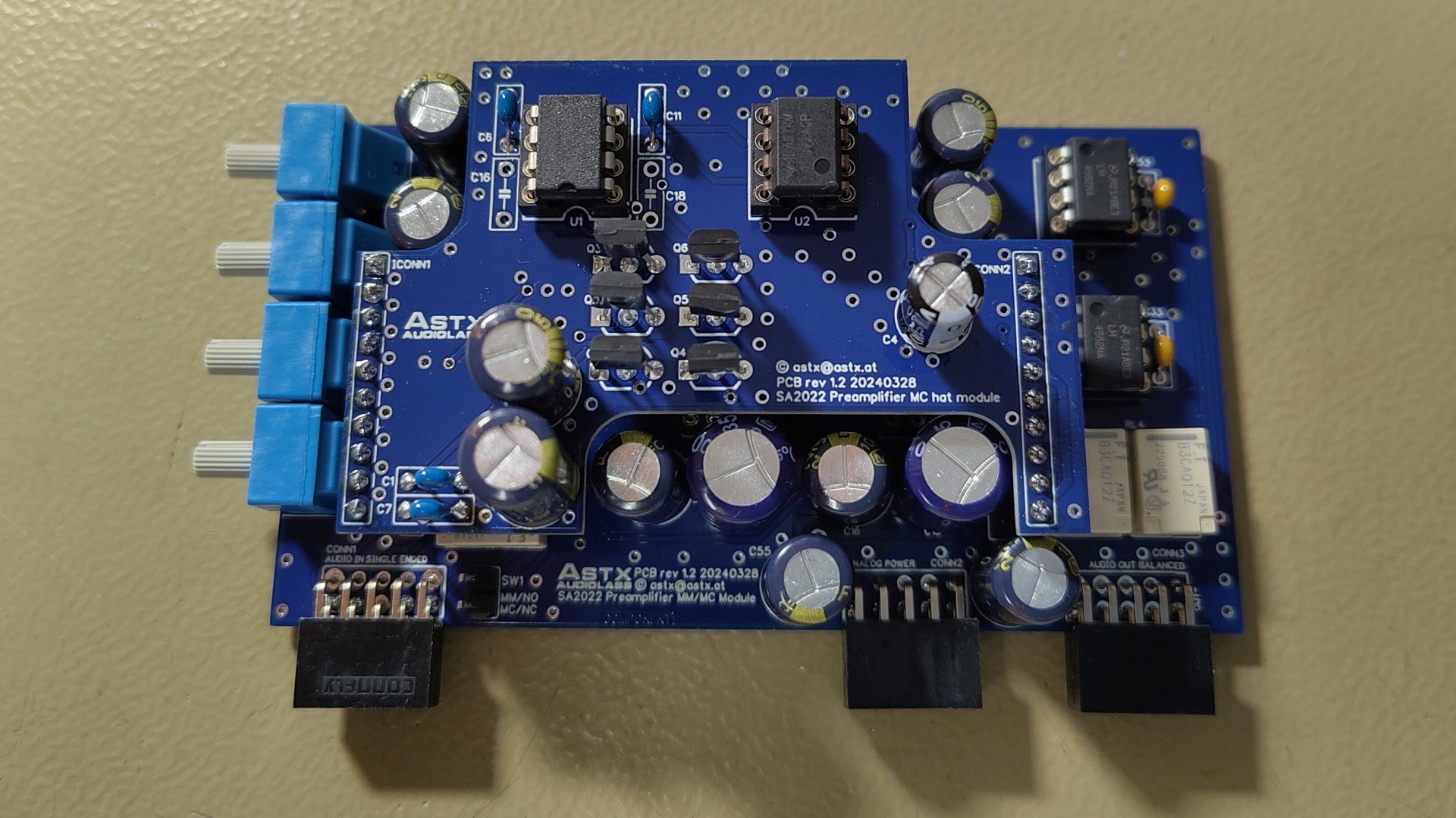

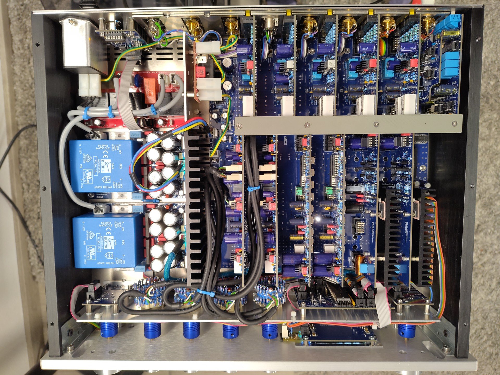

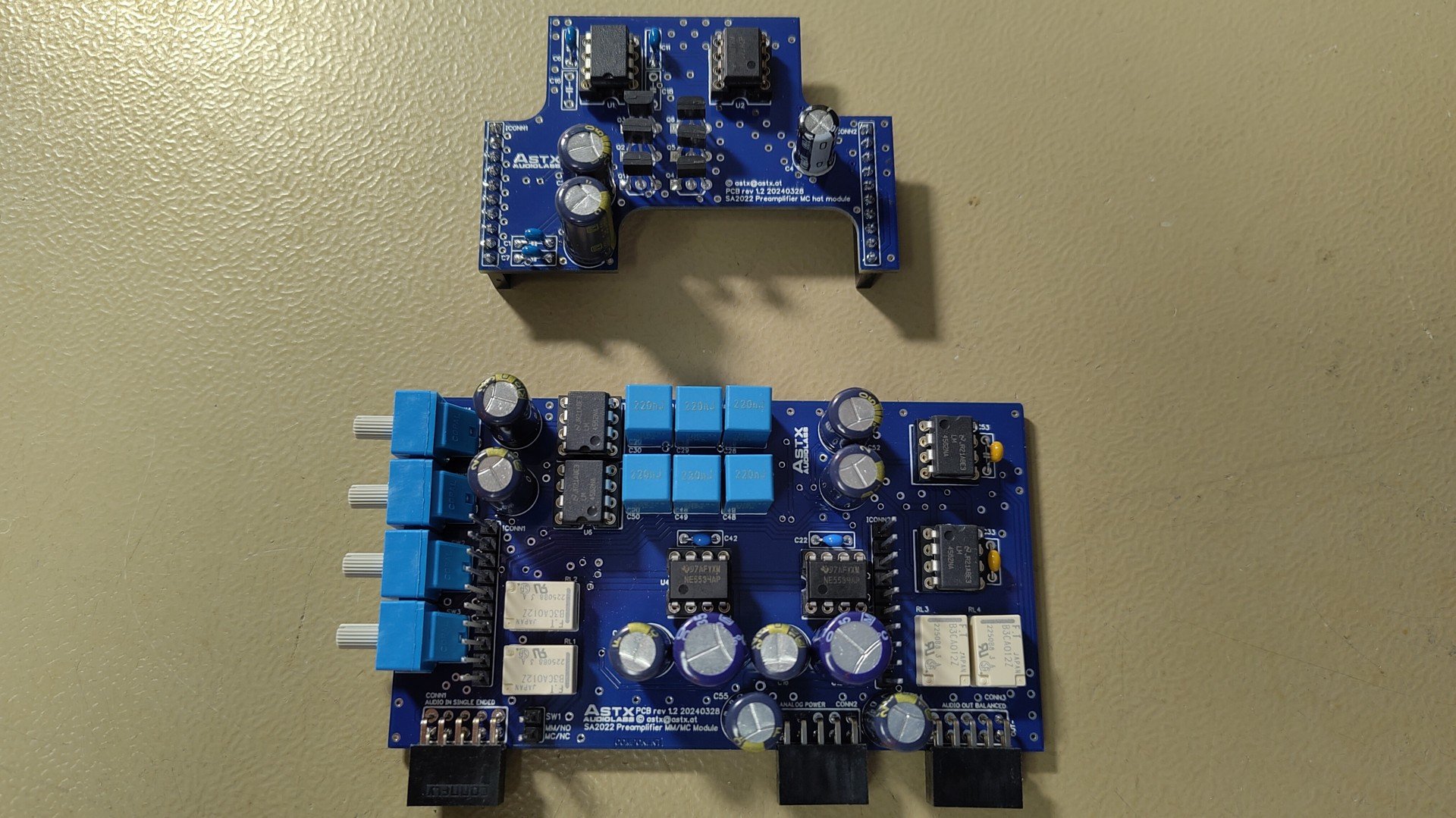

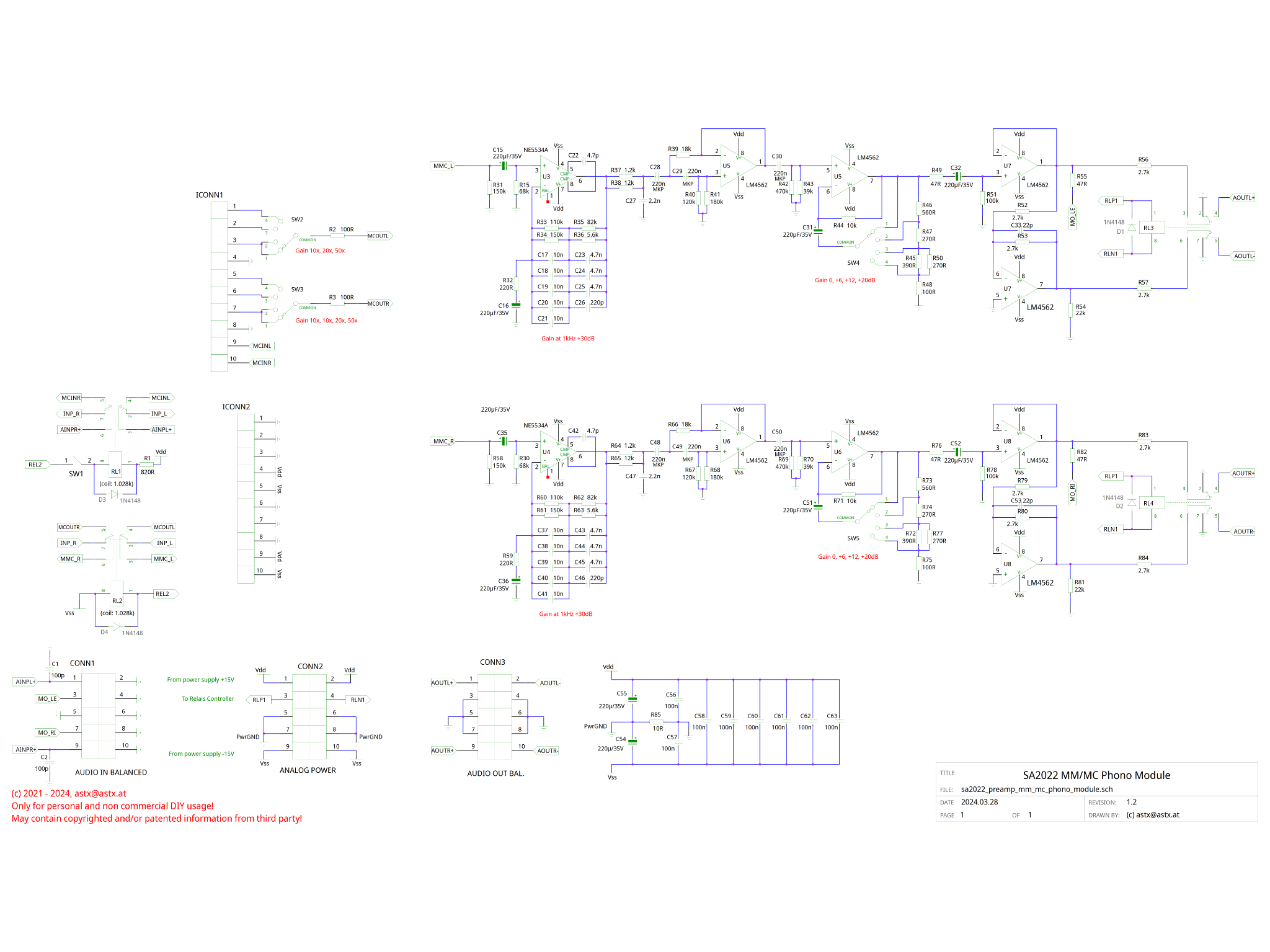

... instead of weeks I have needed months to finish the Moving Magnet / Moving Coil Modules. Sorry for the delay ...
Attached the corrected schematics. (MM part is mostly the same as be4). The ideas and schematics are mostly from D. Self's excellent book "Electronics for Vinyl". The MC input uses 3 pairs of ZTX951 low Rb transistors. This required some feedback modification to reduce the gain above 200kHz to avoid oscillation interaction with the MC input coil.
Maybe I have time for some measurements. The first hearing tests results: noise free very fine resolution of the vinyl sound. no noise and no hum with open inputs.
The gain of the MC input can be selected 10x, 20x and 50x times. (with the lower 2 blue selectors seen on the 2nd picture)
The gain of the MM module at 1kHz is set to 30dB and the output of the MM stage can be further set to 0dB, +6dB, +12dB and +20dB (with the upper 2 blue selectors seen on the 2nd picture)
Upcoming input module project: a USB audio I2S DAC using amanero USB/I2S module and PCM1794a.
Have fun, Toni
