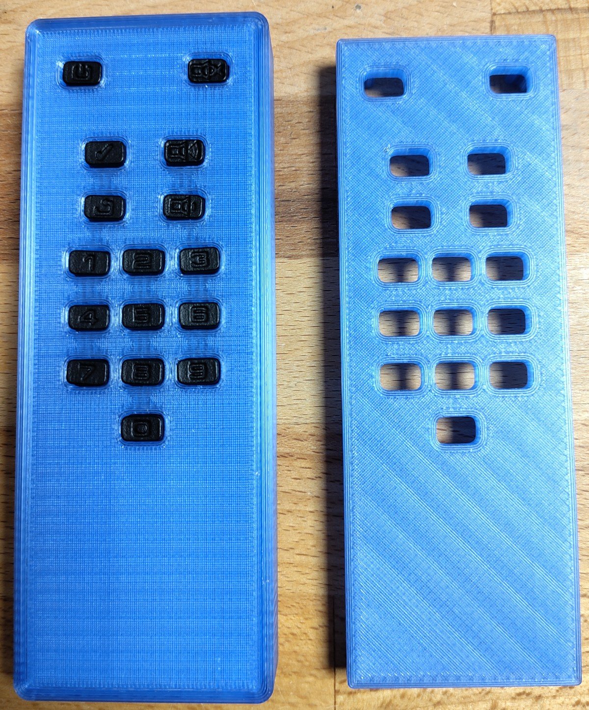

It makes big a difference, if I rotate the 3d stl file 45 degree on z-axis (left) for printing ...
BTW: Have ordered some Aluminium SLM printed buttons - another 2 weeks waiting ...

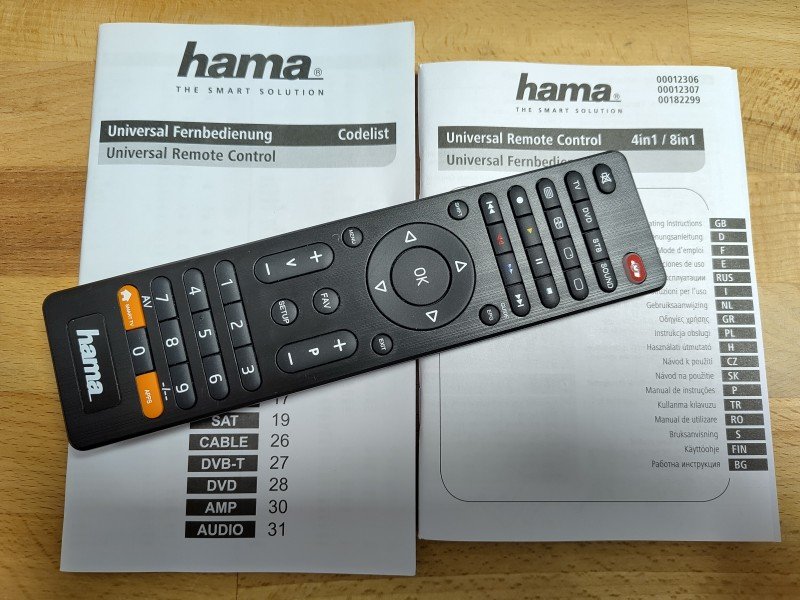

Today I have tested some universal remote control units. Many of them allow to configure NEC protocol. So buying a universal programmable RC could be an option. As I'm the programmer of the SA2022 controller software I could implement a configurable table for different NEC protocol based RC's. Stay tuned, more to come.
Have fun, Toni
P.S.: I still prefer a custom RC. The costs of the project itself is killing a standard DIY budget. But keeping in mind that e.g. the newest Accuphase Modular Preamp C-3900 is far beyond 25 kEUR you can build the SA2022 preamp and add either the SA2014 or the SA2021-NCH power amplifier several times, buy a CNC machine, let a fab produce you a prototype of your case ... YOU CAN DIY!
Just a quick note (black Friday deal): The required 5 transformers are available at Conrad (Germany), likely at the lowest price. However they also have 20EUR off when ordering above 170EUR, which also is coming with free shipping; so that might be a good idea to buy 2 (mini group buy) sets for a really good price.
(I as well received a 25EUR off above 170EUR coupon via email, but that might be unique or attached to my account, so I won't post it. Might be worth to check your emails...)
Honorable mention at Conrad: RTE24012 and PHAP3302B - might be cheaper elsewhere, but not available everywhere.
Note: Get the "B" type RECOMs, they are supposed to be less HF noisy than the "A" type.
Reactions: astx

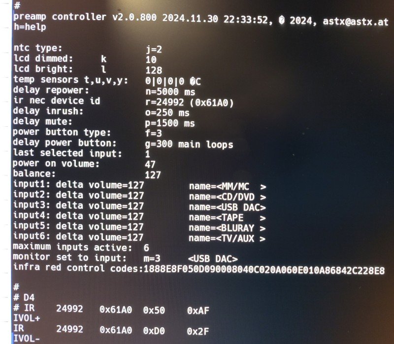

Have programmed a newer firmware release which allows you to use nearly every (extended) NEC remote control to be used.
E.g.: this ~ 10 EUR "Hama" universal RC programmed to use "TV - 5481" config works very good.
Help:
Code:
b       : reboot
c       : switch to configuration mode
d       : toggle debug
f       : select power button type (switch=1, push=2, push_save_state=3)
g       : delay power button. number of main loops
j       : temperature sensor type: 1=NTCLE100E3222 (2.2k), 2=NTCLE100E3103 (10k)
k       : set lcd dimmed contrast 0 - 255 (low to high)
l       : set lcd bright contrast 0 - 255 (low to high)
m       : set monitor output to input number e.g. from 1 to max. 8
r       : ir nec 16bit device id, default 43146 (0xA88A, 0-65535)
t,u,v,y : temperature sensor 1 - 4 trip values
                  (0=ignore; 1=use port like digital low for poweroff; 2-99 max. celsius)
n,o,p   : delay (repowering, inrush, mute) 1ms steps
i       : list configuration info
w       : save configuration to eeprom
q,x     : exit
remote commands:
F,N,S   : power off, on, current power status
RI      : get, set input e.g. RI=3
RM      : get, set monitor input RM=4
RV      : get, set volume e.g. RV=99 (range 0-151; -63.5dB to +12dB)
K,L,M   : get current mute status, set mute off, set mute on
T       : get temperatures
Use own NEC infrared ir codes:
        hex code array in this order: IR=[OK,MUTE,BACK,PWR,VOL_UP,VOL_DOWN,0,1,2,3,4,5,6,7,8,9,UP,DOWN,LEFT,RIGHT,MENU,EXIT] (22 hex values))
        e.g.: IR=0a0b0c0d0e0f00010203040506070809101112131415
        use this new ircodes with: IR1; return to default using IR0
Change input related settings - some examples:
IV4=127         : delta volume input 4, 127=0dB, 95=-16dB, 151=+12dB
IN1=AUX6        : rename input 1 to 'AUX6'
IM=8            : maximum active inputs
Using the remotes debug mode ("D4" <ENTER>) helps you to define the hex code array. See screenshot. Don't forget to enter a "w" and reboot with "b".
BR, Toni
BTW: The working hex string for this cheap IR device is: 1888E8F050D090008040C020A060E010A86842C228E8 (hexcode array in this order: IR=[OK,MUTE,BACK,PWR,VOL_UP,VOL_DOWN,0,1,2,3,4,5,6,7,8,9,UP,DOWN,LEFT,RIGHT,MENU,EXIT] (22 hex values))
