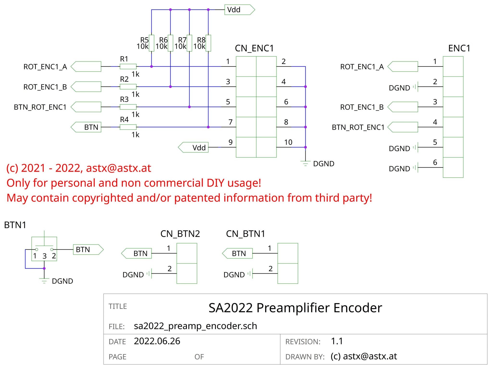

A long journey developing a high end analog preamplifier is going to come to an end. The parts mostly materialized on my table .
Many pcb's/components have been tested and are ready to be put into a nice case in the style of SA20XX amplifiers.
For me it was really time to develop a preamp - I have built so many SA20XX power amplifiers - but a preamplifier was still missing - till now!
Have fun, Toni

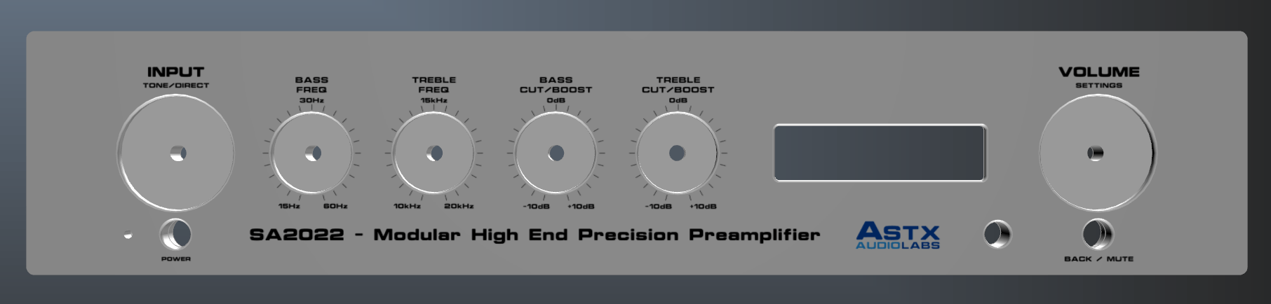

- 2022.07.22: Knob background using lightblue transparent acryl, final front design

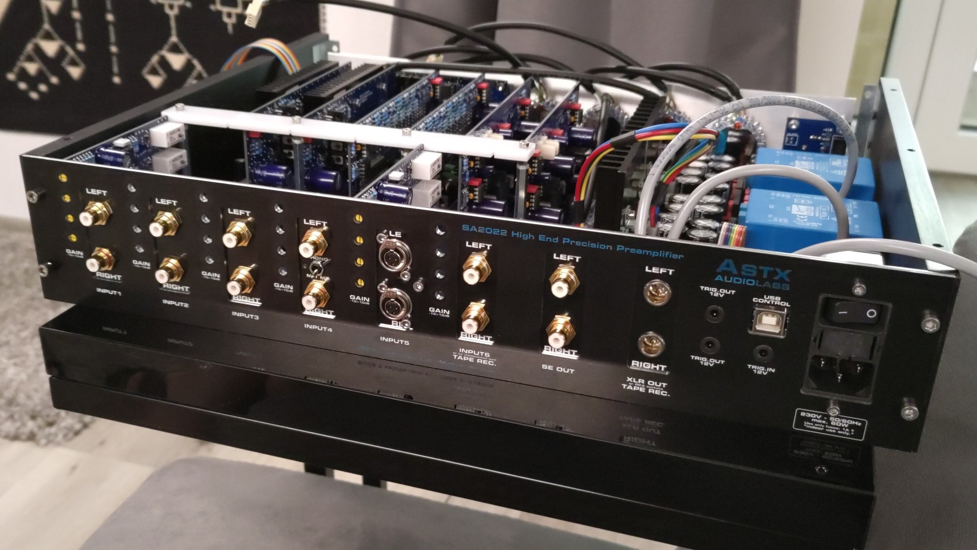

- 2022.07.05: My prototype build

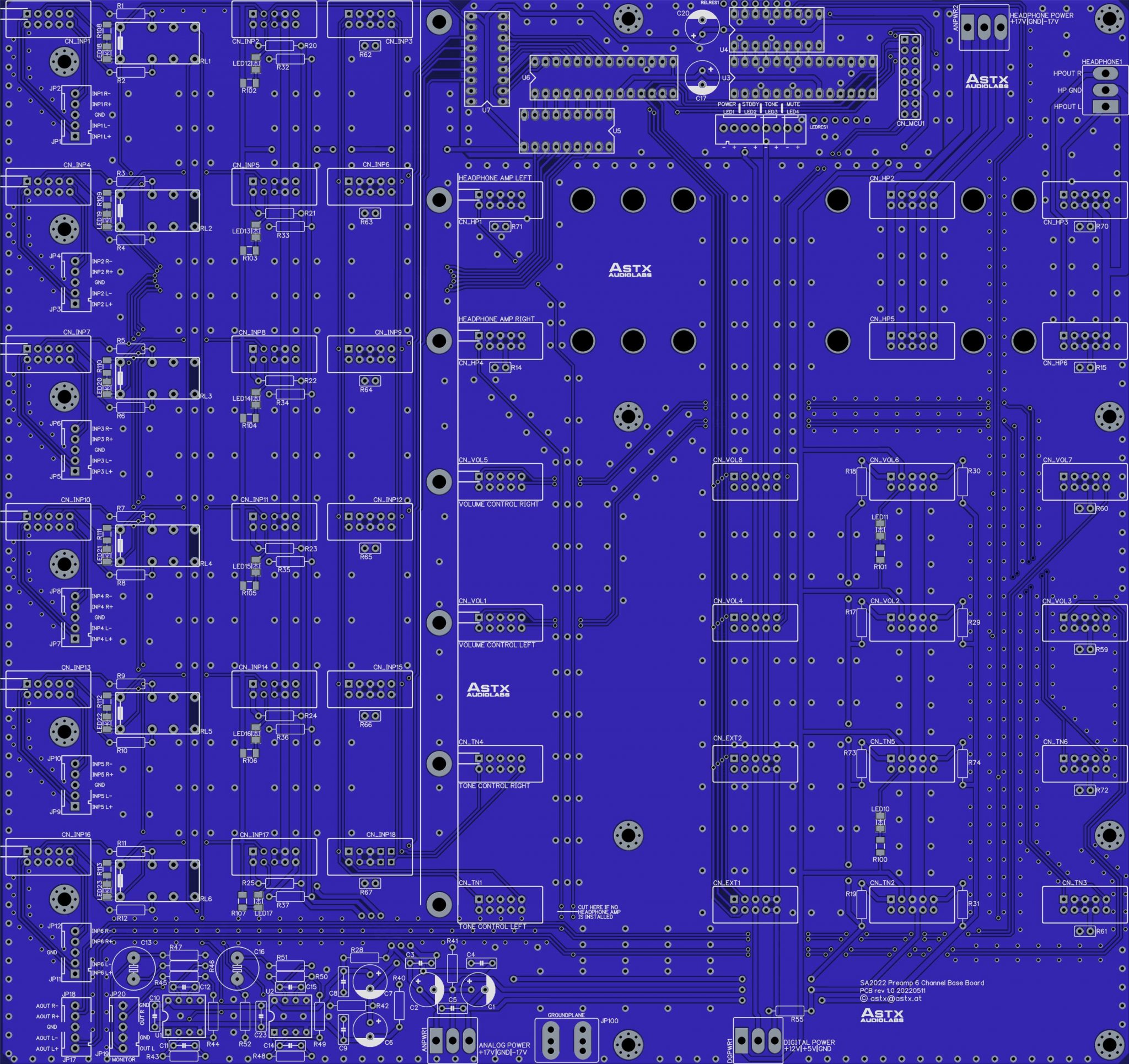

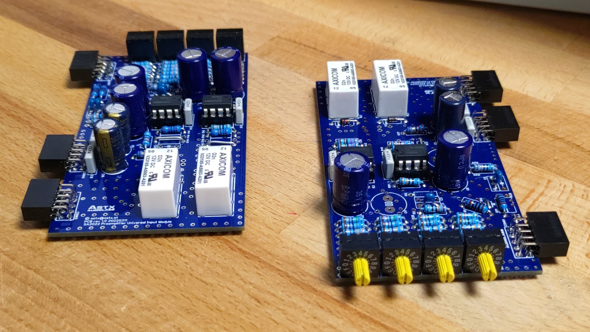

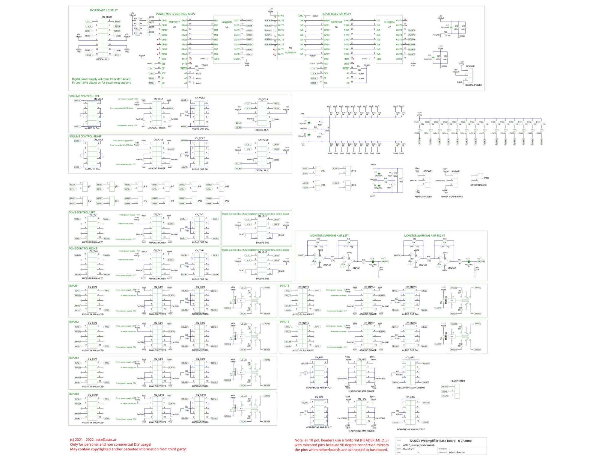

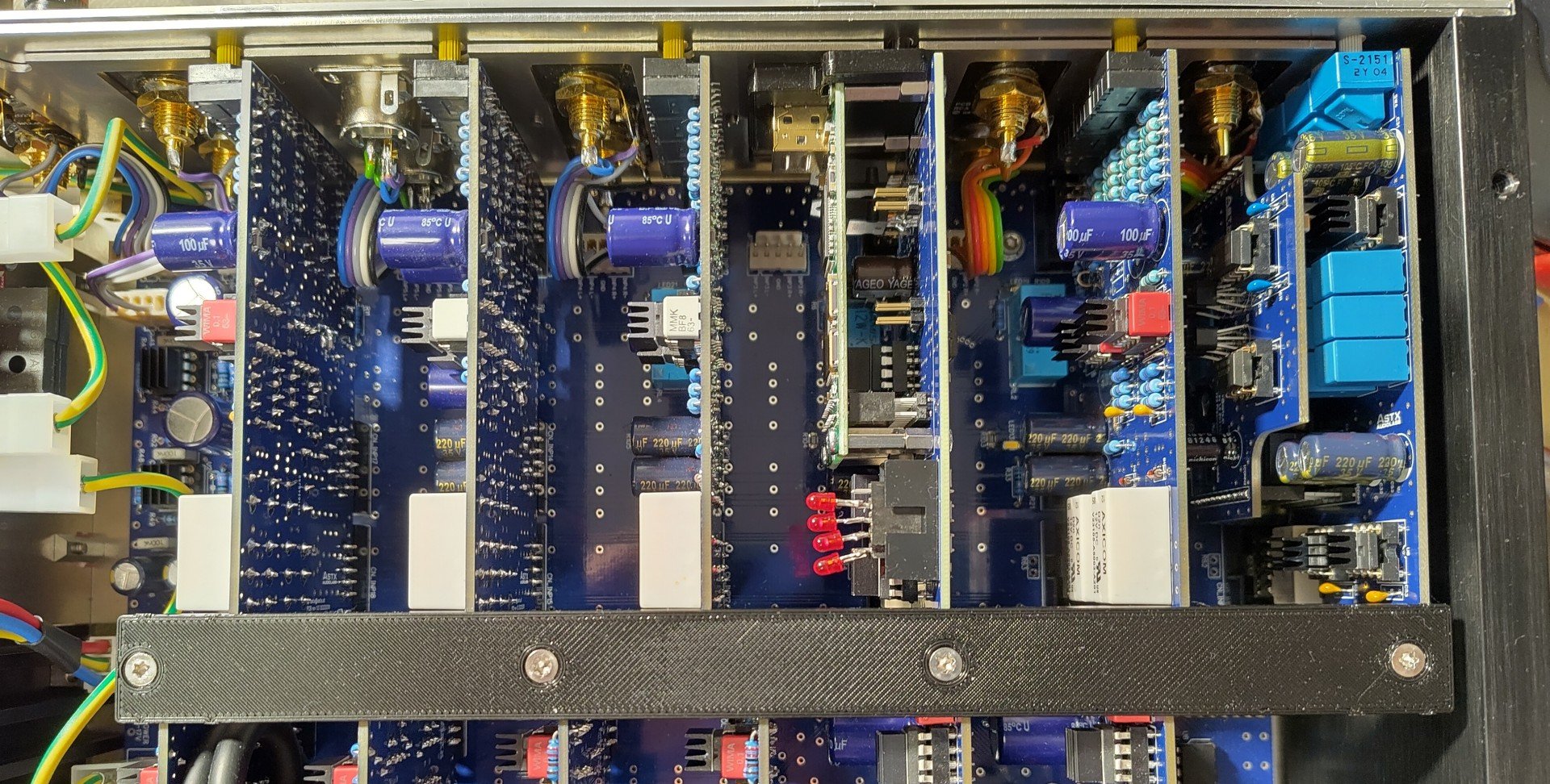

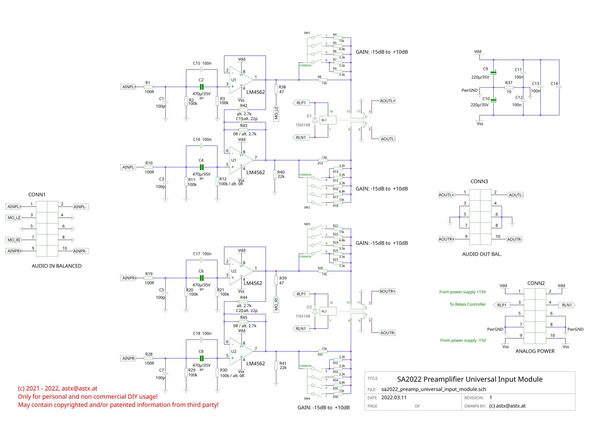

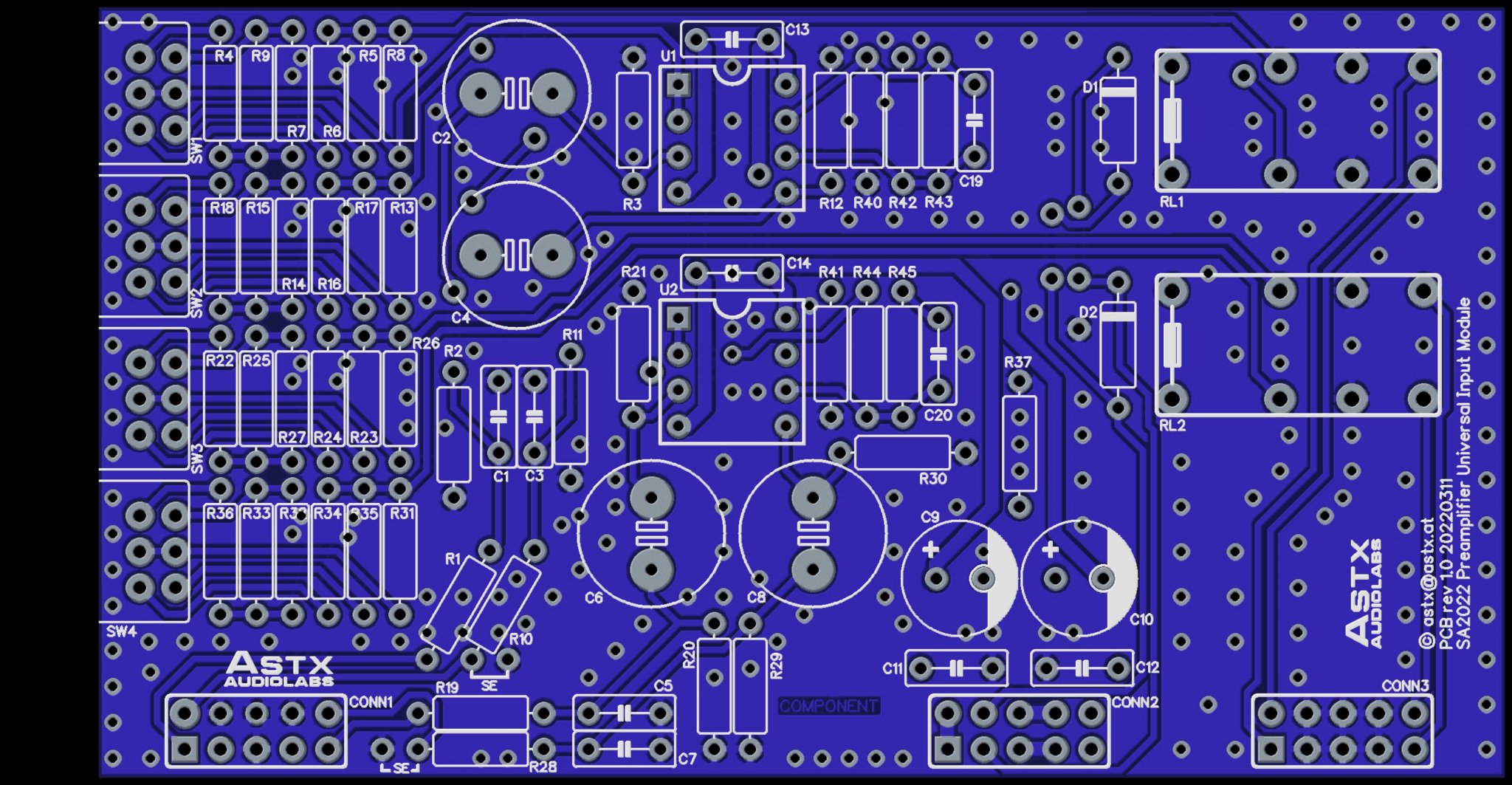

The baseboard includes 6 slots for stereo input channels. It can be populated with different input card variants. Currently a universal SE/balanced stereo input card with selectable gain from -15/+10dB is available. A MM and MC phono input card is in development - pcb only - the design will be from D. Self.

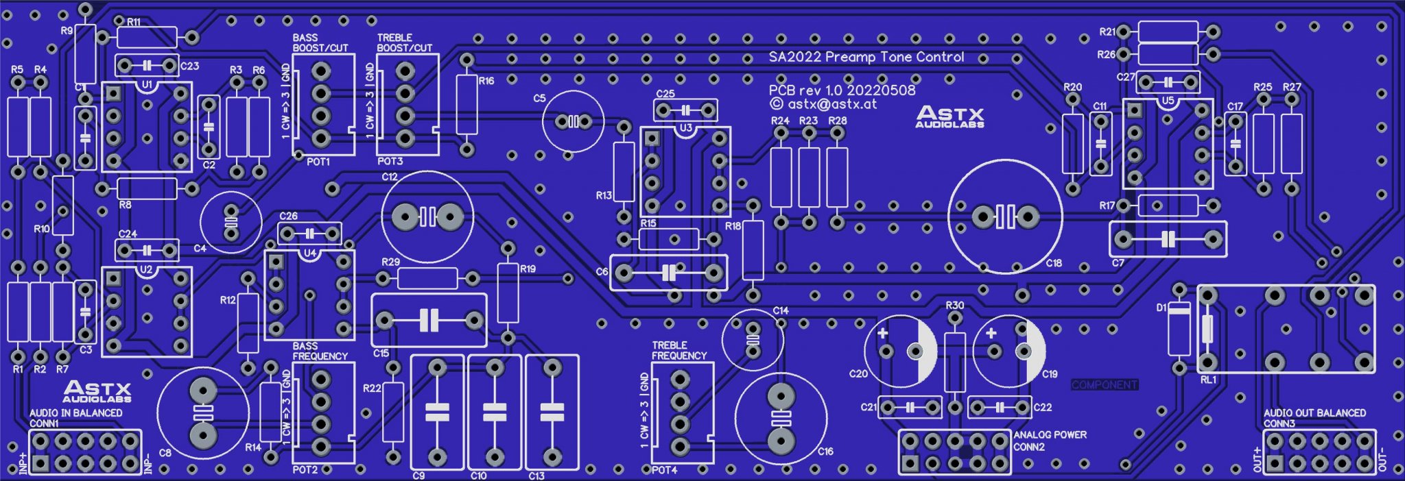

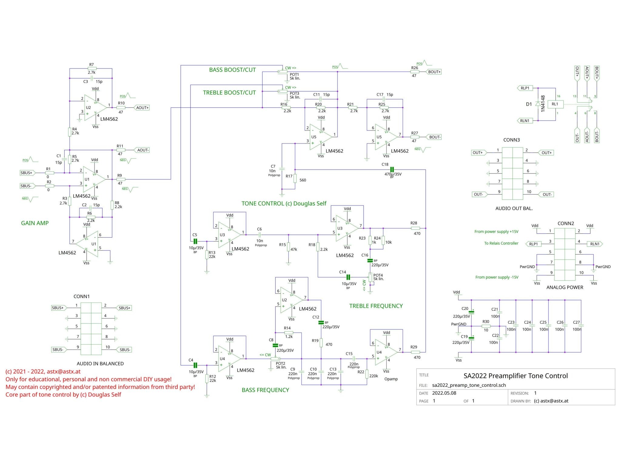

2 slots are for tone control

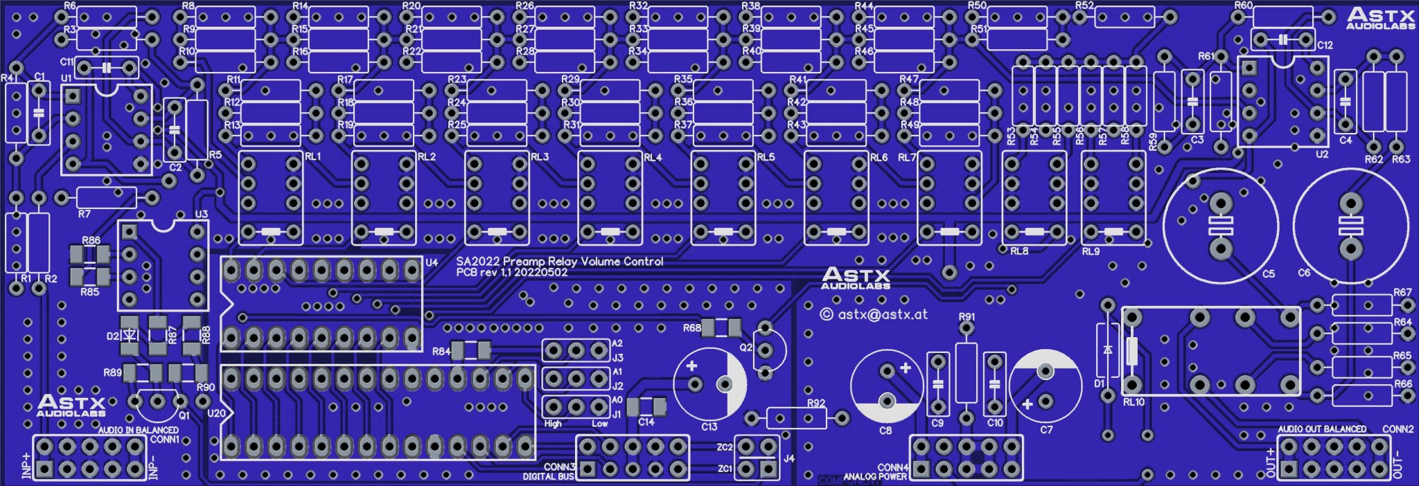

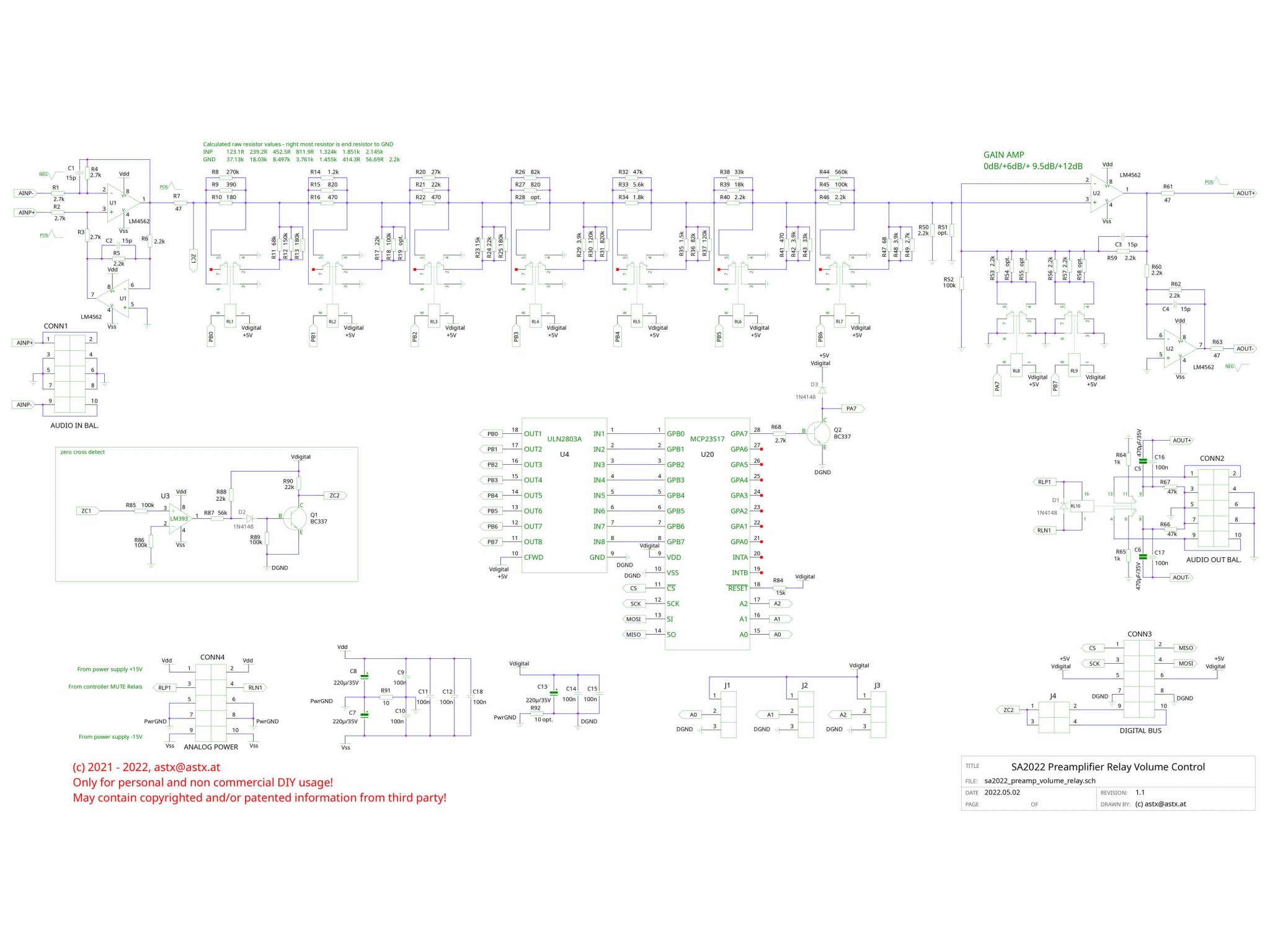

2 slots are for relay based volume control -63.5dB to +12dB in exactly 0.5dB steps (+/-1%)

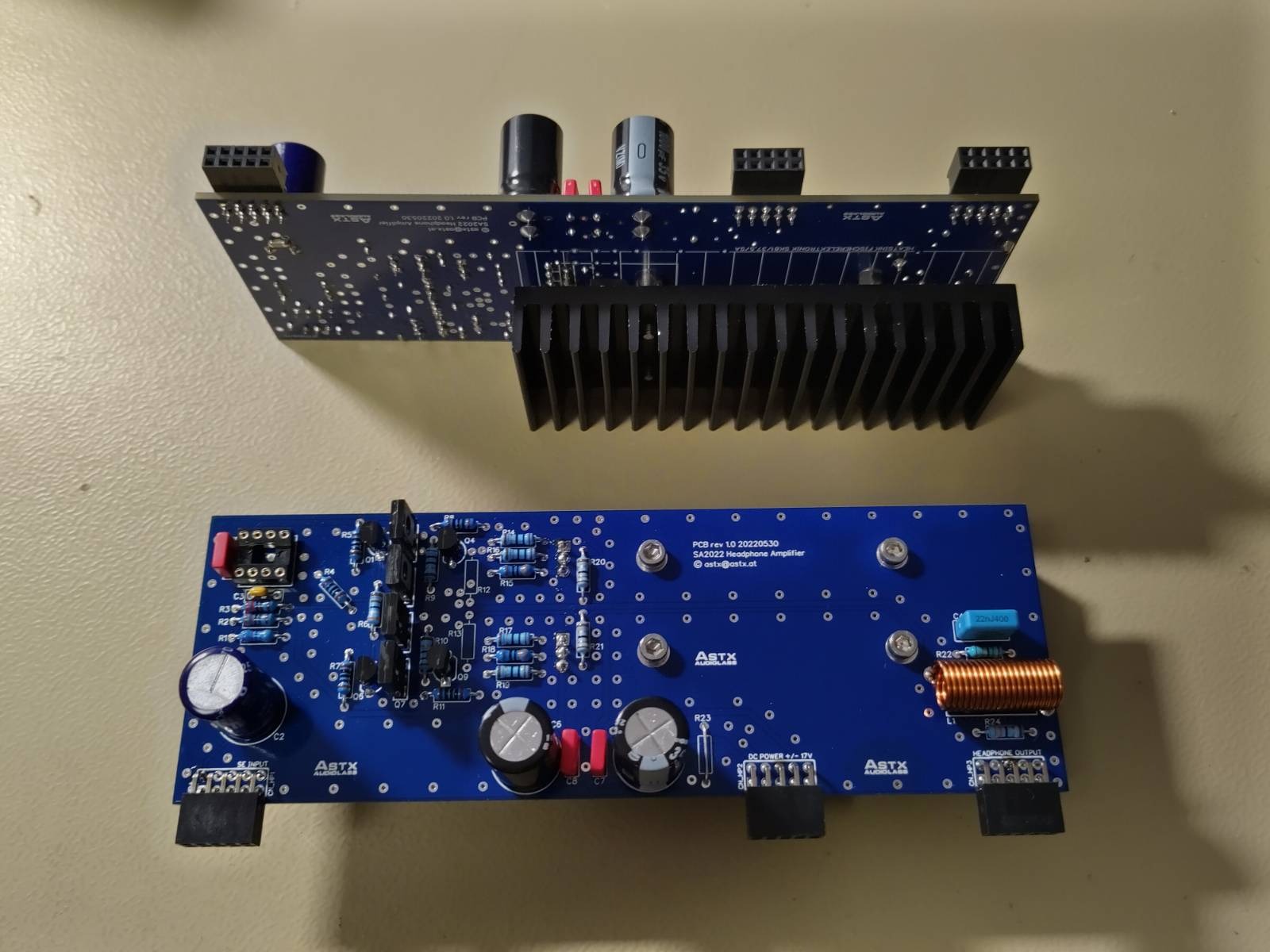

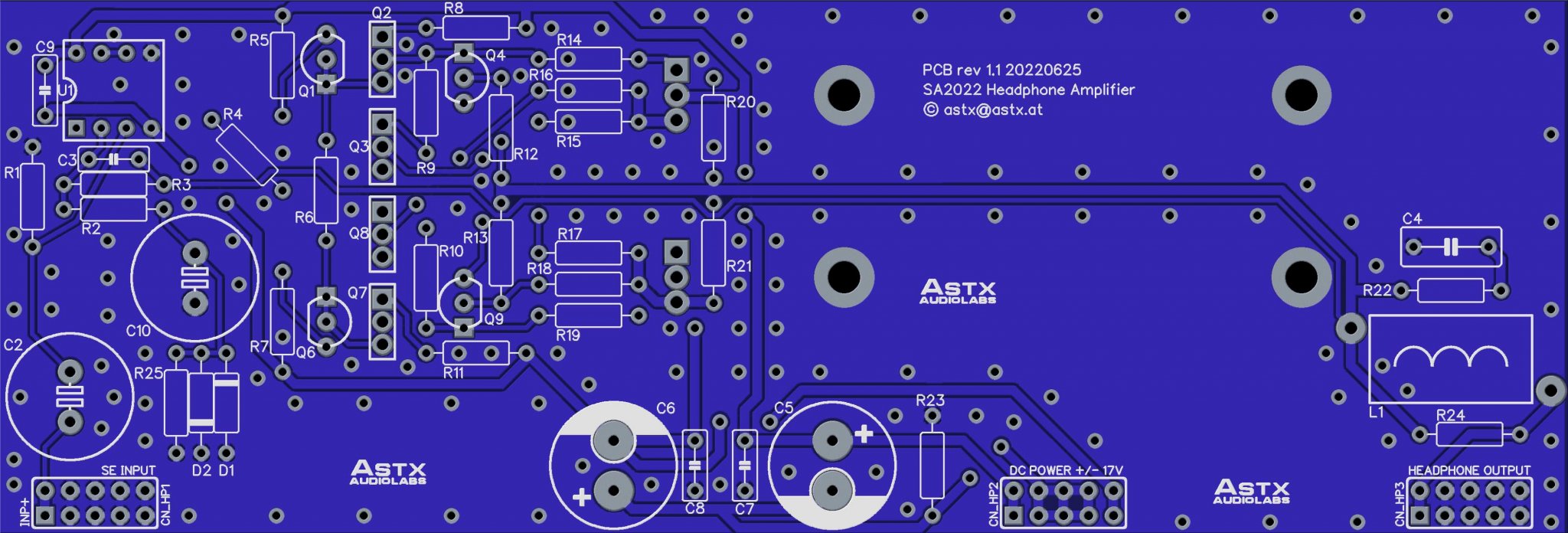

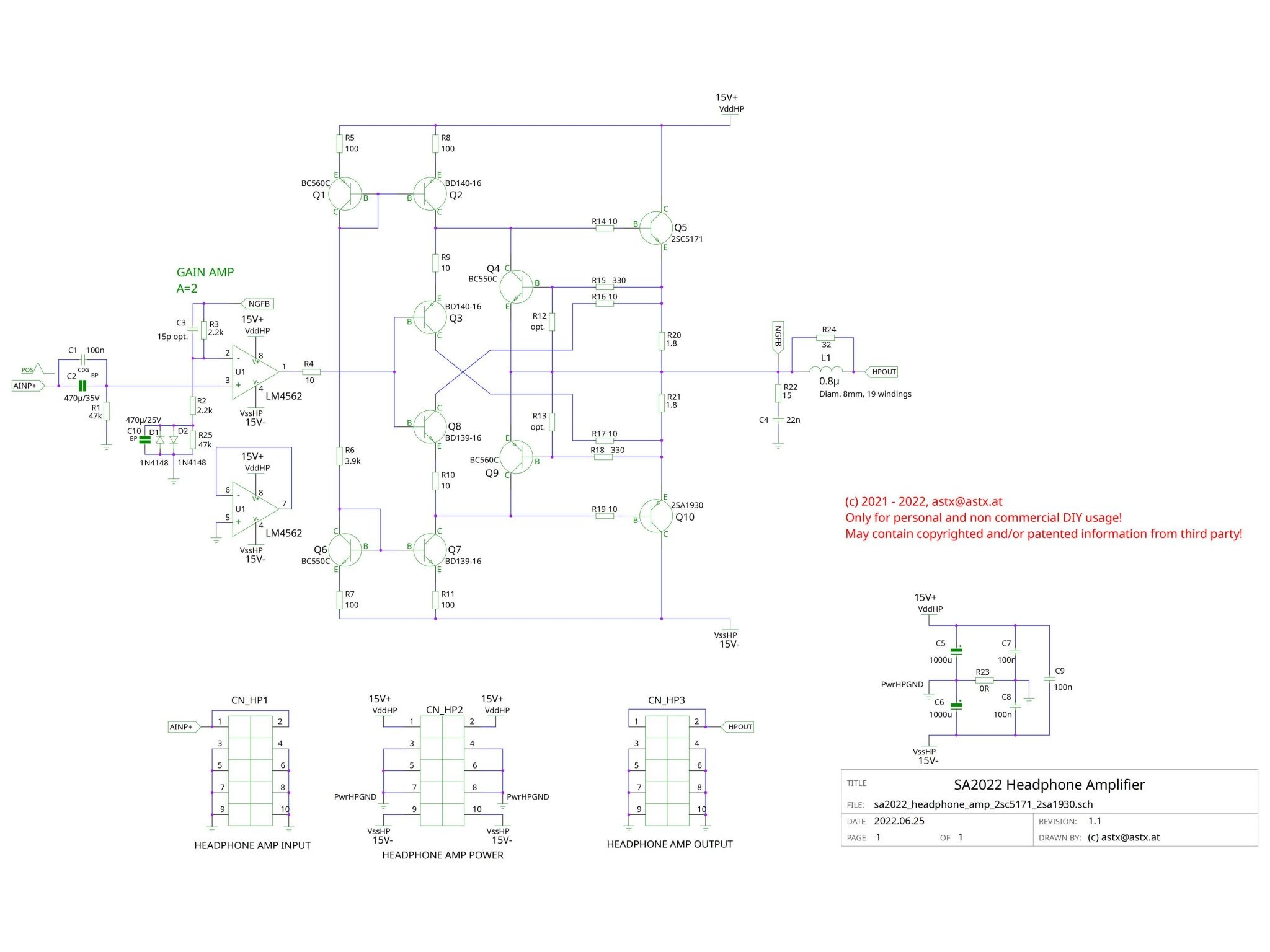

2 slots are for the high end diamond buffer headphone amp.
Included is a monitor output - this can be used e.g. as "tape record" output

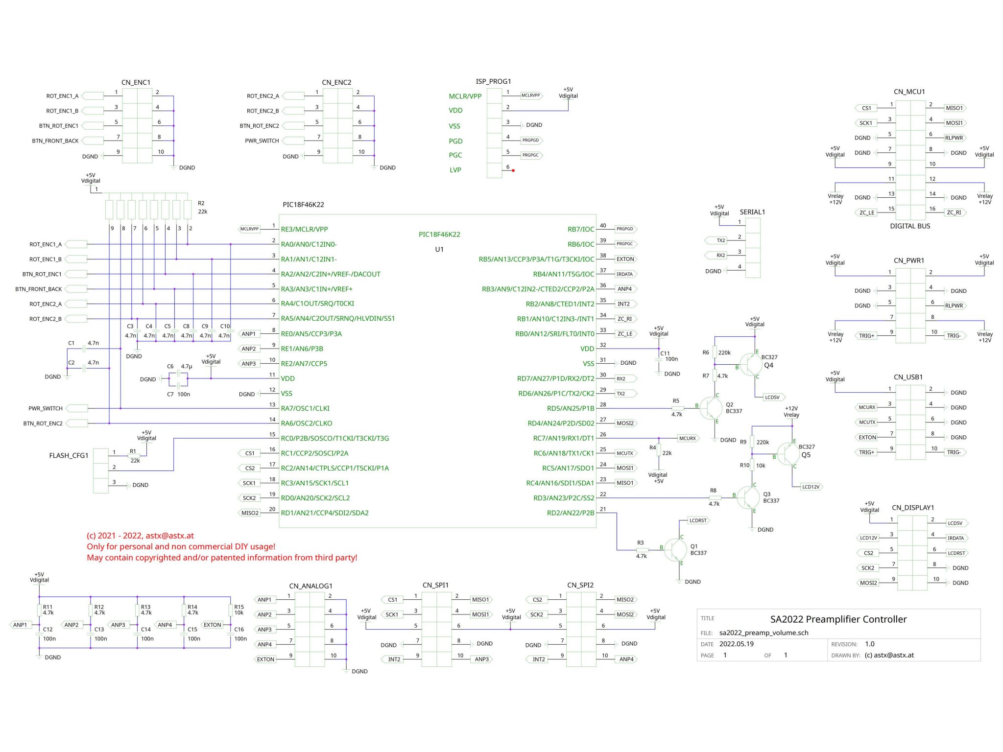

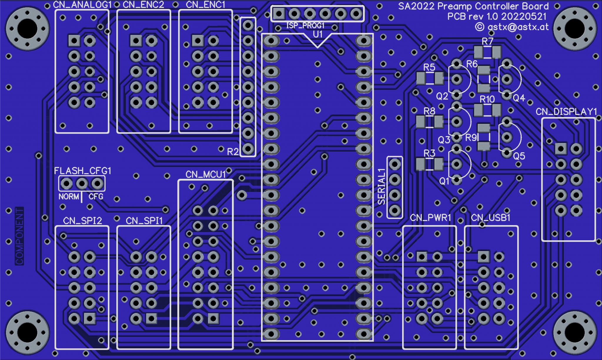

To program the PIC18F46K22 controller has been a long running project. First ideas are from 2006 ...

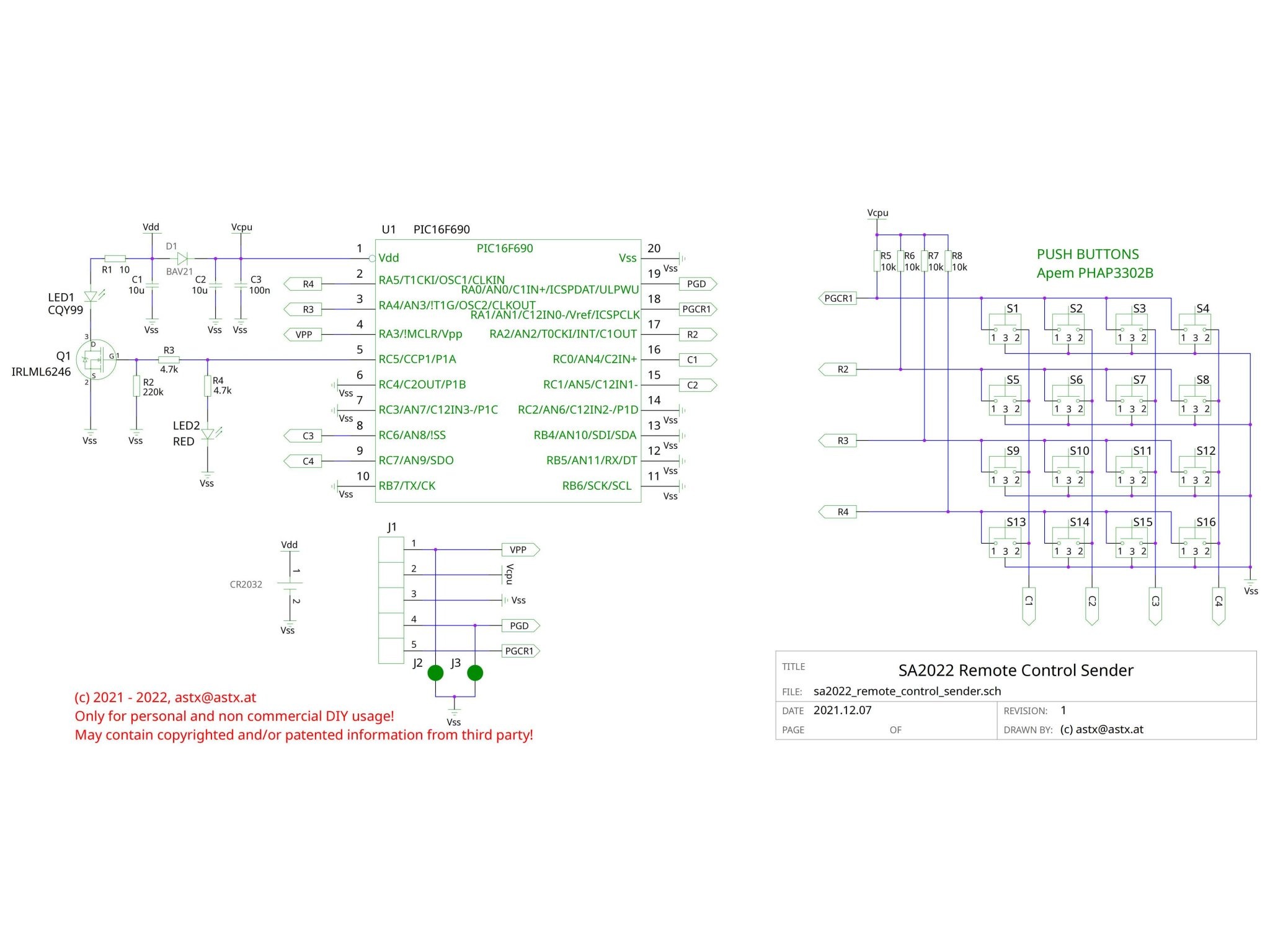

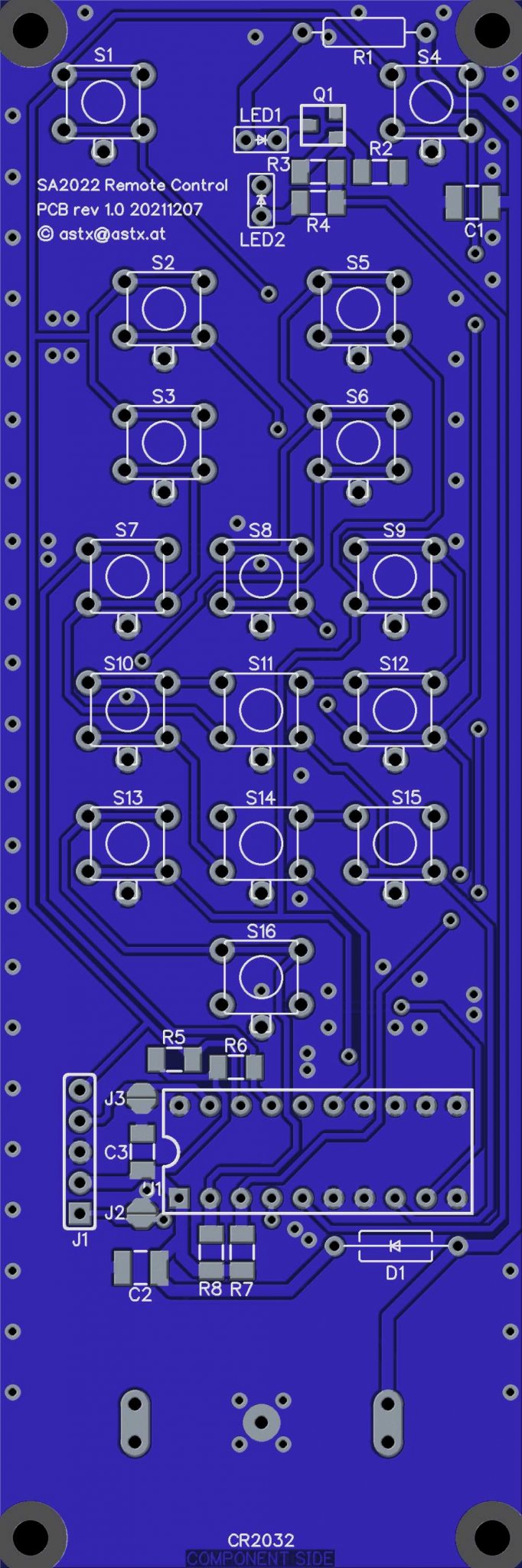

Of course such a preamplifer project needs also a homebrew remote control based on NEC protocol too. This is a perfect job for an old PIC16F690.
For you nerds: some PCBs may be available at the end of the project!
Attached are all schematics. Note the copyright: only DIY/private use!
Have fun, Toni

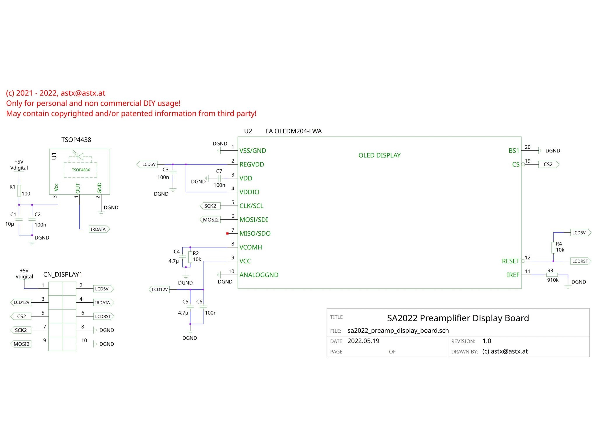

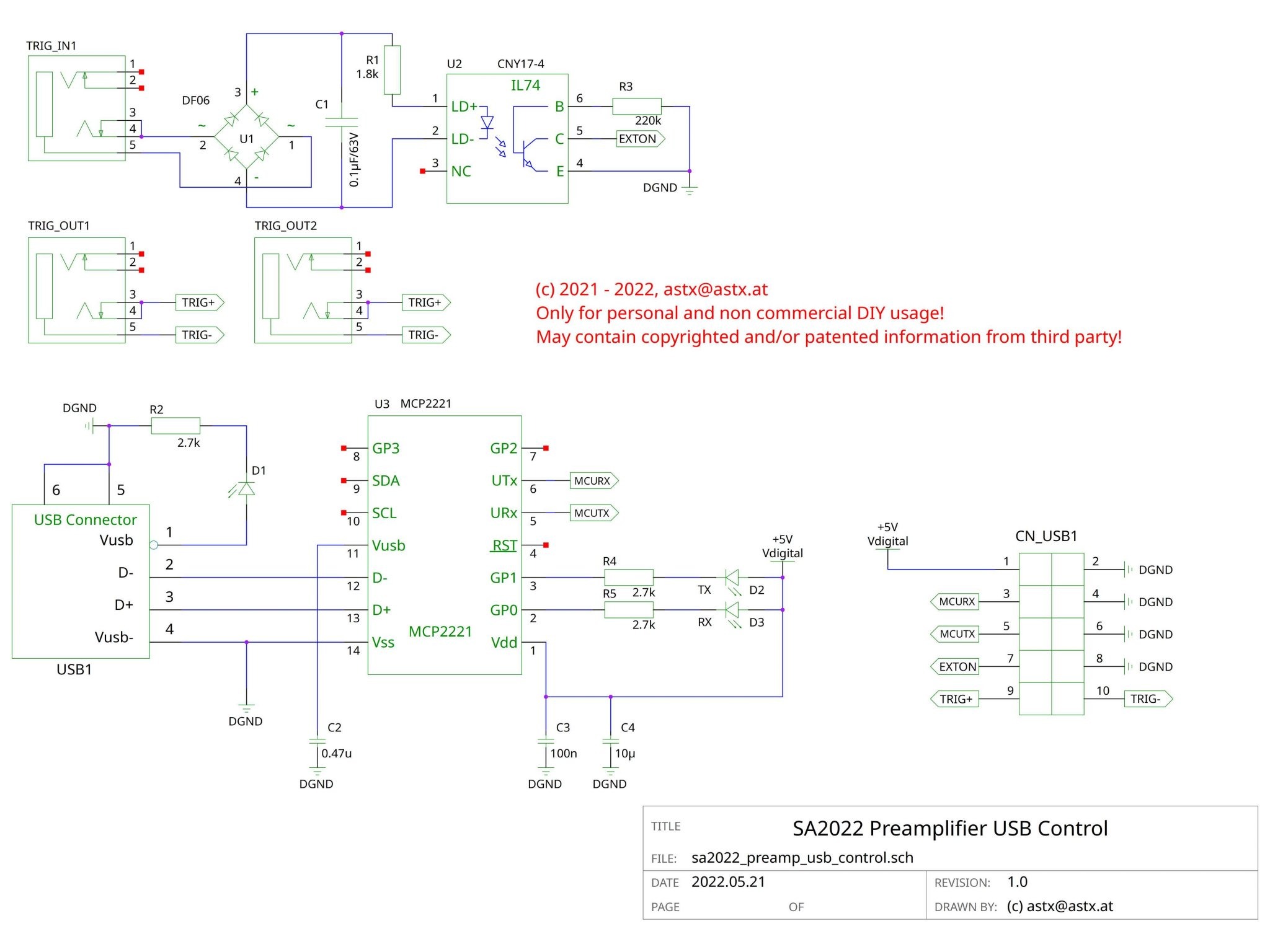

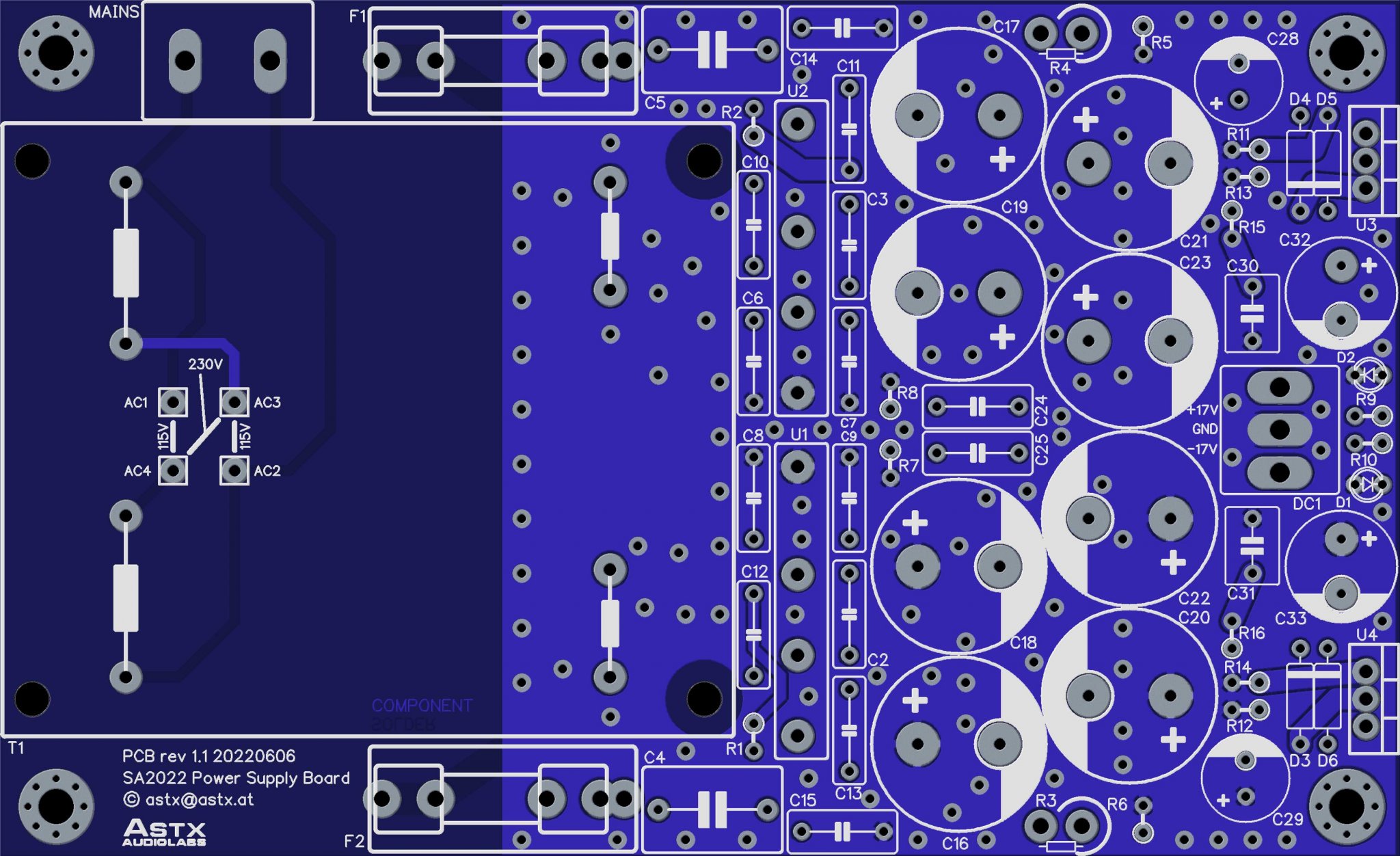

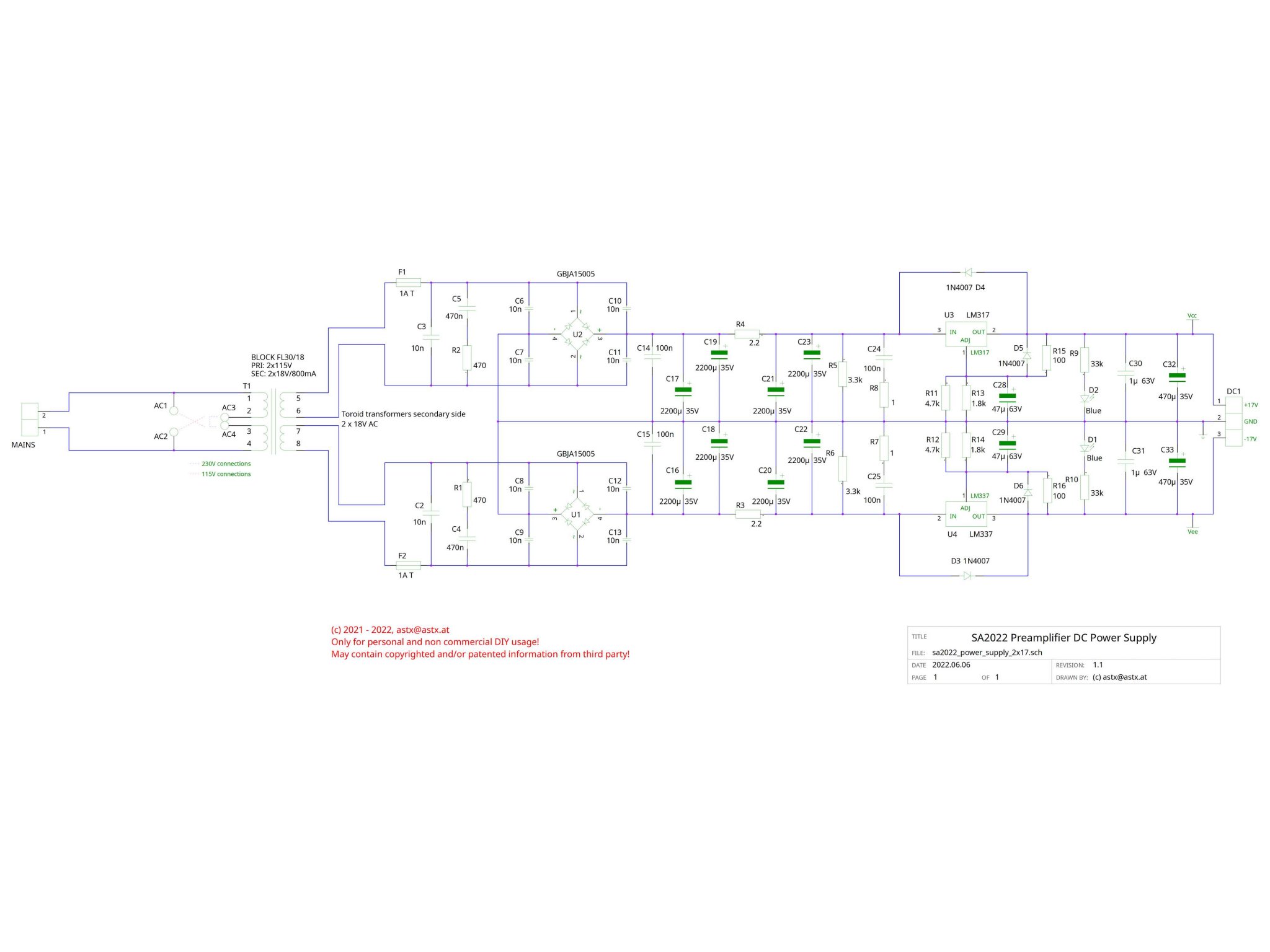

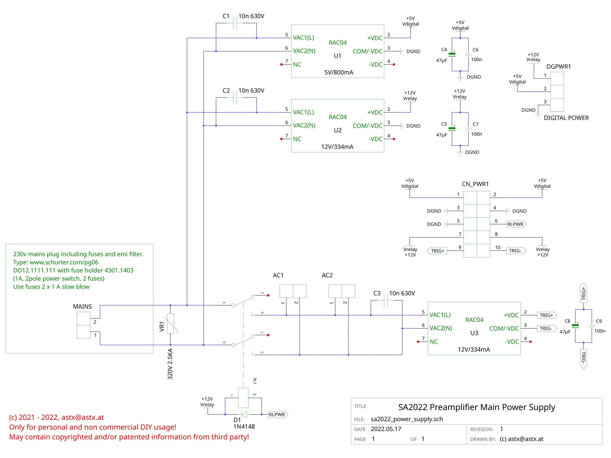

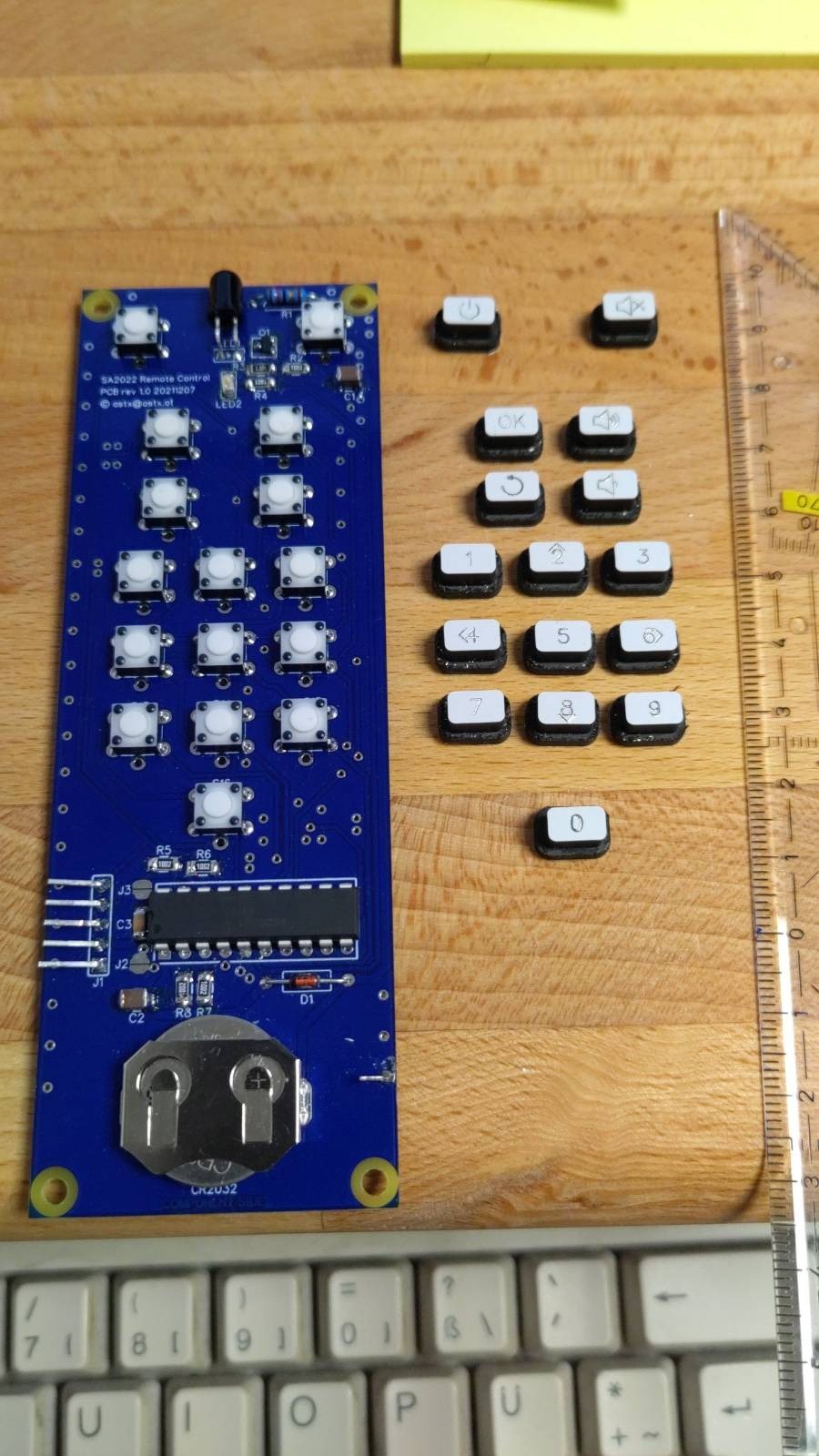

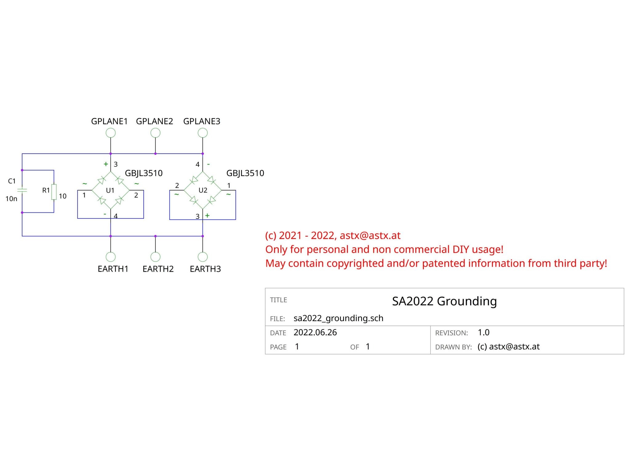

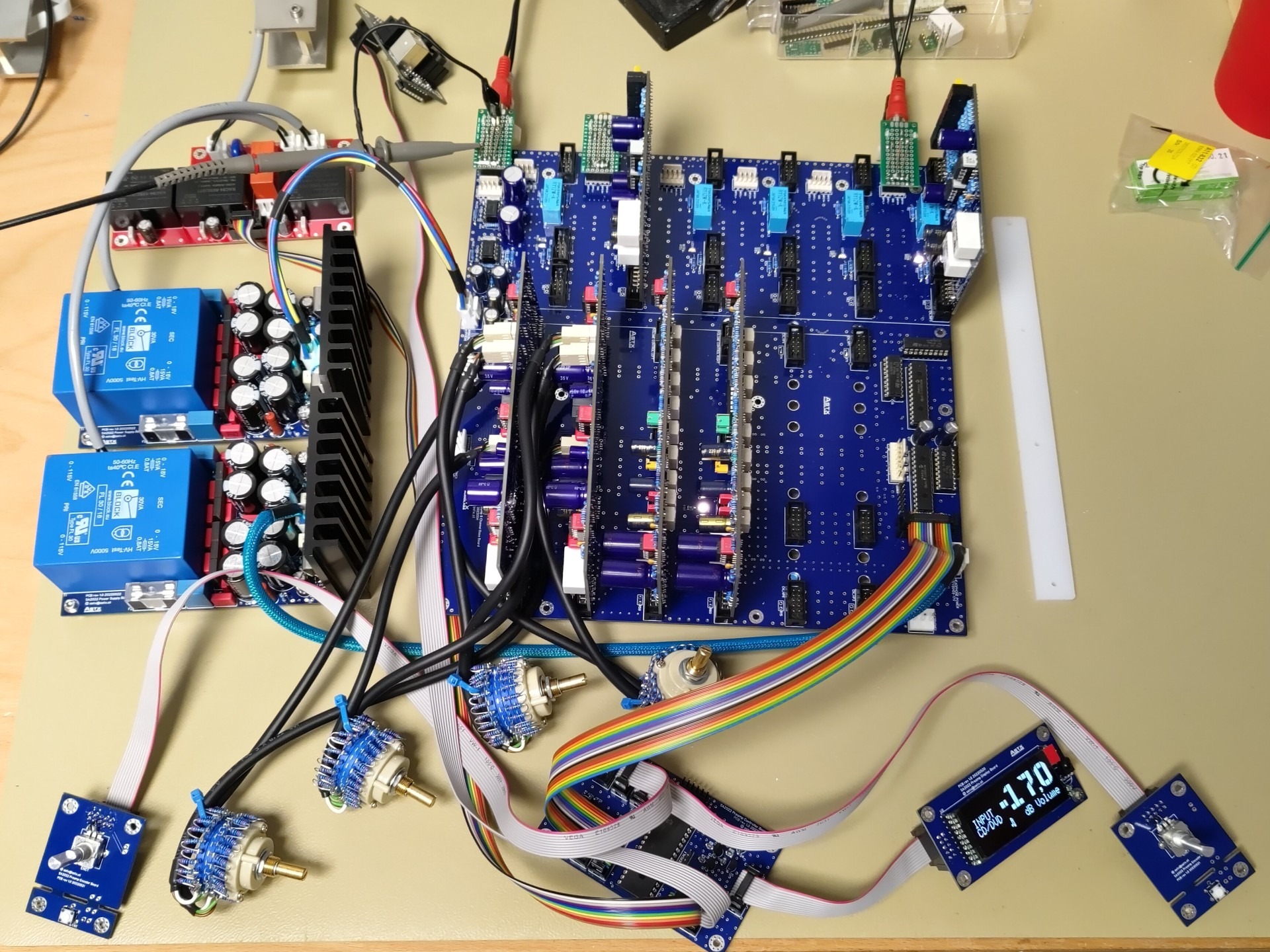

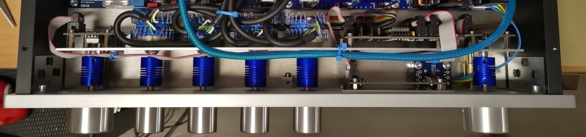

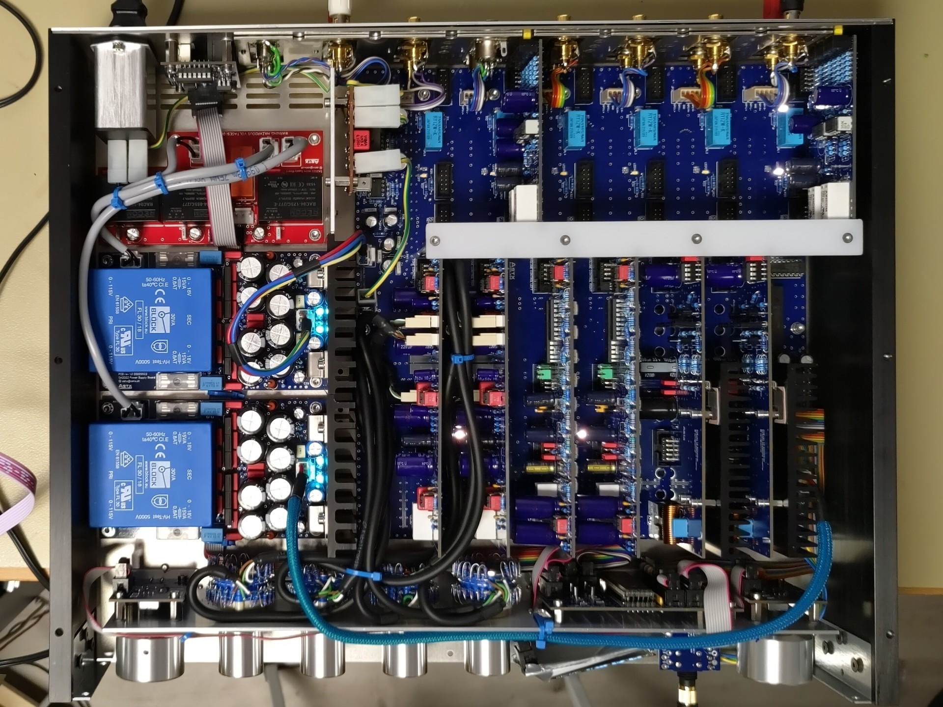

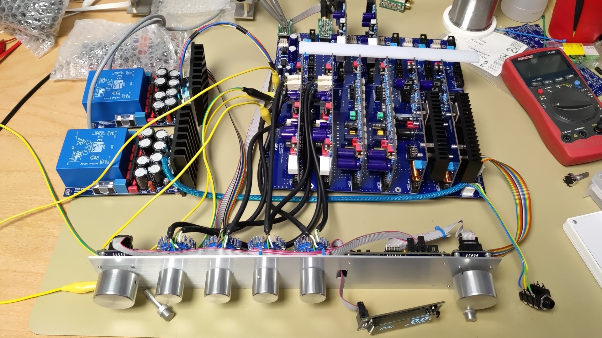

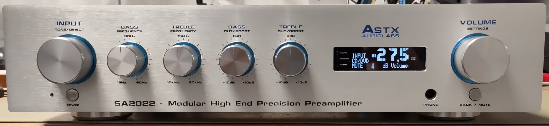

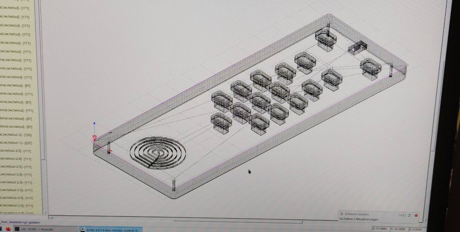

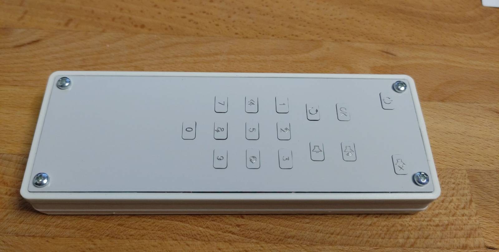

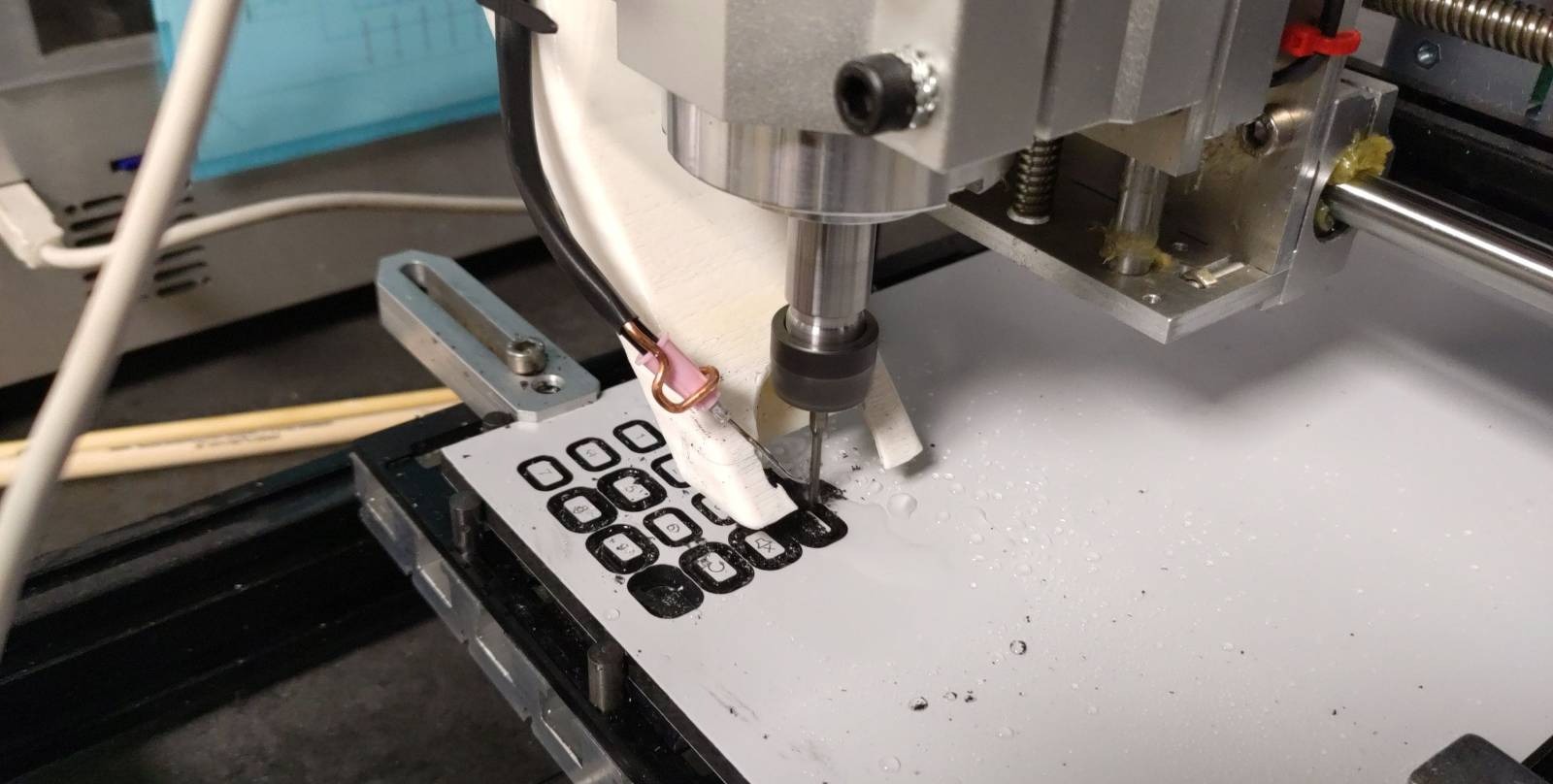

From left to right:
First powering, headphone amp 1, 2, remote control, machining knobs, machining top cover, prototype got a 3D printed ABS case - works!

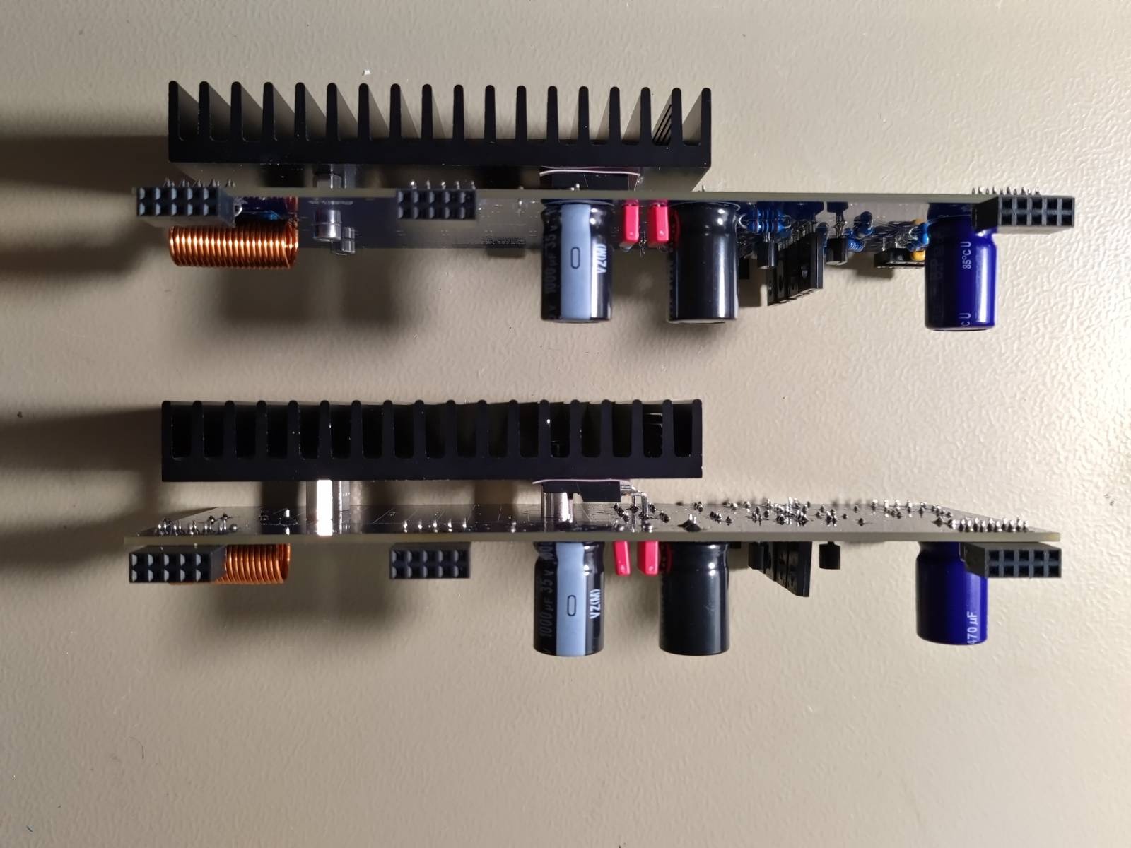

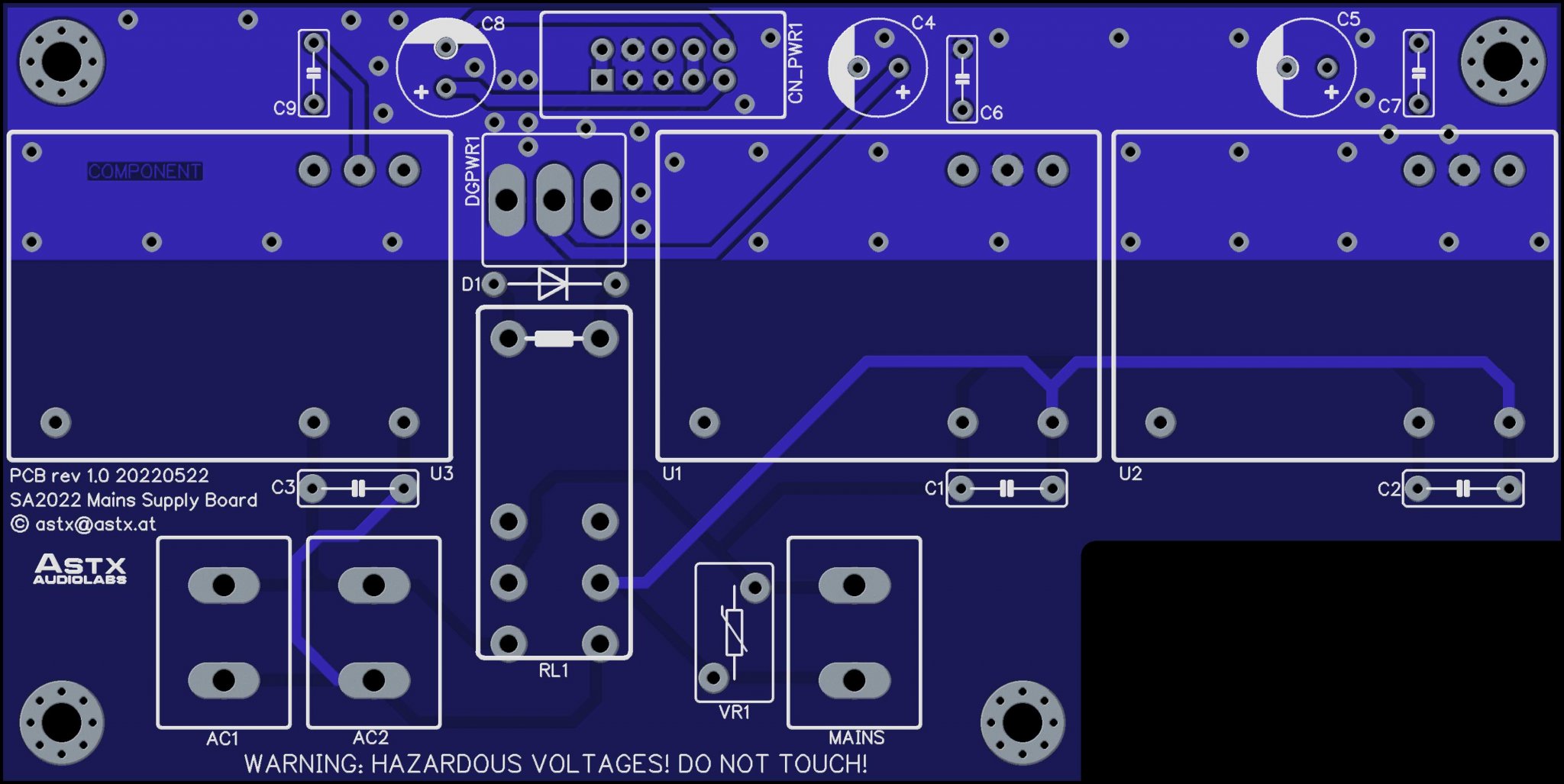

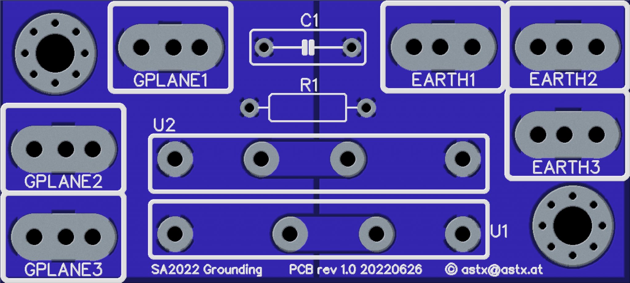

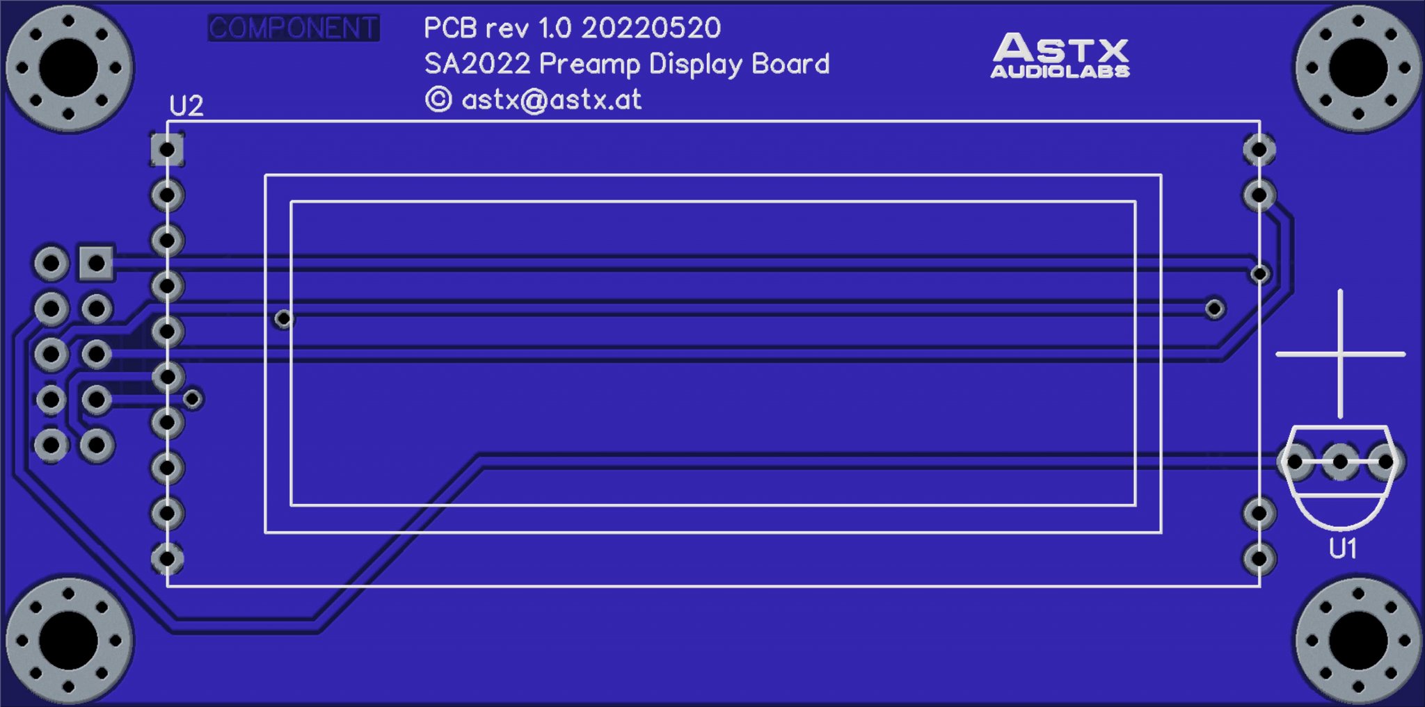

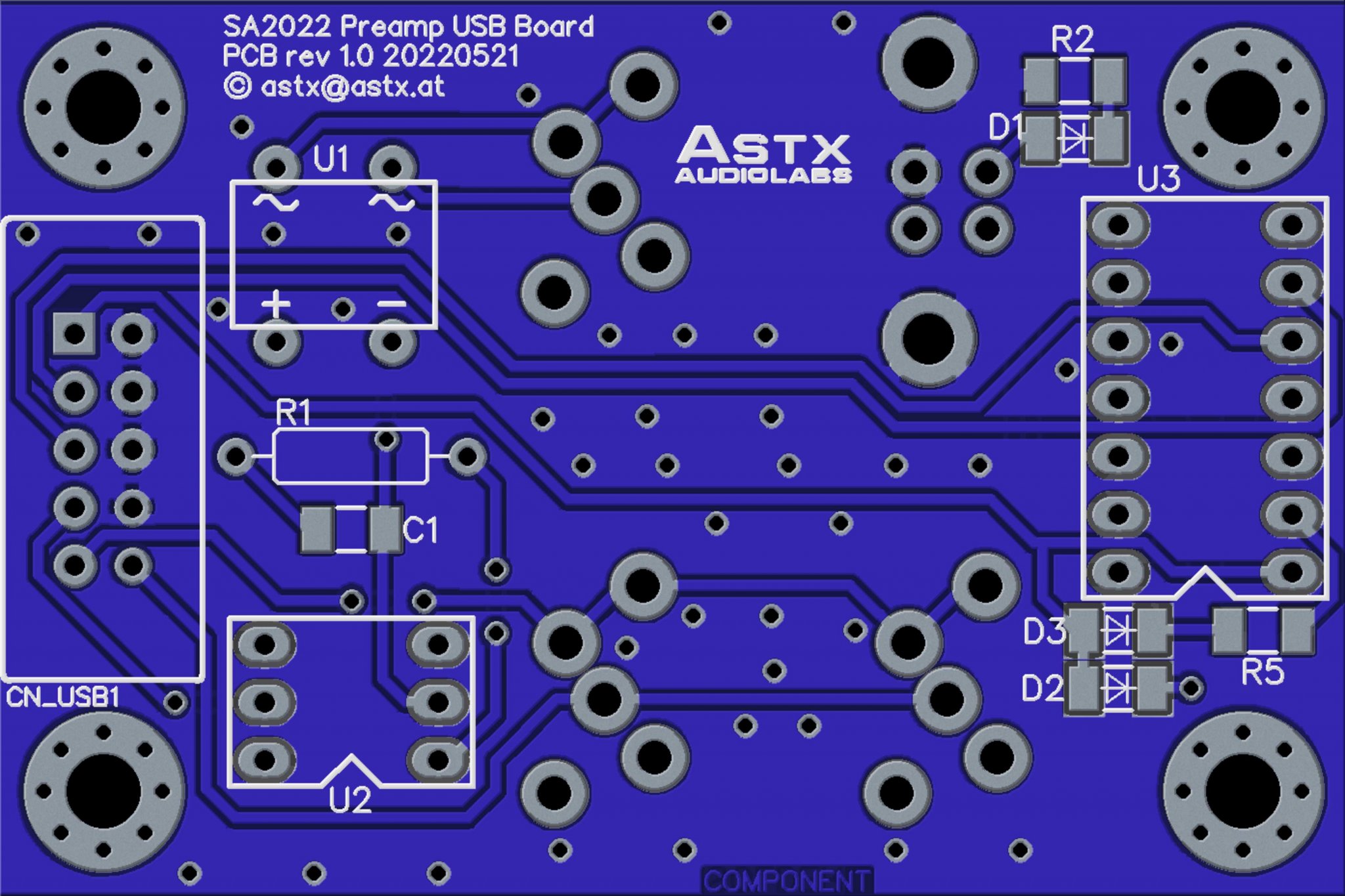

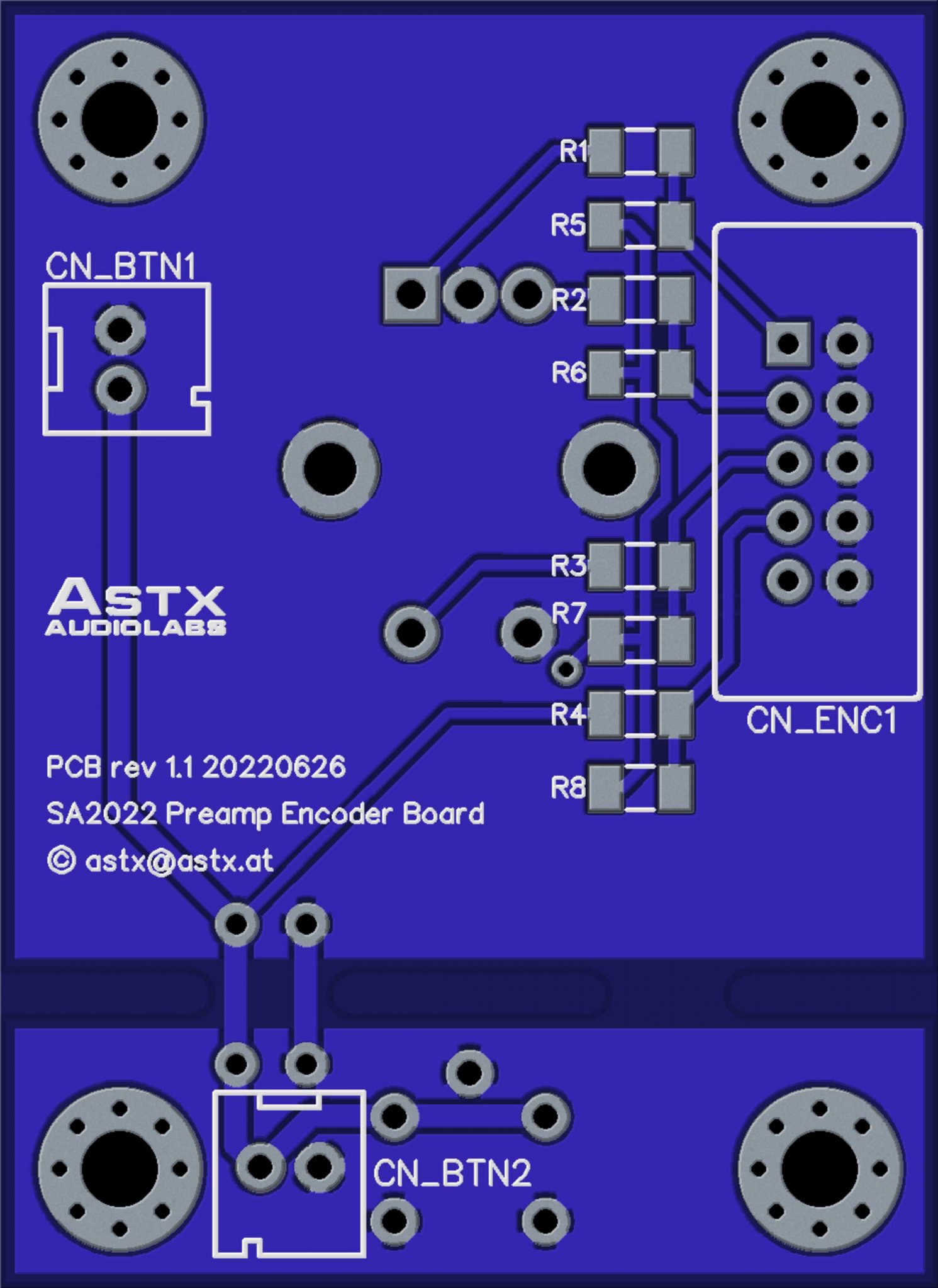

These PCB's have been designed during the development process...

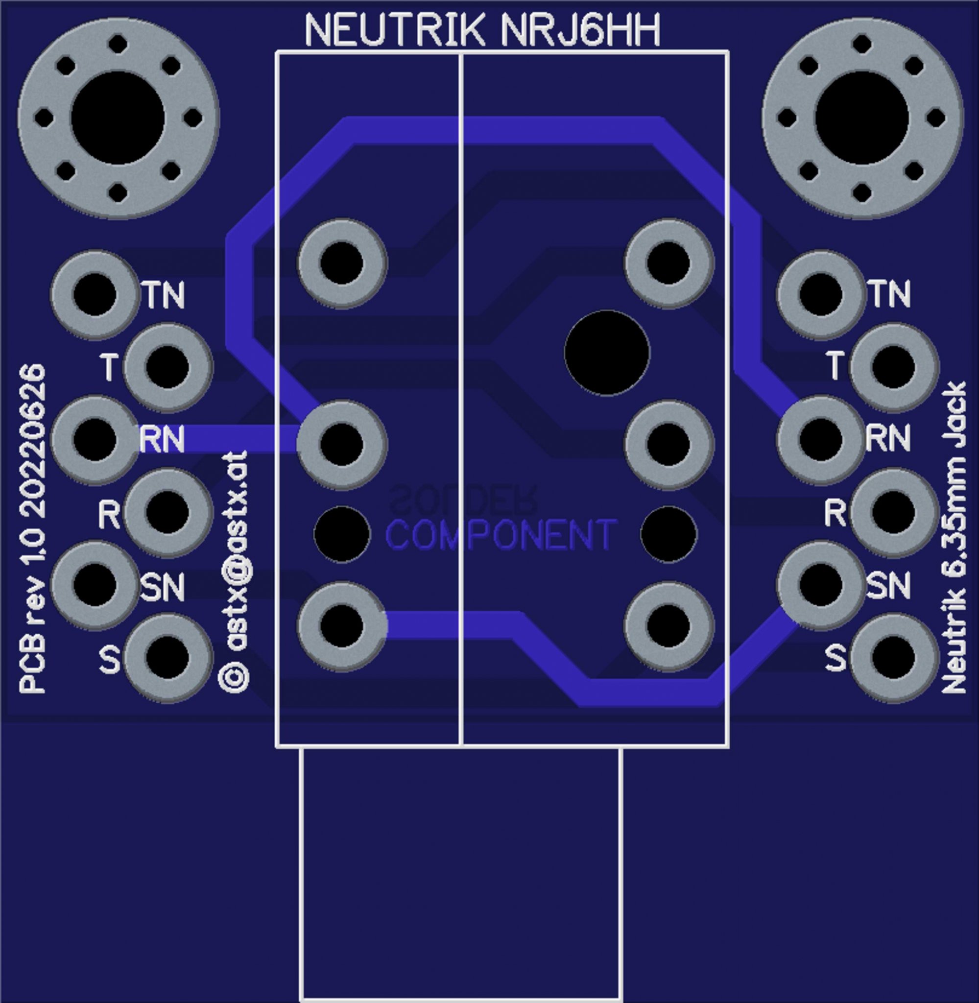

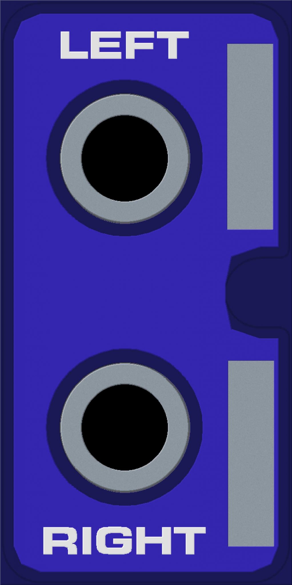

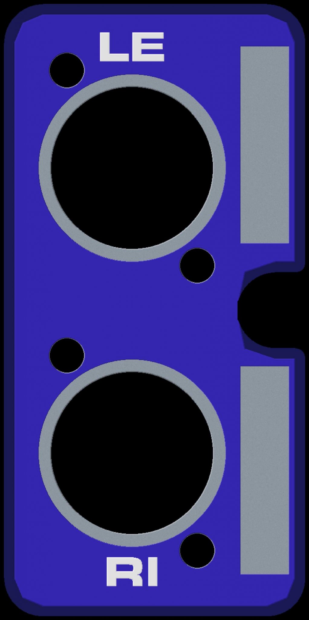

... and these small shields ...

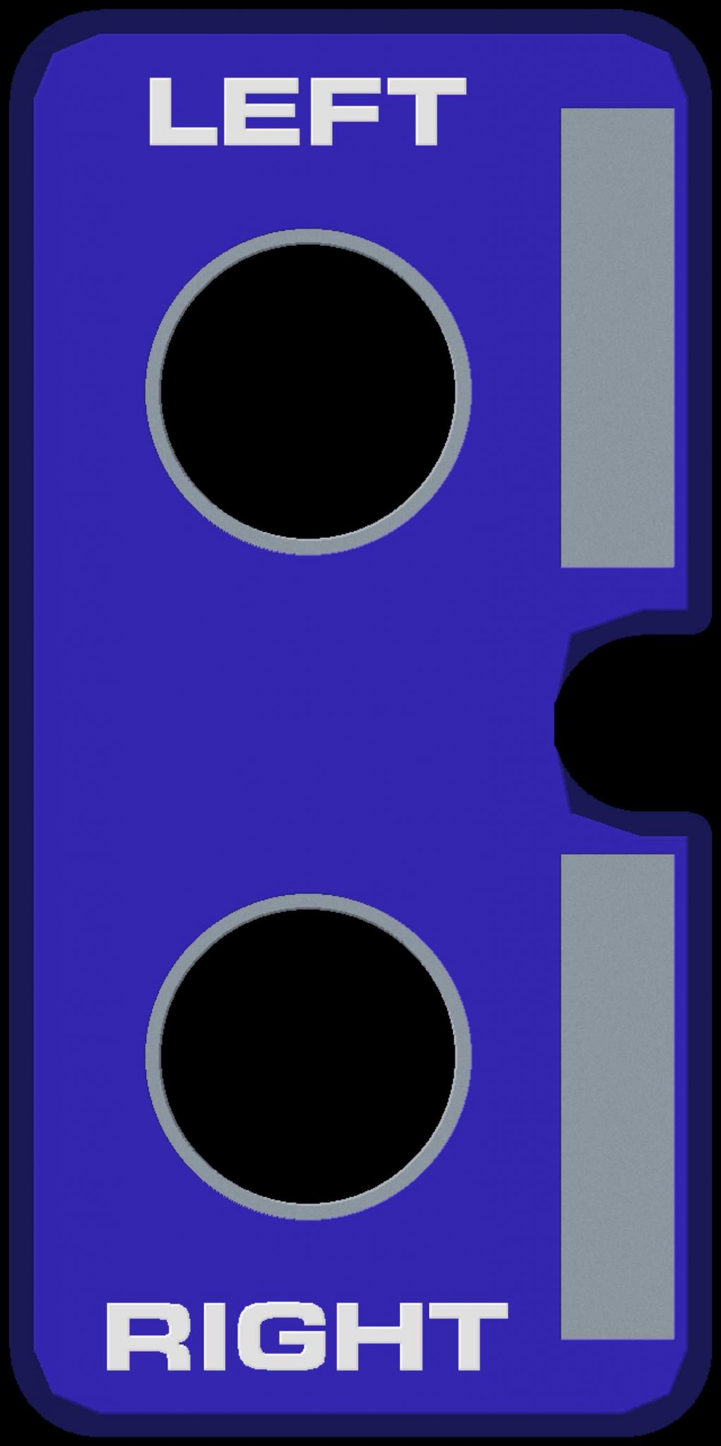

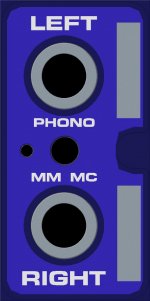

Thx for the nice words! You are right and not: Vinyl and other audio devices from the 80ies have their time for a comeback. Currently I'm reviving a tangential vinyl player from revox with MC pickup. One of the next input modules will be a MM/MC Phono RIAA card.Lovely design, perfectly executed. Impressive. The lack of attention is I suppose a sign of that the architecture of the audio system is changing and the era of the "pre-amp" is over or at least, sleeping. Skills!!!

So it was time for a analog high end preamp with the possibility to connect old and new devices with modern comfort: IR remote control but also the possibility to integrate it in the house automation (USB port accepts also remote control commands).

The zero cross detection (2 separate channels for le/ri) works very well. the interrupt is only enabled for one shot when a volume change is needed. the logic waits a configurable ms maximum till a hard volume switch will occur. the default is 50ms - a full period of a 20 Hz wave. The small relays are fast and need about 1ms to switch. The logic takes care of the special cases where a volume change goes from e.g. 0b0111111 to 0b1000000 to avoid clicks. During my test I have never heard any click or thumb on volume change.

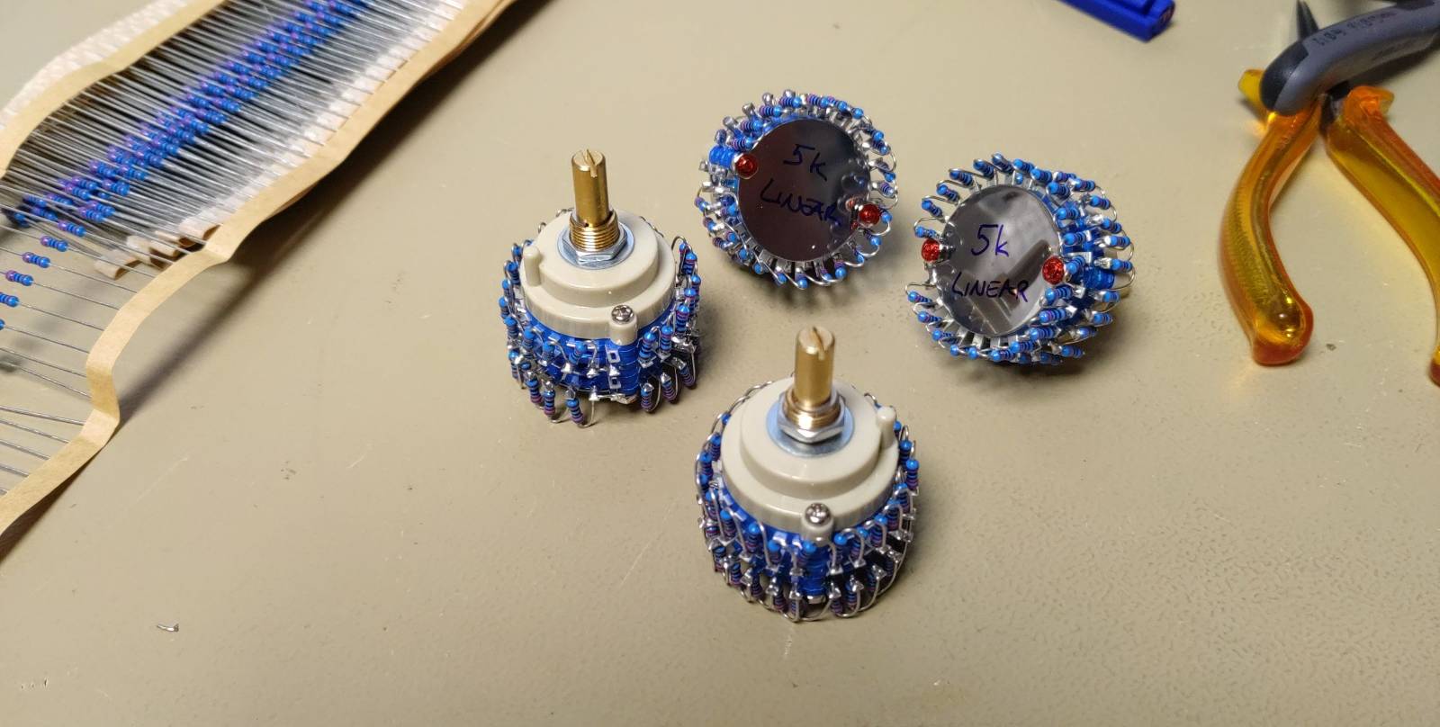

The tone control rotary switches are also click and pop free.
BR, Toni

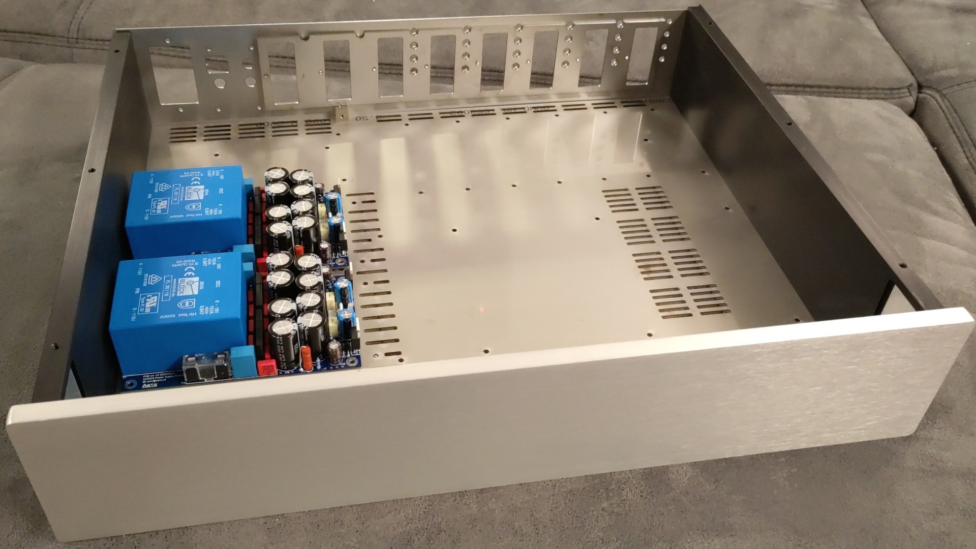

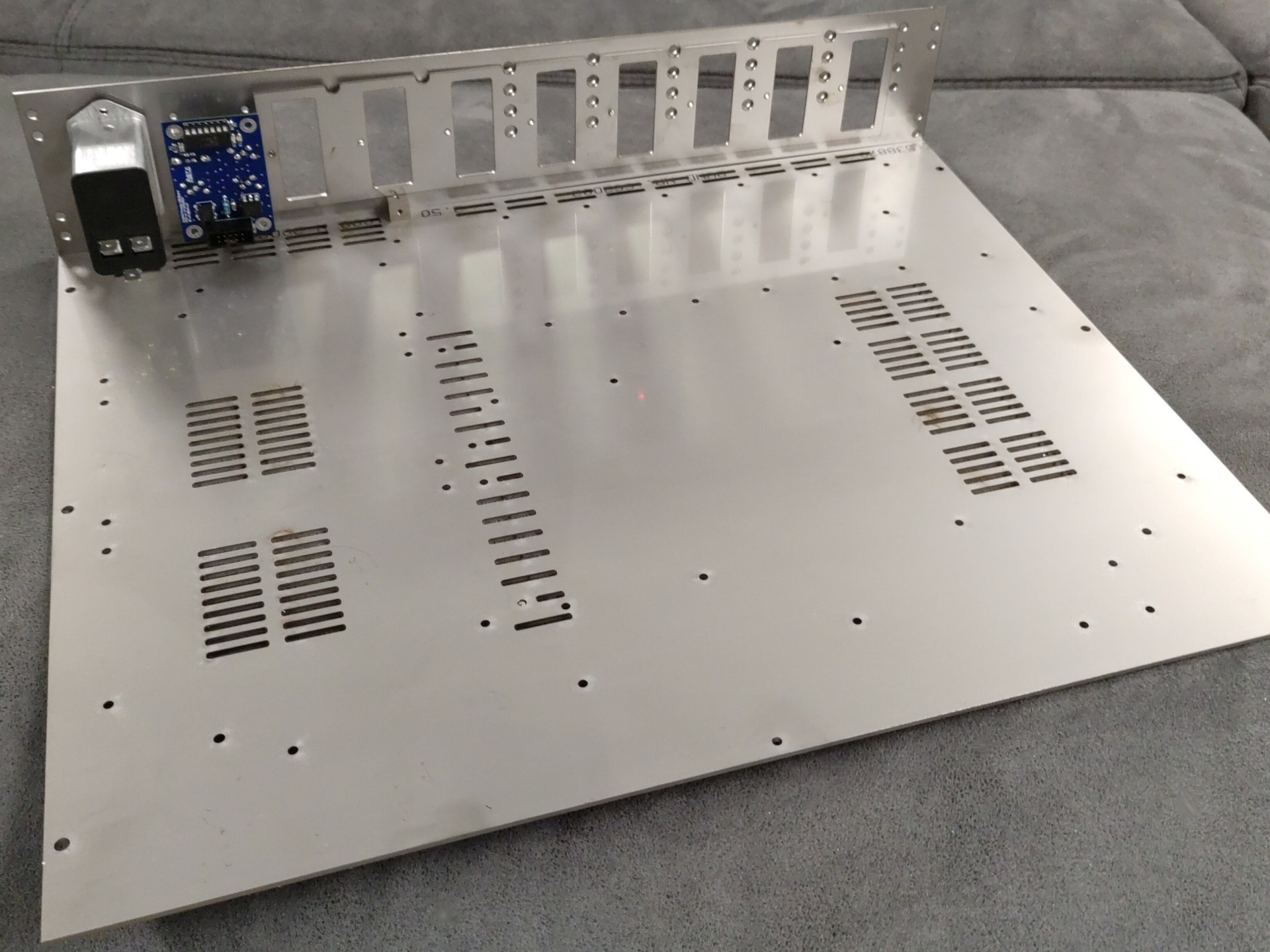

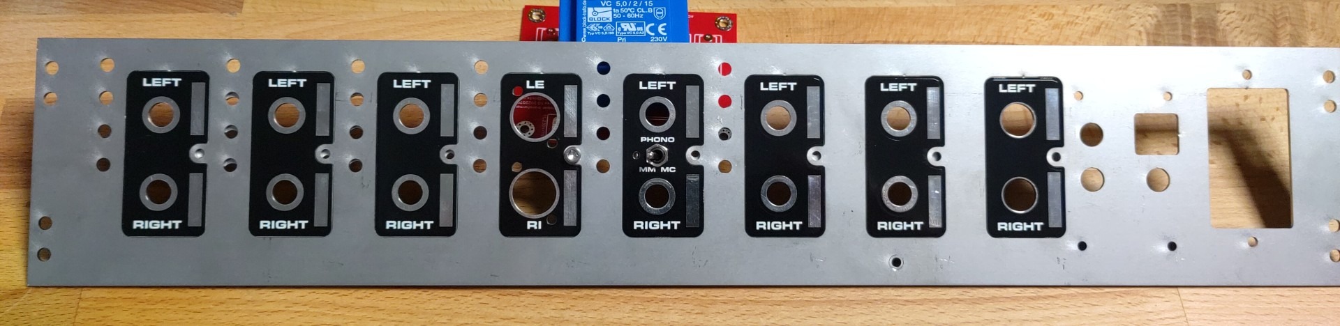

Today some parts arrived.
Bottom stainless steel 2.5mm.

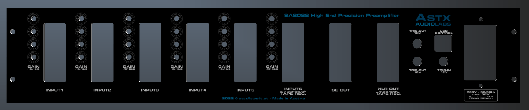

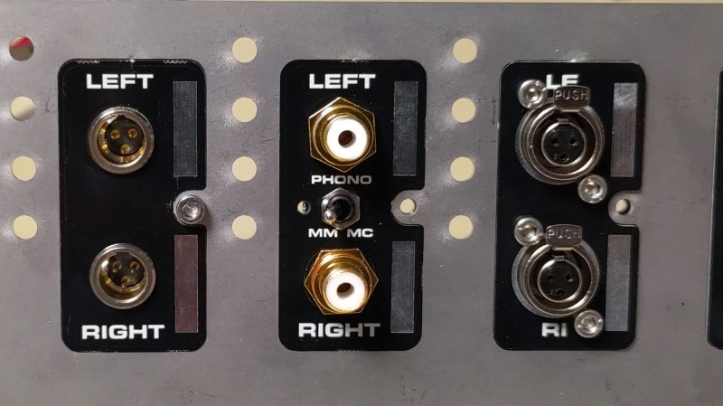

The Backside is constructed of 3 metal sheets:
- sandwich outer in 1.5mm Aluminium see post #13
- sandwich middle stainless steel 1.5mm
- sandwich inner stainless steel 1.5mm fixates the input/output shield pcb:s from post #7
