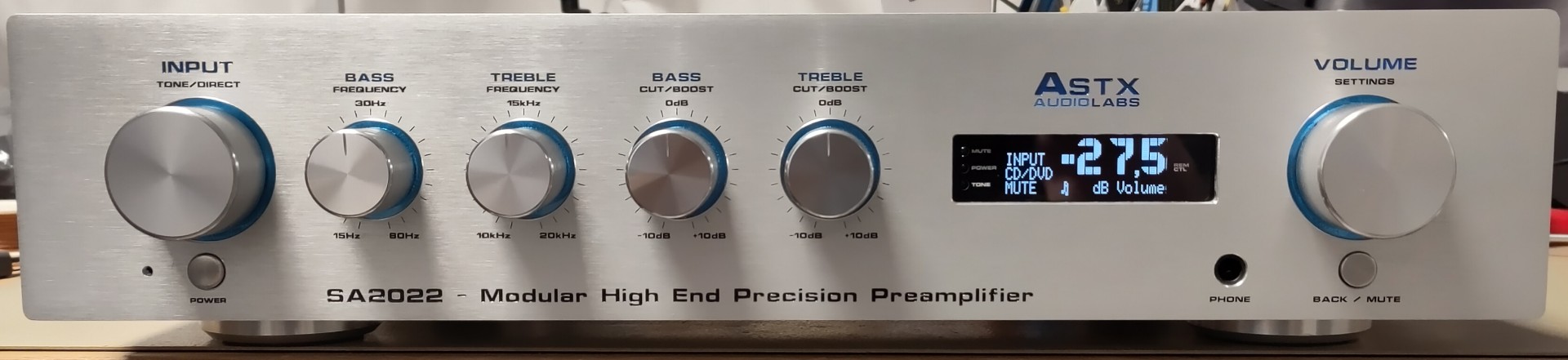

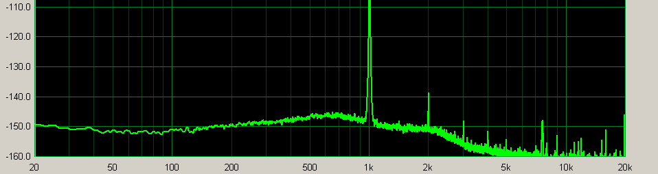

Have 3 Rohde & Schwarz UPL in restauration. This will soon improve my measurement capabilities.
In fact the preamp is far better as I have thought it could be. The baseboard design which mostly makes cableing obsolete due to very low impedance balanced interconnects is a direct hit.
Also the new developed headphone amp which is able to drive even a 8 R load is a highlight.
Soon 2 new input modules will be presented. A MM (with a MC preamp extension as daughter board) phono stage (D. Self design) and a own design USB dac with PCM1794A powered by Amanero Combo384 module to connect a PC, Laptop or even a Raspberry Pi et al on the fly for outstanding sound quality. The controller firmware will get extended features to control the DAC and the phono stage

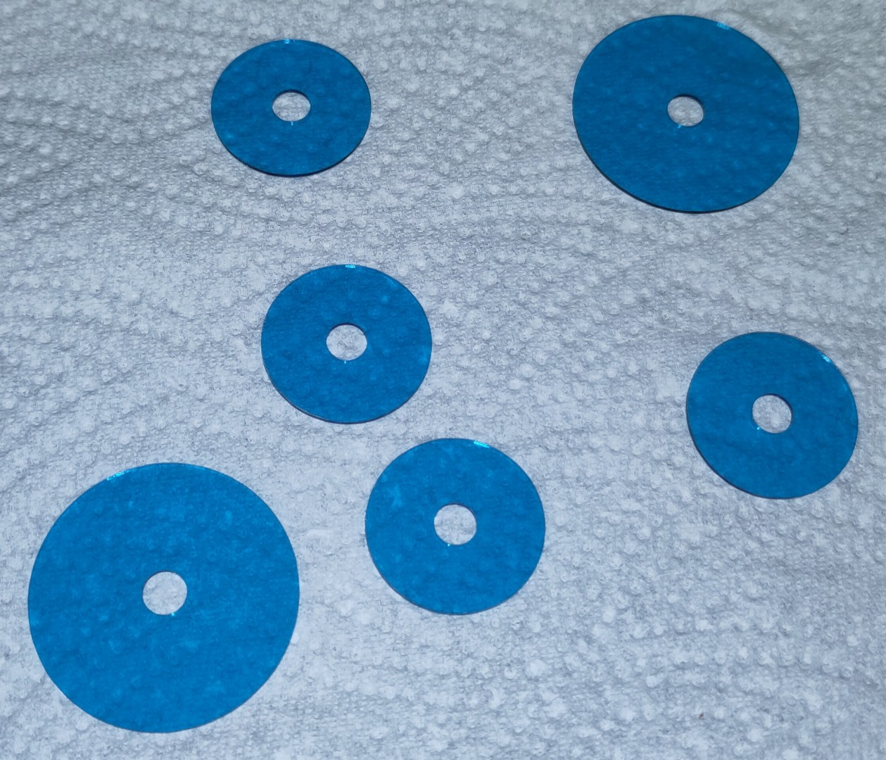

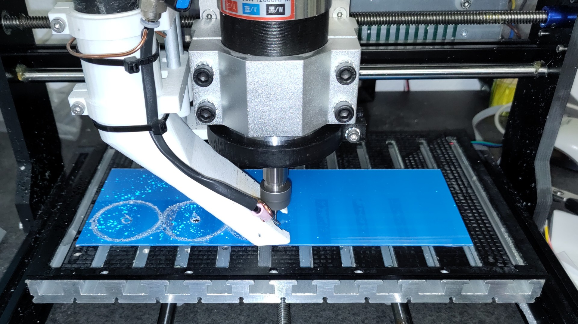

Chapeau Toni! 👏 Really impressive!Today got the 1mm lightblue acryl to cnc machine the knobs background.
The base kit was a sainsmart 3018. Have done a complete redesign of the Z-axis and replaced the T-nut profile. Using better spindle 12000RPM 400W with frequency controlled 3 phase motor. Control PC is a raspberry pi running opensuse tumbleweed and the CNC software is bCNC.

this is really a very nice project and a lot of thought and planning went in to this, wow.
i want to use the tone boards for a balanced salas dcg3 build with variable gain.
I am also looking for a variable loudness controll board, for the easy listerning moments.
I will look in to how to change the base frequenty.
I really like the use of rotary switches a lot.
just let me know when and how to buy boards from you!!
