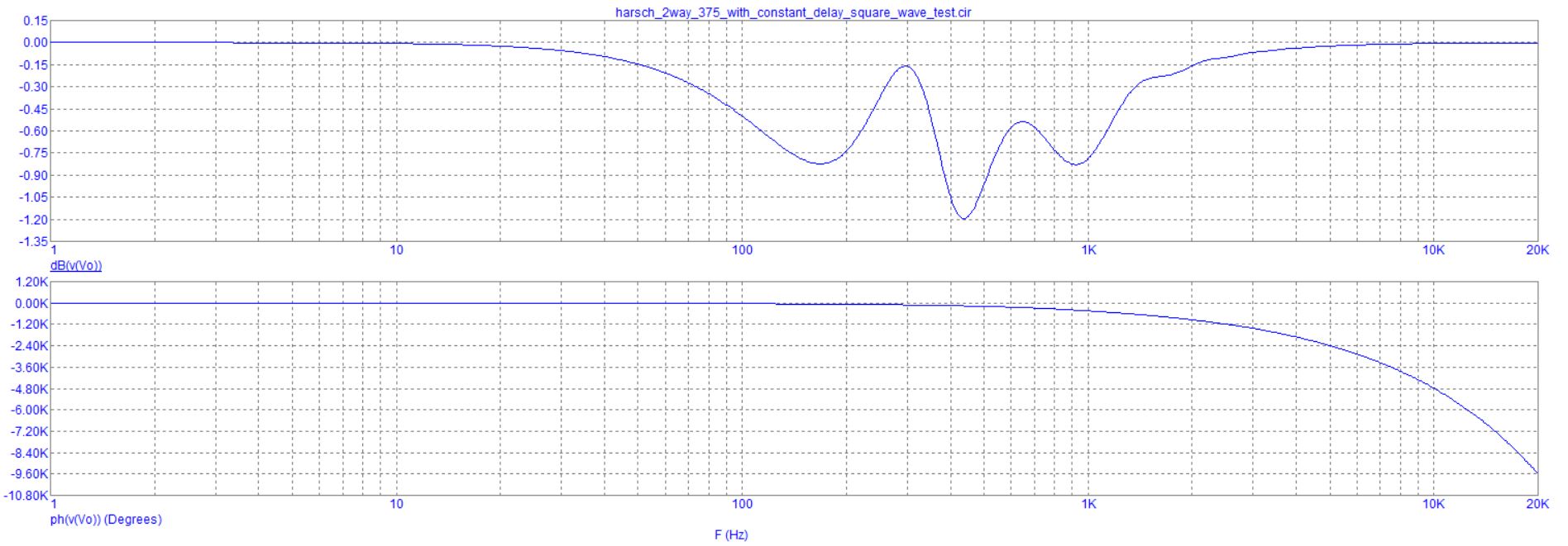

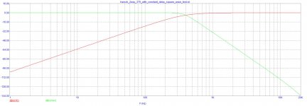

Hi All;

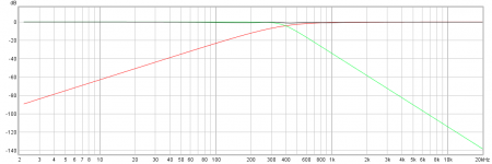

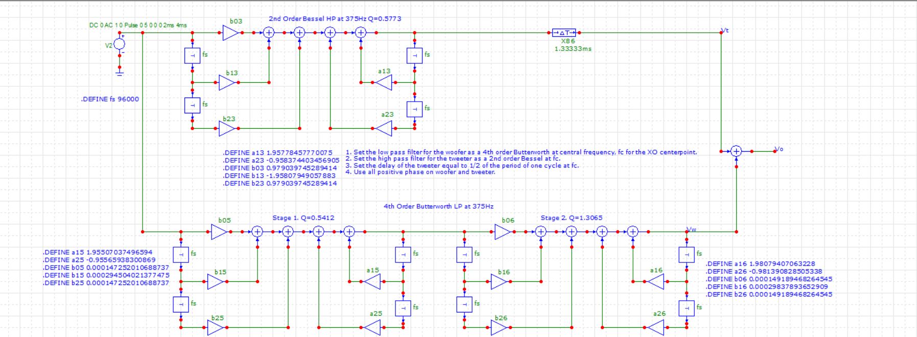

Great work here with some really great insights and results. I am only doing simulations right now but am planning a build for the near future (Dec/Jan). It's all DSP so I can do whatever I want with biquads and canned crossovers and filters in Audio Weaver. Don't have enough horsepower for FIR arbitrary phase/amplitude filters unless I play with sample rates which I may do.
I will play with filler driver designs (which I have also learned about in this thread;THANKS to all) as well as conventional LR4 and BW4 etc designs. It's just a file and an upload once the drivers are measured.

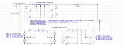

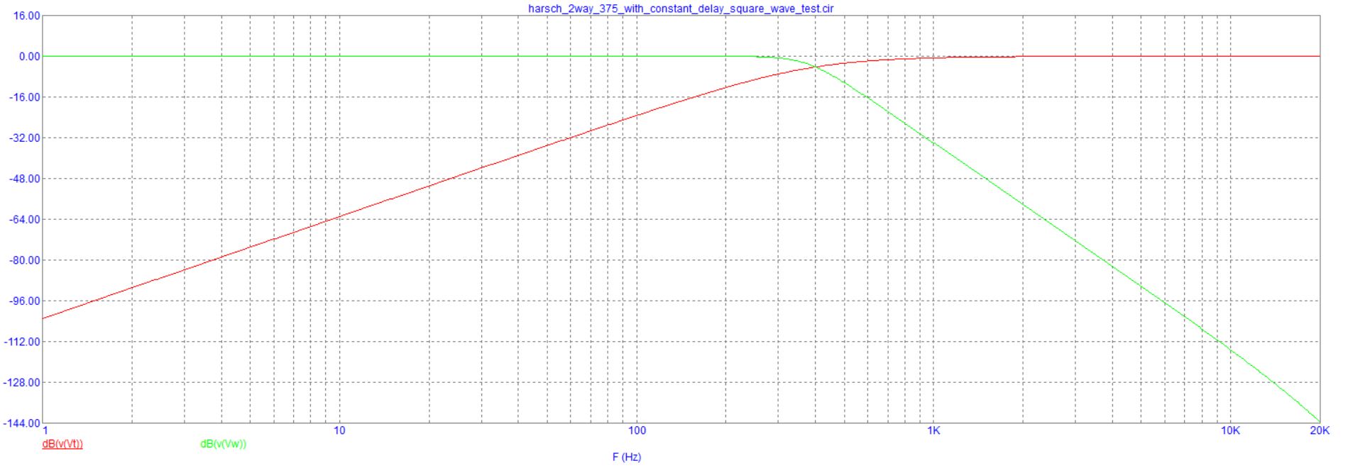

I am simulating biquads in SPICE and I can make the Butterworth/Bessel slopes but I cannot get the phase to make sense. The coefficients are from the Mini DSP spreadsheet. I am sure that they are correct. I have simulated a 2 way with a crossover at 375Hz (a FAST like xrk's) and I have the 1.3333ms delay in the tweeter path (1/375/2). Note that there are no drivers. The free space summation is an ideal summing node so driver response/displacement is not a concern (but I still can't get it to look like a Harsch response 🙁)
Intuitively what the simulation says makes sense. A constant delay (1.333ms) will result in huge phase wraps at higher frequencies. I simply cannot get the little phase ripple that you guys can make. 1.333ms at 1kHz is 480°, at 5kHz it's 2400°.
Am I doing something goofy or does what I am simulating make sense and I am just interpreting it incorrectly.
Thanks for any insight.
Matt

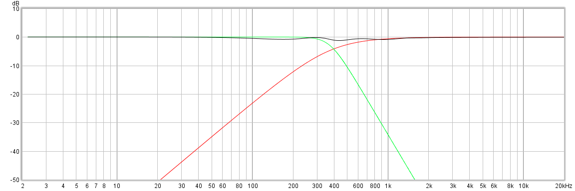

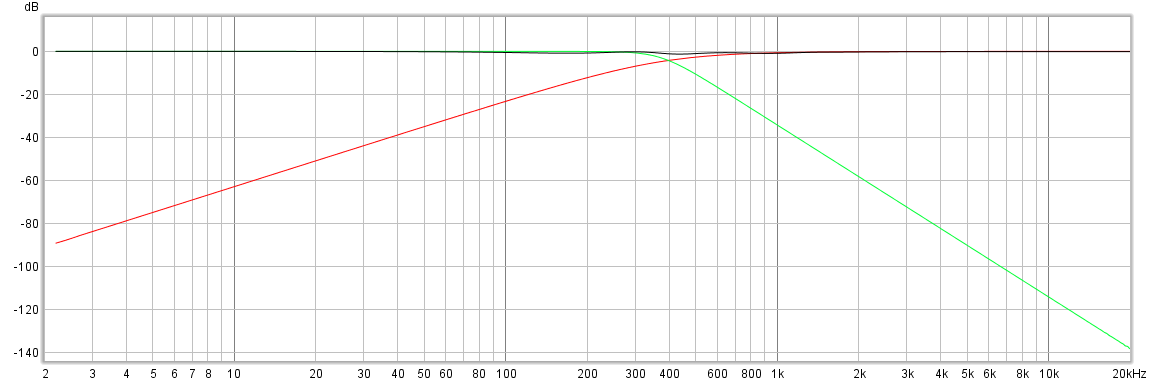

Think looks you probably close enough, filter is a compromise to transient perfect behavour summing two non symetrical out of phase minimum phase filter slopes plus add a physical delay to HF part, on axis sum is not as perfect as for example LR or 1st order slopes, for HARSCH filter sum have a cost in some more or less amplitude ripple.

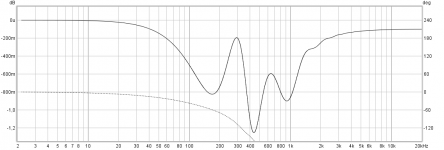

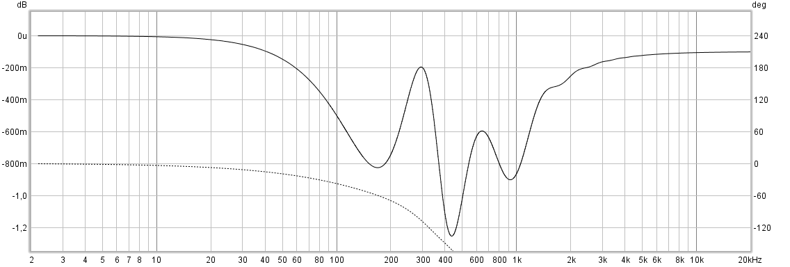

Error looks you view that summing ripple on a 1,5dB vertical scale and there it looks bit scary, i setup your project specs into REW and if you look below we can see vertical scales mean a lot : )

Hi Matt
It looks as if you were able to program your DSP quite freely. Why don't you try subtractive delay in this case ?

Thanks Guys;
Brytt; I am not concerned about the amplitude ripple. I suspect that this gets lost in the noise of actual driver FR variations. Who knows; it might even help. It's the huge phase slope that I can't reconcile with the results presented here (small phase bump up to 60-90°). Again these are SPICE simulations. There are no drivers, offsets or lobing issues.
Charles; Thanks; will check what is available but this is not DSP that I have presented; it is a time domain based biquad simulated in SPICE (Micro Cap). Like the MiniDSP SW though I have many building blocks available including biquads that behave like the MiniDSP types. I do not have a subtractive delay however. There is a block for a two-way subtractive type crossover that i can play with.

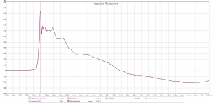

Okay phase was culprit subject : )
In REW i get the same phase wrap when i sum the two IR (impulse responses) with HF bandpass delayed 1,333mS because IR for the new summed bandpass continue sit 1,333mS delayed on timeline in IR window, but then one can re allign IR to time zero and phase then change to the characteristic HARSCH filter hump. Other method in REW that output the correct phase without one re alligning IR is instead of a delay to IR for HF band then set IR for LF band 1,333mS advanced in time, so wonder if you can do the same in remove the delay on HF band and try with for example a negative sign -1,333mS set for woofer, else try put a normal delay on both bands in front of their filter sections and see what happens, for example a delay of 1,333mS for LF band and then 2,666mS for HF band.

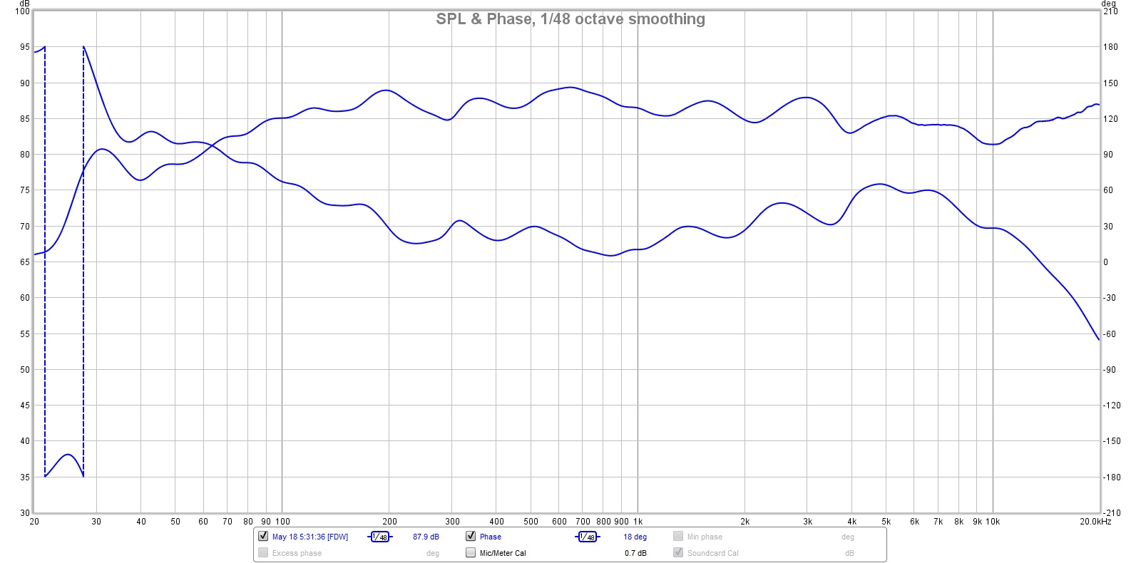

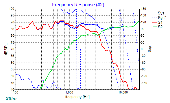

What if I told you guys that I was able to make a simple (2 inductors, 2 capacitors, 4 resistors) passive XO that resembles a Harsch XO and doesn’t need a stepped baffle and is easy to build and sounds great?
Here are the predicted XO curves, note the tell-tale sign of a Harsch XO in the slight dip in system response a bit below the woofer to the left of XO:

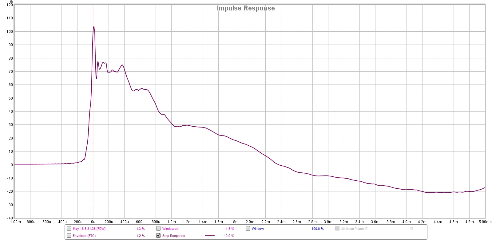

Here is the measured step response:

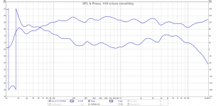

Here is measured acoustical phase - note that there is about a 55deg rise in the phase from the lower baseline to approximately where the XO point is.
This was quite a surprise to me that it was possible, but made possible with a woofer that is wide bandwidth and a shallow commercially available waveguide on a dome tweeter.
