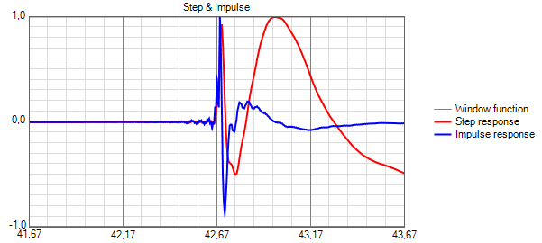

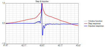

Well crud... I did not save the FRD file from the full-up Harsch filter network... and I have already put away all of my test gear.

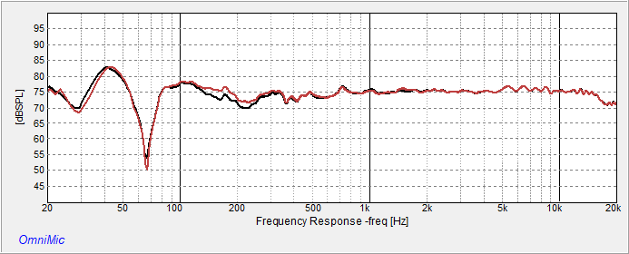

Well anyway, here is a plot of the LR4 filters with the wrong delay (black) and the new correct delay (red).
If I recall, the Harsch filter looked very similar to these from 500 Hz up. In the 200 Hz region, it was almost flat, which would seem to be an improvement, but I found it too heavy in the upper bass / lower midrange on most recordings. As I said before, it deserves a process of optimization before I pass judgment on it.

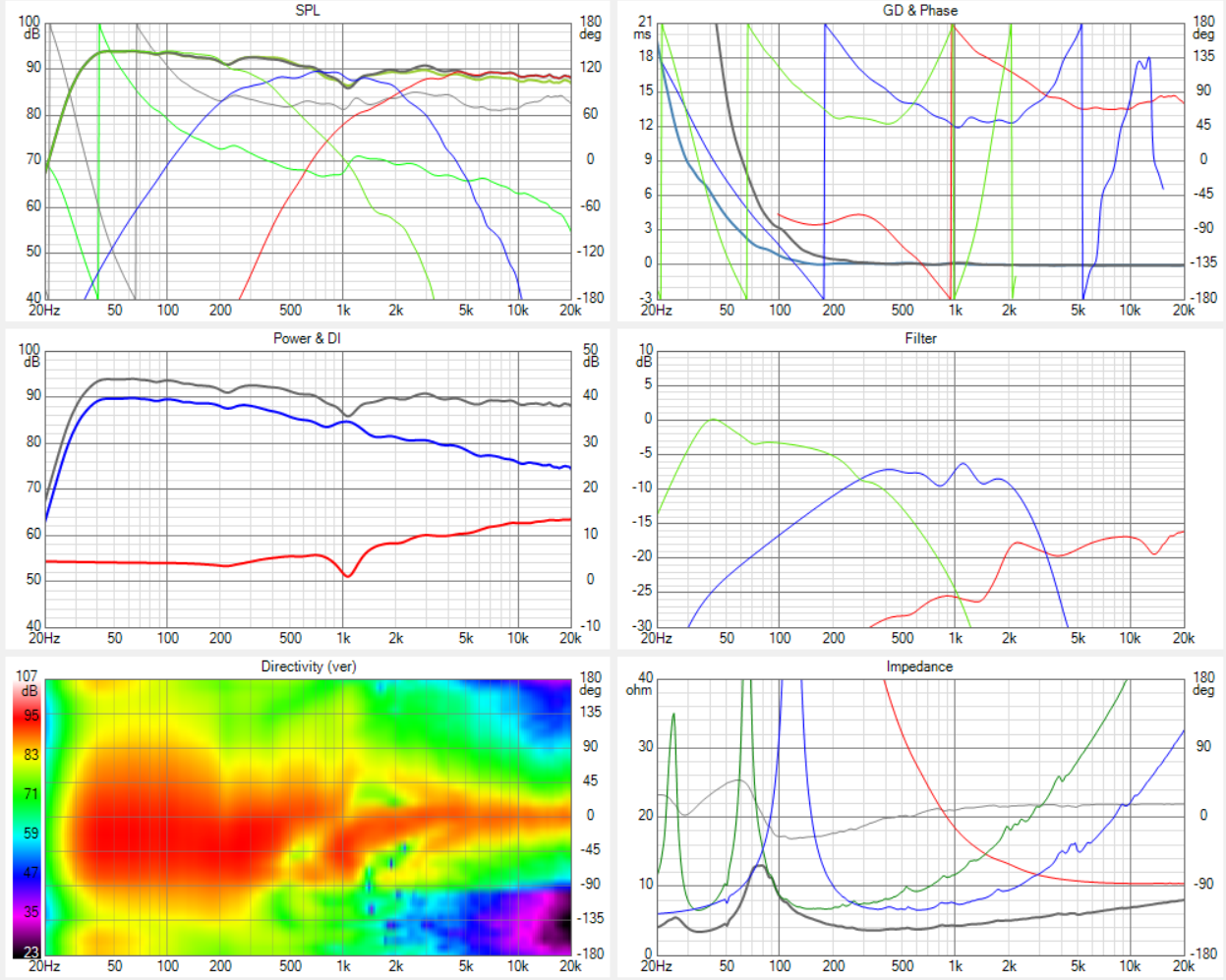

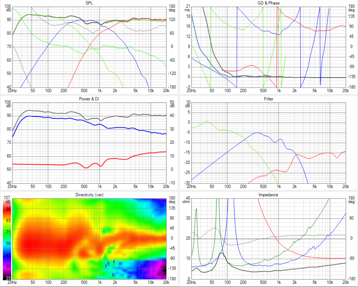

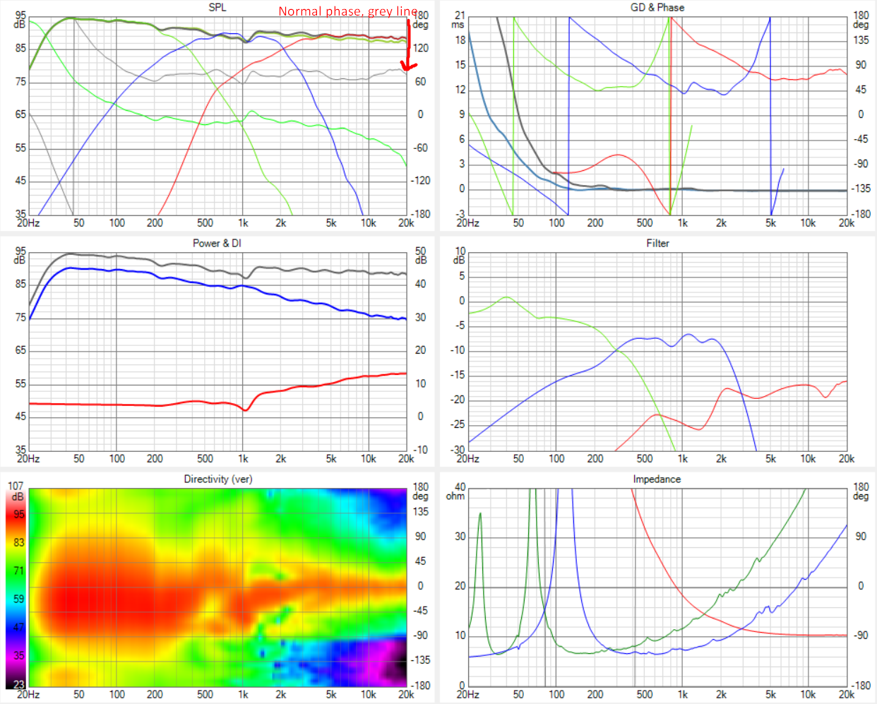

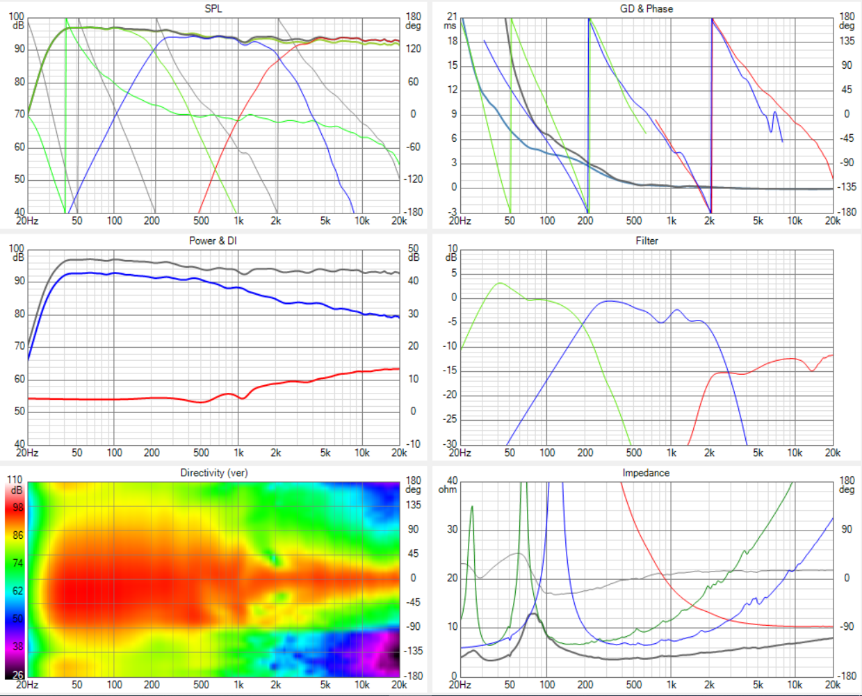

Hi, I tried to make some experiments in VituixCad. Attached are simulation plots from a three way speaker prototype 15", 8" and a horn. Crossover is DSP IIR filters.
I tried to make as good xover as I could (power response, polars etc. all windows pretty) and then turn it into a Harshish xo. Basically took the XRK quide how to make a Harsh xo and then tweaked a bit with the delays and filter components to get good compromise between system phase, power response and vertical polar map. Horizontal polars seemed to be ok so didn't bother to attach that.
note. I haven't listened the harsh filter shown here yet, so no comments.
To me it seems that with harsh xo one can get pretty good results, but the vertical polars are a bit lobsided, null around xo is pretty close to 0 axis (tweeter axis in this case) comparing to the other simulation which is a lot more symmetric and has wider vertical listening window at the mid - tweet xo. Looks like it would be better to put the tweeter below the woofer with the Harsh xo (null below the listening axis instead of above). Another thing is that I'm not sure it is possible to optimize the power response and listening axis response with this setup but they aren't too wild so I think very usable. Phase doesn't wrap like it does with the other plan.
btw. I could make the phase pretty flat for the woofer - mid xo with many different filter slopes + delay, or without delay by inverting the polarity. I don't know excalty what are the acoustic slopes with either setup 🙂 Have fun!
ps. the harshish xo was made pretty quickly while the other one is iteration number xxx 🙂
pps. noticed the harhs xo doesn't have "global" high pass at 30hz as the other one has, so the groupdelay rises quite a bit less.

One more, this is the above xover again. All drivers flipped to positive polarity and then timedelays adjusted so that normal phase is within about 60 degrees. Didn't mind Harsch xo rules and managed to get somewhere in the ballpark.
Edit, another one attached, normal phase within 30deg just by adjusting delays in a pretty good crossover.
Edit, acoustic filters slopes seem to be close to 3rd order bessel for high passes, mid lowpass is close to 3rd order butterworth, woofer lowpass is close to 2nd order butterworth and other slopes on the woofer lowpass seem to work as well when delay is adjusted.
One more for completeness sake 🙂 same system but with LR4 acoustic slopes. Group delay is a bit worse, all drivers with same polarity, step response gets more wavy.

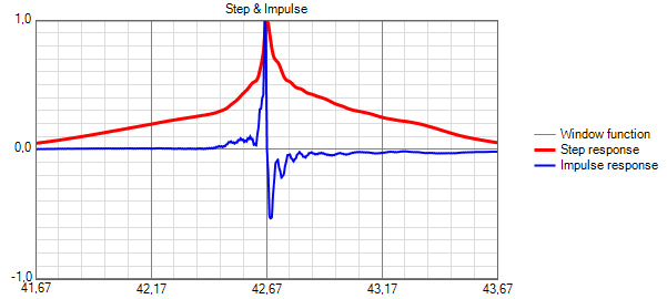

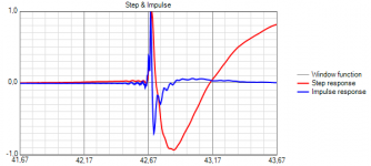

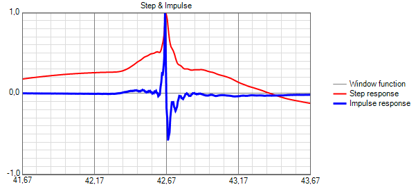

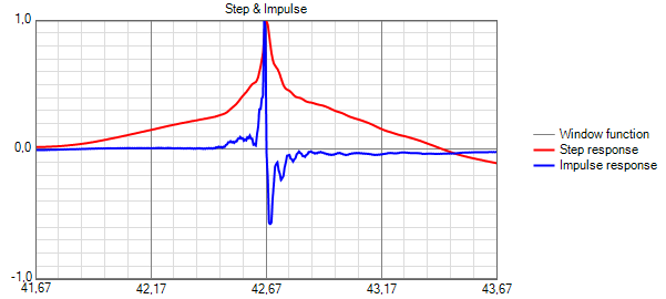

Nice work Tmuikkku! It’s tricky getting a 3-way Harsch to work! I have also noticed that the slopes don’t have to be textbook perfect - just close. However, whatever I did lately with the passive Harsch XO using the PTT6.5 and the RS28F in a waveguide seemed to provide a better “right triangle” shape than I ever got from the time I used to do DSP IIR filters. Those all looked like a “bread loaf with a spike” sort of like what you are seeing.

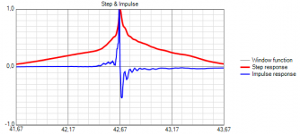

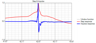

What I see now more closely resembles the step response from a first order XO:
When the step response looks like this, it is a definite improvement in percussive timing clarity and resolution vs the step from an LR4:
But some people are not as sensitive to this as they are to the little wiggle in frequency response.
Your observation that placing the tweeter below the woofer is a good one and I am already doing that:

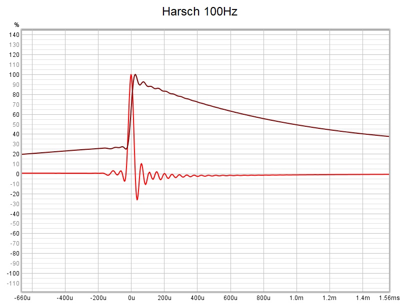

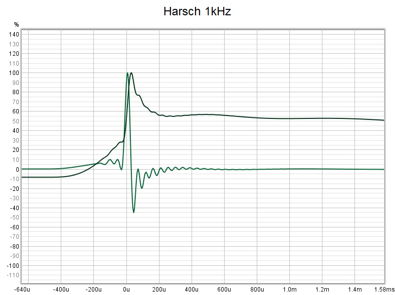

Good observations YSDR.
As luck would have it, i was measuring Harsh via IIR DSP this morning, and found xover frequency has a rather large effect on step shape.
Below are 1kHz and 100Hz, where both output channels are summed back together.
the more I used delay (advance on the woofer relative to mid and tweeter) the more there was stuff on the left in the step response. I'd quess harsh xo trick works better with a two way setup than threeway since less delay is needed.
Interesting - my XO is 3500Hz and looks more like your 100Hz one. Maybe I did find a new XO filter slope?
