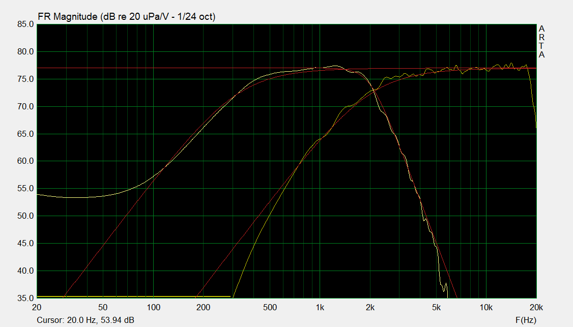

An update for my Harsch xo attempt. It seems like there is no need to use the 1.27 factor formula for creating the BES2 response with a DSP like Hypex are using. Just use your target xo point with a Q=0.58 2nd order high(or low)-pass.

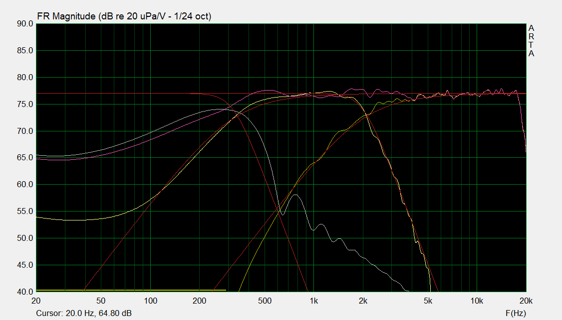

Below there is some of my measurements, showing the individual slopes with their target and the sum of a 3-way with 320Hz and 2000Hz xo target point and the step response. The woofer response is a victim of the gated measurement but I left it there.
The responses should be like that or I am missing something? Sounds really good but unfortunately the off-axis responses doesn't look as good as with the classic LR xo version.

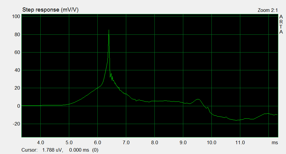

The step response you have looks like what they look like when done in DSP. When I did the passive Harsch XO, it looks much closer to a right triangle - almost like what one looks like from a 1st order. I think you have it.

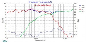

Btw, Bwaslo (author of Xsim) reminded me that by delaying the "amp" (delay between entire speaker and mic), you can get the phase to align itself and unwrap to see if you get the 55deg bump. In my Xsim simulation, I simply added -1.12in delay to the "amp" and I got this for the predicted phase plot - note the 55deg bump is now visible:
So YDSR, try changing overall delay between mic and speaker to see if you can get your phase wraps to go away.
