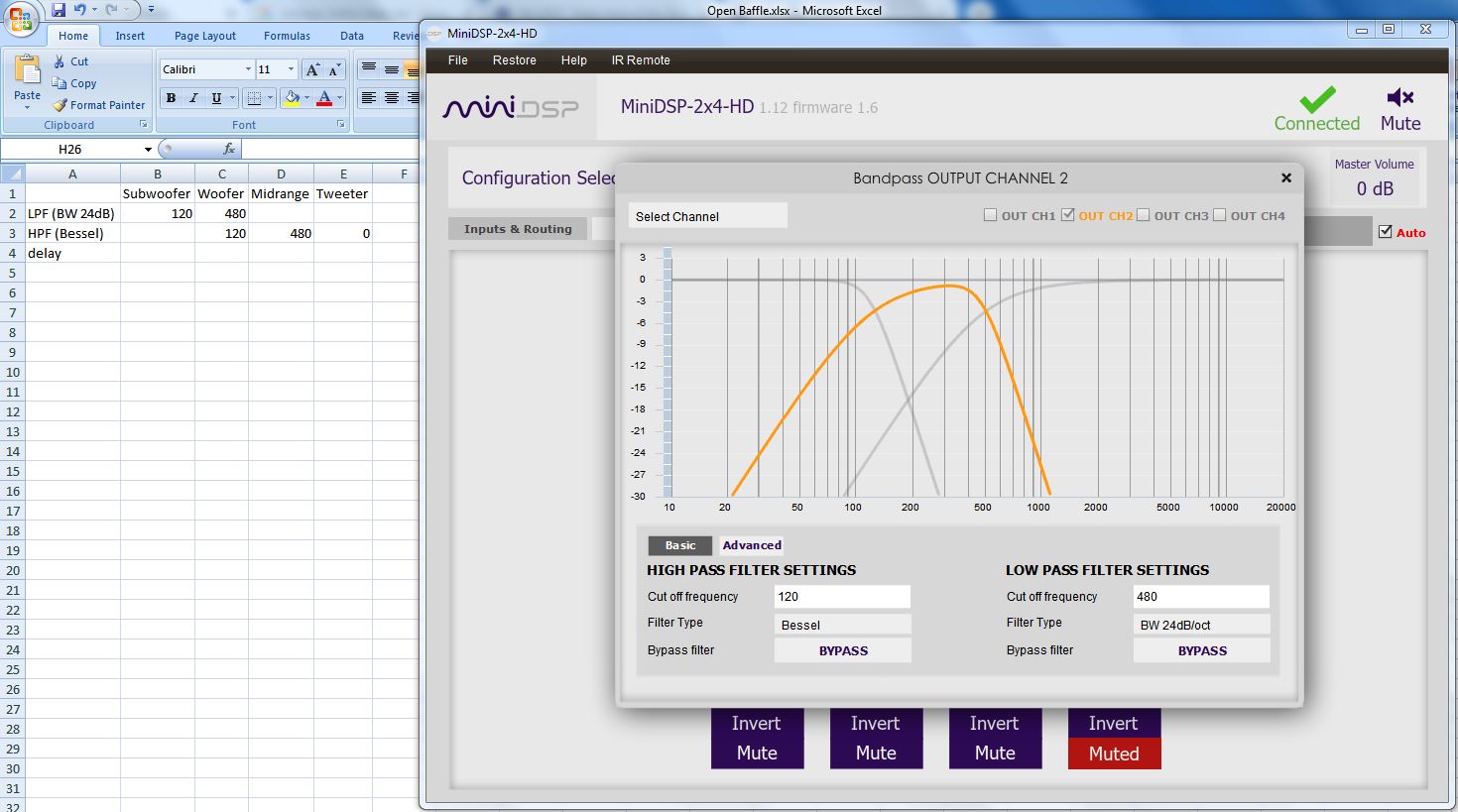

I wonder how this alignment would transfer to a 4 way system. Or I may try the upper 3 bands as in the first post plus LR24 below.
Sorry, my mind read you wanted to try this passively.
Then yes, I believe X has tried a 3-way using the Harsch XO. As long as you have 8 channels of DSP outputs, and the amps to power all that.
Yes, that is what I have now, using two t.racks DSP 4x4 mini. Standard LR24 on all 4 bands right now. I think I will try the 3 upper bands as Harsch and keep the lowest LR24.
I wonder how to measure and what to look for in the measurements. I have REW and UMIK and can do the basic stuff. I still fight with filtering out the room (how to set the windows) and then how to interpret GD and impulse plots...
Follow the recipe for the Harsch XO.
With your mic and REW, look at the impulse window, and tweak the delay the upper driver to get a nice clean impulse. You will see what's happening on the window, when trying some values up or down.
Do the first XO, then move to the next one, aligning everything.
I didn't even remember that I tried this in a 3-way. And it seemed to work if you look at the Step response.
I am not even sure what to do for a 4-way. I think 4 way is not necessary.
As long as you cascade all filtering elements into every drivers response, response can be flat amplitude and phase. Had that problem with my 4-way, tackled it but problem is DSP are not ready for my filter style....

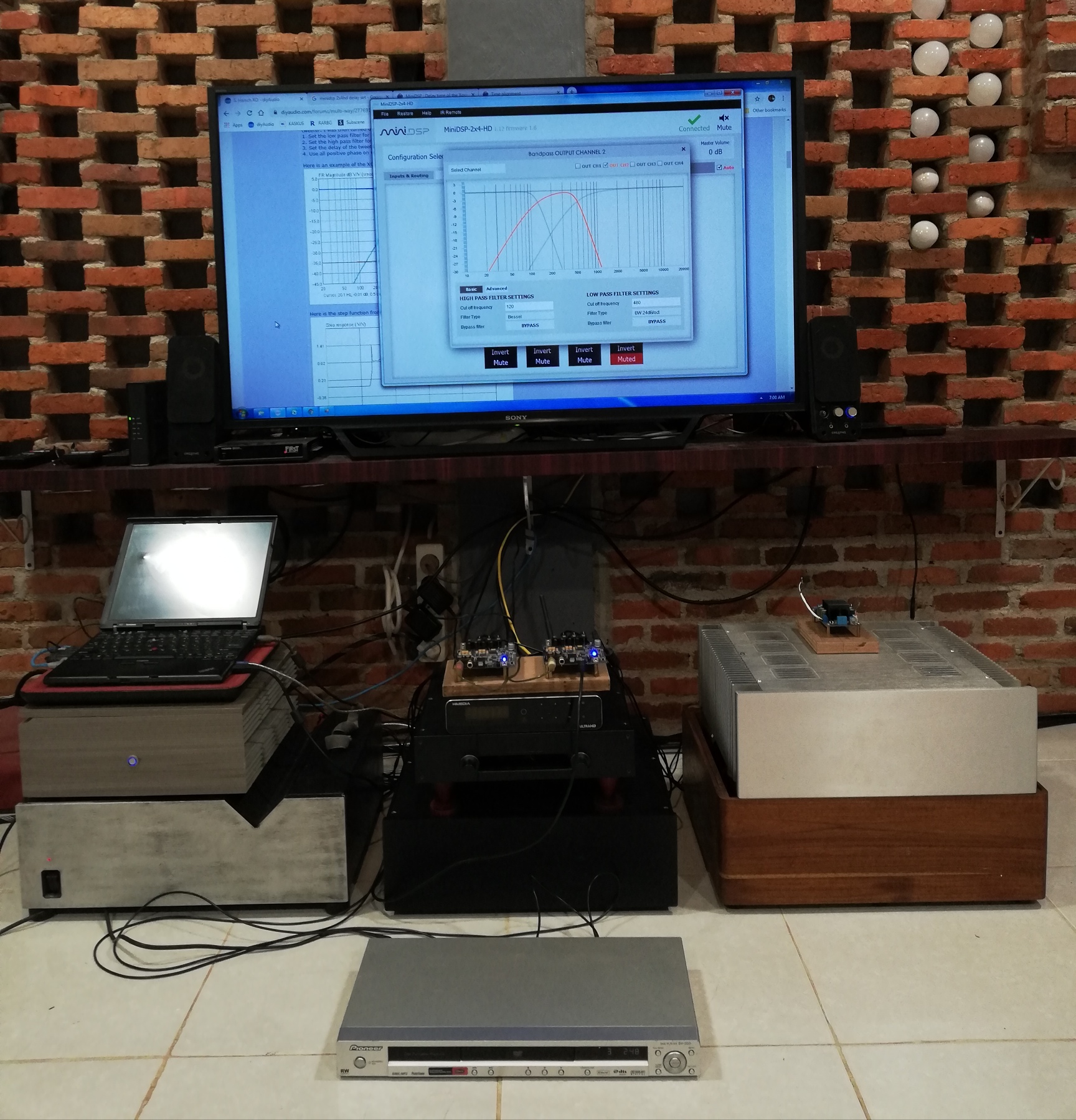

just powered 2 of minidsp 2x4HD to configure 3way as proof of concept and it works on basic setup. I have configured Crossover for Harsch but need to learn on manual FIR to setup the delay
- S. Harsch XO
