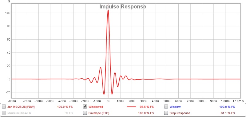

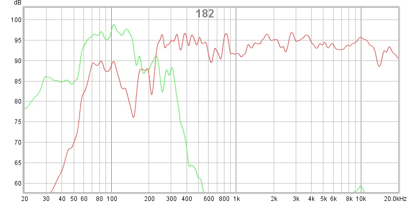

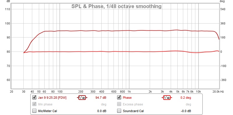

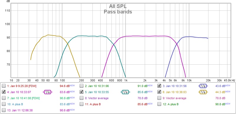

Here's a 4-way, using 48dB LR's throughout... 18", 12", and 2-way coax CD.
(I use 96 dB LR's now, but only have plots for the 3-way without sub, to show.)

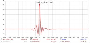

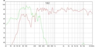

Hi BYRTT, ya beat me to it ...yes, what some mS and FIR can do for steeper sloped crossovers...😉

Nice textbook results. Must sound loud and clear as can be with the BMS covering the important stuff.
Three-way with 1x15", 1x6", 1.4" CD through baffle no horn.
Crossovers are LR48 600hz, LR24 600&1.5khz, LR48 1.5khz
While not as pretty as the shallower slopes, it's still much better than typical steep IIR implementations. Resolution is improved over the 24/12/24 setup I was using.
I would like to see if someone can get an even better phase linearity with steep slopes.

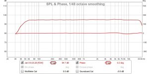

Because I keep coming back to this....
When I get ruler flat magnitude and phase...both of them ruler flat...Then step response looks awesome, as does impulse.
Heck, I think all measurements are just mag and phase shown in various ways...
And I now think step and impulse are the same thing, just shown differently.
Impulse response is so heavily weighted to the top end, I only use it to fine tune timing above maybe 6kHz. Impulse is also good at letting me see when room reflections are messing up measurements, but that's about it at my current state of learning. I don't know how to glean much from step yet, other than see how it improves with mag and phase.
So, mag and phase I know how to measure and tune.....
And 'everything' improves with their improvement.

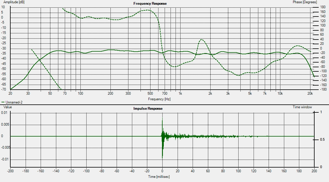

@Wesayso
Thank you for your detailed response 🙂
Personally I "only" have an IIR filter to work with right now. But I can hear that having an even FR do help alot.
Right now I cover 600 - 19Khz within +/-1,5dB
I do not compensate for the room, since I still find it difficult to believe that all the room-perfect solutions, can change the laws of acoustics.
What I do, is to measure my speakers in a reflectionfree area - well as reflection free as possible - using gating as well. Then I use 24dB LR and cross over where my midrange did not start beaming yet. So at least my reflected sound "looks" like my direct sound. My room is very uneven and I have some absorption at first reflection points and behind the speakers.
My impulse response, looks almost exactly like most other good classical speakers - no matter the price.
I will try and see if it possible to try and correct the phase with some extra software or device in the future.
I only correct for one peak in the room around 145hz. Below 90 hz I use 4 subwoofers to even out the FR - works great.
