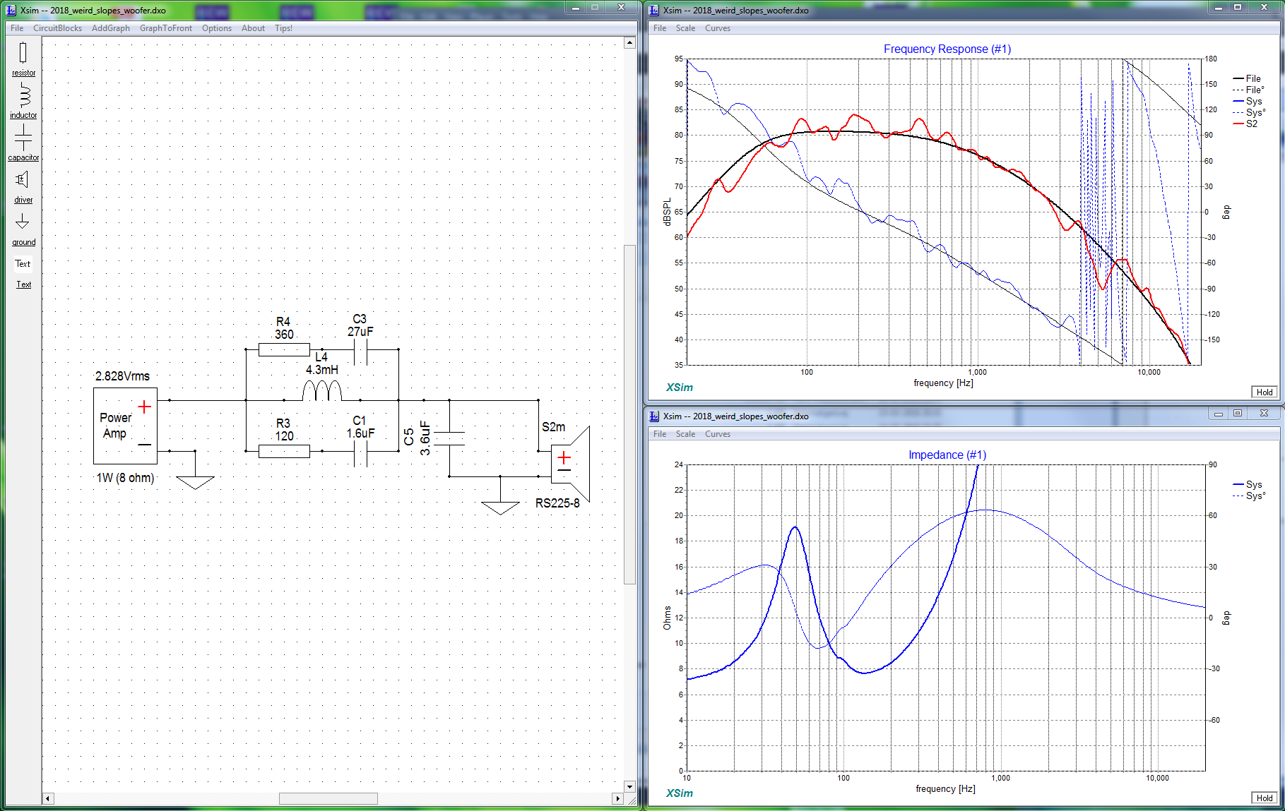

Hi Byrtt,

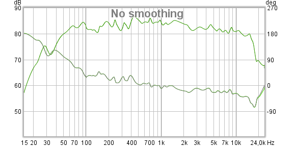

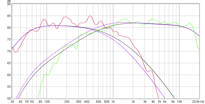

I know you think that the RS225-8 aluminum cone has problematic breakup as you show so prominently above. But in reality, adding a simple 4.4uF and 0.47ohm filter across the terminals pretty much effectively gets rid of it. See XO plot below.
XO design currently used:
XO is closer to 900Hz in practice but due to wide bandwidth of both drivers I don’t think it matters much is it’s 600Hz or 900Hz.

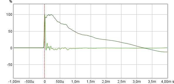

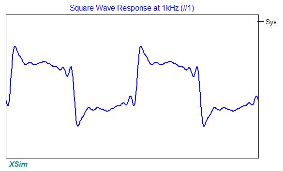

Here is predicted square wave response at 1kHz for about equal contributions from RS225 and from 10F:
And in fact, listening to the speakers in comparison to headphones at the same position the speakers sound very nice. Similar response and balance and overall feel.

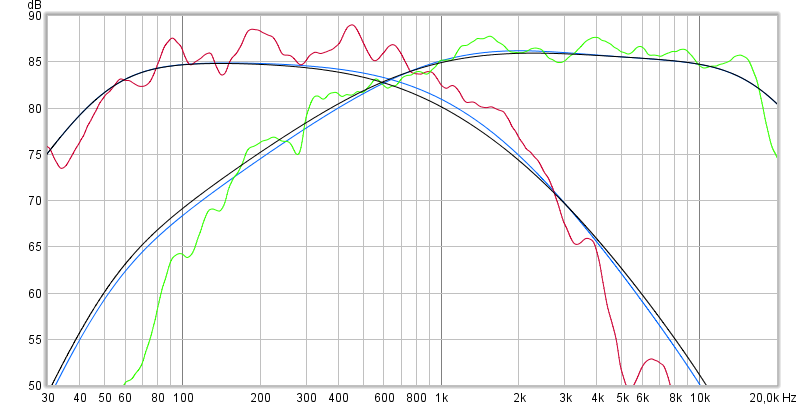

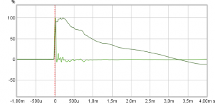

Shure on your XSim graph that design axis slope looks nice but then it loose its wideband quality compared to how a named 1st order slope would have looked and end up be a designed waveshape distortion element that the absolute phase verse MP phase back in post 577 shown attached below makes clear over a wide range starting in area 600-800Hz and up, in diy world designer can probably stop here knowing he listen to his own homebrew math of summing slopes, in pro world to take advantage of a math scheme named 1st order slope it takes more than that to call it a name and keep wave shape non distorted as it supposed to be.
To really call it 1st order transient perfect and superior to design compromise using Harsch slopes see below pointers how your objective amplitude data post 573 should look on design axis, and its not about be within either plus or minus 20-25º relative to flat phase to have a transient perfect wave shape its about be close to textbook prediction else there is non intended wave shape distortion to deal with or else call it something else to be transparent about it. Can't know but there is probably reasons why very few products claim acoustic 1st order slopes, what i know from hobby trials is that subjective sound will change enormous fixing a small design error in a 1st order system compared to small fixes for higher order systems.
...XO design currently used...
Attached zip folders below are two set of weird target slopes that are transient perfect maybe they worth a try.
Alternative to black from previous post is this blue target attached below, not much difference from black but still maybe advantageous when drivers coverage is on the edge.

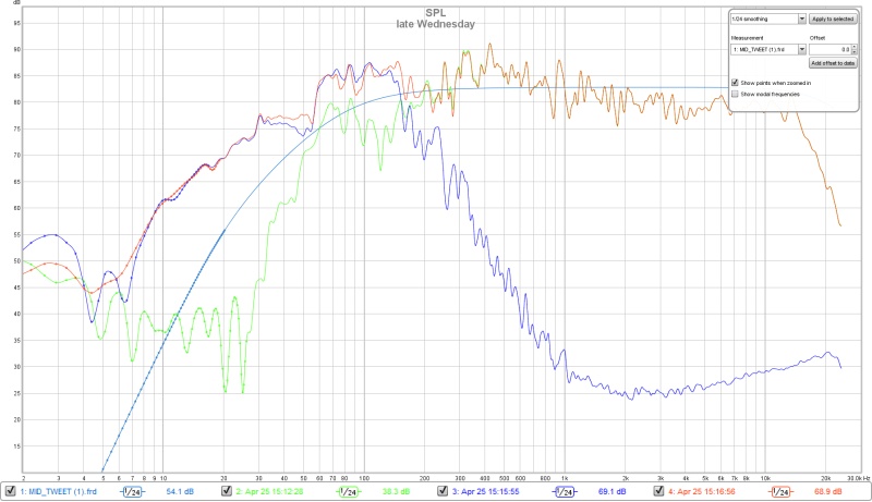

BTW using the old XSim project file from 2015 where RS225 was measured on a bit different design axis below attached XSim network can hit the black target fairly good, with the notice in below network RS225 response from 300Hz and up is very less damped compared to 10F so maybe its a good idea add inductance compensation network for RS225.

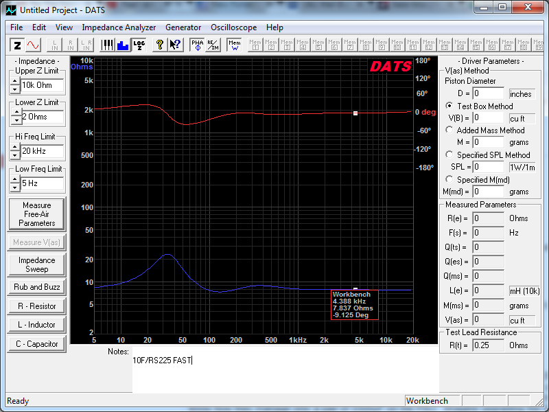

Thanks for RS225 inductance compensation network, Byrtt. I am not sure if that is really needed considering the measured impedance response for the speaker system as a function of frequency. It looks fairly benign as XO’s go varying from 7.5ohms to 25ohms without any major peaks.

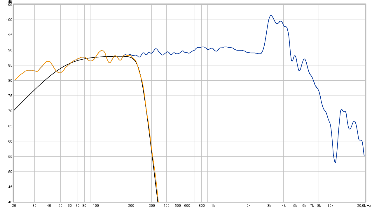

As for XO, using a miniDSP, I was able to try anything from a simple 1st order to the Harsch... to me, the Harsch wins every time. But only really feasible with a miniDSP at the low frequency XO we are using. Cost would be prohibitive going passively so low.

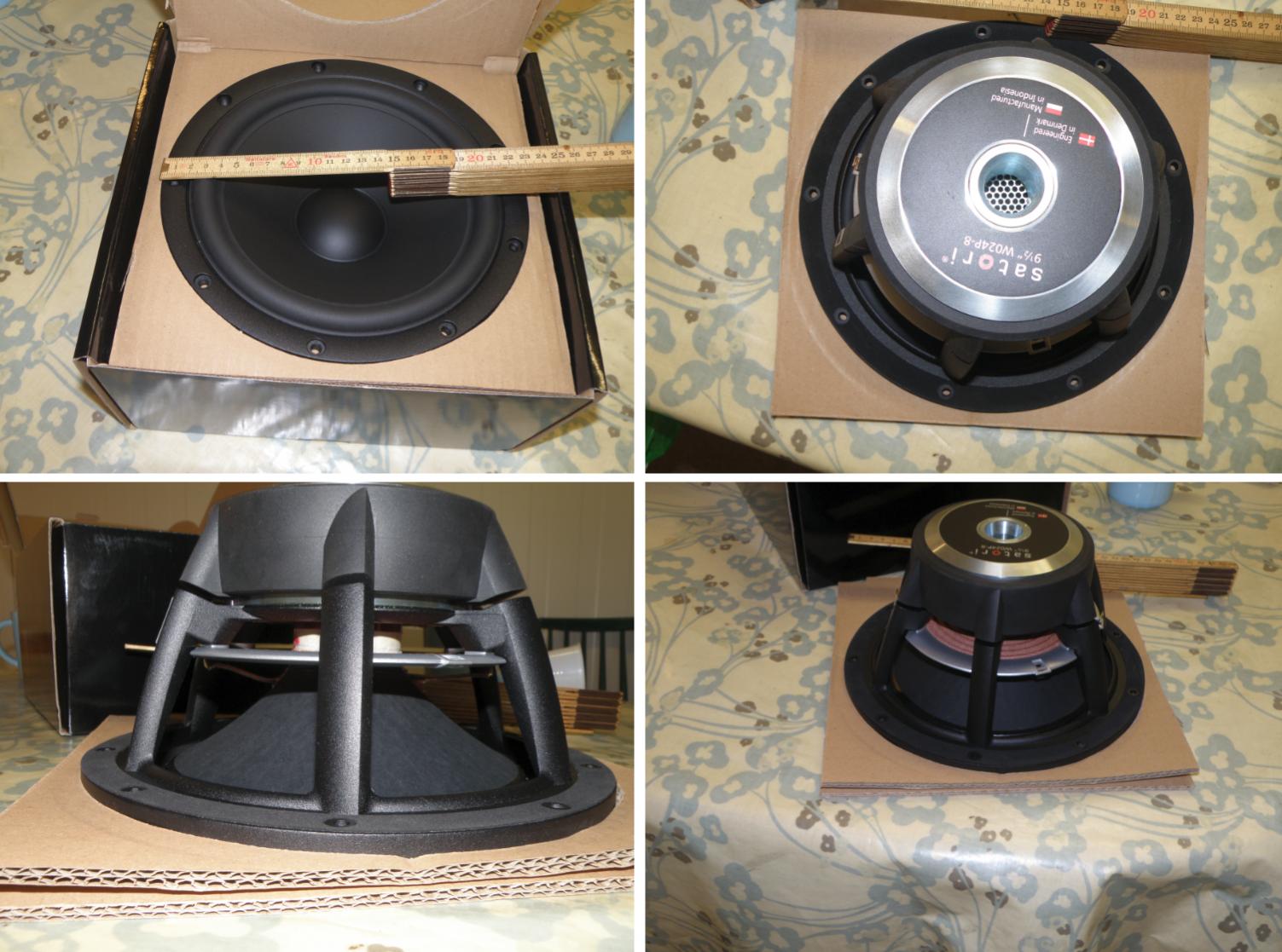

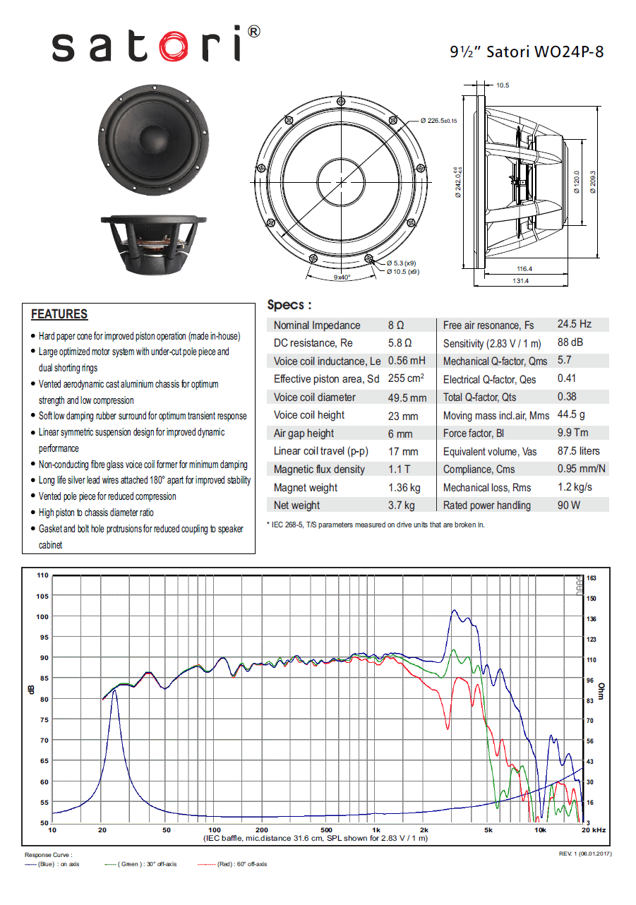

Hi Brytt,
The FR for the Satori has horrible peaks, which have to be supressed, so why did you choose this ?
When I think about the time and effort neded to design and build a good speaker I realize that it is significant. Reading your posts makes it clear to me that one must put in time to understand the finer points, have the discipline to exercise attention to detail. Most likely I would not develop any good speakers first time, as experience is so important so I try to ask questions here and there! As for DIY we are building for ourselves it makes no sense to choose low cost parts unless they are v good, it makes more sense to pick good parts that will ease the journey and make it more likely to achieve good results. This is why I was thinking to ignore cost, but of course it should be sensible!
For speaker design I am a learner, with only experience of single driver full range. I am curious about multi driver because of the compromises in full range that I experienced. But there are so many new compromises in 2way to understand. I wonder if coax is a good place to start for transient perfect instead of Harsch?
That Satori is fine for a Harsch XO, since the woofer is a 4th order, cutting it in between 500 to 800 should be ok.

About that SATORI will expect all the attention that had been put into its huge ventilation windows and other stuff will pay back with good real world numbers and that horrible peak is not loved but its up so high that it shouldn't be any problem. Below blue trace show datasheet curve plus black trace for my band-pass target and if we take that raw datasheet curve times a low pass textbook 96db/oct LR we get that orange trace and as can be seen looking -50dB down looks absolut fine, but then again because i can and have all the DSP power one can dream off i intend to EQ that raw curve flat before it gets LR low passed.

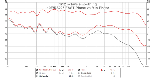

Be aware many whizzers have a acoustic mechanical XO point that adds excess phase shift same way as minimum phase electric networks do and you can see it in REW ask it to plot minimum phase curve that belongs to actual amplitude response using "Controls" "Generate minimum phase" and also waterfalls would be distorted by that point of delay. Don't think such mechanical feature is most linear and easy to work with and smooth out using upstream electric correction, for example if raw measurement is a precise basement one can correct a TC9 or 10F with a inverse electric correction curve upstream and driver starts to sound smooth as was it pure silk as long as ears is within a closer distance than any nasty reflection points, where my personal trials with whizzer cones never gets to that point of smooth clean magic without a layer of some buzzing signature, although will expect one can get rid of that added layer if driver is low passed and used below the mechanical XO point.

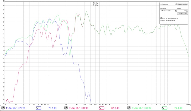

for my OB 12" woofer and audionirvana clasisc 8", I'd like to use passive xo on AN and use behringer nu3000dsp for woofer. any advise whether this is a good path for passive approach before i buy passive xo parts? I'm thinking about 200Hz HPF for AN, maybe it does not need any delay for this low fc.

To be a pure Harsh filter at 200Hz it will need AN relative delayed 2,5mS (1/200 x 0,5) or physical offset about 85,75cm behind woofers acoustic center, and looking at your nice OB pictures it looks there's a super tweeter involved in system that also need that delay or physical offset, so my 2 cents would be if you end use a electric device in chain to achieve delay its smarter get a device that at same can dial in the XO slope.

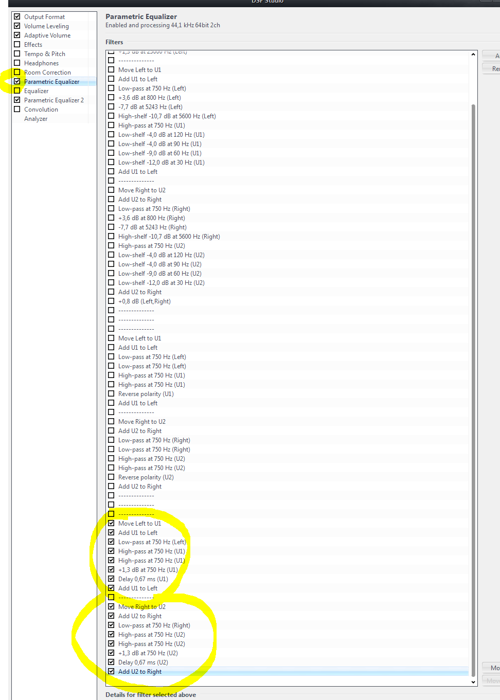

If you really like to hear what Harsch verse LR2/LR4/BW1 can bring try a player as JRiver or Foobar, because its possible using head phones and set up DSP engine so it split L/R channels out into AUX busses then add XO points and delays and downstream sum them again to normal L/R channels, this way you can compare how it sounds into a controlled acoustic head phone environment. As example see below how it could look in JRiver marked with yellow for Harsch, some of the filters above is for BW1 and LR2/LR4 and can be ticked on for listening trials.
