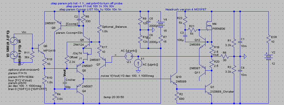

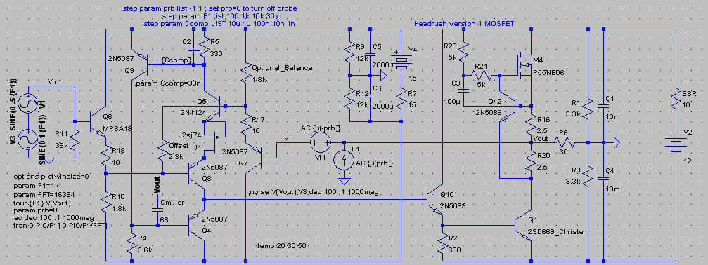

If for some reason, the output sticks at one voltage, while there is input, often the NTP will draw several hundred mA trying to correct it. A resistor between the emitters of the NTP has been suggested to help with this, but I like this idea better. Using a Jfet here is a more complete solution. The 2SJ74 here limits the NTP current to 10mA. This should also help keep the transistors from heating up during overload moments and causing memory distortion. Of course, it's best to avoid overdriving in any case.
R17 and R18 should be calculated for the closest match the DC impedance of the Jfet at whatever quiescent current you operate the NTP at. Here it is about 2mA, and according to simulation the Jfet impedance is about 26 ohms.

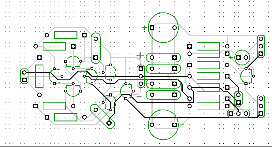

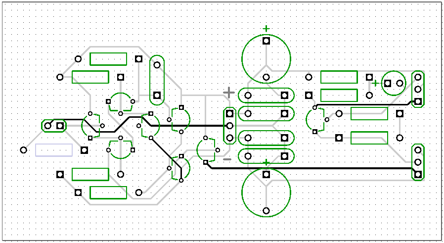

I wasn't able to test the prototype further, which I think I will do soon. However, I have made several attempts at a PCB. Attached is my current one. I'm pretty sure this is the most compact it can be, although different capacitor placements can be made. It should probably be expanded a little so as to be easier to service.
For me this has to be an experiment, since I've never made a PCB. So I would appreciate advice...
As for the schematic, notice the addition of J1. This works better than a resistor for overload protection, just remember the Jfet's CCS current should not be below the Rush's bias current, or very near it. This isn't included in the PCB.

Ken, that looks nice. Thanks for the link. I had a few PCB's sitting around that I could Manhattan on top of but they've been consumed by the pile that slowly levels out toward the center of my room...
I was told OurPCB has a prototype policy where they'll send you a board to test out before doing the whole production. So if I ordered several PCBs, they would send me a sample and if things didn't work out, I could cancel the order. This would speed things up quite a bit. Am I out of my mind?

Added a jumper to change between voltage and current feedback mode; I'm curious to see the affect after reading this thread:
http://www.diyaudio.com/forums/vend...lifiers-revealed-much-more-4.html#post2192006
The current feedback resistor doesn't do much in voltage feedback mode. It can be bypassed if it's not used. There is some sort of standard for series resistors in headphone amps, but I've talked to people and I've been recommended the values of 0, 10, and 120 ohm series resistors. I figure I'll just let the builder decide on their preferences.
