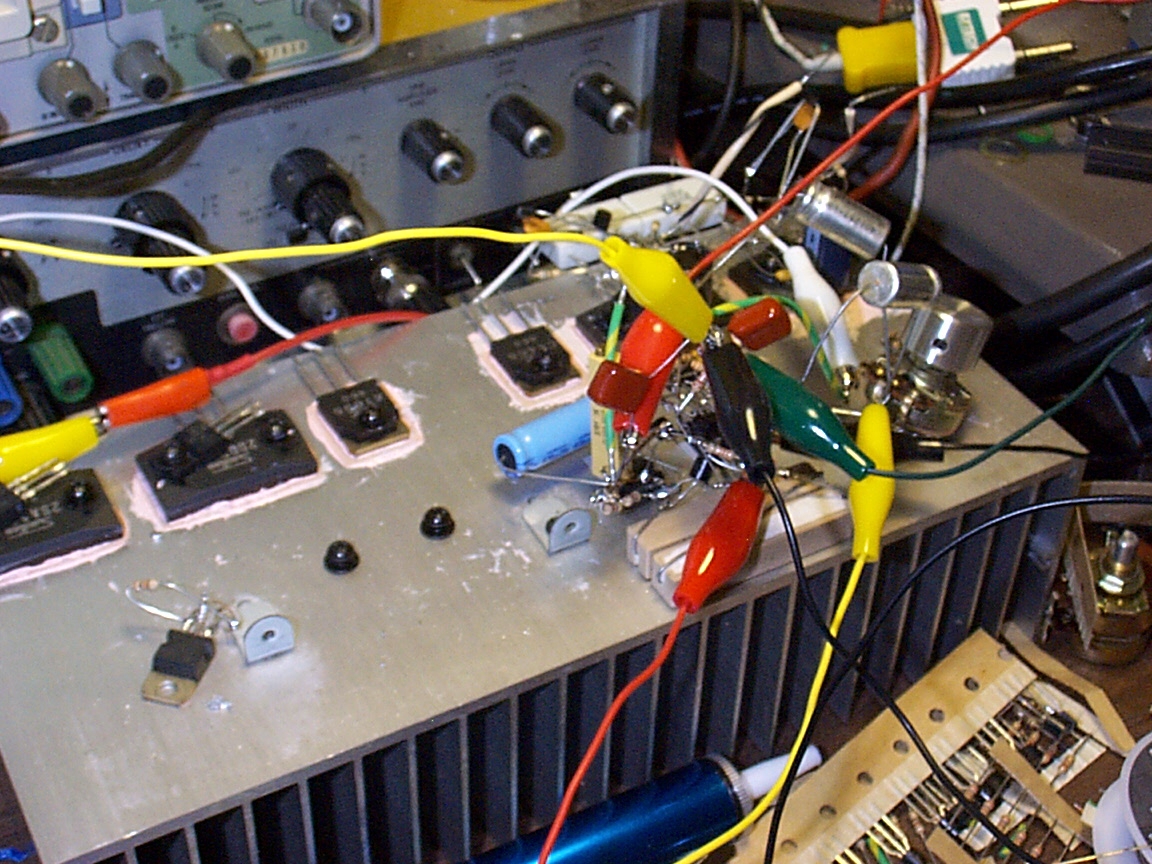

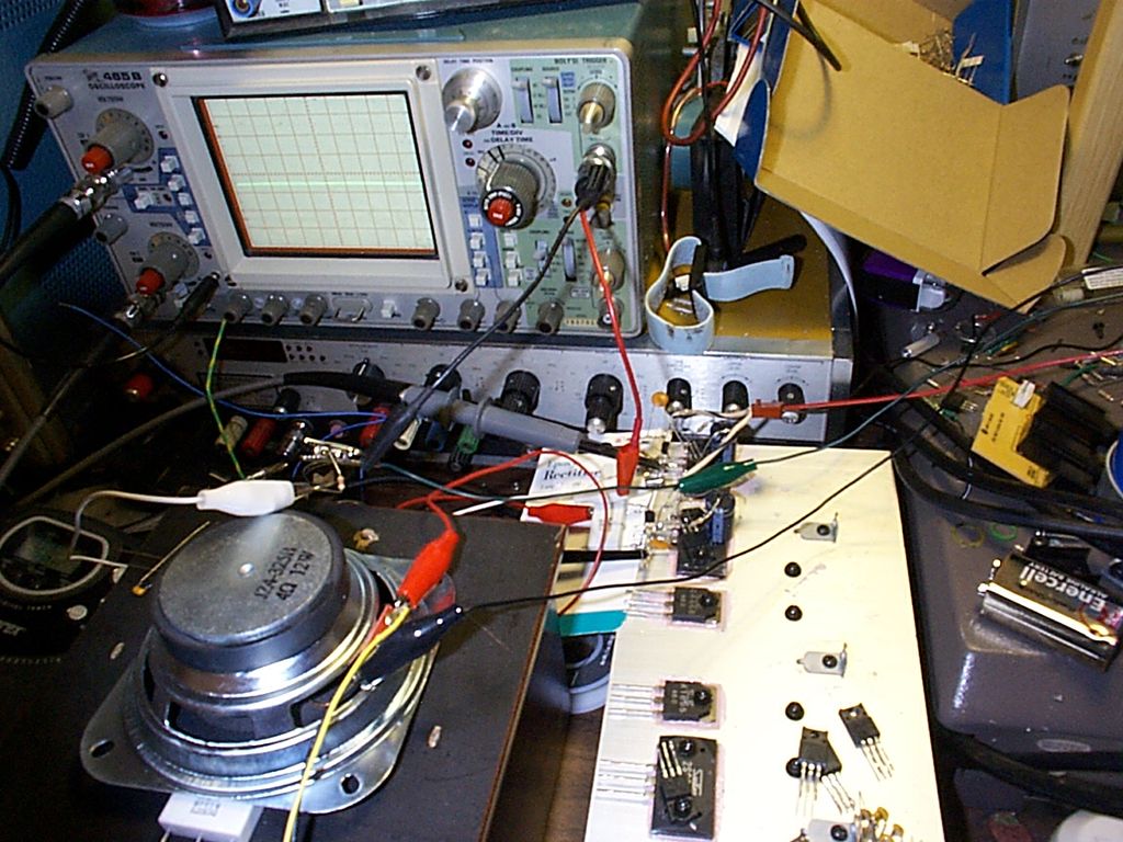

Alright, here is the state of the project:

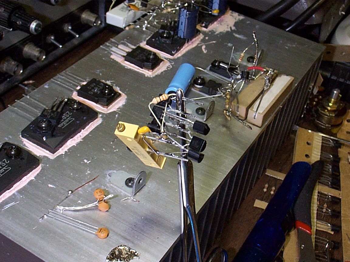

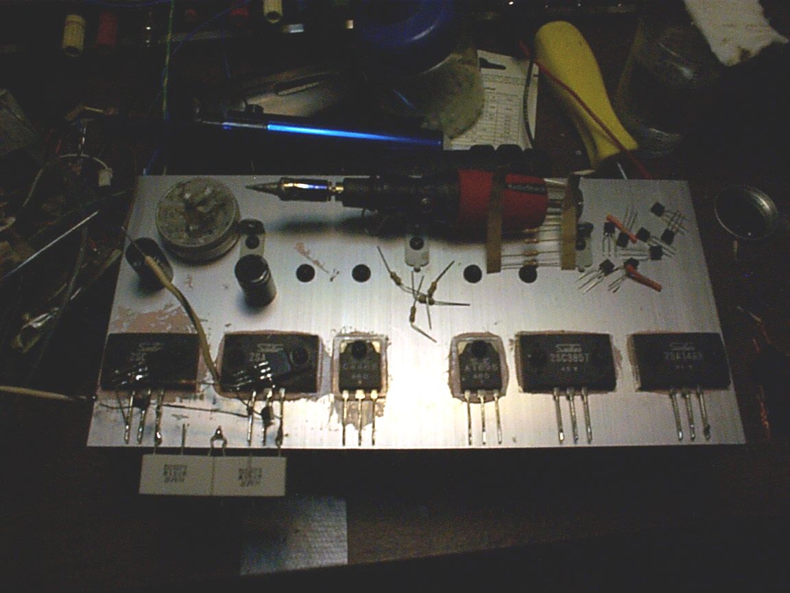

I'm going to rewire the entire circuit on my shiny new amp testbed (see picture). I absolutely abhor using copper wire, since the solder doesn't stick to it and it tarnishes so darn fast. So I'll probably end up cannibalizing that silver stuff they use from some device sitting around. I'm running out of solder or I'd probably have it built already. I haven't been able to find those Ge transistors and try them out on the Allison, but the Allison will remain constructed while I work on the headamp so I can wire it up whenever I find them. After the headphone amp is set up I will even be able to use it as a frontend for the Allison and drive speakers.

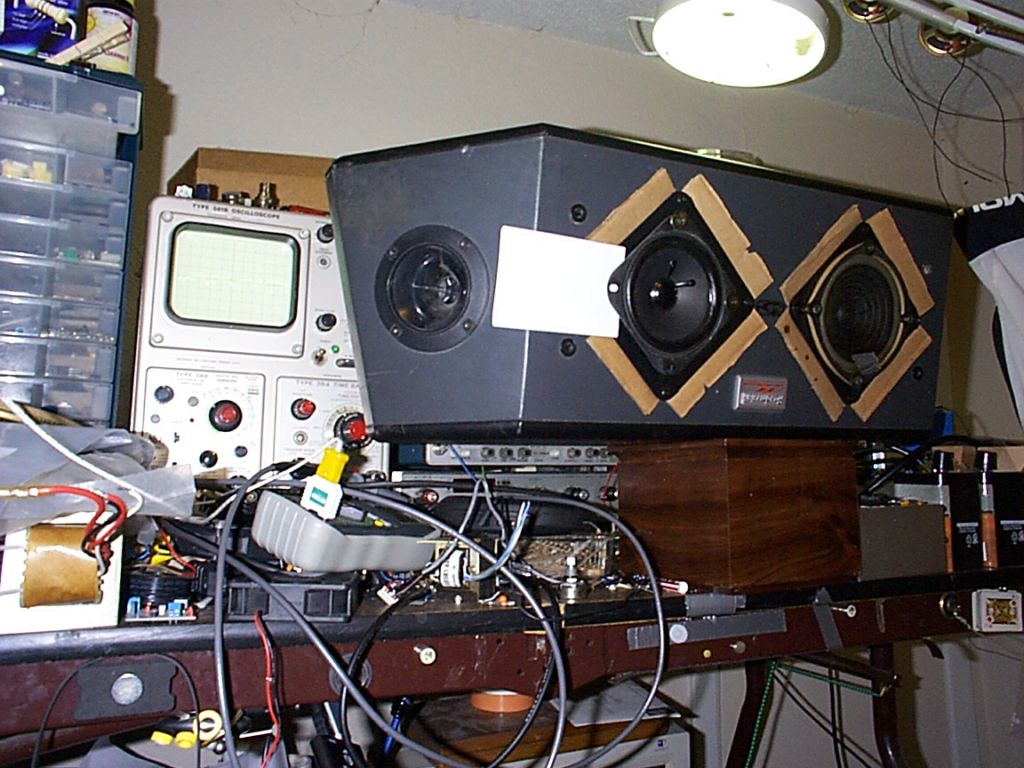

In the meantime, here is the Allison running. It produces sound. Surprise surprise, it sounds a lot like the speaker I connect it to (so it doesn't sound that great...)! I'm too afraid to test it on my new speakers, banish the thought. However a family member came by and commented on the "really smooth" sound, for what it's worth (this person is very sensitive to high pitched noises, so perhaps she would know?).
I planned for it to run at +-15V, but +-6V is already more than enough for my speakers, and at this point the drivers and outputs begin to get hot.

I haven't tried them, didn't think of it. However it would allow me to use one of those dual .22 ohm resistors you get by the handful from dead amplifiers... I'll wire it up next.

The .22 ohm resistors were the perfect width to go from emitter to emitter of the output devices... EXACTLY.
EDIT: Okay, I realize this response doesn't make any sense. What I meant to say was:
I used two dual .22 ohm resistors, one per output which gives .44 ohms per output, giving 1.3A bias for the Allison. This would take 8 of those .12 ohm resistors you gave me. Even with germaniums, it would take 4. More economical to use the old ones...
- keantoken
Leave em connected as-is, and just short across one .22 per output emitter.
Though thats only 1.13A if Germanium comparator drops are 0.25V apiece.
Why your class A quiescent only 1.3A anyways? When you got 6A supplies?
If your trying for AB, you need some diode curve. Can't get there with just
resistors across the gap. I don't think AB was your intent, so I can't fathom
why so much resistance was used?
Then again, you got 25ohm series resistance added to your speaker, I don't
think you could tell any difference 50 ohms between emitters.

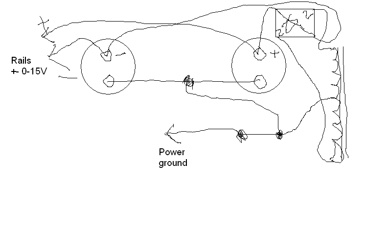

My supplies can push more than a few amps, but grounding is just an alligator clip between the ground terminals on the caps and I fear hum may be too much if I increase the supply. I also don't know how much my variac or the several in-line fuses will take.
Actually with +-6V the amp doesn't have enough voltage swing for a 25 ohm resistor. A 4 ohm has been good enough for testing purposes. I'm testing this with my old kevlars and a few salvaged speakers.
I've attached an image of how I have my grounding set up... I suppose I could slide the alligator position along the wire between the caps, I'll have to test that but I think I tried it and found tests negative...

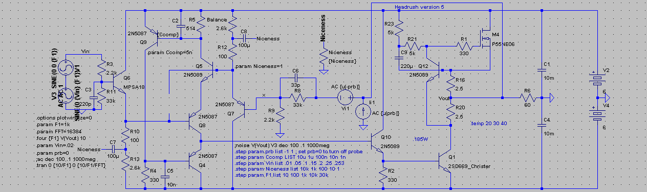

Alright, a further state of the project:

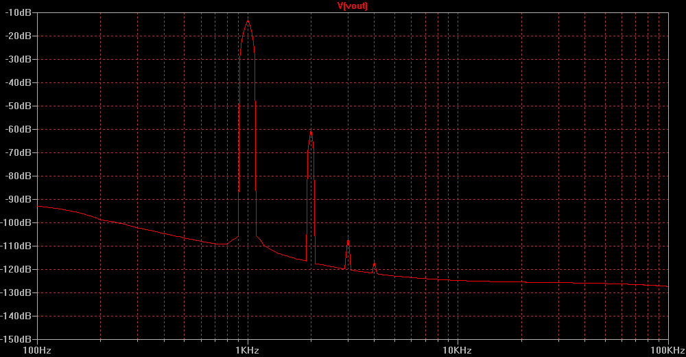

I think the circuit itself is becoming finalized. I may add some things for improved clipping.
I am going to test out a current-type compensation, C5. I've trivialized the "niceness" function. If the Niceness is turned up, even harmonics are boosted but of very low order. The amount of odd harmonics will vary but will always be very low, and I believe this can be tweaked with the Balance resistors. C8 and C7 serve to filter ripple and increase PSRR, as well as facilitate the "niceness". I may opt, instead of putting the offset resistor between the bases of the Rush pair, to turn R5 into a trimmer, which is more trivial from a design standpoint. However I've never seen this done.
There is a mathematical relationship between all these values and the harmonic profile, I will see if I can determine it and make a flowchart for customizing the NTP this way...

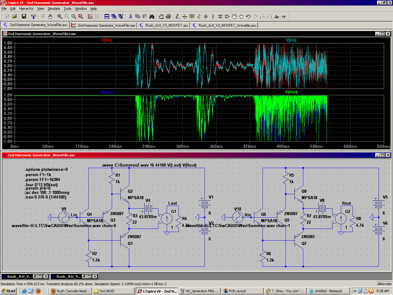

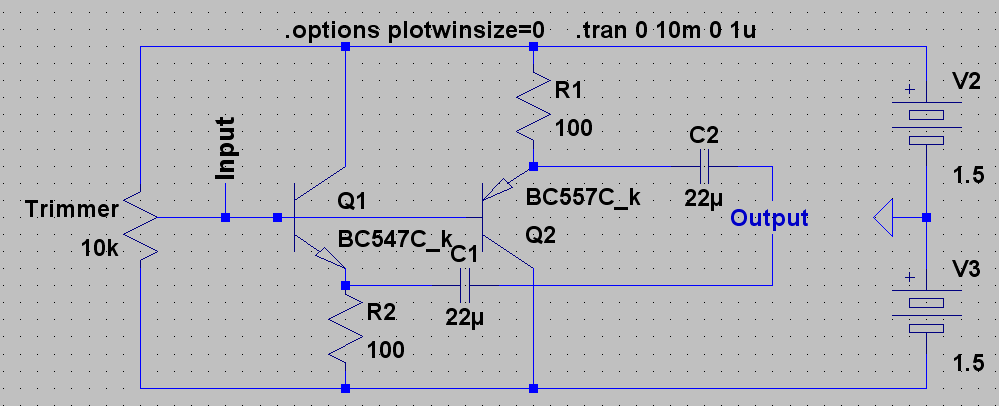

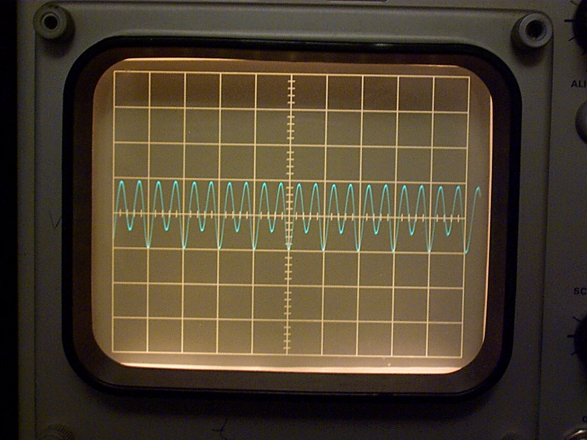

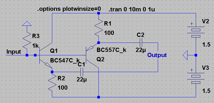

Attached is the FFT of a sine input with "niceness" turned all the way up. This is measured at about 1mW into 60 ohms; to get 4ths above 3rds here would be a feat of matching since levels are so low. I've also attached a circuit you can build and test out. Hook up a preamp or something and listen to your voice shifted up an octave! Scope shot of the same circuit, doubling a 500Hz tone. And then, a music file played through on the simulator...
It should be noted that 2nd harmonic generation depends on input more than it does the circuit itself. It depends on the music signal, and a sine wave tone cannot reveal this. Matching devices won't matter unless you're one listening to sine waves. As long as the music is above a certain volume, you will be getting virtually the same amount of 2nd harmonics.

Okay, I've got it working.
Very interesting!!! Definitely distortion!!! I have to take back my remark about listening to your voice and octave higher... It would be, but very harsh and hardly recognizeable.
It doesn't produce non-musical tones, I can tell that much. It does move the mid up to treble so everything sounds like a snare...
Might make a good distortion pedal...?
- keantoken
Here is an improved circuit which allows you to totally "tune out" the fundamental. It is easy to do when listening to sine waves...
I have no doubts this circuit could be used in RF to double the broadcast frequency.
Well, listening to bass, I think it could make a pretty good X-bass circuit...

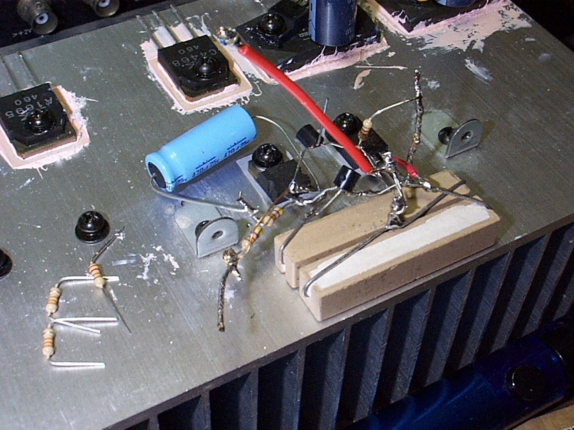

Oscillation did not respond to 1uF decoupling.
I have a local HAM club meeting to check out later this afternoon, so I think I will stop here before I burn myself more severely (ouch!).

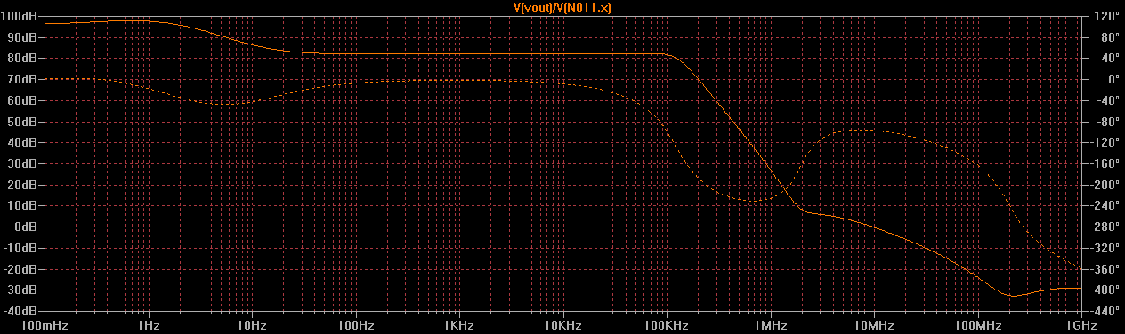

Next thing I try will be a 10R resistor in series with C5... Giving this cap 0.1R series resistance in the simulator gives remarkably similar oscillation as what I observed on my scope.
The series resistor is not a well-known technique when it comes to stability compensation. Kenpeter taught me this trick. We shall see...
