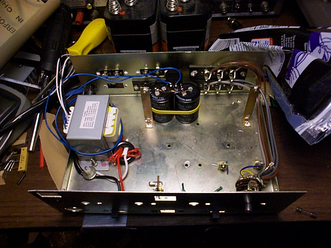

Just wired up the caps.

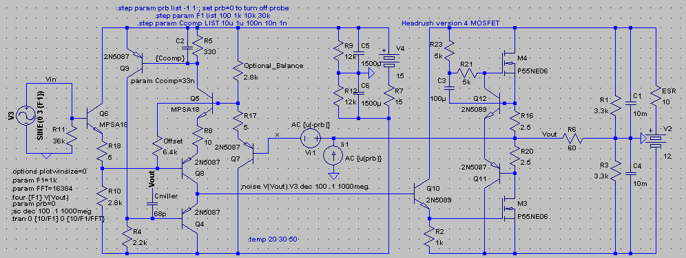

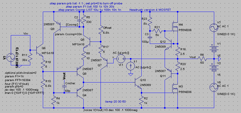

kt, you around? Your latest is oscillating on me (ltspice). Would you like to exchange notes?
Here's my sim file.
Here's my sim file.
I'm still around, gathering up the courage...
Figured out your problem, Iko, the compensation cap C1 isn't connected to anything on the node end. It should connect to Vout.
Also, your input voltage should not exceed the voltage across R15, or else the prebuffers/levelshifters and their sources will start switching.

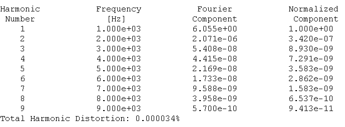

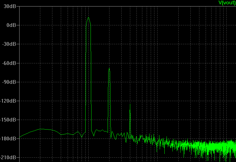

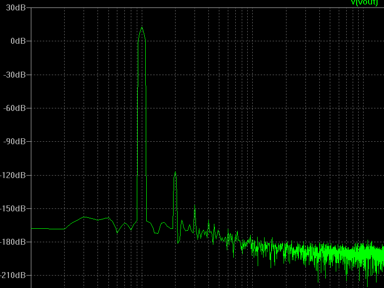

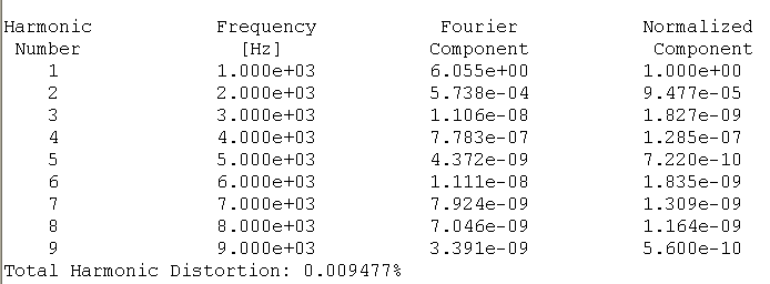

Oh, thanks. OK, now here's my nitpicking. Remember your earlier version that had H2 and almost no trace of H3? 😀 That I liked. This one, and in fact every one with gain, has some sizable H3. If you got some version with gain, and with only H2, that would be awesome! Whether it has mosfets or bipolars on the output isn't important to me.
I liked that version too, Iko. But the odd harmonics were there, they were just obscured by the noise floor. My recent changes were meant to make sure the even harmonics were audible.
They can be tuned out by matching the Vbe's of the level shifters. Note, that the NTP and amplifier mechanism itself generates practically no distortion; all the distortion is generated by the level shifters. Beyond that, the current through the level shifters should also be equal. (Note: I tried the simulation models of matched transistors and THAT arrays, but what we need for the level shifters are a matched NPN and PNP pair)
I've constructed a circuit on my breadboard for matching, but two transistors are showing 300mV difference at the same bias current of 15mA, and that can't be right. I'm not sure what's wrong but the diode function on my multimeter read them within 10mV. I don't think I'll trust breadboards ever again.

You can test this out by modifying the models. The 2N5087 and MPSA18 models get remarkably close in Vbe, which is just convenient for simulation. To get better matching, try varying Is in the models.
Wait, wait, wait 🙂 obscured by the noise floor means H3 is really small, and I wanted a listening test of that, but with gain.
Doesn't sound very appealing.

Weird "DC" readings that change with the touch of a finger are often a symptom of HF oscillation.Touching my finger to any spot instantly shifts the trace up several mV,...
Ditto.... but two transistors are showing 300mV difference ... and that can't be right ... my multimeter read them within 10mV....
[OT]Playing with little transmitter circuits, it's not unusual to have your multimeter tell you a transistor's BE junction is reverse biased, while it's conducting hard enough to get hot![/OT]
Don't mosfet's normally need gate stopper resistors for stability? - (tied directly to the gate pin, not via breadboard etc). Maybe that's a problem?

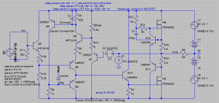

I think you're right Iko. I think this experiment of mine should end. Here is the original idea upgraded so it's "up to date". Even if the shifters aren't matched, odd harmonics should never go above even ones, so I guess it's a win-win. THD plots are the same as in the first post of this thread.

Maybe the mosfets? 😕If that is the case, what is oscillating?
I haven't used them myself, but every mosfet power-amp circuit I've seen uses gate resistors to prevent oscillation...
edit: Don't you have experience with these things, Iko?
In kt's circuits I've seen the I/V probe that's used to sim the phase margin. I haven't looked at that yet for this circuit. In reality it's easy enough to stick a resistor on each gate. But if he doubts the breadboard he'll never be sure until he builds the circuit on copper or point-to-point. But hey, I'm not an EE.

Hey kt, the circuit (in general) seems very easy to get into oscillations. This isn't criticism, I'm just saying that IMHO one cannot expect to build the circuit with the exact values from the schematic and be 100% sure that it will not oscillate. I think the builder should expect to tweak the circuit until it is steady.

Here is what I'm about to build. The Balance resistor would be used to tune the "sound". Changing balance changes offset, but balance is fairly independent of offset (or just leave balance at 6.2k, it may not matter). So, adjust balance first and then worry about offset.
As you can see, rails are fairly low... I made an error computing the transformer voltages, but nothing devastating. Unfortunately it clips at -2V, but I don't think I'll need that much for my headphones.
