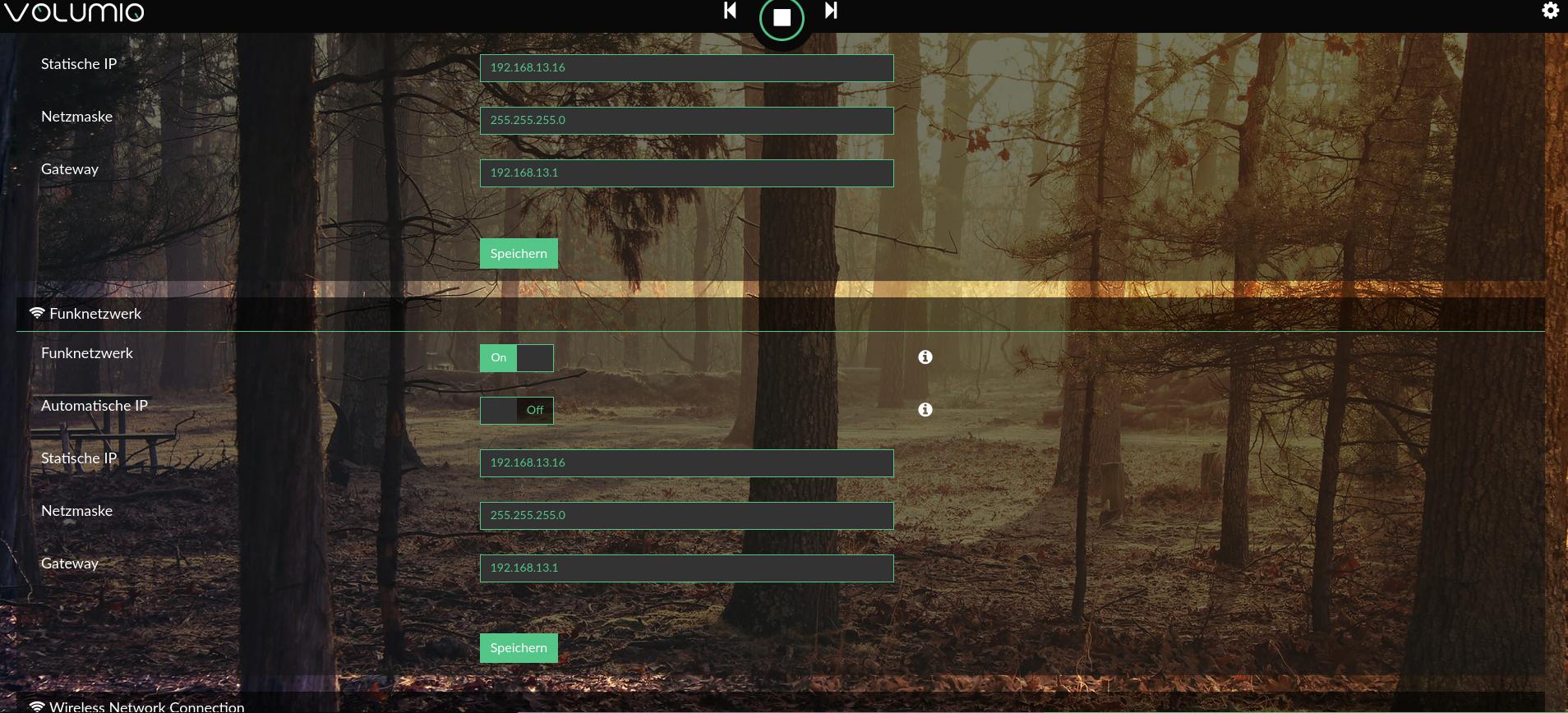

I just plugged it back into the hub via ethernet cable. Hub manager now just shows the Pi device. Connection type - wireless, status not connected. Attemps to connect to it's IP address time out. WTF!

Now unplugged from the hub i can no longer connect to volumio using its own hotspot. I'm starting to think my board is faulty. How do you guys deal with this madness? computer logic is very far removed from human logic.

Looks like you have two different connections (wired and wireless), which is why you get two different IPs. Only the top top connection shows as "connected" though. When you set up Volumio in hotspot mode, did you connect it to your wifi? Did you change the tablet's connection back to the wifi network or is it still connecting to the hotspot (it shouldn't)?.

Thanks buddy but I think this board is faulty. I did the setup first time around no problem. Logged it into my network, got it to recognise my DAC ok etc but it's just not working wirelessly. The pi case might be blocking it's wireless signal but it shows up ok on my hub manager, it just won't let me connect a tablet or my laptop via the WiFi. Any attempts just time out....and now it's own hotspot has stopped working. Think I'm beat to be honest.
I think it prioritises the network with the best connection and if you look at the screenshots you posted you can see that only the wired connection is active. The wireless connection has been active (because it got an IP) but isn't any longer. Several things you can still do, restart, wait 2 mins to ensure it is booted up, check whether the hotspot network reappears etc. If the case is metal it may also degrade the signal, so the wired connection might be better and more stable. When the board it is running, you should be able to connect to it via volumio.local or the IP address as described above.
I set up volumio in hotspot mode and inputted my wireless network details ok. Its no longer able to connect via the hotspot. With it plugged into the hub I ran through the setup again but everything appears fine. My DAC shows up ok and the volume bar is almost max.Looks like you have two different connections (wired and wireless), which is why you get two different IPs. Only the top top connection shows as "connected" though. When you set up Volumio in hotspot mode, did you connect it to your wifi? Did you change the tablet's connection back to the wifi network or is it still connecting to the hotspot (it shouldn't)?.

It works with a wired connection but it's no use to me stuck in the back of a closet out by the front door. I can't sit on the hall floor with my headphones on lol. It is useless as a headless device without wifi.

Adress assignment: Not DHCP
In the setup of volumio you have to give volumio a static ip-adress. No dhcp. Forget the hotspot!
