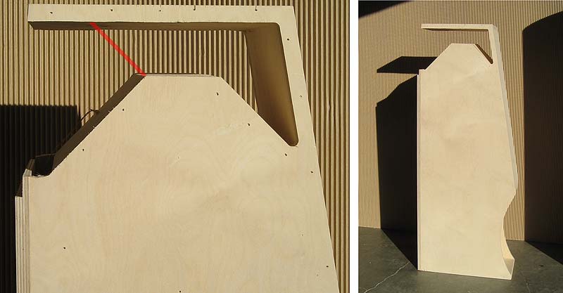

gnat_leader said:Dave,
thanks much for your reply. I do believe we are talking about the same problem/issue. Question: if we add a spacer or supra-baffle of the specified thickness , what diameter should we increase the existing driver hole to? ie, to let the back-wave from the driver "breath"? Right now we have it just large enough to fit the driver and scalloped at 45 degrees on the rear of the baffle.
When using drivers with the limited clearance from large magnets such at least the entire FEnn6 series of Fostex, I'd agree that it's very important to allow some "breathing" room on the rear side of the baffles, and particularly so with double layers as a separate supra-baffle will create.
One solution is to flush mount the driver on the standard width enclosure panel, and bevel the driver opening on the front side of the supra baffle. Depending on the thickness of material for the SB, you can end up with a shallow waveguide, such as seen below.
These were sized for a friction fit, to allow the quick demonstration of "with and without". (hint - they seldom play for long without them)
Aluminum angle brackets and closed cell weather strip tape could make for a fairly simple, and well sealed installation - just don't use the baffle as a carrying handle.
If the panel to which the driver is presently mounted is not removable, it won't be particularly troublesome to enlarge the hole, but it obviously be a nightmare to chamfer the rear side. In that case, I'd be inclined to cut a square opening, almost flush to the perimeter of the 4 sides of the CC.
For those concerned about the extra volume that such spacing of the driver's mounting plane will create, this'll make it much easier to add solid blocking to the rear or side walls of the CC.

gnat_leader said:Chris,
Thanks for the feedback, but I'm not sure you've been following what we've been talking about. One of the reasons for adding the supra-baffle is to increase the CC volume provided by moving the driver forward the thickness of the baffle. If your version of baffle is added then how would we increase the CC volume?
Sorry, it wasn't clear from the above posting that the CC in this pair had already been enlarged after our first audition. In addition to a cosmetic modification to the outside shape, there was some major surgery involved in routing off the sides, and moving the rear wall back several inches. ( somewhere Dave has pictures)
You'll note in the posted picture additional plywood "cheeks" that enclose the revised CC, as well as layer of 1" MDF on the outside of horn mouth, for resonance damping.

It looks like we need to add .51 liters (31 cubic inches) to the CC.
If we cut out a square 6"x6"x.75" piece of front baffle and add another on top, we get close (27 cubic inches). If we can cut a rectangle 6"w x 7"L (down) without moving into the horn throat area we will get 31 cubic inches.
