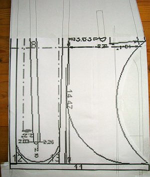

Recreate A126 Rev H part II as Acad.dwg
I have now drawn a cad replica of Ron´s A126 rear firing (18mm ply).
I can´t get closer, so I will use this drawing for my set of horns.
I ran into some problems with the horn mouth, so I did an enlarged 1:1 zoom-copy of Ron´s gif as a master. Then I just glued it on top of my 1:1 scale drawing and it turned out pretty good.
That´s the way I verfied that I´m on the right track.
Have a look at my simple duplicating method on the attached jpeg.
I will post dimensions, linepath, partlength and some other stuff as pdf-files later this week.
