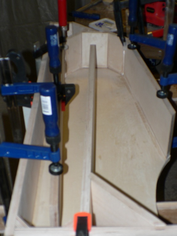

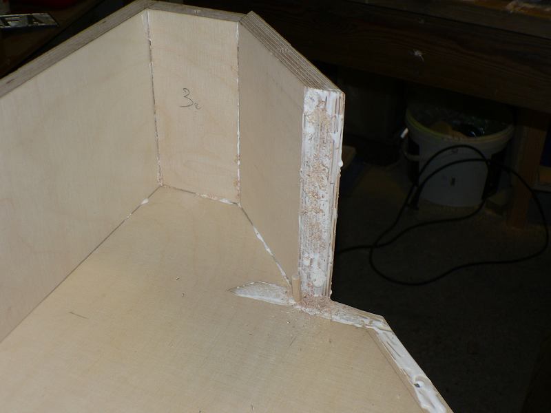

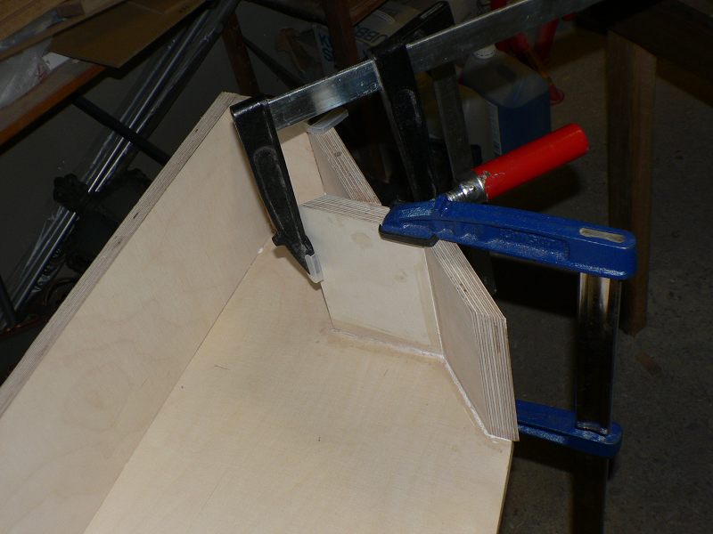

2) Drawings, pictures
I've created a web album at http://picasaweb.google.com/florian.otel/A126HornBuildingPictures
There are pictures of my 1:1 scale drawing of the horn profile with corrected metric dimensions (in mm). The assumed building material thickness is 18 mm.

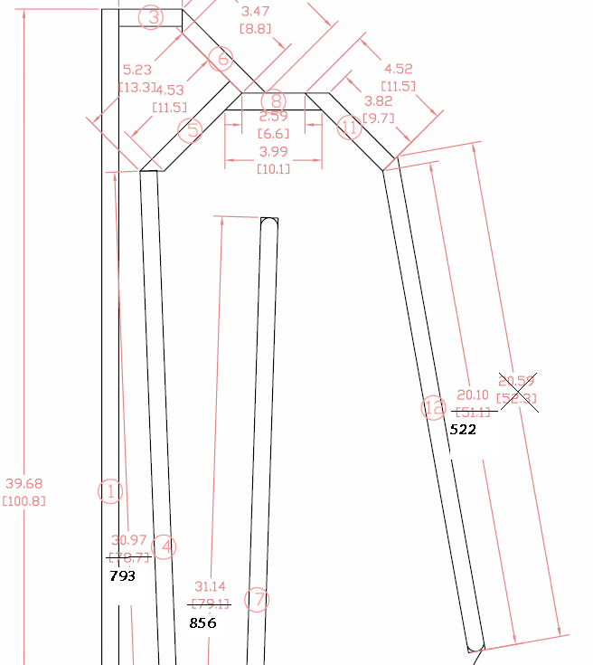

4) Corrections to the building plans.
Now, this is the trickiest part. The corrections I've made to those plans are only based on my current understanding and I would highly appreciate if someone more knowledgeable (Dave ? Ron ?) could verify that this is OK.
- Corrections to the length of the internal deflectors (better name?) i.e. part 4 and 7 in the building plans. My assumption is that the horn throat width is to be (cuasi) constant at the horn inflections at the bottom of the speaker (part 4) and top of the speaker (part 7). IOW the distance to the different boundaries at those inflections should be cuasi-constant / increase smoothly -- as drawn at page 5 in the PDF.
If this is the case part 4 and part 7 have to be lengthened as 793 mm and 856 mm, respectively:
- Correction to the back of the speaker (part 12 in plans). The length should be increased to 522 mm. The correction is mostly to respect the horn mouth curvature in the plans (center and radius) and the 10 degrees horn expansion angle given for that part.
- Corrections to the CC external dimensions on page 4 of the PDF. Some dimensions there are off (by some 4-5 mm).
Again, I would be greatful if someone could ack that my assumptions wrt horn inflection and expansion rates are correct.

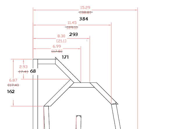

Sure.
Here is the correction for page 3

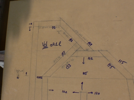

Updated plans, new CC
Well, let's get back some life into this thread. It took me quite some time to get all the stuff together (Dave's drivers got stuck in the customs, the birch ply took extra to deliver, etc).
First, some updates:
- Based on Ron's feedback about the shape of the CC now I've revised my plans again (see this thread: http://www.diyaudio.com/forums/showthread.php?s=&threadid=99769)
Unlike Dave's mod, in order to get the required CC volume the CC was expanded by "pushing" at the same rate (i.e. 18 mm, or "one wall thickness") both the top side of the CC and the top sloped part.
The new CC shape and its dimensions (in mm) are detailed in the attached pic
(As above, updated high res pics of the plans + build are at http://picasaweb.google.com/florian.otel/A126HornBuildingPictures)
Suprisingly enough (or maybe not...) now the A126 CC resembles the CC in the A166 (yes, that was a coincidence, or -- as I like to think -- interpreting correctly Ron's design guidlines).
In the pic one can also notice the original (as per building plans), undersized CC.
Florian

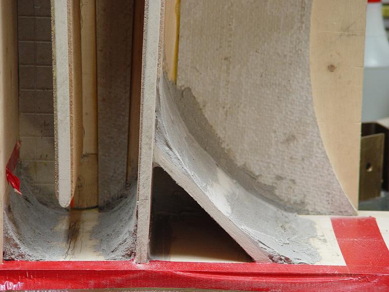

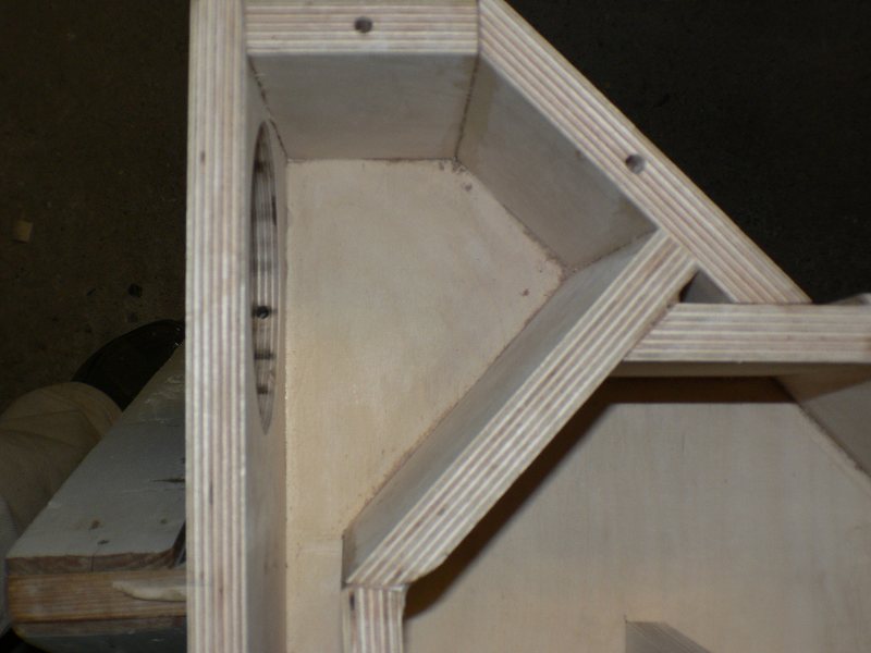

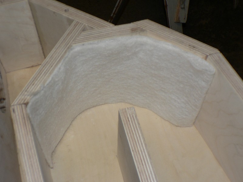

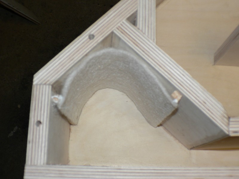

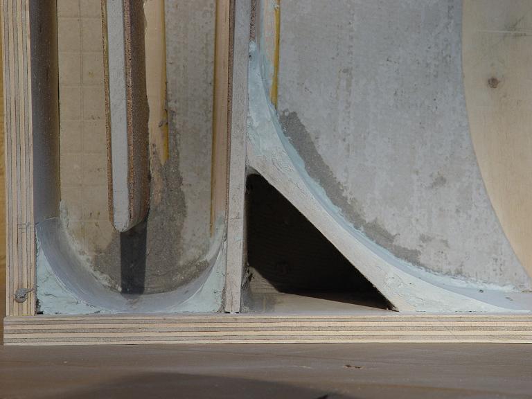

You could try this to make the turns..... I used an epoxy mortar (1 part epoxy: 1 part sand mix) , followed by body putty to smooth out the surface. The epoxy mortar allows the application of lifts up to an inch and one half , but as it begins to set up, it becomes difficult to smooth as seen in the first photo. If you don't need big lifts, less sand makes smoother applications. The body putty (polyester resin for auto repair) smooths it over and allows adjustments in the dimensions. It would be good to make a template of the turn to place in the open end. Much easier than using a rasp. later on.....Also, if you need to use a rasp or sand paper, there is a certain moment , in the curing, where the removal of material is relatively easy to manage.
Thanks for sharing....
Still, I'm not so sure about treatment of the horn folds...IIRC ron's attitude towards folds treatment was not so favorable.
Yet still, it may very well be that rounding the corners with some sort of mortar is beneficial.
The only question is of doing that via lining with cloth or rounding it up with mortar. Or both ?
Ron ? Dave ?
Thanks again for posting the pics. Highly appreciated.
