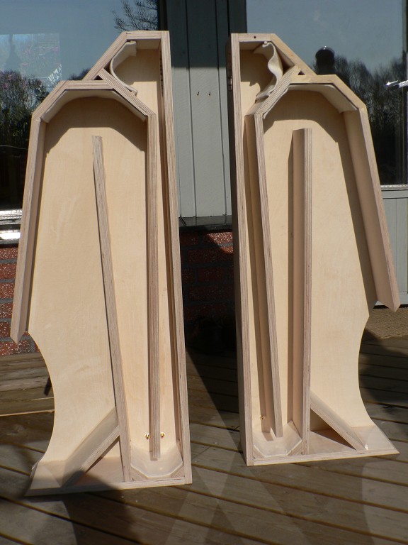

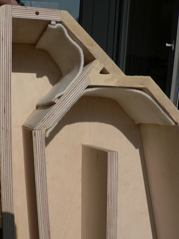

Wrt the radi, I was thinking along the same lines -- round the corners at the folds with either "plastic tree" (as they call it here, not so sure how you call it -- a paste that simply cures as "wood") or putty reisin.
The epoxy mortar (or white cement as an alternative ?) is heavier and should add to the weight on the bottom folds it can make the top fold heavier. And yes, laziness and unpatiences (I really want to glue these together and do some listening...).

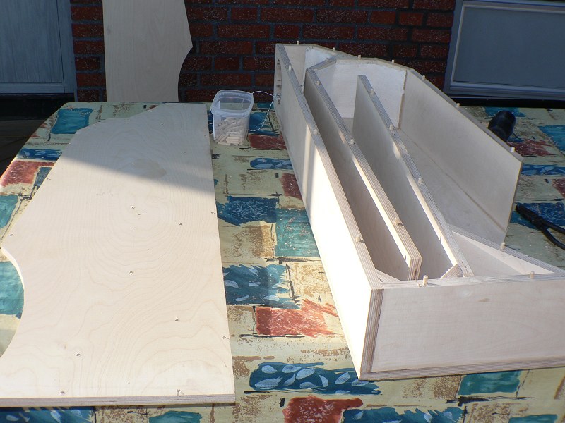

nice work - I wish I had the patience for dowels - the air powered brad nailer is just too convenient.
My attention span isn't what it used to be; are you planning on supra-baffles? For my taste, in concert with Ron's deflectors, they take this design "to another level" and squeeze possibly "the last drop" of performance from the FE126e

jleaman said:May i ask what type of plywood that is ?
over here we'd call it "baltic birch"

Over here we call it fs"#!%!ing expensive birch ply 🙂
Joke aside it was 18mm birch ply, made in Findland, so I guess you can call it baltic too 🙂.
Costed around 180 USD per 1200 cm x 2400 cm sheet (yes, 180 USD / sheet!). And you have to buy them whole sheets, even if needed only one and a half (roughly).

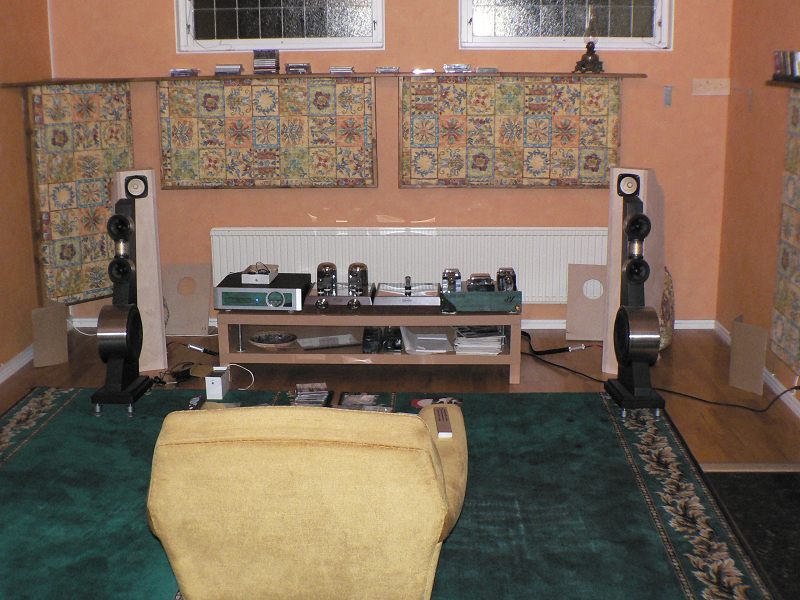

Now both sides are cured, installed in my reference system, and gave them a serious listening and a first round of tweaks.
System:
CD player: Cayin CDT-17A heavily modded (tube buffer output bypass, upgraded O.As, improved power supply)
Pre-amp: Supratek Chardonnay
Power Amps:
EAR 890 (70 A Class A from 4 x KT90 pentodes per channel);
Audiodigit/Autoconstruire Class T 100 HCL digital amp ( TAA4100A Tripath chip) driven by 12 V 7Ah battery
Speakers: Gallo Reference 3A
Cables: Low level: Silver Siren; High Level: Xindak FS-1
Dedicated listening room rectangular 640x480x205cm (that's aprox 21 x 16 x 7 ft) in short wall setup. Damped back and side walls.
Attach is a picture of the setup. The panel was removed from the right corner to allow corner loading. As can be noted from the window positioning, this is in a cellar with side and back walls made of concrete.
Also on the floor one can note a mini OB I used for addiional break-in of the drivers I received from Dave and makeshift deflectors out of cardboard 🙂

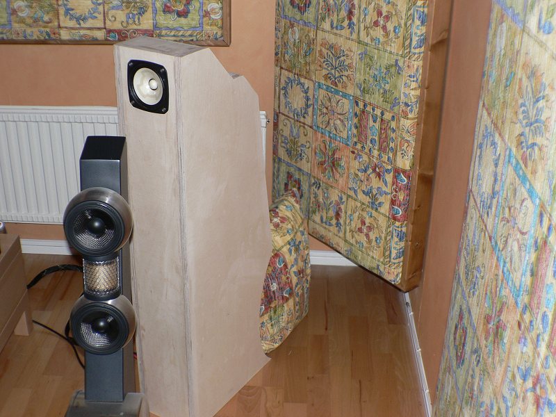

First, I tried to corner load the A126. Placed them on the room diagonals (well, roughly) at around 30 cm (1 ft) from the corner. Tried both no deflector and makeshift cardboard deflector (as the right corner in the pic above).
The results were frightening: The midrange was to die for. The treble is pretty good, but not much happening in the last octave (I'll get back to this). The only real problem was the bass: While more than aplenty -- "Output at 40 Hz (sine wave) ? Yesssir !!" -- it was booming.
In this setup the bass was simply too much. "Quick" bass notes got the transients mushed together. Large symphonic pieces (Mahler 5th symphony, "Trauermarsch") and dynamic piano solos (Beethoven pianosonata Nr 21) got (too) bass loud and muddied. Quite annoying.
Then I tried to move them a bit in the room, and even stuffed a pillow in the horn mouth 🙂. It helped, but not by much.
Eventually I put the corner panels back on, moved the horns inside the room about 1m and removed the stuffing from the horn mouth.
The bass settled down and boom is now non-existing (well, almost) . What I get now is cleaner, deep bass notes. While sometimes I feel that the bass is "lazy", I wouldn't call it either soft nor squishy. It just takes its time to catch up 🙂
So, while it might be that I am unused to the BLH bass, it might very well be that some roommodes get excited due to corner loading and makes the bass boom.

A proper deflector will help with any boom by re-directing the wave front. The cement walls are a natural for too much bass.
