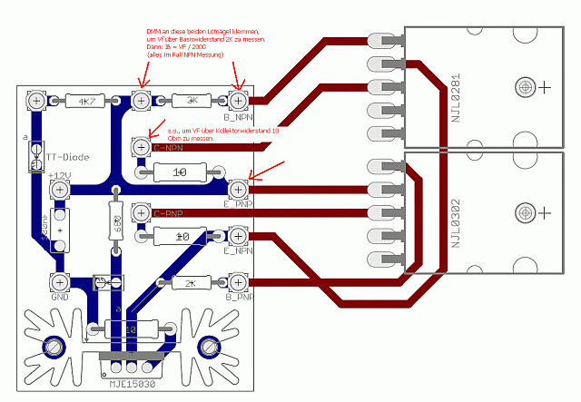

Finally i have in my hand 10 pcs of NJL 1302&3281. I used the schematic from Builders manual to measure Hfe and Vbe.
Vbe is very consistent between 0.610 and 0.614 V for NJL 1302 and between 0.623 to 0.627 for NJL 3281. (measured directly Vbe with Dmm while transistor was installed in the test rig).
Regarding hfe i have obtained for NJL3281 values between 110 and 115
and for NJL 1302 hfe is from 112 to 118.
What do you think are my values close enough? Also are my measured values close to what should be ?

Adrian, the HFe values of your transistors look quite good, but I remember Mihai's advise to not use the NJL3 - series transistors,
since they have another type of compensation diode installed.
Find the description of the differences in Bob Cordell's book: "Designing Audio Power Amplifiers" on page 305.
The NJL4 - series would have been a better alternative!
If you want to stick to the NJL3 - transistors, build a compensation scheme like the ones Bob describes on the following pages.
Best regards - Rudi
I've attached the test rig recommended to me by Rudi and the testing current is close to the one recommended by you.
Vbe is pretty consistent and is ranging between 0.630 and 0.638V among the 10 transistors under test.
Hfe obtained after calculation was:
86,09
94,65
90,90
91,24
92,90
92,90
95,25
88,80
91,77
85,76
Now i wait some NJL0302 from a fellow diy-er from Poland to how they measure.
I have also some good matching pairs of 3281/1302 but i understood that they sound a bit different that the recommended 0281/0302.

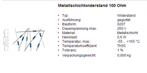

@PeterLeest: I am not aware that any of the small resistors has to dissipate more than .25W.
I use 1% metal film resistors manufactured by YAGEO (formerly: VITROHM), and these resistors are rated at .6W.
Best regards - Rudi_Ratlos
