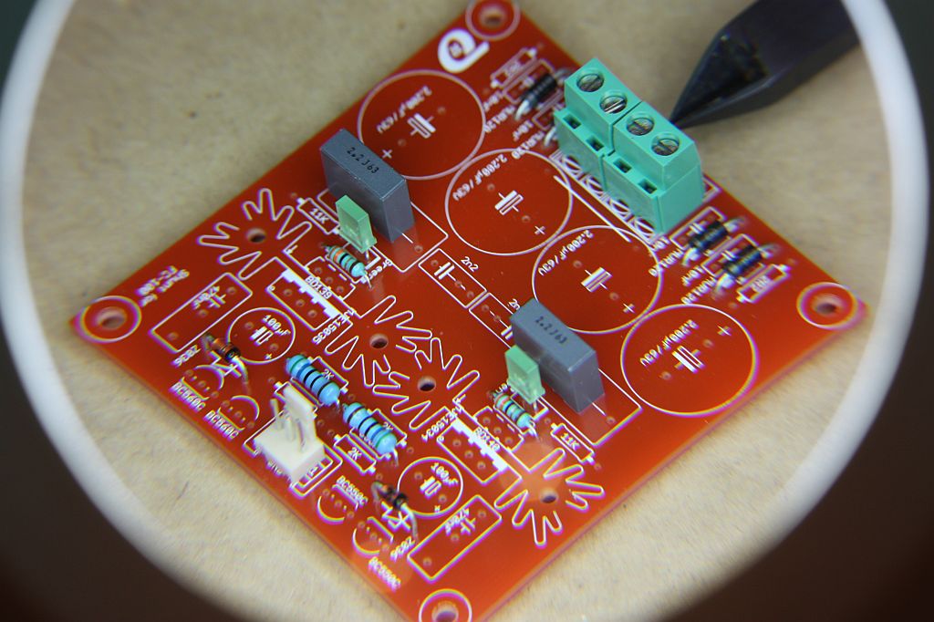

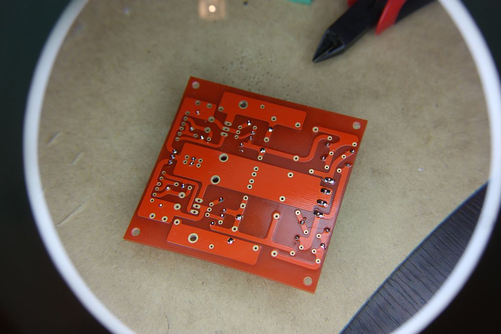

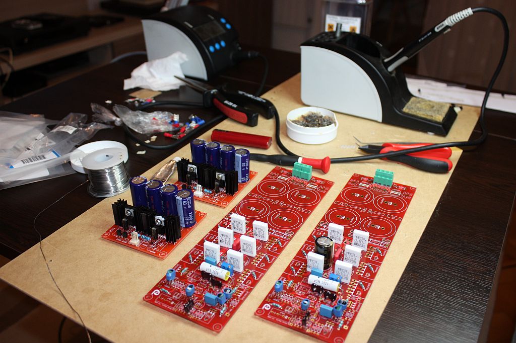

I want to show you some pictures of my work.
This pcb's are just lovely and my soldering iron is very happy with them 🙂
Still missing some parts but hope to have it soon.

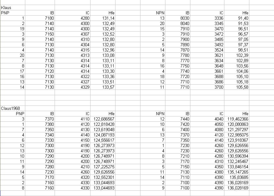

Finally i've received 2SA/2SC transistors and as with MJE's is impossible to find PNP-NPN matched pairs but i have an idea and i ask you to tell me if i'm wrong or not.
In the attached picture i see two Sziklai pairs and i was thinking to "match" the equivalent beta of the Sziklai compounds.
Is my thinking correct ?
Usually PNP transistors have lower hfe than their NPN pairs but i have found with my DMM that this rule is not apply for MJE 15034/15035 and is not possible not match the total hfe of Sziklai transistors (NJE/2SA/2SC pairs).
Is that normal for this MJE transistors to have bigger hfe for pnp or should i measure their hfe in another environment than my DMM ?

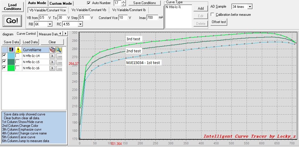

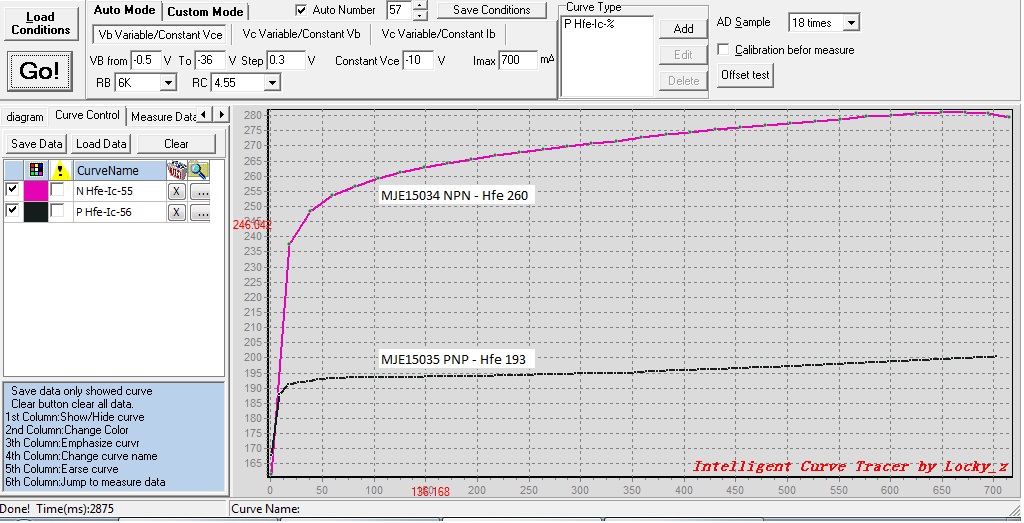

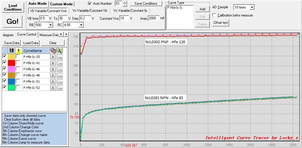

These are the trace curve for my MJE 15034/15035 & NJL0281/3020. It looks like the NPN TRs are not so linear as compared to the PNP ones. Also, Hfe gaps are quite huge.🙁

Andrew: it depends.
I have measured more than 300 pieces of NJL0281G/NJL0302G in the last year, always using the "matching circuit".
Depending on the production date / date of my order / company where I ordered: the transistors either match very well (in Claus1968' case)
or not so well (in Klaus' case).
Best regards - Rudi_Ratlos

Rudi,
I am not referring to matching.
I am referring to post713 showing the variation in hFE for a single device as Ic is varied.
For that specific test situation I have NOT found Onsemi devices to have significant hFE variation (non linear) as Ic is varied, once the Ic value is above a sensible minimum value.

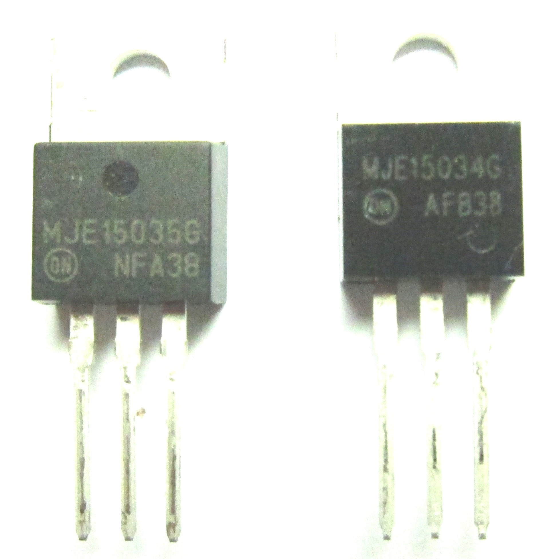

The question TR MJE15304 is procured from RS component (RS Stock No. 463-098P.
I did three consecutively test on same transistor. The Hfe would increase a bit in each test (is it affected by heat ?). Also, for 15304, the increase seems higher than other transistors, eg. MJE15305, NJL0302/2801. all 5 TRs I puchased behave same characteristic.
could it be a fake?
