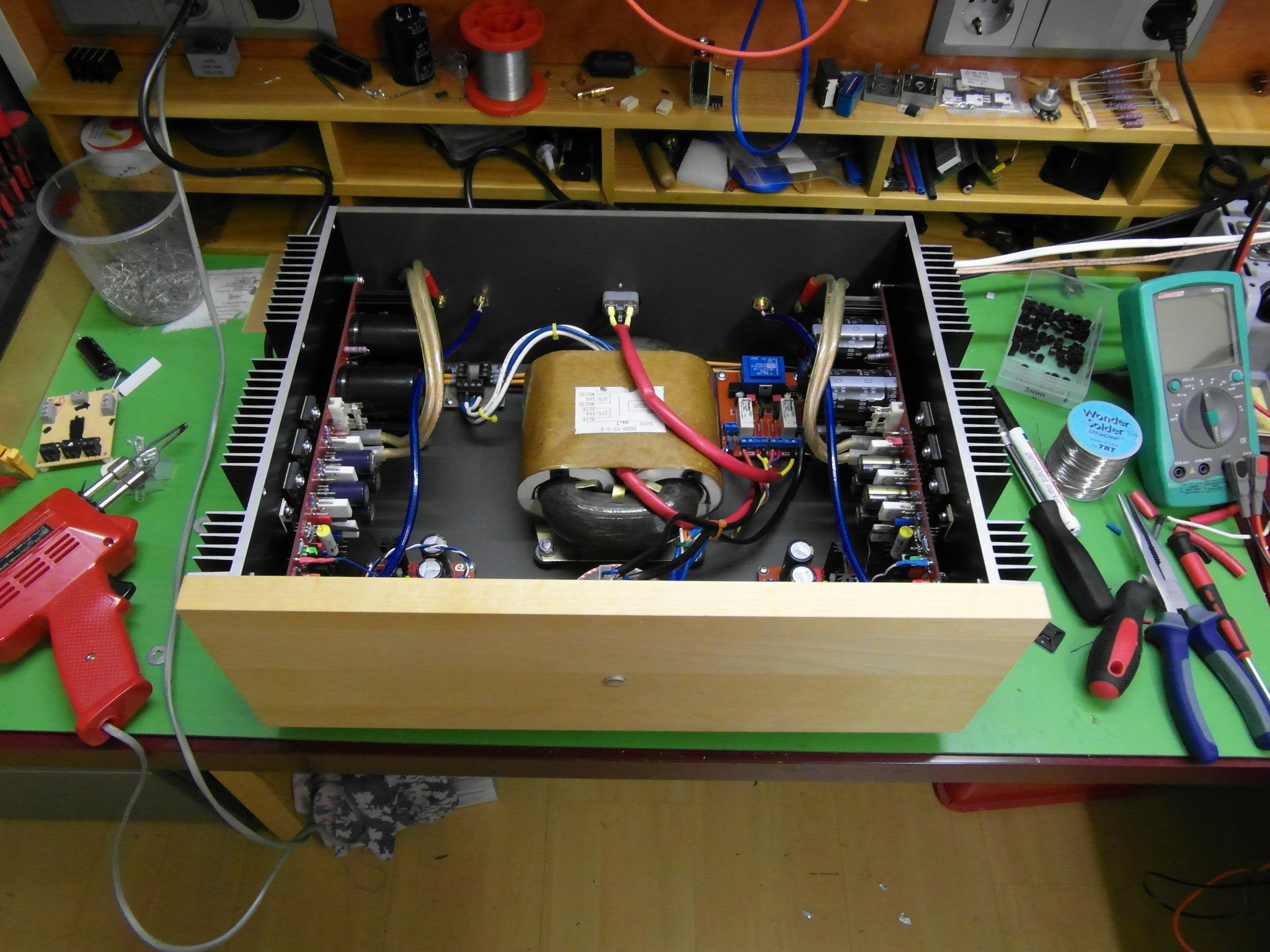

CMF55 is half watt. look at the datasheet. it`s 0,5W @ 70° and 0,25W @120°
when you compare them with other datasheets like other Vishay or PRP you see the all refer to 70°
And, Gerhard: how does the FC-100 sound in your ears?
Best regards - Rudi_Ratlos
P.S.: I like your build (metal and wood) very much!
