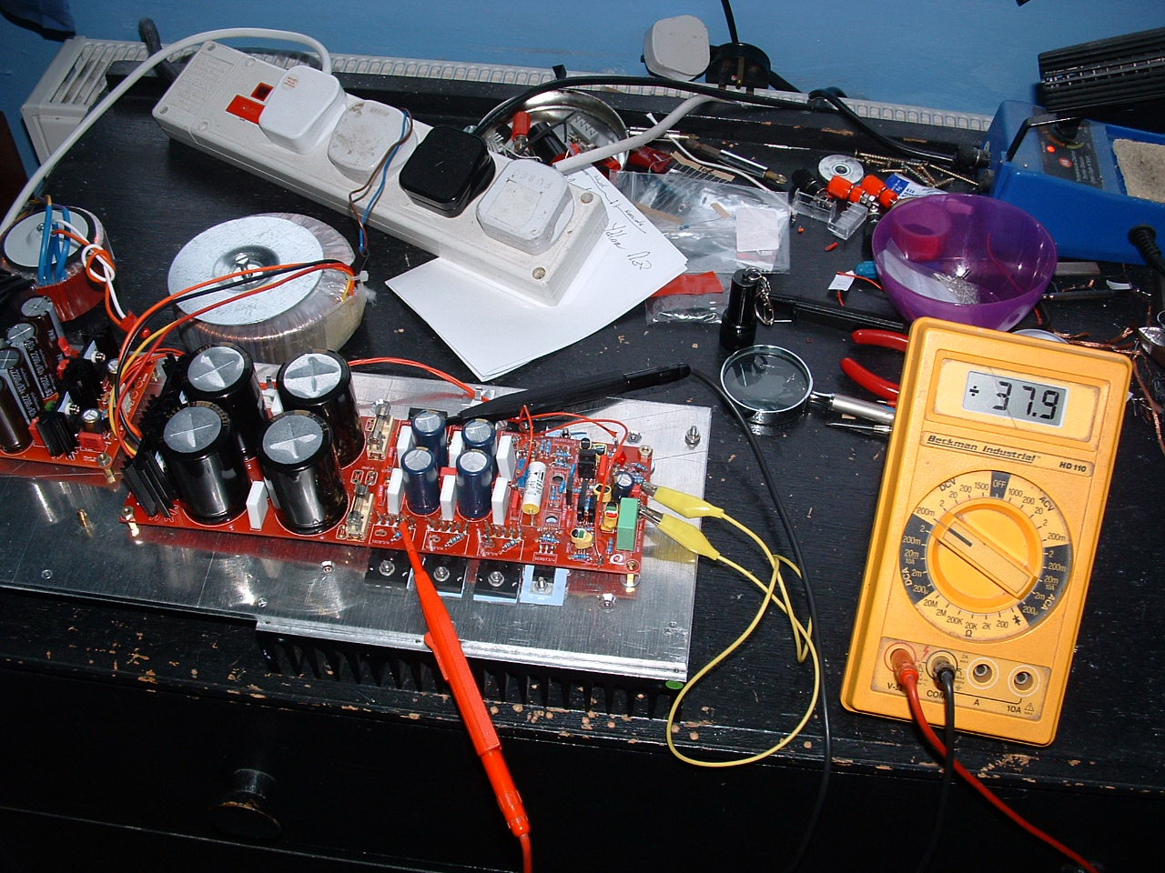

Hi After sorting out one side with Rudi s guidance i started on the other side.
No problems works perfectly 36mv with 5 active tt diodes.:)
The problem i had with r28 smoke stopped when i changed the input short from 2 wires to ground(alum plate) to using a croco clip as in pic .:confused:. next music
regards john

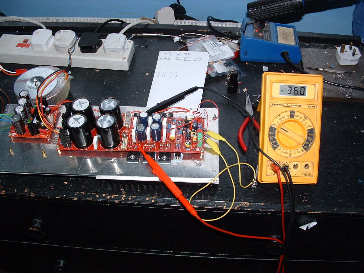

regards john
You don't want a DC connection between circuit common and earth/heatsink. It should be connected AC only, via a cap. Something around 1uf will do.
