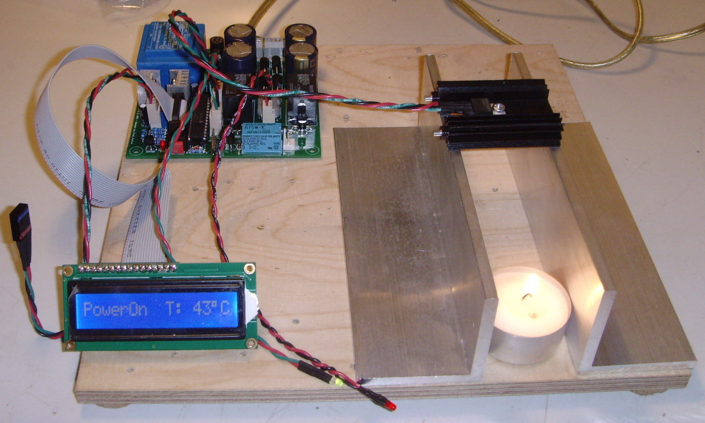

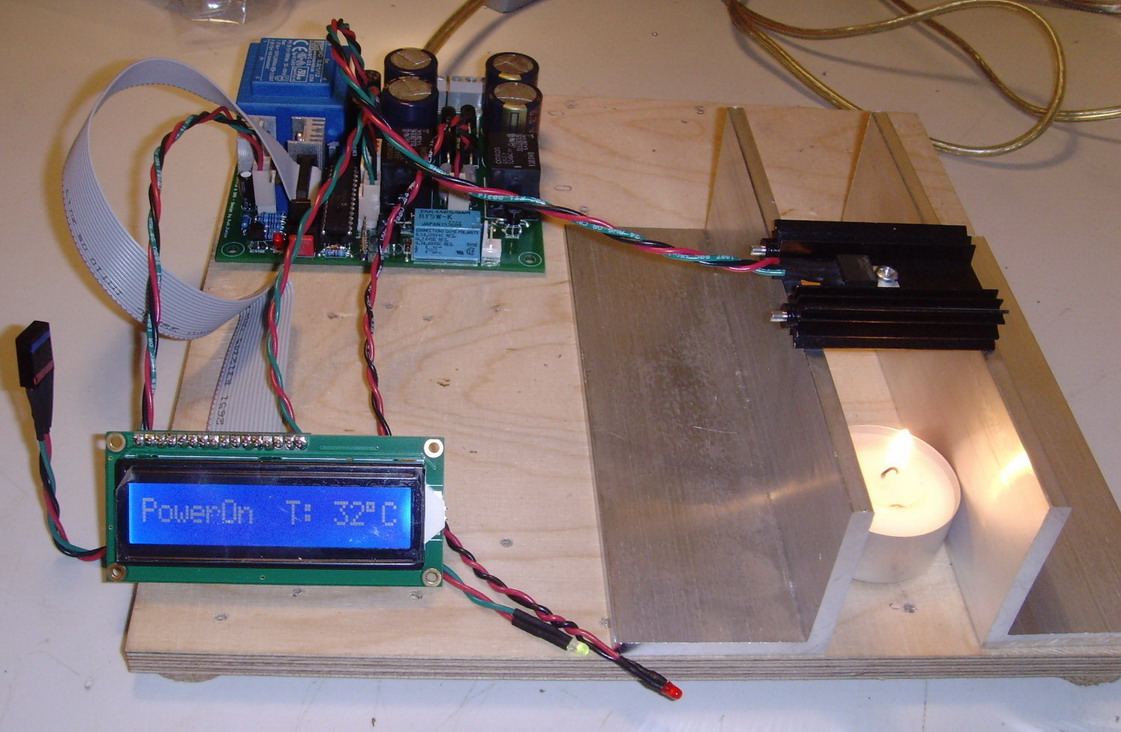

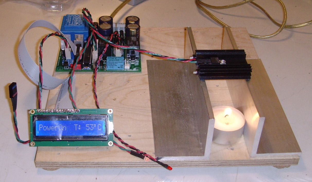

Gentlemen, I cannot resist and have included 3 pictures showing you, how I tested the "temperature control feature" of the SPO-PCB.
Up to the threshold value of 50°C the DuoLed is shining green.
When the threshold was exceeded, I heard the blue fan-relay clicking (it is now showing +12VDC on its associated connector), and the DuoLed changed its colour to red.
"Everything works as designed."

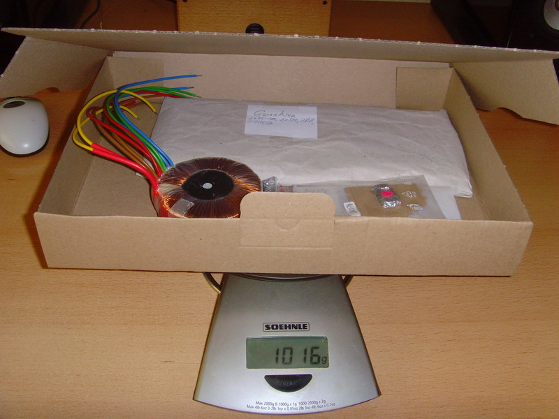

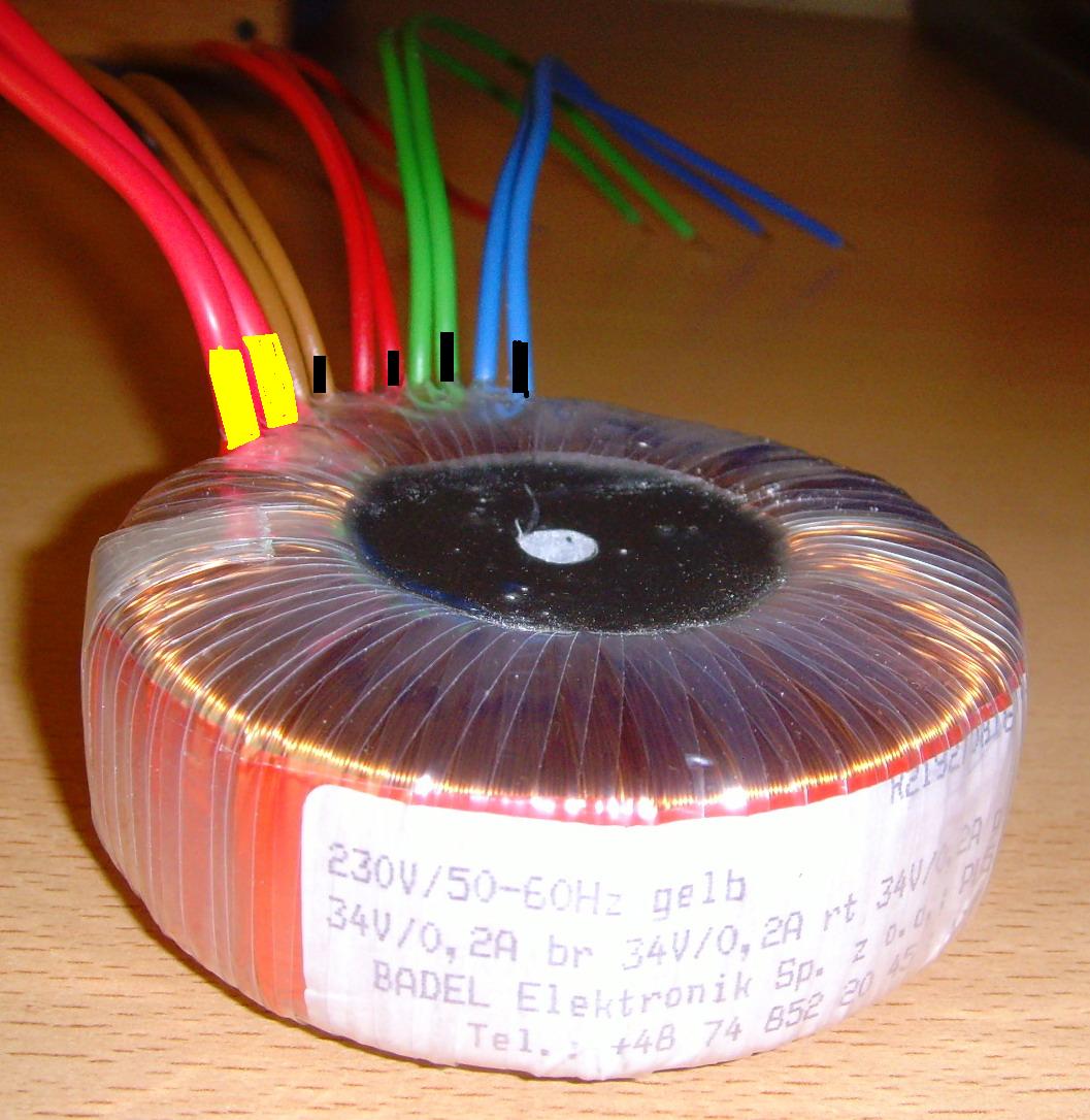

Gentlemen, I have received the 4x34VAC / 30VA toroid transformers from BADEL today (see attached image 1).
The mains 230 VAC primary winding has yellow wires.
The secondary windings show pairs of blue, green, red and brown wires.

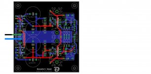

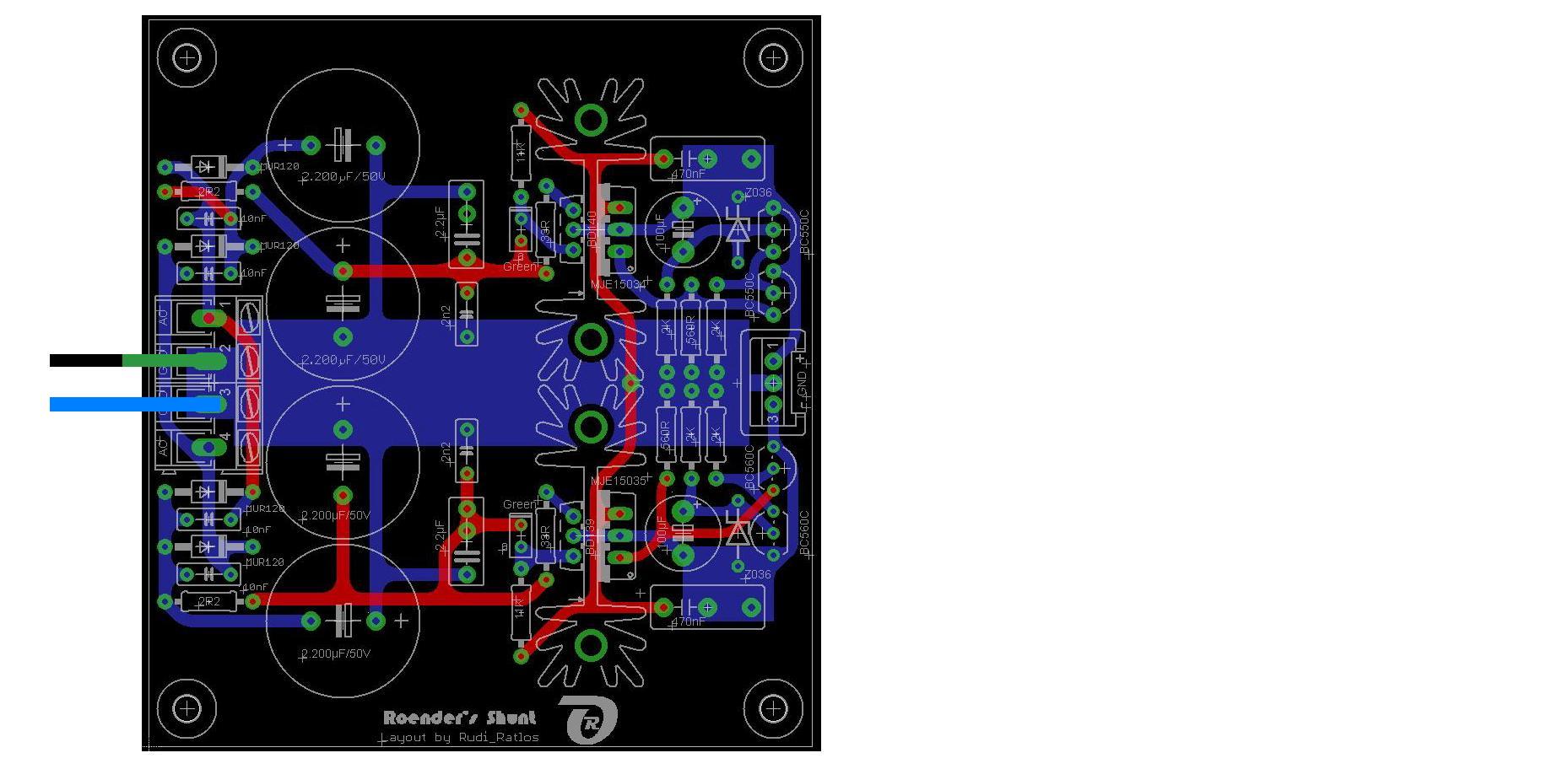

Connect the blue - not marked black- secondary winding to the green - marked black - winding to constitute "GND" of a FC-100 Shunt regulator (image 3).
The same applies to the red and brown secondary windings.

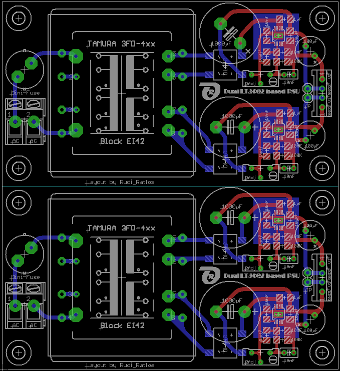

I am currently weighing and optimizing the components' placement of each parcel to give you the best shipping cost (image 2).
I will take all of the parcels to my local post office tomorrow morning.
Best regards - Rudi_Ratlos
