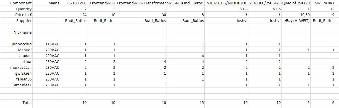

Find attached the current order.
Best regards - Rudi_Ratlos

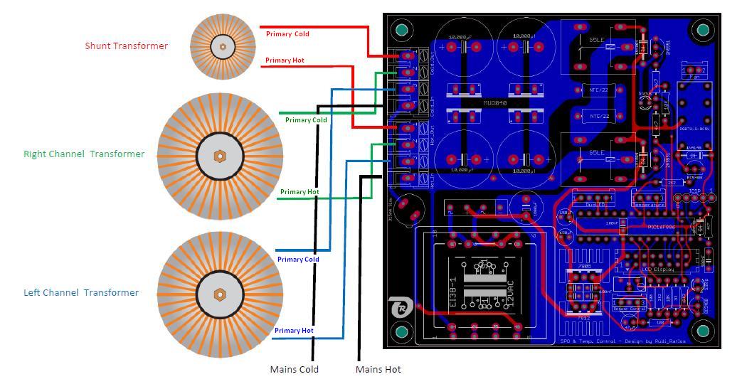

Gentlemen: just to show you, how simply and elegantly / perfectly my SPO / Temperature Control PCB will match your transformer requirements.
P.S.: I am rather unhappy currently, since the German soccer-team has lost its playoff during the EM2016 yesterday.

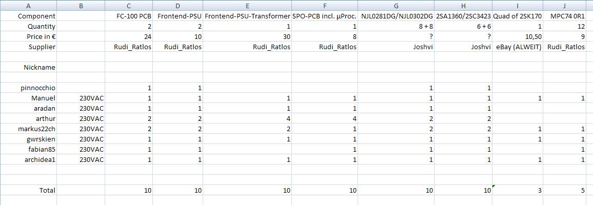

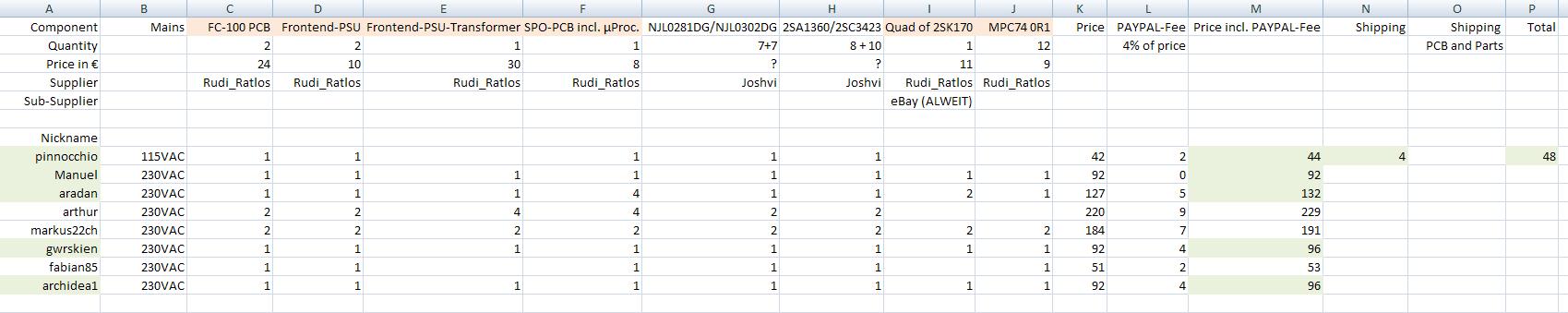

Of course I did, Dominic!
Find attached the current order status.
I have marked the nicknames of the participants, who have already payed, in "light green".
Since Dominic did not order a transformer, I know exactly the price for shipping his small parcel.

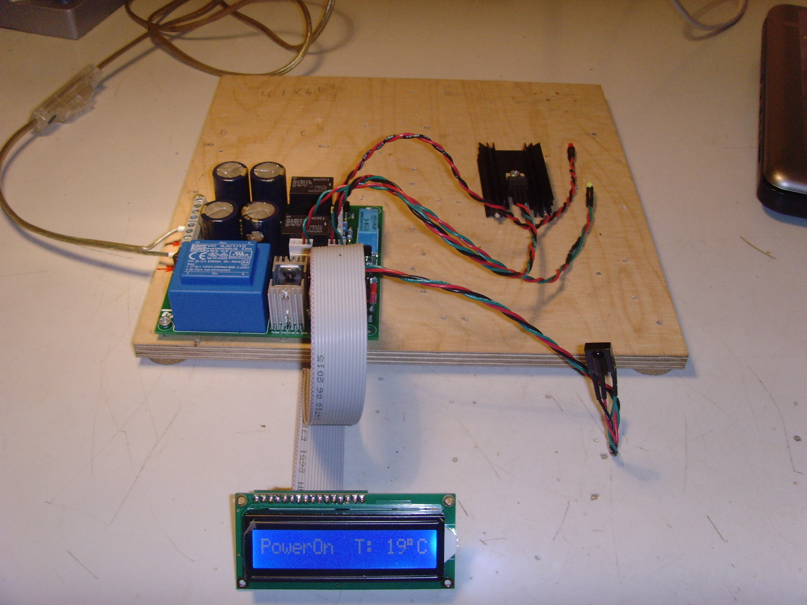

ARADAN has allowed me to solder one of his SPO-PCBs to:
- check the completeness of the BoM
- check the functionality of the PCB
- check the correctness of the µProcessor's firmware
I have finished his PCB this morning, and: everything "works as designed".
You can see a 3mm LED on the top right, shining red, meaning: mains current is flowing without restriction.
Below it you can see a 3mm Duo-LED, shining green, meaning: the heatsink's temperature did not exceed the pre-programmed threshold of 50°C.
The Duo-LED changes its colour to red, if the temperature threshold is exceeded.
The temperature is sensored once per minute.
I have connected the LM35 - temperature sensor to a small heatsink on the left side of the 2 LEDs.
The LCD in front is showing you the "PCB's status".
The infrared-sensor is working as well, and I am able to remotely power off/on the SPO-circuit (with attached transformers).
I will send you the "Builder's Manual, BoM, Drill Template, ..." on the weekend.
