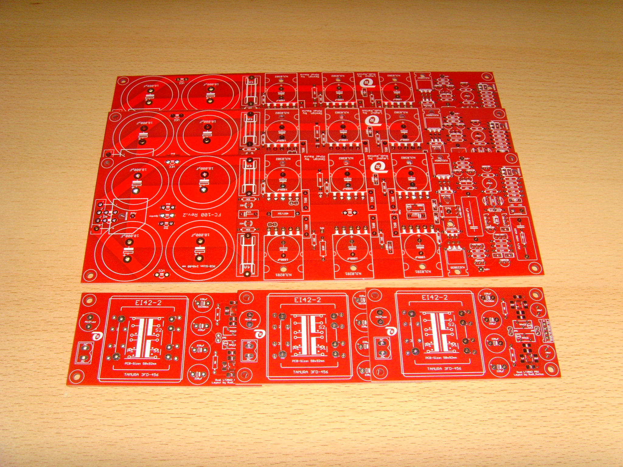

Gentlemen, I have 1 pair of FC-100 PCBs and 1 pair of LT3062-FrontEnd-PSU - PCBs left (see image).
Give me a PM if you like to have them.
