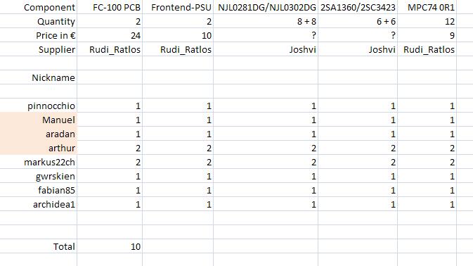

Find attached the current order list.
I will close this round now and will not accept new requests.
I have asked Joshvi to order 70 pieces of each NJL0281DG/NJL0302DG from Mouser. From my experience this amount will be sufficient to allow for 20 well-matched triples of each type of transistor.
I will include one spare transistor of each type into your parcels.
I will give you the price for the NJL0 and 2SA/2SC - transistors, as soon as Joshvi knows it (how much will the customs duty, shipping, ... be).

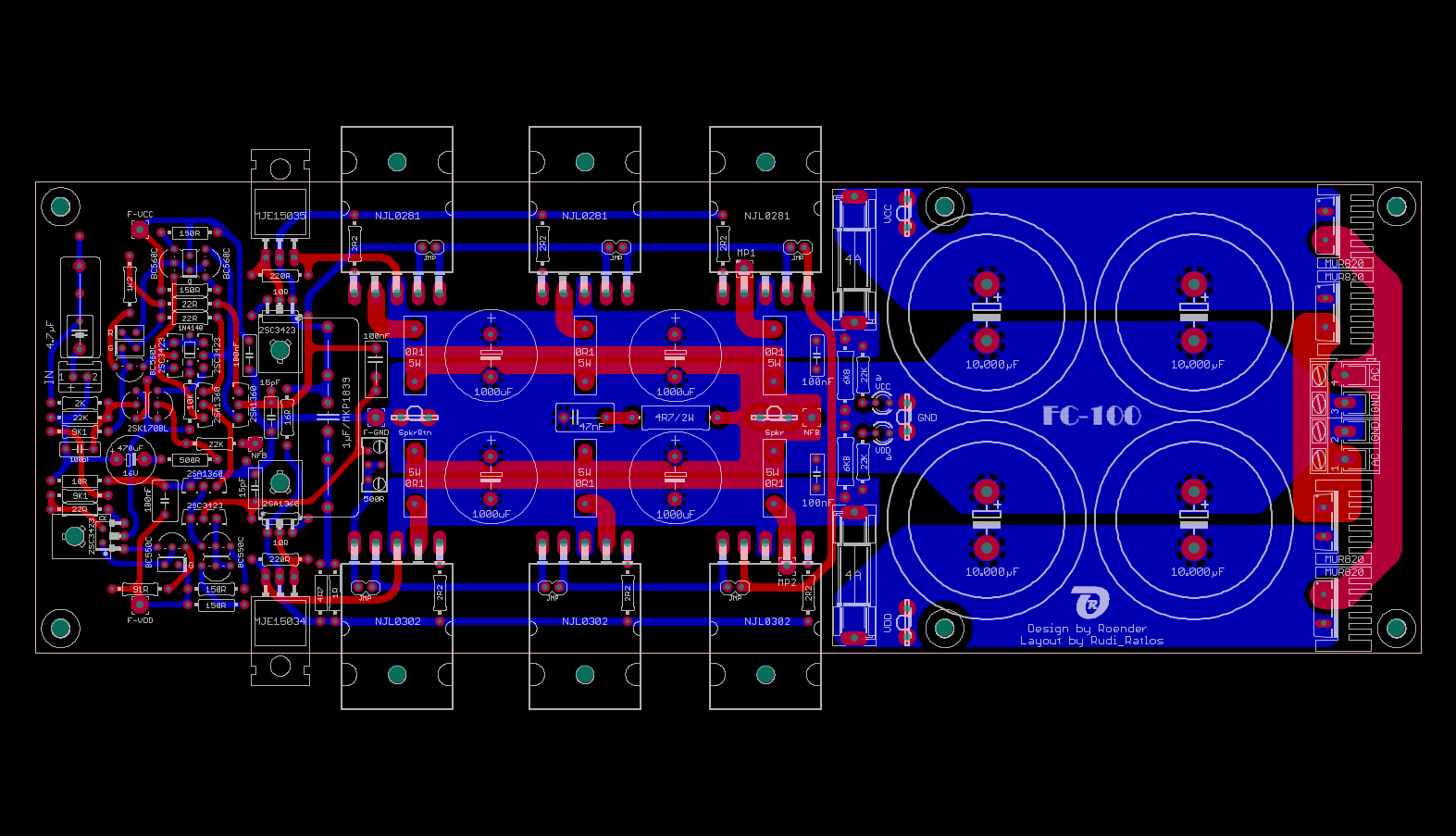

Chris: I have added 6.3mm Faston power connectors on the left side of the backend reservoir capacitors, if you like to cut the PCB into 2 parts (amplifier and backend PSU).
If you have a better idea: tell me! I did not yet order the PCBs!

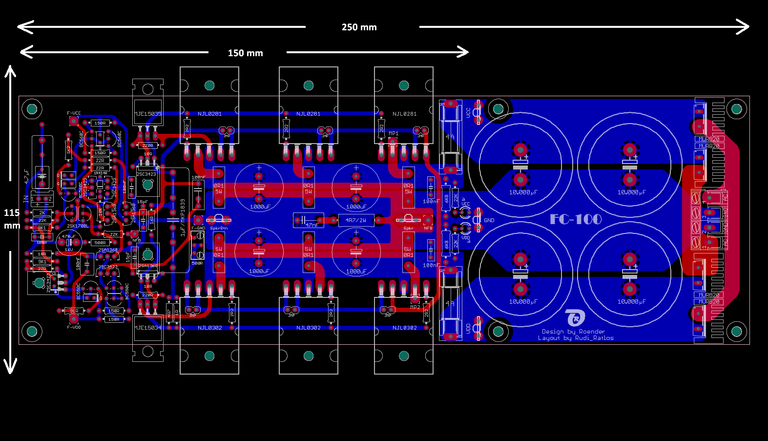

Find attached an image showing the dimensions of a FC-100 PCB.
Concerning the heatsink: either get a case with heastsinks covering the whole PCB (a Modushop Dissipante 4U would be a suitable case, for example) or:
Get an ALU-plate, 250 x 200 x 8 mm (which costs about 12€ in Germany) and screw the PCB on it.
Add an appropriate heatsink to the opposite side of the ALU-plate and build a case of your own.
Best regards - Rudi_Ratlos
