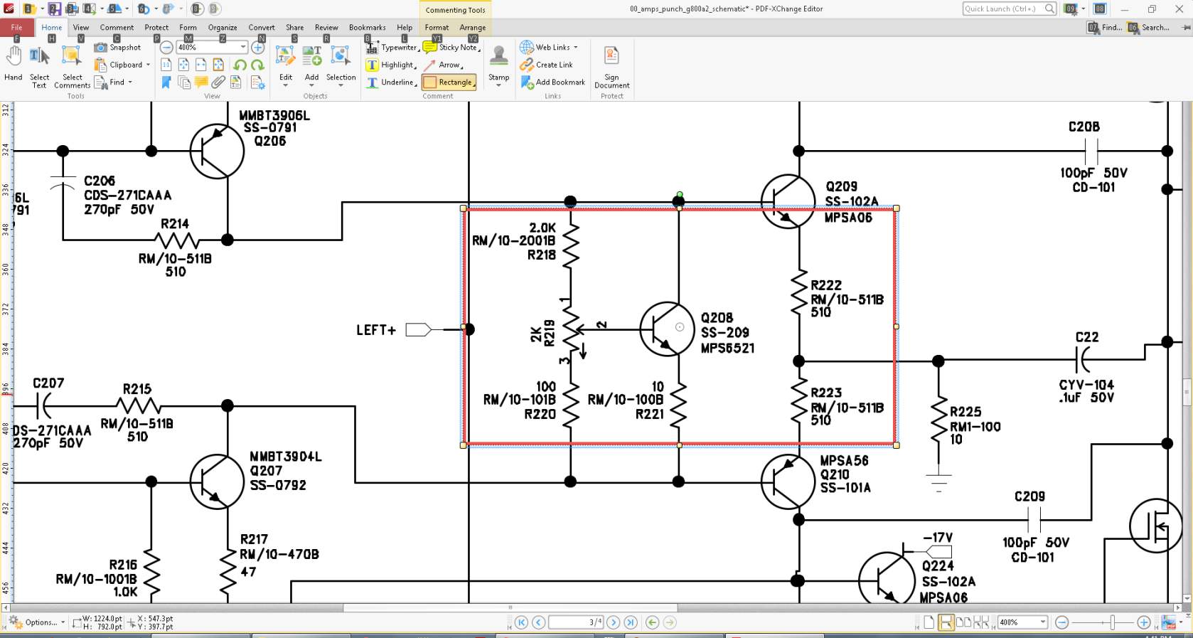

Are the resistors in the rectangle within tolerance and the values listed in the diagram?

That regulator is out of tolerance. The 1.5v between the output and adjust terminals should be 1.25v.
The jumper doesn't disable the output. It switches the output stage on without a delay so you can power up with a limiter without allowing the rail caps to fully charge before it switches on.
But if I remove the jumper there is no output. It is not switching on by itself
