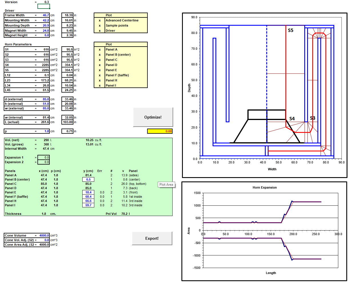

It just occurred to me that the layout of the ROAR is very close to the layout of the Cyclops. The only thing significantly different is that the Cyclops has an extra fold at the back, which results in shorter box for the same path length. The simulated response curves are pretty close too (see attached). As I've got a spreadsheet that can (theoretically) optimize a Cyclops fold, it shouldn't take much to change it to use a ROAR fold as well. If I have some time this weekend, I'll have a look at it.
A small update - I moved the S3 position back a bit to make the L34 expansion a bit less abrupt (and therefore a bit more accurate). The S4 position in the sim will still be off a few cm from the actual location, but some fiddling in Hornresp suggests that this will only make a small difference.
BTW, considering the length of the front "resonator" as the distance from the mouth to the baffle may not be entirely correct. Pipe resonance requires that one end be open and the other end be closed. Neither end is closed in this case. One is open (the mouth), and the other opens to the rest of the horn 🙂. The size of the baffle is too small to act as any sort of major reflector at low bass frequencies, and may only start having a major impact above 200+ Hz.

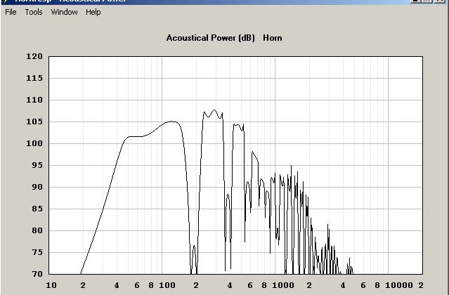

A Hornresp sim of the RCF LF18G401 in a stock ROAR 18.
I am afraid that the sim does not reflect the real performance, so take this sim as a very crude first indication of the passband and the efficiency.
The response I got from the numbers you've put out yourself and the driver info I've found on their website got me this´result
