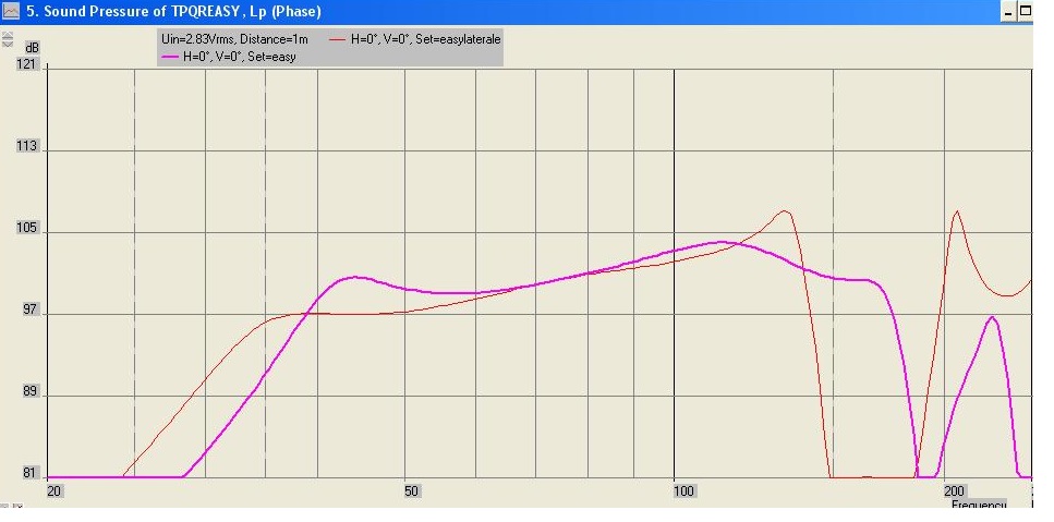

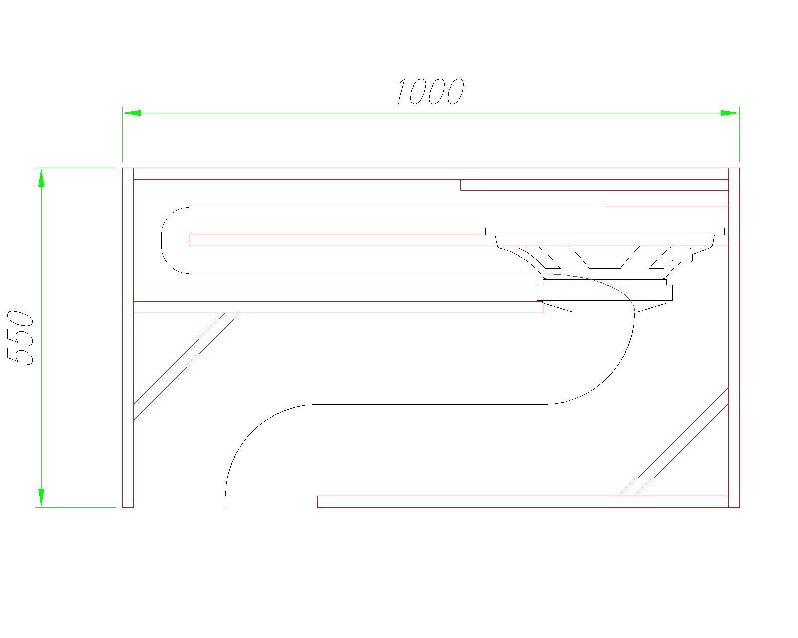

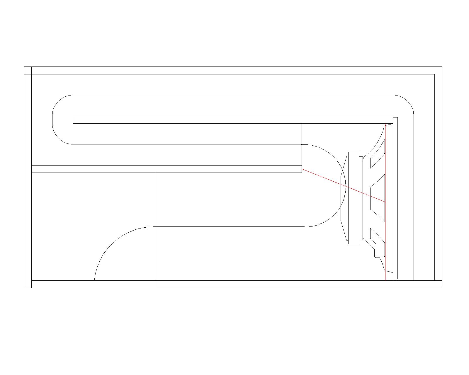

hi, I was intrigued by the project, and despite the detractors I decided to use the idea to build my 2 subwoofer, to put under the TV at home, obviously i can not be width (they go into an apartment) .. so I decided to rotate the system, I know that but lacks the character of the roar ,the symmetrical woofer loading ... rather I worry about putting the woofer too close to the end of s3 ..
If you are putting the enclosure under a TV, then why design a subwoofer with an F3 of 40hz 😕
here

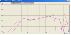

Here ... I added a fold ... under 60 hz the efficiency is like reflex ... since I like techno music I'm afraid for the punchy ...is better the old system (purple line) ?...
