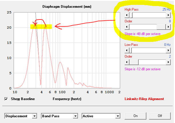

While there are a very helpful driver displacement at freq's lower than tuning frequency, there are absolutely no doubt they must override 12PS100's Xmech at 1kWt.
For ROAR18 with Driverack family or DCX2496 i'm using strong 48 dB/oct LR8 filter at around 25 Hz. Attached pic provide easy and understandable goal for HPF tuning. Use audibly-preferred filter, lift HP freq for same level of displacement upper and lower than tuning frequency. This will provide you with good level of LF-extension and simultaneously good heat dissipation with safe displacement run.
Low-freq displacement rising very needed for heat dissipation, driver suspension acts as a pump for moving air, so coil effectively vented. Keep in mind useful subharmonic synth, provided by Driverack's, this also useful for some kind of program material with lack of lower extension.
May i suppose KDSP module inside K10's or some kind of HPF inside soundinterface/soundcard?

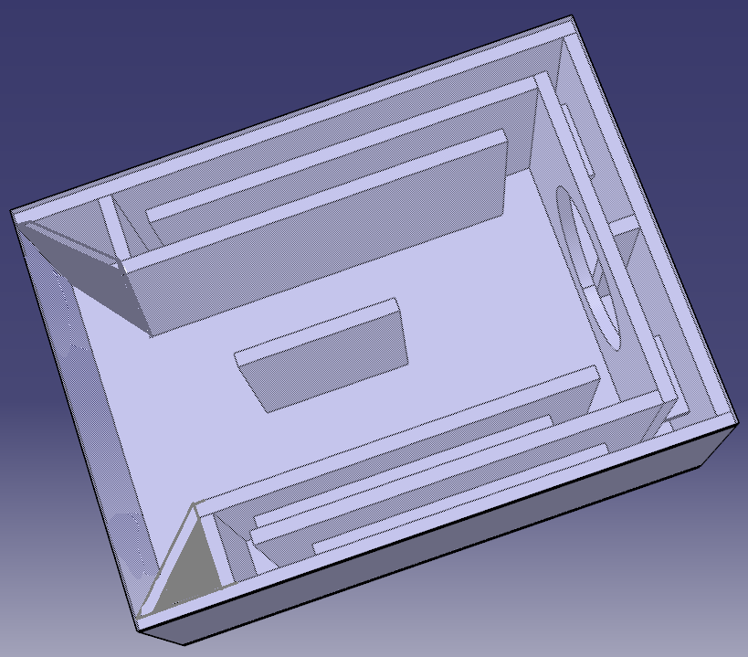

Hi all,
I tried to mod the ROAR 15 using Brian Steeles' spreadsheet, it optimizes the box resulting in a slightly smaller box. Please check and confirm if I am lost or seeing the light :confused:
I plan to build a "2x15 ROAR" sized: 730x 1000 of the optimized version. Must I put a pannel to separate the woofers or not? What are the effects or both?

Its the one you posted, the panel thickness is correct. Is the exit not too narrow? The original ROAR15 and the Cyclops have a larger exit.
That image capture looks like it is from the earlier version of the spreadsheet. The expansion near the driver is treated differently in the later version. Check the version number to see if is is 0.3. If it's not, then it's not the latest version.
If the exit is too narrow, then you need to increase the width or height of the enclosure.
The spreadsheet provides an optimized design, i.e. all volume contained within the external dimensions that you provide for the enclosure are used by the horn. The ROAR 18 enclosure, as provided on Martinsson's website, is not optimized. Have a look at the front.
This is very much intended, the resoator center frequency, i.e it's length, needs to be balanced towards to length of the first segment, and seeing that the resonator provides the highest sensitivity boost when combining these two we altered the length of the first segment instead, making it shorter in relation to the front resonator, this means raising the lower knee both in level and frequency resulting in a more even passband according to the simulation model we used.
But you are correct, if the optimization is to consider internal/external volume usage only then all ROAR designs except the ROAR15 is not optimized, this is how we choose to balance the resulting passband, but you could get a lower knee both in level and frequency by extending the first segmet all the way to boundaries of the enclosure, as per the optimization in the spreadsheet, it' a matter of taste i guess.
