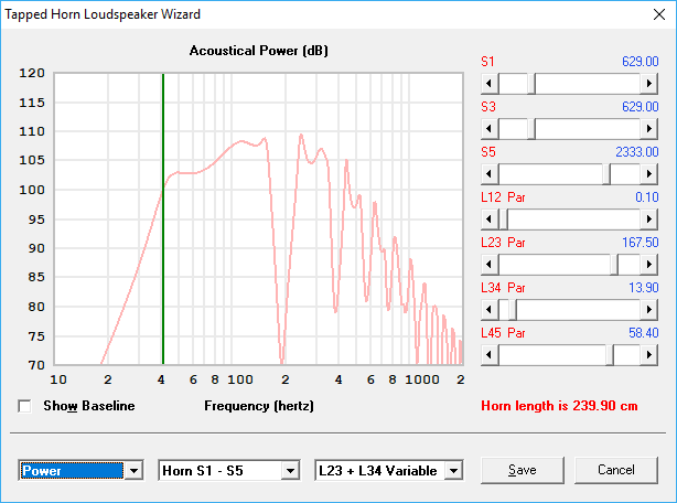

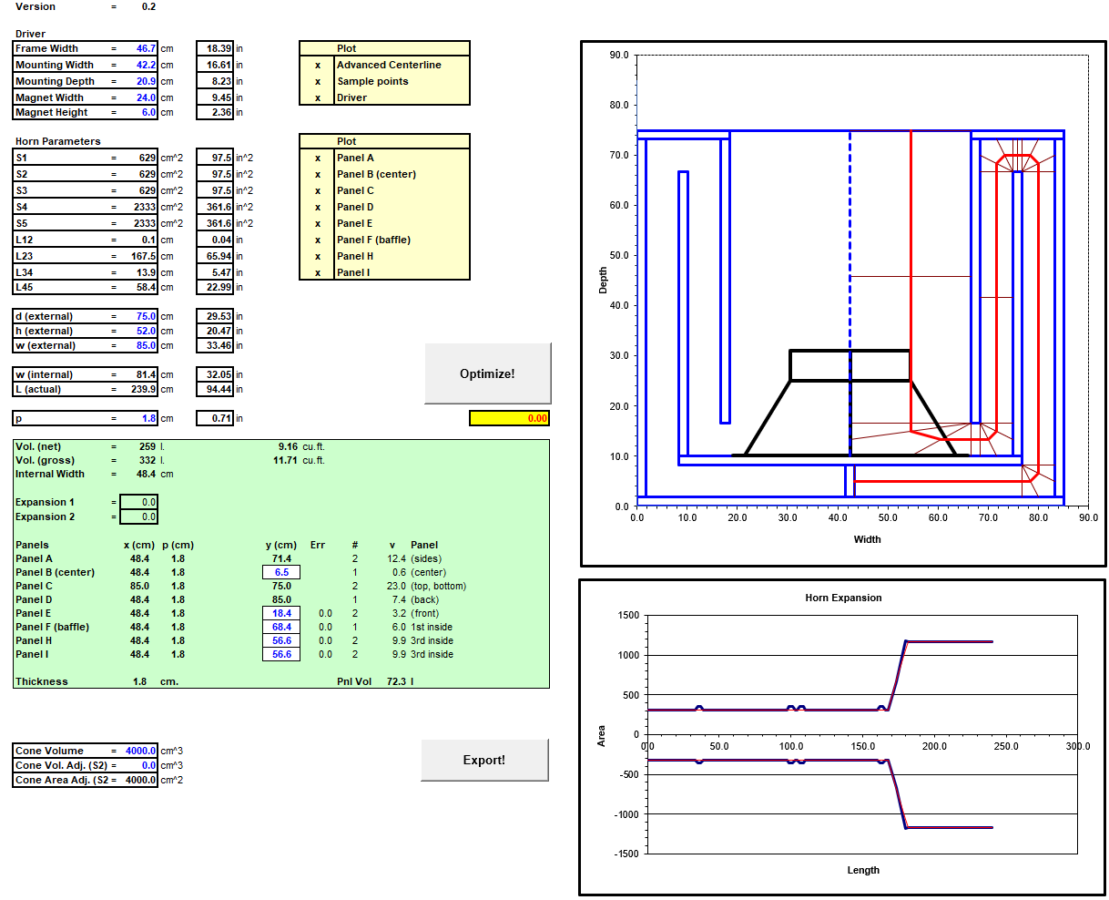

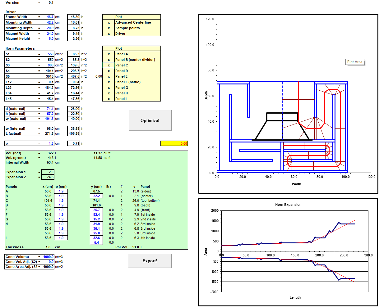

It just occurred to me that the layout of the ROAR is very close to the layout of the Cyclops. The only thing significantly different is that the Cyclops has an extra fold at the back, which results in shorter box for the same path length. The simulated response curves are pretty close too (see attached). As I've got a spreadsheet that can (theoretically) optimize a Cyclops fold, it shouldn't take much to change it to use a ROAR fold as well. If I have some time this weekend, I'll have a look at it.
Turns out that the mods were actually quite easy, but there is a catch. In putting together the spreadsheet, it's clear that Hornresp can't exactly sim the ROAR. That's because Hornresp will put the driver only at S3 or S4 in a TH sim, and the driver resides somewhere between those two points (but closer to S4) on the path. So the sim will be close, but it will always be a little off as well. I think this cane be improved by converting the front resonator to an expanding section, at which point the driver can be placed directly at S4, but then it would no longer be a ROAR.
Anyway, I've attached a copy of the workbook, if anyone wants to have a play with it.

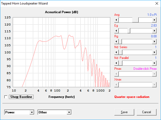

In any case I'm not really concerned about the labels. My focus is on the topology, and the closest match to the ROAR's topology is a TH with two non-expanding segments and an abrupt expansion between S3 and S4. As Hornresp is usually pretty good at modelling such alignments, I don't see why it should fail to do so, or at least come pretty close, in this case.
Thank you Brian! that way of setting up the hornresp paths was actually something we investigated in the beginning, what made us deviate from it was the front resonator the length, which needs to be set from the driver baffle to the aperture, so we realized the sim would not be 100% but perhaps more true due to the big influences of the QW resonator on the system.
Here is the response at 1m (with smoothing) of a ROAR12, no EQ or filtering applied, measured in a ~150m2 room, at a local sound contractors warehouse, 4m away from the closest wall, even so room acoustics are evident, sensitivity is not calibrated/true :
