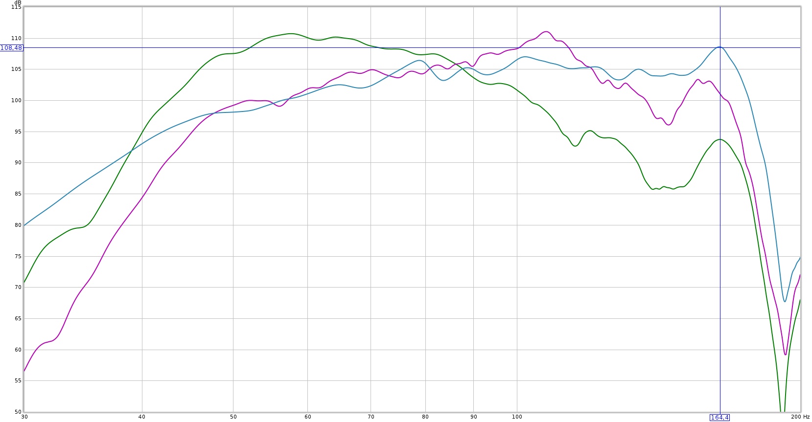

So, the ROAR12 in-car peaks just below 60 Hz, is about 5dB down at 50 Hz and about 16 or 17dB down at 40 Hz?
Looking at the most recent measurement - the blue line - I think it is much more correct to say that my car has a cabin gain with a 20 dB peak centered at 60 Hz and a lot of leaky losses below that frequency. I am having a hard time breaking in this driver. Every time I play music with more then 10 watts through my ROAR12, the rest of my family and my neighbors complain. The blue line is with a few hours of 10 watts or so and maybe two hours of more then 100 watts. The driver is still way to stiff and new.
But the 12 dB drop between 40 Hz and 80 Hz is part of what baffles me with this design. The simulation does not show this at all.
The ROAR12 behaves like the tapped pipe is much longer than it physically is, but only in the lower part of the passband. It seems like the front resonator couples much more aggressively to the tapped pipe then the simulation predicts. This would also explain the large discrepancy between the simulated cone excursion and the measured cone excursion.
Johannes
Have you taken an impedance curve of the build? That's probably the most accurate way to confirm whether or not the sim matches the build, or vice-versa. It's normally the first test I do, not only to confirm the build matches the sim, but also to check for leaks or excessive panel flex.
The frequency response graphs, well at least the green and purple ones, suggest an inflexion point around 42~43 Hz, which seems to match the sim you published in the Hornresp thread. The peak around 100 Hz is a bit off, which suggests that the sim may need some adjustment, or it could be that the driver's t/s parameters are not as published. Overall, the FR in the passband is a bit different, but reasonably close (going by the purple graph), if you consider that Hornresp does not include the impact of box losses in the sim, and the higher the "Q" of the resonances at low frequencies, the greater the difference between what Hornresp predicts and what's actually measured. And then there's the question of the driver's t/s parameters perhaps being not as published, which would impact the FR as well.
The in-car response is curious. That must be a very lossy cabin if the response from 50 Hz down is decreasing *faster* than it does in free air, as suggested by the graphs. Are you sure there was no high-pass filtering engaged?
Some interesting things can happen when you put higher-order designs in a car's cabin. When I tried out my POC3 in my car (it's an SUV, so the cabin includes the trunk), the impedance curve showed the middle impedance peak was almost completely damped away, suggesting significantly reduced excursion because the cabin was "loading" the TH at that frequency. The end result was that I could actually feed it a bit more power in-car before it started hitting its excursion limits (the flip side of that being I had to make sure and turn the volume down before anyone opened the trunk!).
