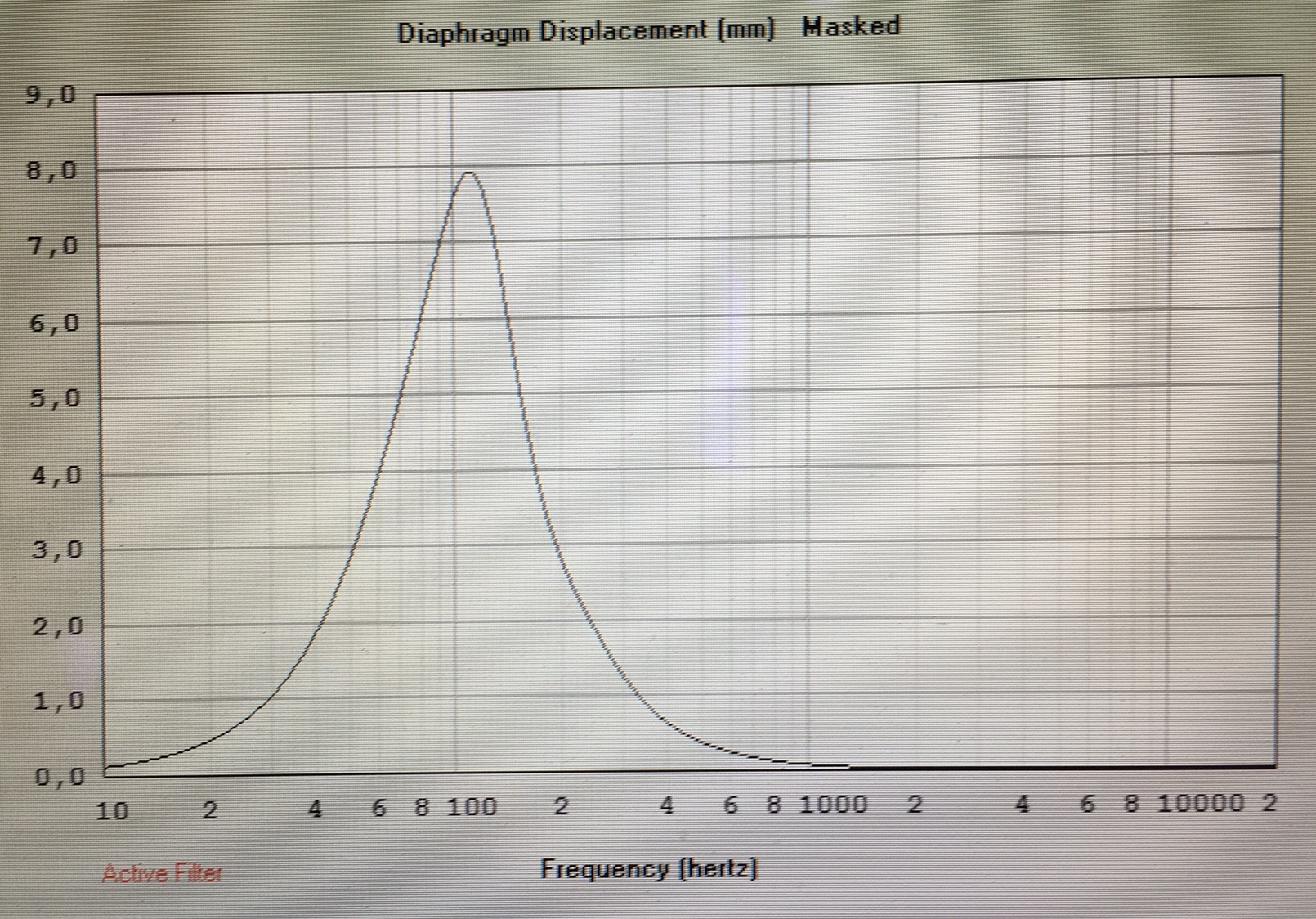

that cheap fullrange runs out of its 2mm xmax pretty fast - what other drivers might work?
[OFF]HI, Freddi!
Yes, but it have Xmech at about 4 mm and due to front horn speaker have good directivity even at the low-mids.
It couldn't reach 120 dB, it couldn't resist of 400 Wt and it couldn't be the main speaker in PA-systems.
But it sounds pretty cool to be build and then it will be the standalone speaker at any small party with tight budget. It doesn't need much power, just believe, your legs starts to dancing around and you couldn't still hold the volume knob.

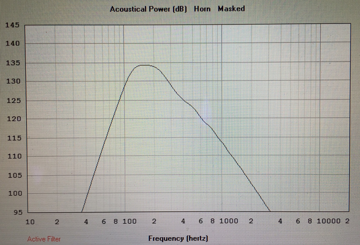

a thread on BesPav's BP-horn approach would be interesting - here;s a Fane 250tC 1pi at rated xmax (~125 watts)
He-he. Let's go further.
This driver needs a lower rear chamber volume for good damping and rising of Q.
My suggestion is 15 liters.
Having 5,25 mm of Xmax it's probably have ~8 mm of Xmech.
There are no reasons not to use it fully.
So, 15 liter RC + Butterworth 2-order HP at 70 Hz + 600 Wt could provide enough kick to any possible butt:
Keep in mind, it's loaded with front horn.
In the 1-5 kHz we will have good sensitivity rise due to front horn, higher driver itself have a hair lower 110 dB.
Just add capable sub and you're in.
