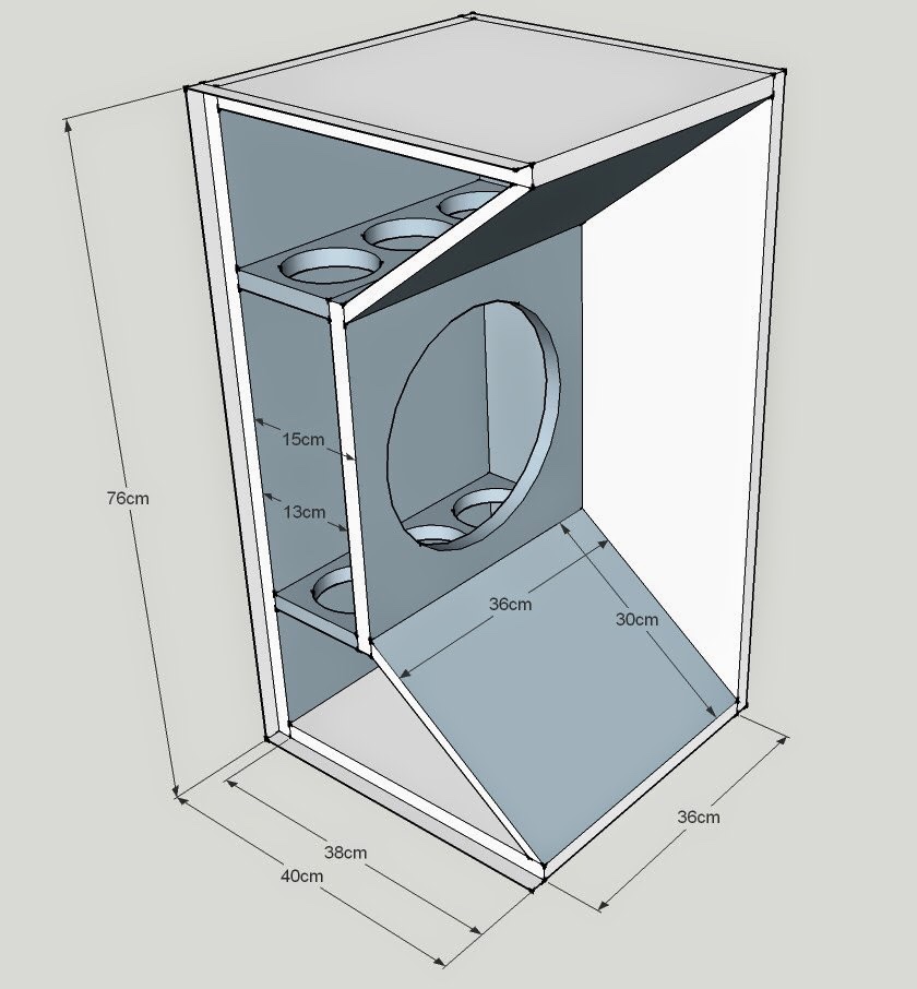

I just calculated the weight w/o driver and the weight (in birch 18mm) is 41,26kg. Shortening the horn will make the speaker 10% lighter and 8,8cm shorter. And from what I have analyzed in House EDM (Which is very popular here in DK), normal tuning might be a tad too low when stacked or indoor.

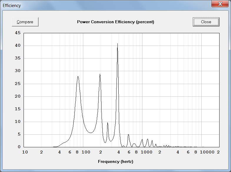

"Moreover, i'll prefer to tune front resonator a bit lower, this allow ROAR to reduce efficiency dip in 60-80 Hz range." There is no dip compared to the original design just a tad more mid peak
No, i say about dip in the power conversion efficiency, not frequency response.

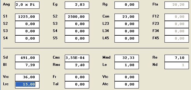

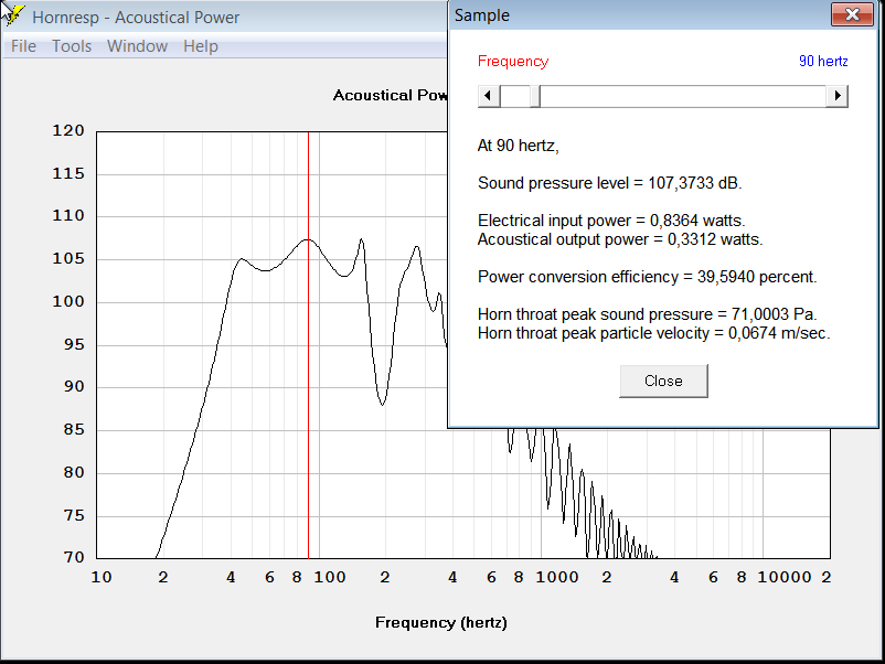

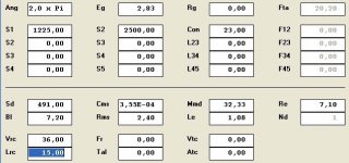

Can I see power conversion efficiency on hornresp?
Depending on the setup my whole setup will be consisting of
Tops:
2x SRM450
2x Cubo18
For bigger events:
4x Soundgear orbit 4
2-4 Groar
Driving it:
iNukes and if I'm lucky a Digam5000 or 7000 for subs 🙂
And thanks for the response Circlo. I didn't get that he was refering to smaller drivers for kick. The orbit 4 have a sweet kick (according to my friend) and it is crossed at 80hz, so they should match well!
Yes.
You'll definitely need more than 2 'groar' for 4x Soundgear Orbits. Even 1:1 ratio will be quite top heavy.
Of course!
While seeing to SPL response select "Tools" -> "Efficiency"

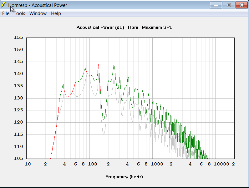

This is the Fane Colossus Prime 18 in a ROAR18. Grey curve is 1200 watt and 12 mm xmax.
The black curve is the same 12 mm xmax but with the maximum stated 4800 watts peak power.
The Soundgear Orbits has a calculated max spl of 129 dB in the midbass and a peak output of 135 dB.
They seems to match nicely in a 1:1 ratio.

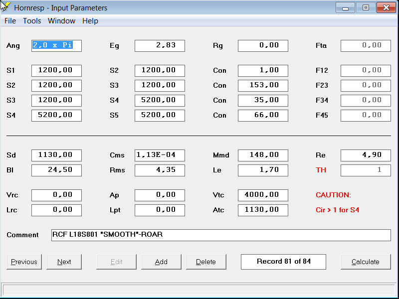

I have been pondering a much larger ROAR18 tuned specifically for the rather unique RCF L18S801. That driver has a reputation of very sharp transients and a great midbass punch. This combined with the nice resonant midbass peak in the ROAR type of bass box should be really fun and entertaining with drums and other peaky, transient midbass sources.
It is a quite old driver with substandard xmax, weak suspensions and a delicate cone compared to modern alternatives. The ROAR is very careful and soft on the drivers due to a symmetric loading, no skewing warping forces on the cone and suspensions and a large cross section of the tapped pipe (low compression). It could be a real killer for fun punchy midbass.

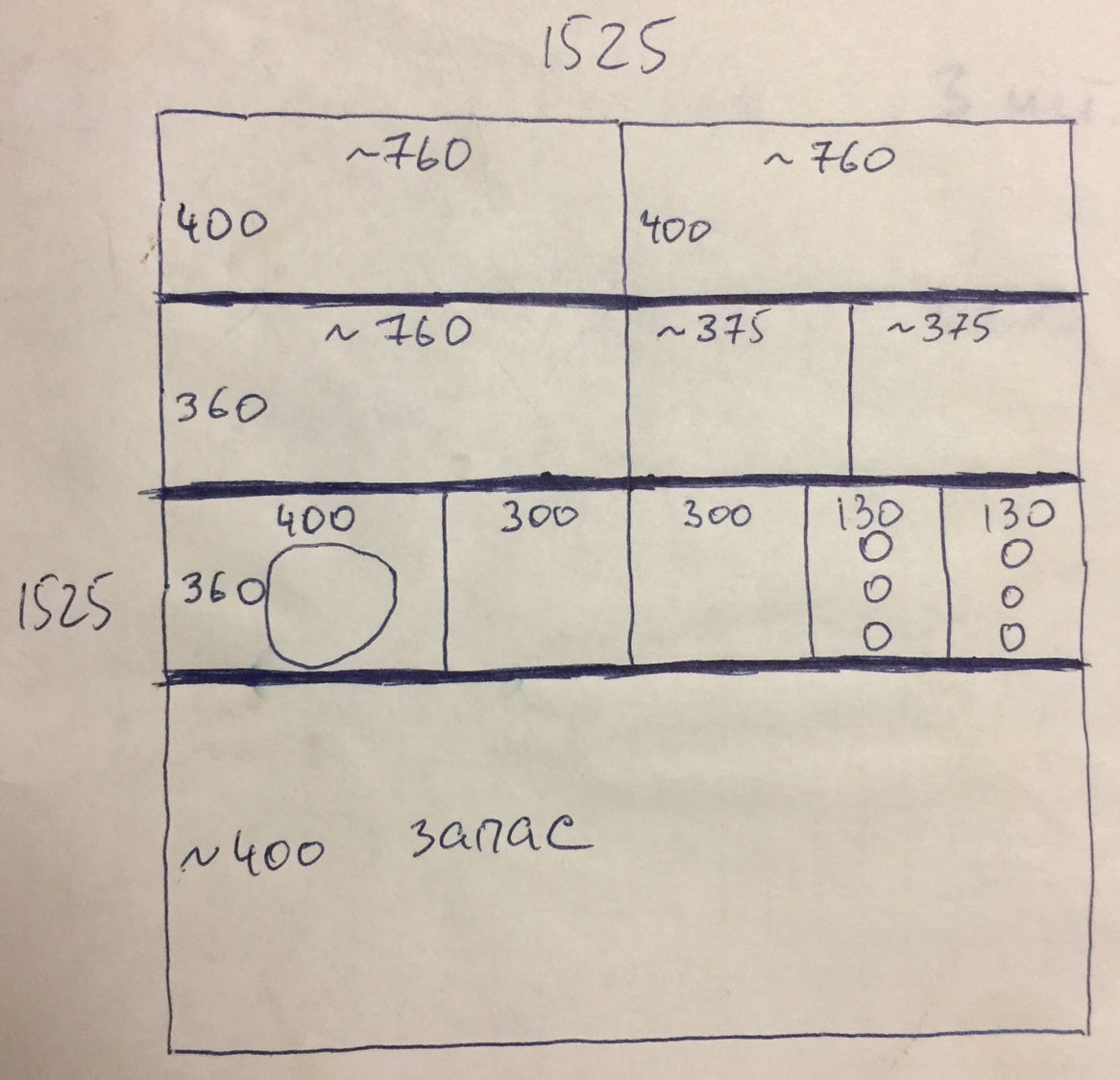

You can be sure, friend of your son will tear off it with your hands while hear.
You have heard violent rattle of anything from ROAR as sub, now you can check what a peppy and cheerful rattle could be from high-Q mids.
