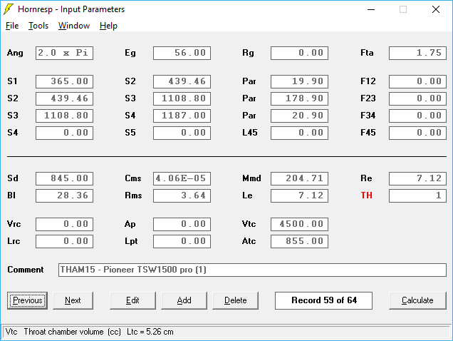

the S1-S2 distance (L12) that goes from the center of the driver to the edge, this is also a bit of a tricky area, and again I'm not sure which way is the correct one
I don't think that S1-S2 length is correct in your sim - should be more like 0.1cm as per the alternate suggestion, as the center of the driver is right over the start of the path.
Hi martinsson & Brian Steele,
The assumption that S2 needs to be above the centre of the driver has no technical grounding. S2 only defines the throat area and its axial position, nothing more nothing less!!! Nowhere you will find that the throat necessarily needs to be in line with the piston.
Instead of using S1-S2 (L12) segment you can also use the Ap/Lpt function in Hornresp for this section. Some 'old school' designers prefer this method since they are used to treat the most narrowing point near the driver as the throat and any volume between cone and throat is considered as the throat chamber. The outcome is the same, so it is more a matter of personal choice.
Hmm...
The way I know how to use it, S2 in a TH defines where the center of the driver's output at that part of the horn , and S1 and L12 define the CSA of the horn at its start and the offset of the driver's center from the start of the horn. Ap1 and Lp can be used to include the baffle cutout in the sim, and Vtc and Atc used to define the volume of air between the driver's cone and the cutout, basically the "throat" of the TH.
In fact, if you put your mouse pointer over Vtc in HornResp, it shows "Vtc - Throat Chamber Volume". As David McBean actually wrote the software we're using to sim these things, I think I'll go with his approach to simming them 🙂

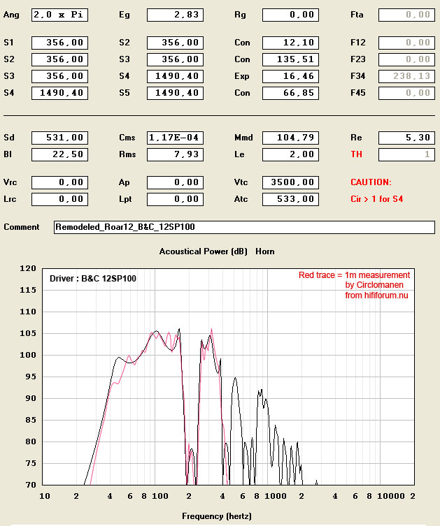

Hi all,
Seems like my earlier link doesn't work.
Meanwhile I finished the model for the Roar12

@ Circlomanen, Johannes I modelled the wrong driver as I thought you measured the Beyma. It is closer now, although the differences are small.
Djim

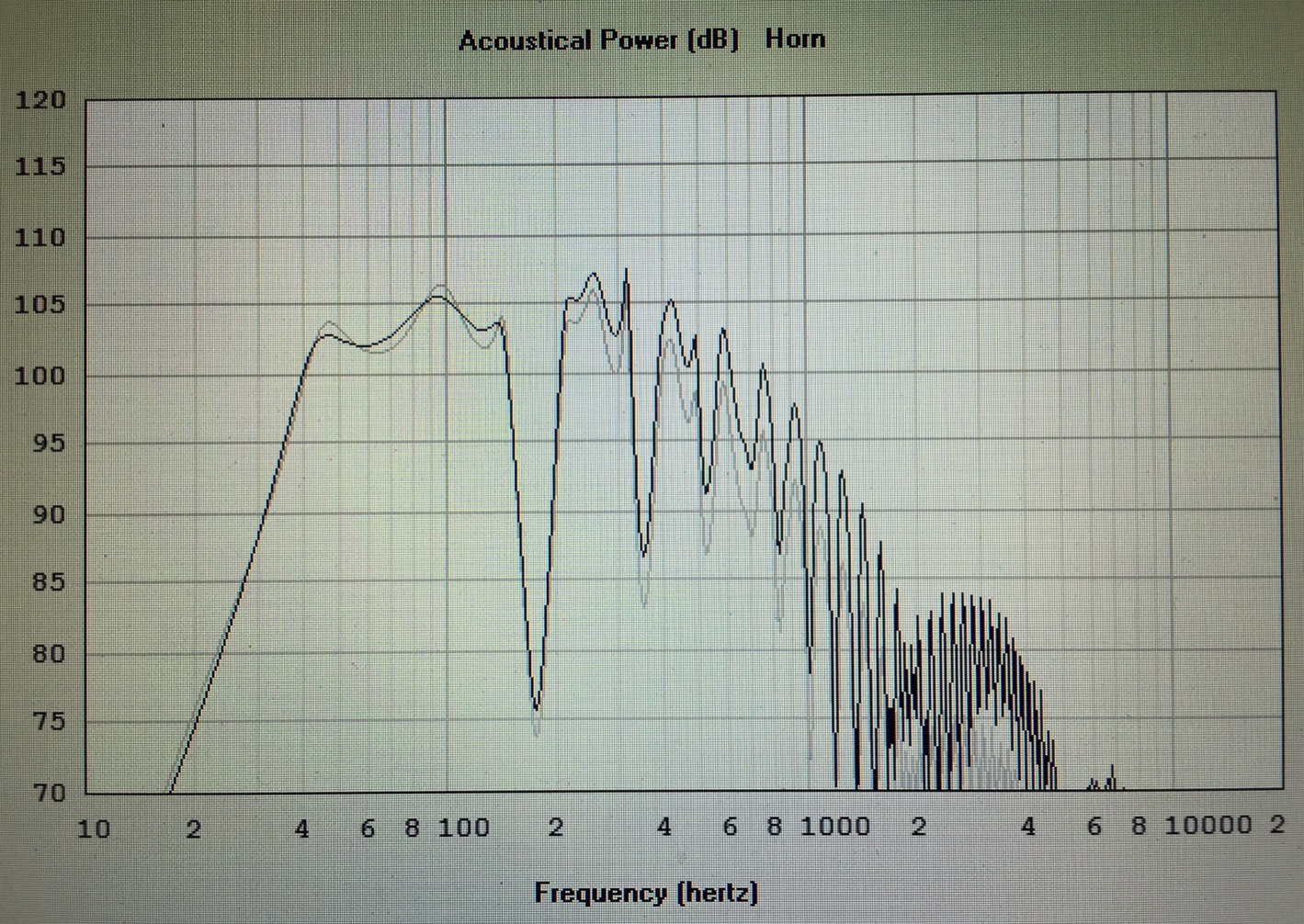

WUT?
The first two sentences in this paragraph directly contradict each other. S2 defines the cross sectional area in all designs and it indicates the driver position along the axial length of the horn flare in all TH (and OD) designs. Therefore the second sentence is correct and the first sentence is not. But even though the second sentence is correct that is not how you simulated it.
Brian is right, of course, the only thing I would change in his statement is that L12 should be 0.01 cm instead of 0.1 cm.
What difference does that make? S1 is assumed to be a solid boundary and there will always be a deep notch associated with the boundary reflection at a frequency related to the S1 - S2 length (L12). In this design it doesn't appear as a deep notch due to the variety of resonances in the 400 hz region (where the notch appears) but you do still clearly see a notch in that range even in your sim.
Not that it matters though - the more than 1/2 octave wide 22 db deep black hole at ~140 hz means nothing above 140 hz really matters and that it will be impossible to get a good crossover transition to the mains. Just look at the damn thing, it's almost a vertical line dropping down at 140 hz, likely much steeper than 96 db/oct drop. Even if you had hardware that could cross the mains at that slope it would sound terrible, as Brian said.
Instead of using S1-S2 (L12) segment you can also use the Ap/Lpt function in Hornresp for this section. Some 'old school' designers prefer this method ...
I assume you mean vtc/atc here, not ap/lpt.
Using vtc/atc to define the S1 - S2 area is simply the wrong way to do it. There will be a deep notch related to the L12 distance and that notch won't show up in the sim if you treat the S1 - S2 volume as a throat chamber.
You can clearly see the error if you look at sims done this way. Danley simulated the Labhorn this way and the sims don't match the measurements at all. You can make the sims match the measurements though, all you have to do is sim it accurately.
Other than those two points though, you did a good job on the sim. L12 definitely should be 0.01 cm, not 20 cm, but in this case it hardly matters as the notch is way too high in frequency to matter in this design due to the massive 1/2 octave wide 22 db hole that kills this thing as a viable design for anyone that knows anything about system integration.
